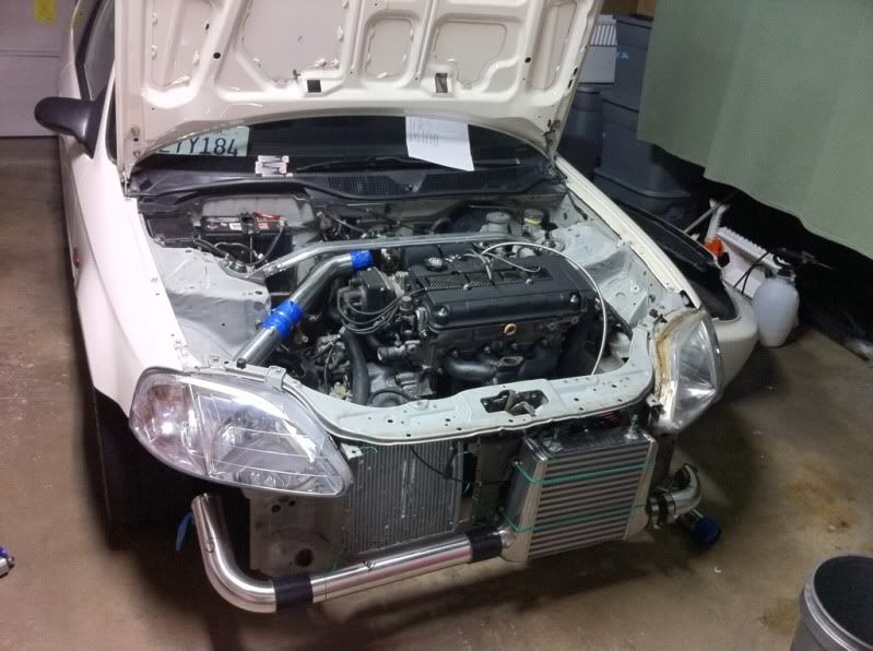

Intercooler and radiator mockup. Using the old radiator as those fins get damaged way too easily.

interesting... i kinda like... although i like symmetry... hope it keeps charge temps down... but i still think the turbo could used swapped around, full length radiator, full length/height intercooler....
Re: Civic Hatchback, B18C1 with Holset HX35, Road Racing Project
« Reply #32 on: November 20, 2011, 02:44:32 PM »
I would have kept the ic, and gone with a full sized rad, and flipped the turbo around like Dusting said. But I'm curious to see how it will do hot lapping it.

Trust I thought about what you said a few times. Even more yesterday while I was making the downpipe. Thankfully I have thought the routing before hand so everything fits really snug currently. We will all see if it works when the time comes. I have a few tricks yet to be shown that I am hoping will work to keep temps down to a minimum. I have not seen what I have done either so I will be very pleased to see if it works.
This will be the fail safe route if my setup does not work. It will put me behind about $400 to redo it that way I assume so its not too bad for the experiment.

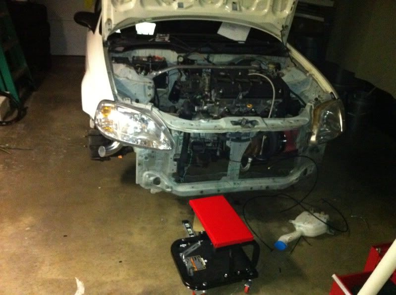

Updated first page with some pics of the little fabrication I had to do so far. Not much but I was very pleased
