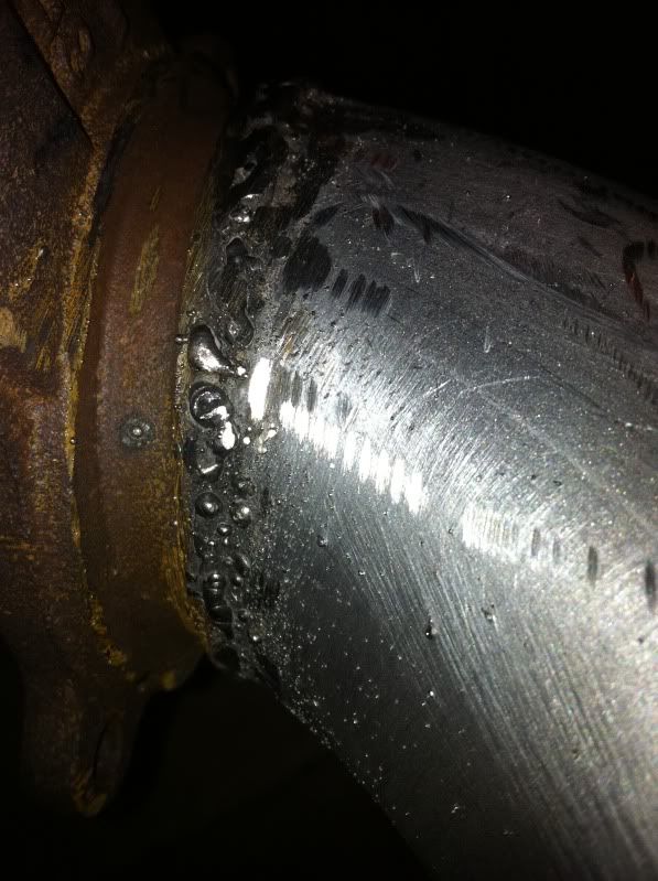

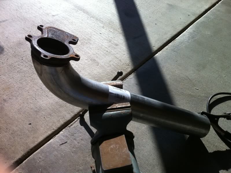

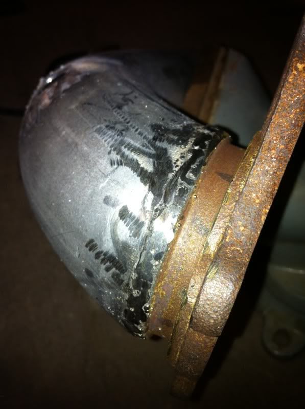

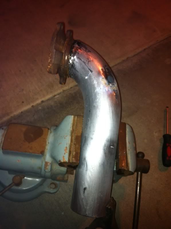

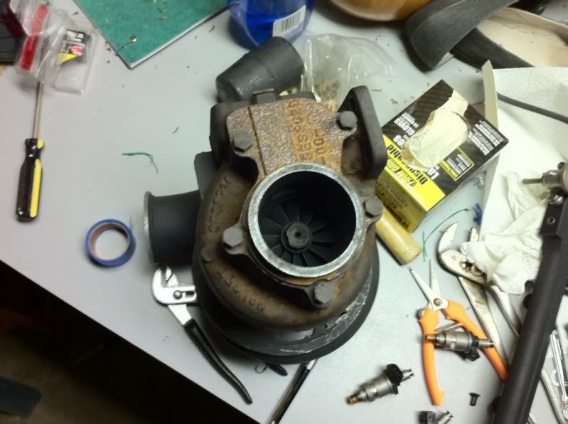

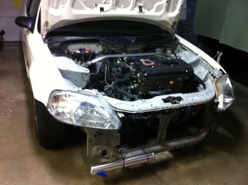

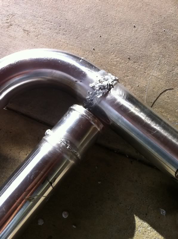

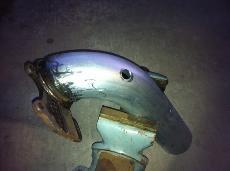

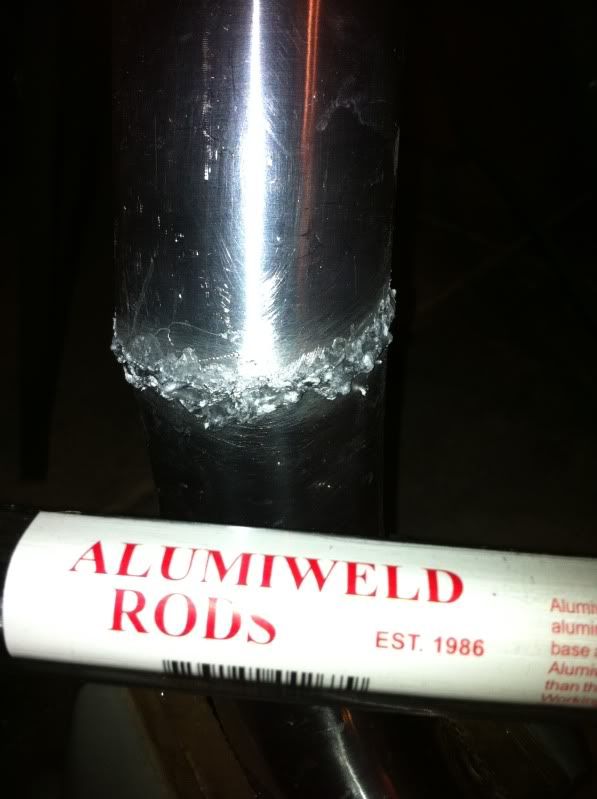

Fabrication:
This is my first time welding and braising. Power of RHMT
Charge pipes.. Went with some aluminum braising to keep the pipes together. Will be using couplers to make sure pinholes dont create problems.
Downpipe.. Ordered a bend online and cut a few pieces for fitment. Then proceeded to mock it up and weld to the vband flange.
« Last Edit: November 20, 2011, 08:23:28 PM by imburne »

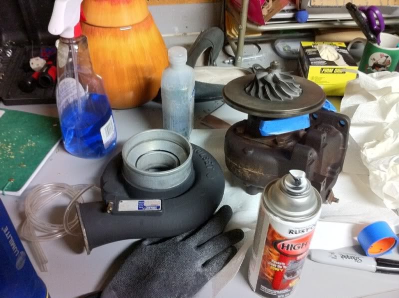

    • TurboByHOLSET
Re: Civic Hatchback, B18C1 with Holset HX35, Road Racing Project

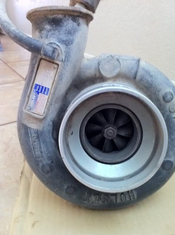

« Reply #3 on: November 04, 2011, 06:14:45 PM »

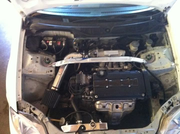

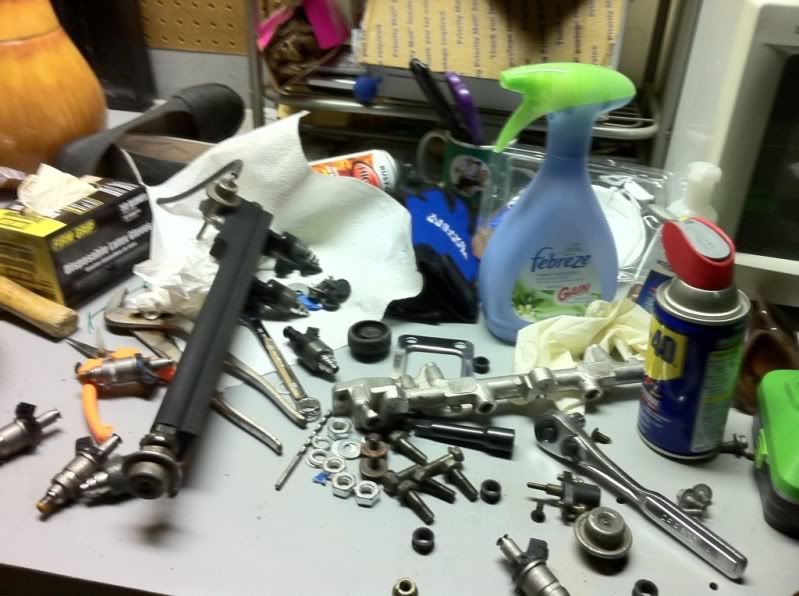

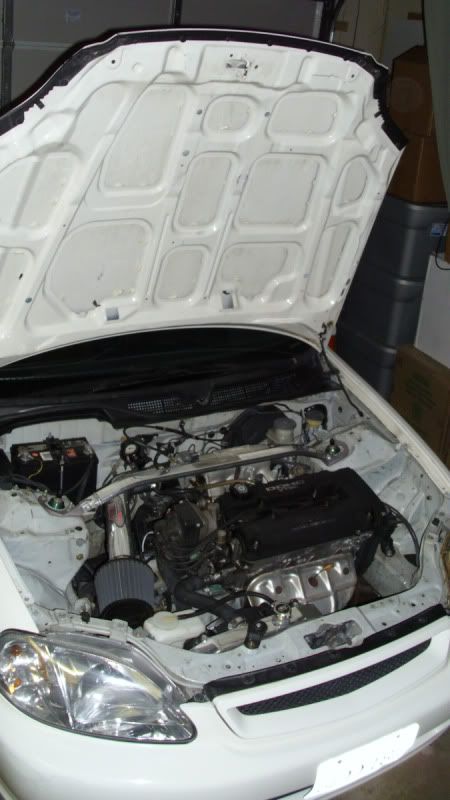

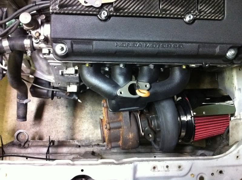

Before and After turbo build pics..
Before
« Last Edit: November 04, 2011, 06:21:32 PM by imburne »
imburne
  • Posts: 3983
    • TurboByHOLSET

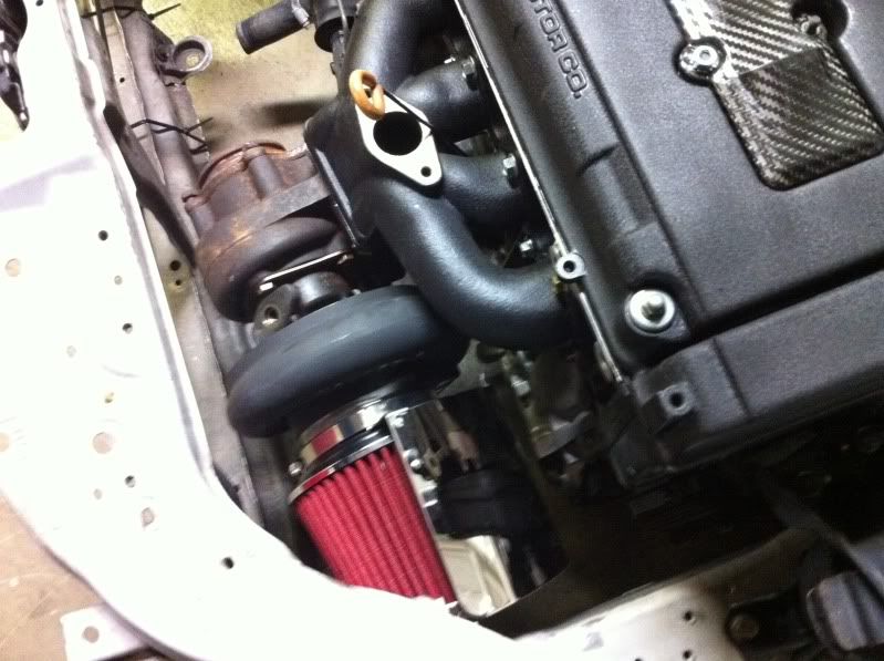

« Reply #4 on: November 04, 2011, 06:22:15 PM »
More Progress
imburne
  • Posts: 3983
    • TurboByHOLSET

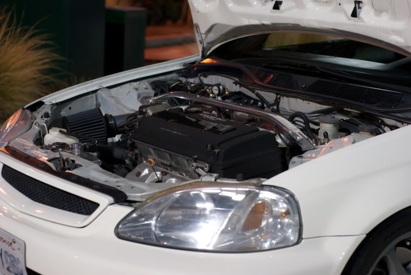

« Reply #5 on: November 04, 2011, 06:23:17 PM »
Final build pics

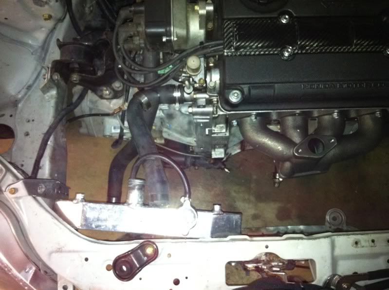

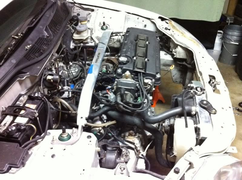

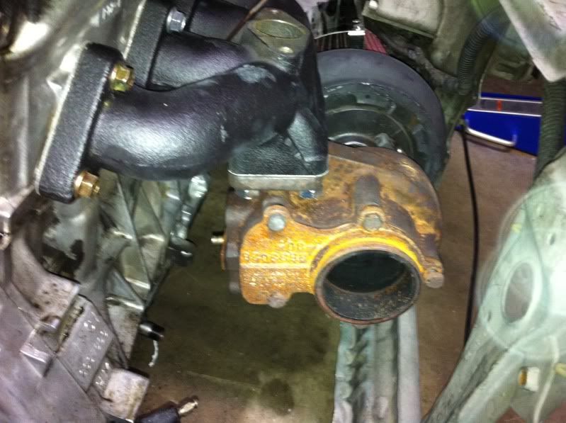

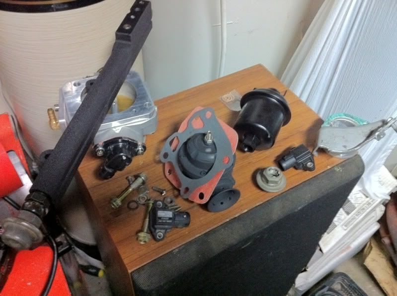

« Reply #7 on: November 04, 2011, 07:37:36 PM »
Finally got themanifold off 8)
Thanks for the help on that. I pretty much did what you suggested with slotting the nut to death. It didn't give up so I ended up smashing it out with a flathead and a rubber mallet on the slotted nut pieces. Easily the toughest one I have ever taken out.

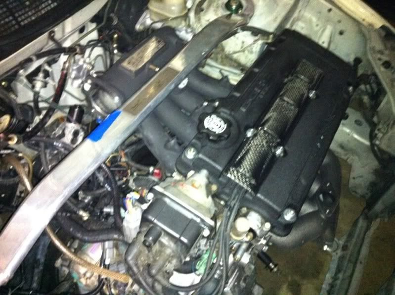

« Reply #12 on: November 05, 2011, 12:26:24 AM »
bust out the angle grinder and work that block over, mount the turbo the right way on that manifold, and then put a full length radiator in that thing...

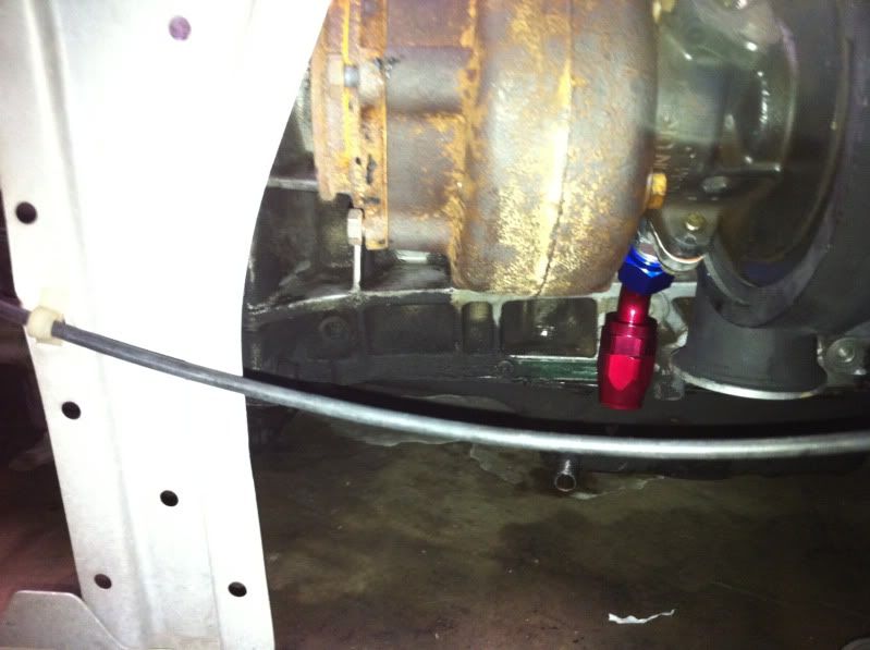

« Reply #13 on: November 05, 2011, 01:34:33 AM »

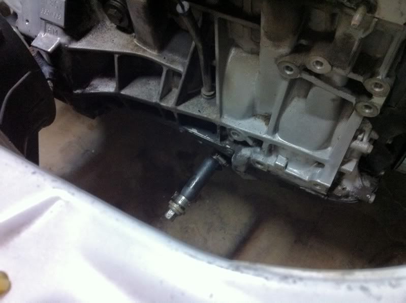

The oil pan is shallow directly where the hot side of the turbo is mounted. I don't have a picture mocked up with it like I should have shown, but I did mount it up to check for clearances. From what I see the alignment of the dp will be perfect at that angle. I am referring to having the cold side facing the drivers side door. I am still going to have to slightly adjust the radiator location but will keep air flow in mind.
« Reply #14 on: November 05, 2011, 01:03:28 PM »
buy a manifold that is made for what your doing then. this will be fail... :-\
« Reply #18 on: November 05, 2011, 11:36:50 PM »
Like a topmount? There is no plans for a full size radiator or intercooler. Be a little more specific I am all ears
just saying that the manifold is not designed to mount the turbo that way. pushes the turbo too far forward, and aims the downpipe and intake like shit.
im in no way endorsing or condoning a topmount.
what are the plans then?
Point taken. Upon closer inspection when I start aiming pipes for cutting if it does not work I will look for another one. At $65 bucks shipped, switching is always an option.

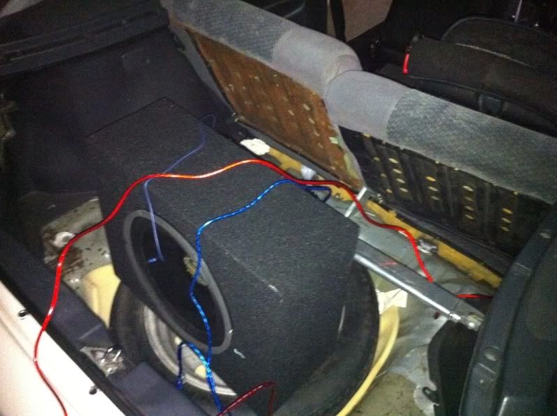

« Reply #25 on: November 11, 2011, 03:16:13 AM »
Still waiting for parts.. Got all the speaker stuff yesterday and installed in a hour or so. Its removable so I can take it out easy, save weight, and its not too smart to race with a speaker box as it could potentially kill you in a accident  :?:
Industrial Dubstep is what I usually listen to
I bungee corded it to the rear strut bar but need to throw some padding on the bar where it meets the amp for vibration dampening.

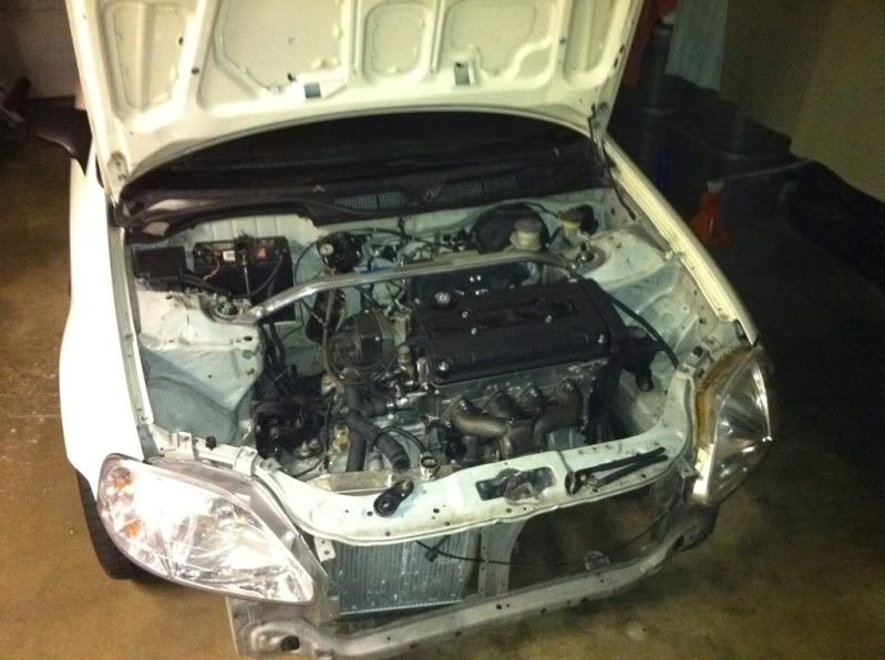

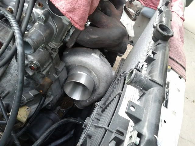

I have been playing with the intercooler placement and piping while I wait on my welding mask. Already cut a few pipes and stabbed the shit out of my thumb on accident when I was mocking up the IC pipe.
« Reply #27 on: November 11, 2011, 12:02:58 PM »
Have you test fit your rad back in there?
I had a similar mani in my integra with an hx35 and that slight angle aims the downpipe right at the radiator.
I had to rock the gangster lean on the rad and it all around sucked.
I finally changed my manifold but I need to repost my build thread, it took a dirt nap.
« Reply #28 on: November 11, 2011, 12:29:35 PM »
I would get another header flange, and then stack that betwent the mani and the head, and then flip your mani around and notch the block the rest of the way for your tubo to clear. This is the turbohf way to do it. I saw him do it a few years back with his 50trim on the itr, He keept the full rad, ac & ps. Shit was kinda tight but it all fit.
« Reply #29 on: November 13, 2011, 01:52:23 PM »
and i still do...
you look you can see it in that pic.
now yours....
looks fuckin retarded. buy the right manifold for what you want to do. or mount the turbo correctly...
