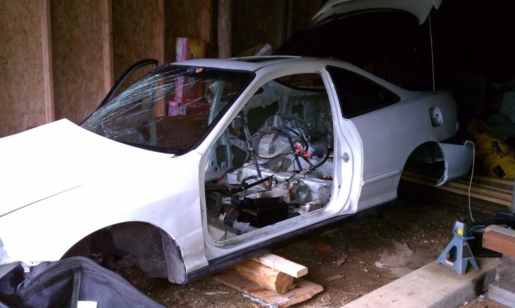

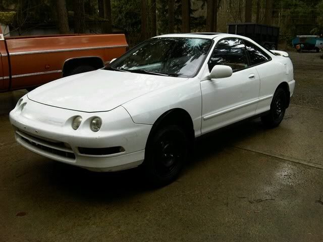

I picked up 2 integras. 1 was a 94 gsr rolling shell with nothing in it at all. Picked it up for $500
My old crx build thred is here www.realhomemadeturbo.com/forum/index.php/topic,205.0.html
Thats the motor thats gona end up in this car
Quick rundown on the history of this car.
Owner had the car but did not have it insured. It got stolen and the raped everything out of the car, cut ecu harness and all. Owner got it back but it still had a clean title because it didn't have insurance to claim it on. Owner sold it to the next guy. I was gona turn it into a father son race car project but it never happened. Fast forward 4 years until feb 2011, dude puts the car up for sale. I come through and swoop it up. While I was there he was telling me about some dbag that had showed up the day b4 me and was talking about how he had the same car, but wrecked it the night b4. And was gona swap all the parts over. He showed up and decided it was to much work. So while I was buying the car I got the dbags number. Text dbag and decide I would buy it on Saturday. Went and picked it up and now the swapping begins. The car I picked up from dbag was a 98 ls that he slid off the road and into a brick retaining wall. I picked it up for $1500
So ive still got my built ls out of the crx so thats gona be the heart of the beast. So Ive got alot of swaping from one car to another going on. So when I say rolling shell, i mean shell. NOTHING inside.
It needs work, but you get the idea, on to the pics

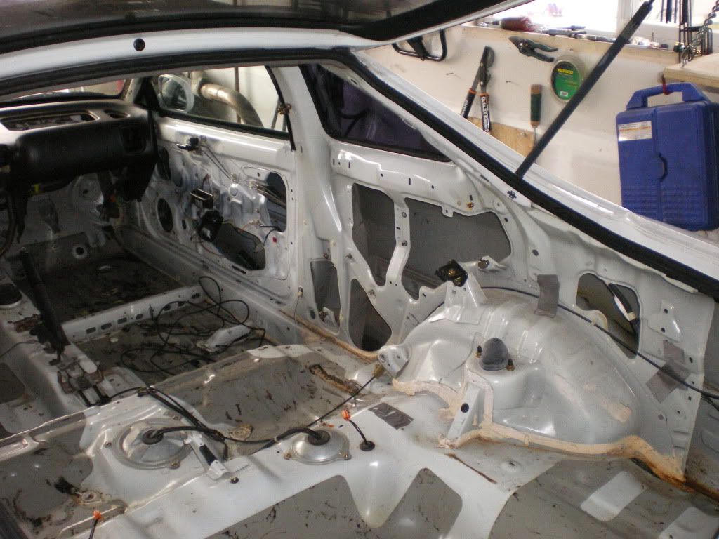

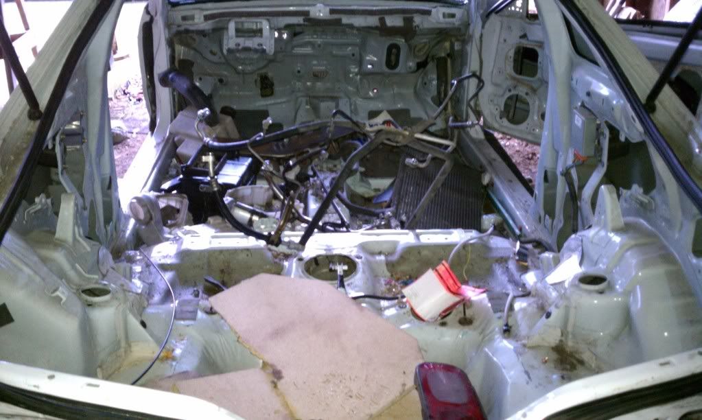

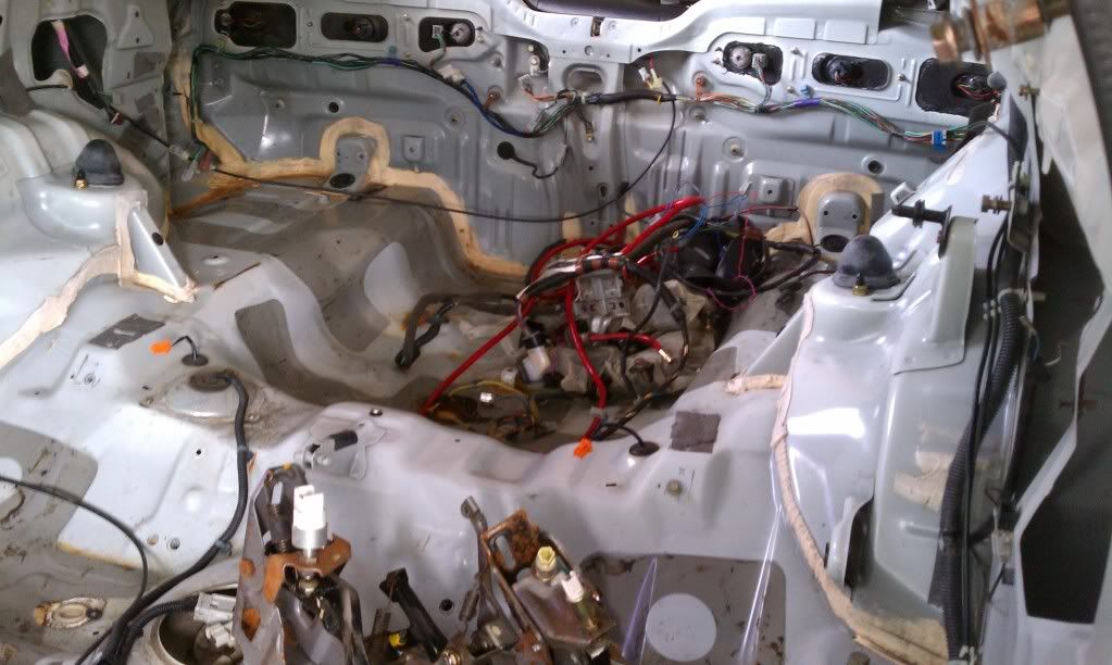

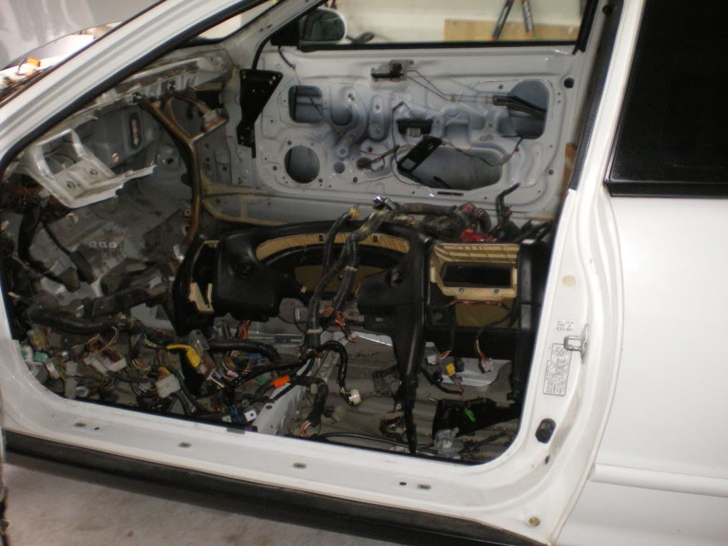

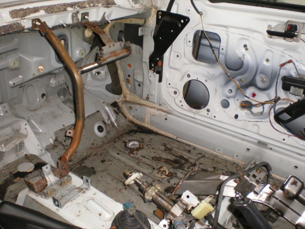

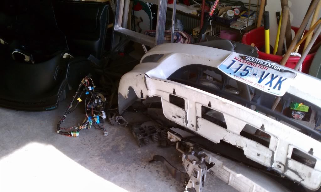

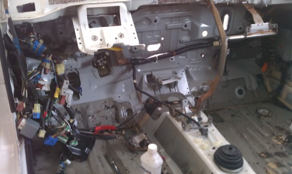

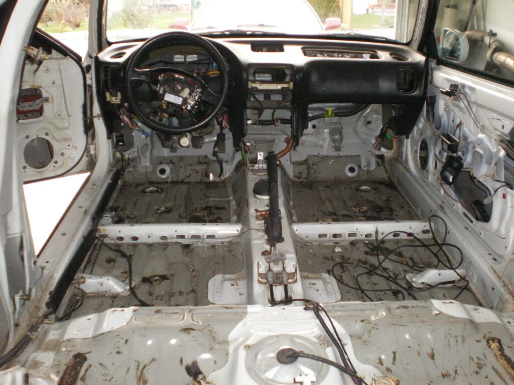

So got all the wiring ripped out and what little bit of interior was still left.

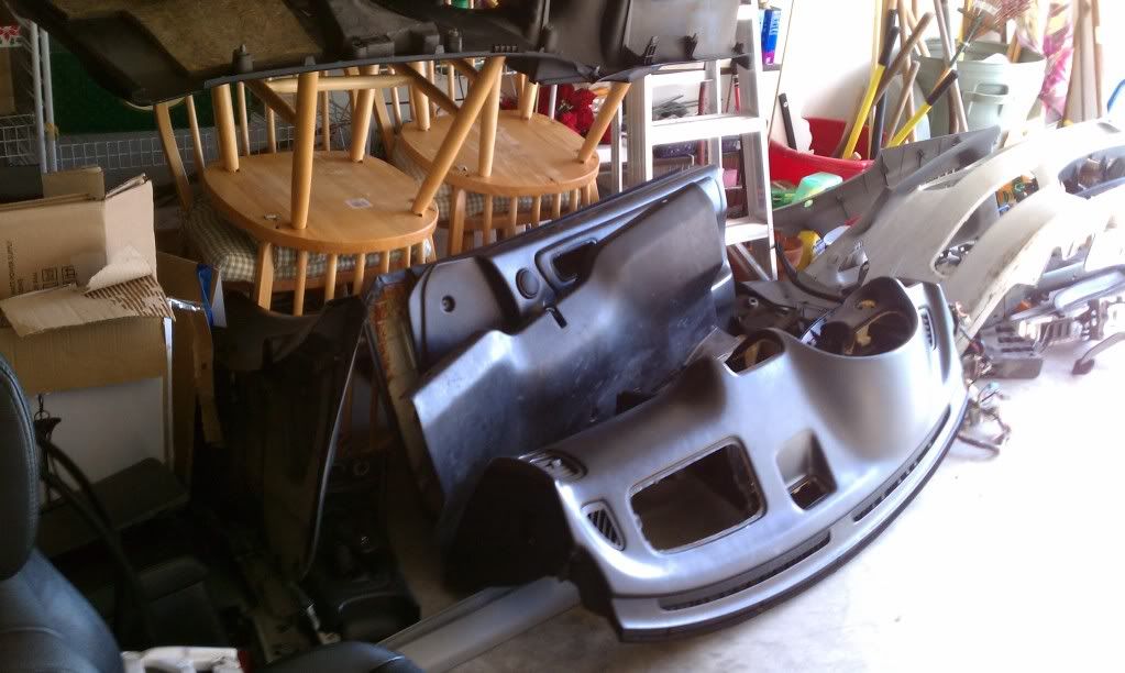

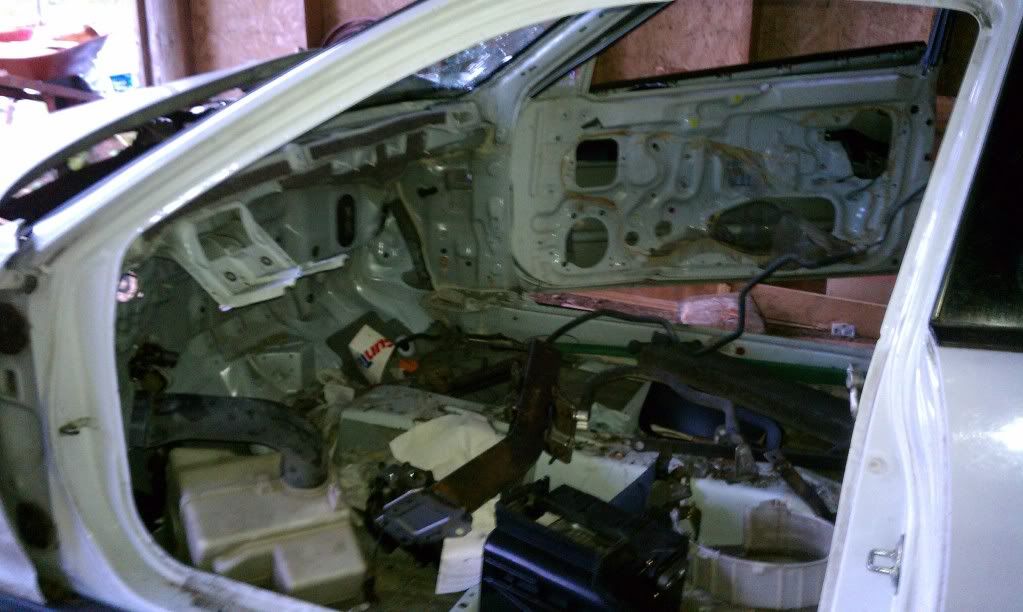

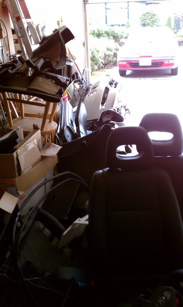

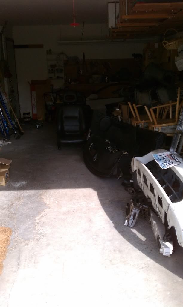

I have every bit of interior from the donor ripped out and stored down the street at a friends garage.
So with everything ripped out of the shell, I cleaned the life out of the inside of the car. With it being kept outside with just a car cover over it, It had the smell of mouse piss in it. GROSS! So I installed all the wiring from headlights to taillights. Installed the sunroof, headliner, and wiring for it.
Got the battery hooked up to test out some of the wiring b4 I start putting all the interior back together and it all worked.... WHHHOOOO HHHOOOOO!!

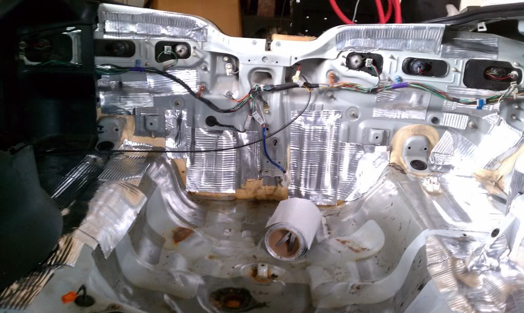

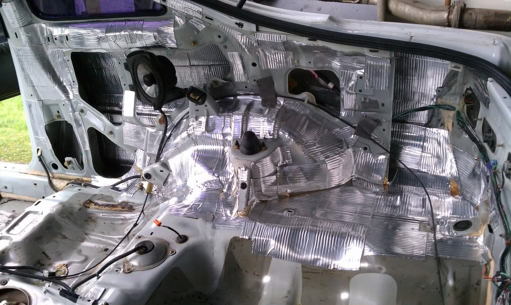

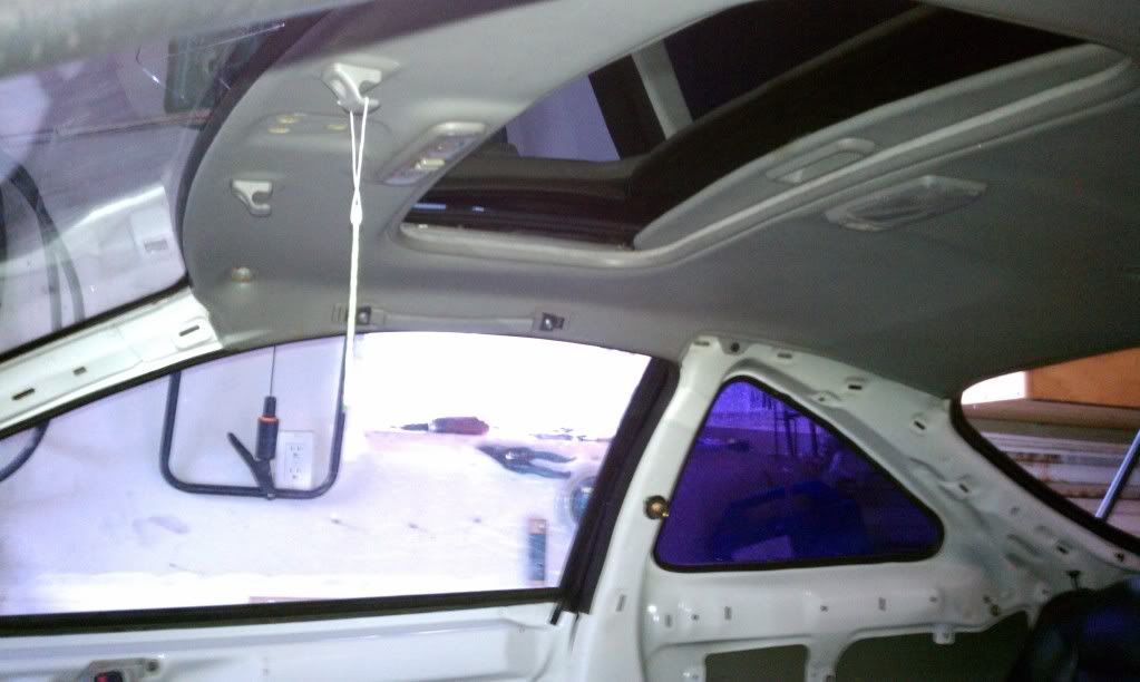

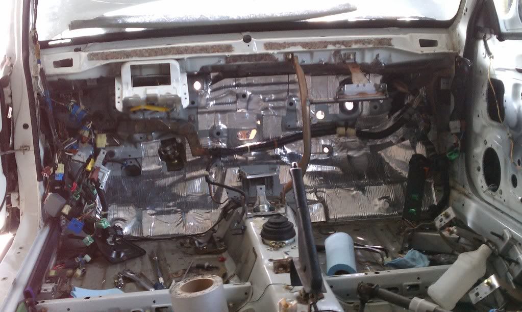

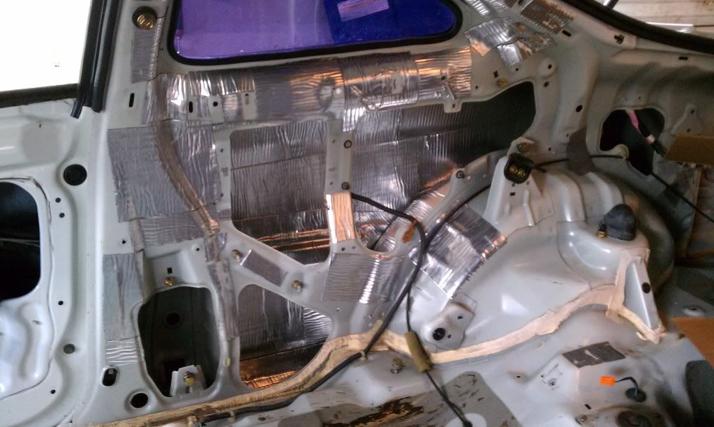

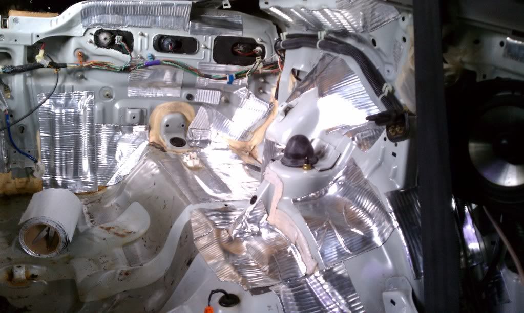

So I put down my sound deadening on the whole firewall and plan on doing the whole car. I want a quiet ride. Im using peal & seal instead of dynamat. Per lowerit's advice. It comes out to just over $1 a sq ft.
Firewall b4 Peal & Seal. I used alcohol to prep the surface after I used a scrub brush and purple power.
Firewall pad was a little torn up, so duct tape to the rescue.
Peal & Seal on firewall
Firewall pad installed and duct tapped.

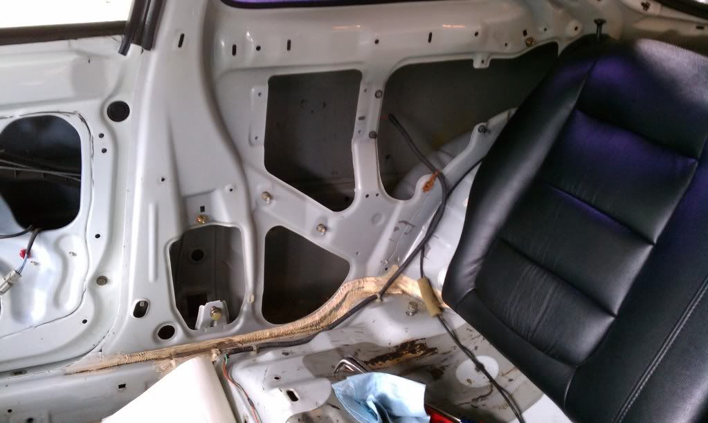

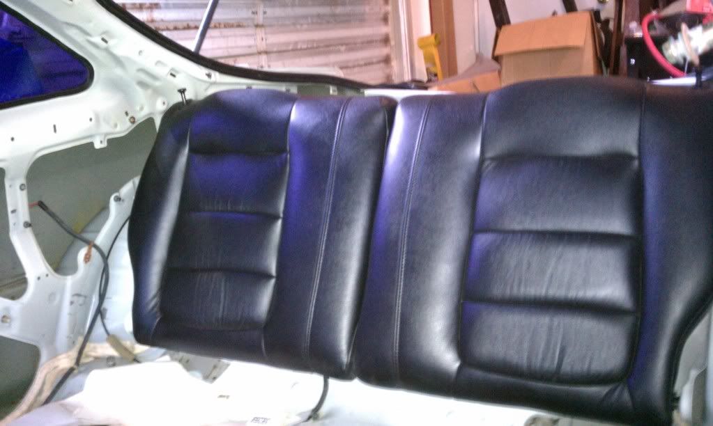

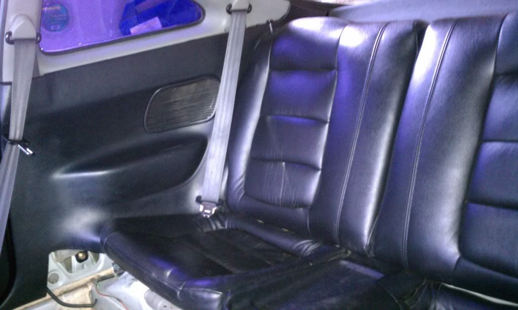

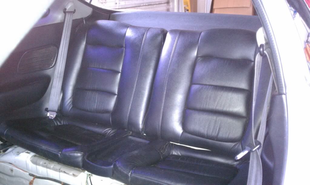

So Just for shits and giggles i threw the back seats in to get them out of the way and see how fitment was.

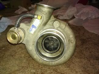

Got a new turbo for it a few months ago. HOLSLUT BIATHCHHHH!

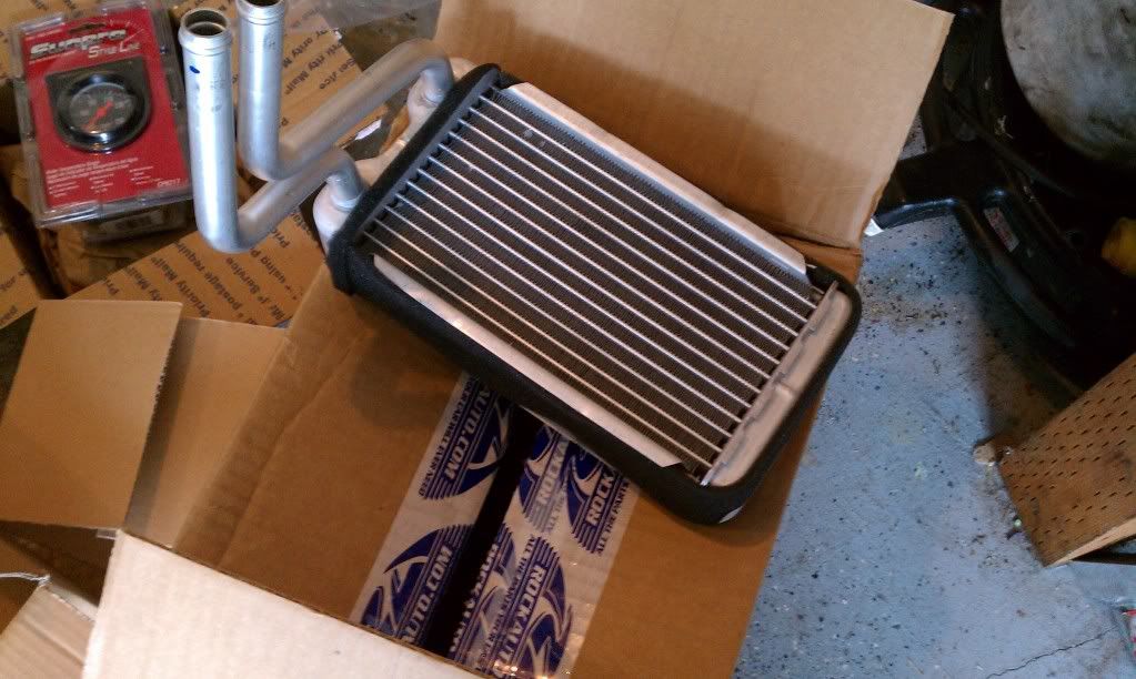

Got some parts in the mail today.
Sunpro water temp gauge and heater core
So I slapped the heater in along with the ac delete
Then went to work on a little more sound deadning
b4
After

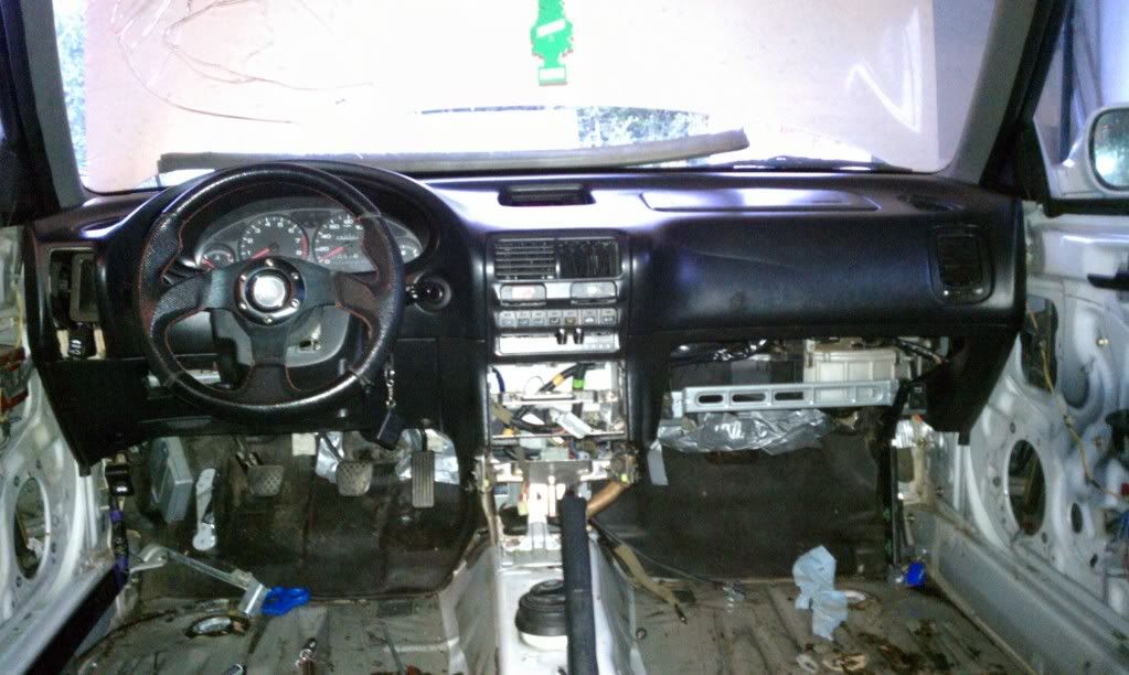

Well, got the dash in
and the gauge cluster is all wired up and just got to put the center console and ashtray assembly in and i will be done with the hard part. Hope to finish it up tomorrow. And maybe finish the peal & seal on the passenger side, and put the rear plastic and seatbelts In and that side will be finished.

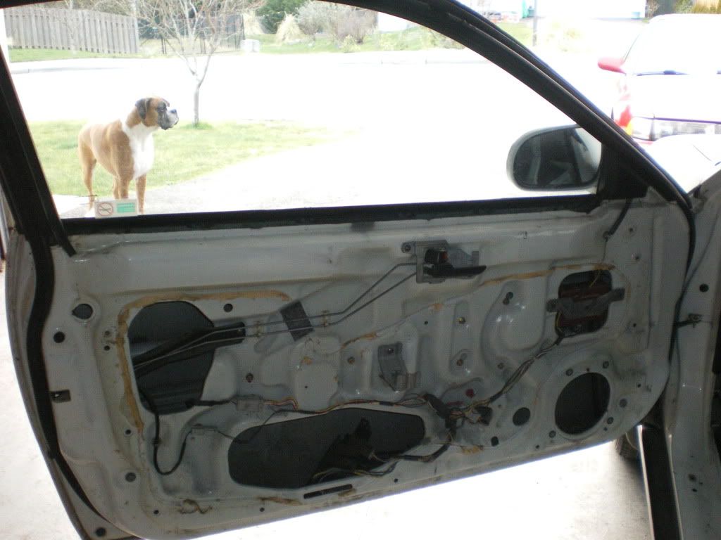

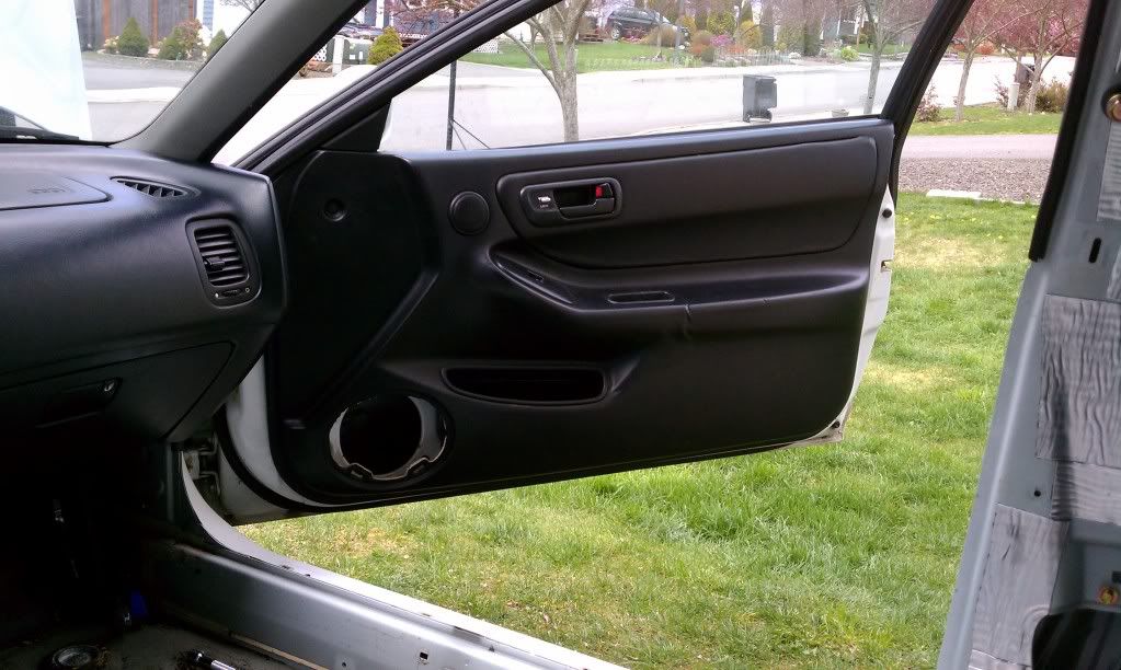

Door wiring, and door panel
Didn't do any sound deadning on the door yet. Need to get a new door panel because this one took a pretty good hit when the donor car slammed into the brick wall.

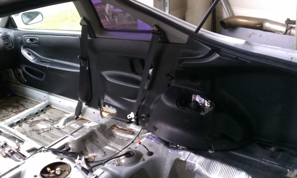

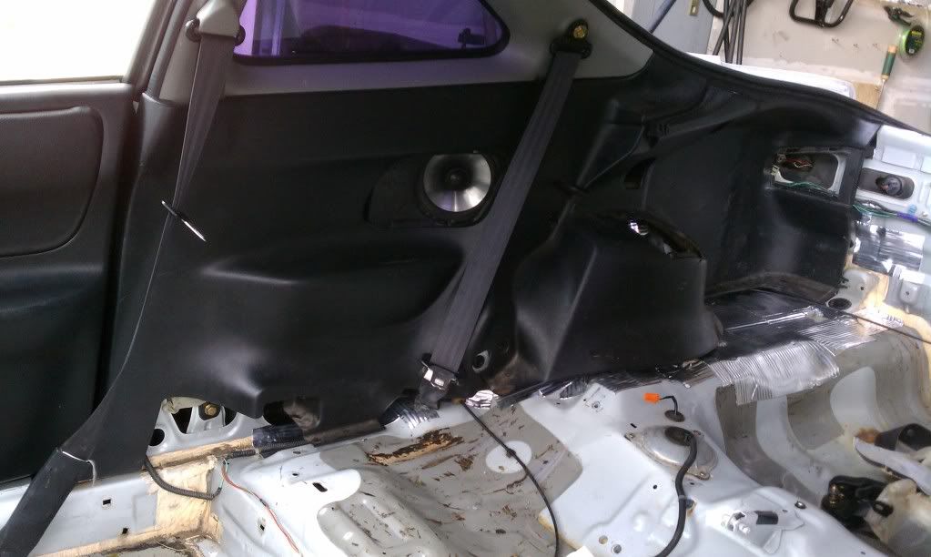

Also finished the sound deadning on the passenger side 1/4 panel
Then installed the seatbelts, and rear plastic

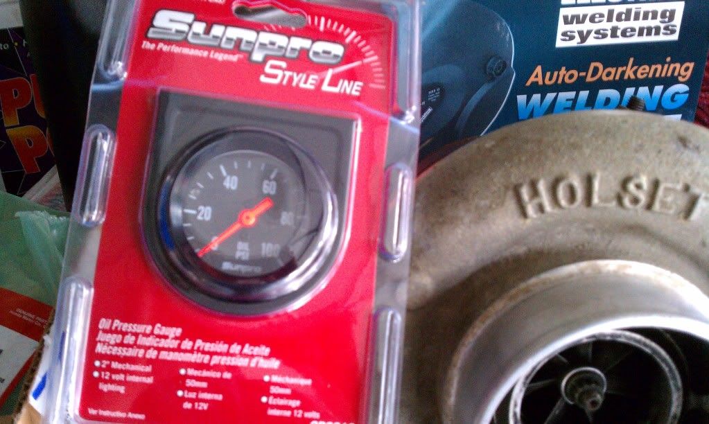

And my oil pressure gauge showed up in the mail

Now I just got to figure out how to make the lower seat out of a 01 integra fit in a 94. The clips dont line up at all.

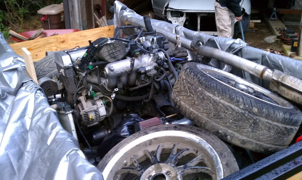

Plan for this weekend is to pull the motor/trans out of the donor and and try and get it in my shell by next weekend. We will see.

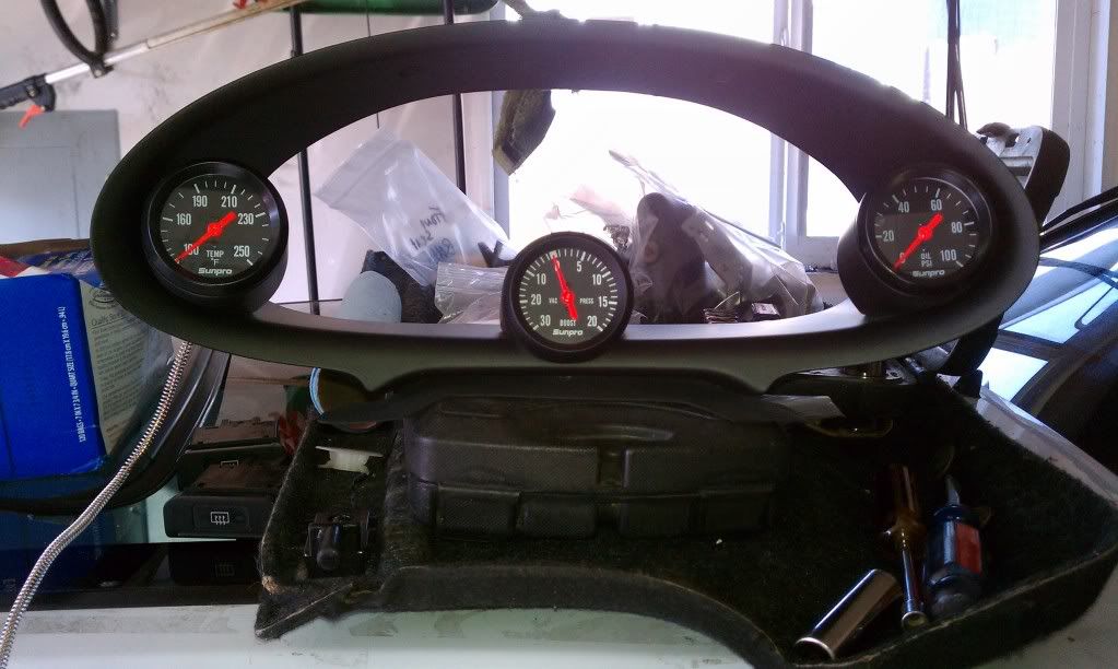

Got my gauge pod yesterday. So I put my gauges in to see how it fit. Got it from www.quad-pod.com I must say its real nice. It doesn't obstruct my view of stock gauges at all.

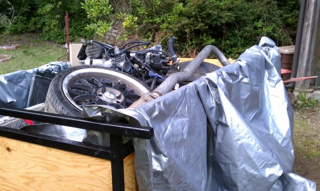

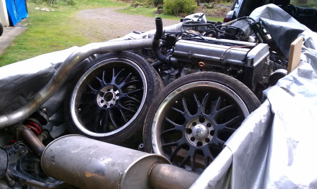

Well got a bunch oh shit today off the donor. Not much left to the donor now.
Now I got a bunch of work to do!!

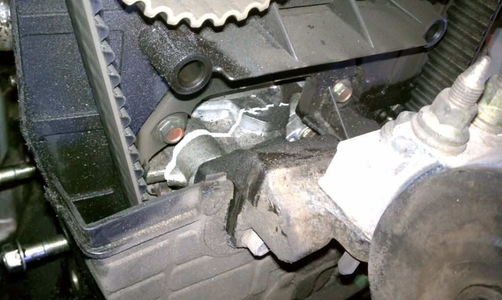

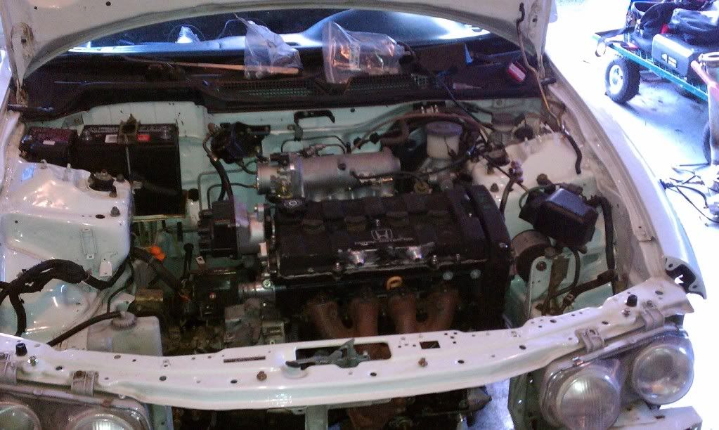

Little bit of a problem with the donor motor.....
I could but I don't give a fuck enough to care. So as I was getting easy to slide that mount in an tighten the last mount down I grabbed it and it wiggled all over the place, so I said fuck it pulled the whole thing out. Sat and pondered a second and decided I would mess with it later. Pull the trans off grabbed my built ls off the stand, yarded the turbo mani and turbo off (my to4e needs a rebuild real bad) I threw it in the car.
So I just have to order up some parts. Hope everything gets here in time. I need my obd2-1 jumper harness to show up so I can drive it without throwing a bunch of cels for not having the obd2 shit on there.

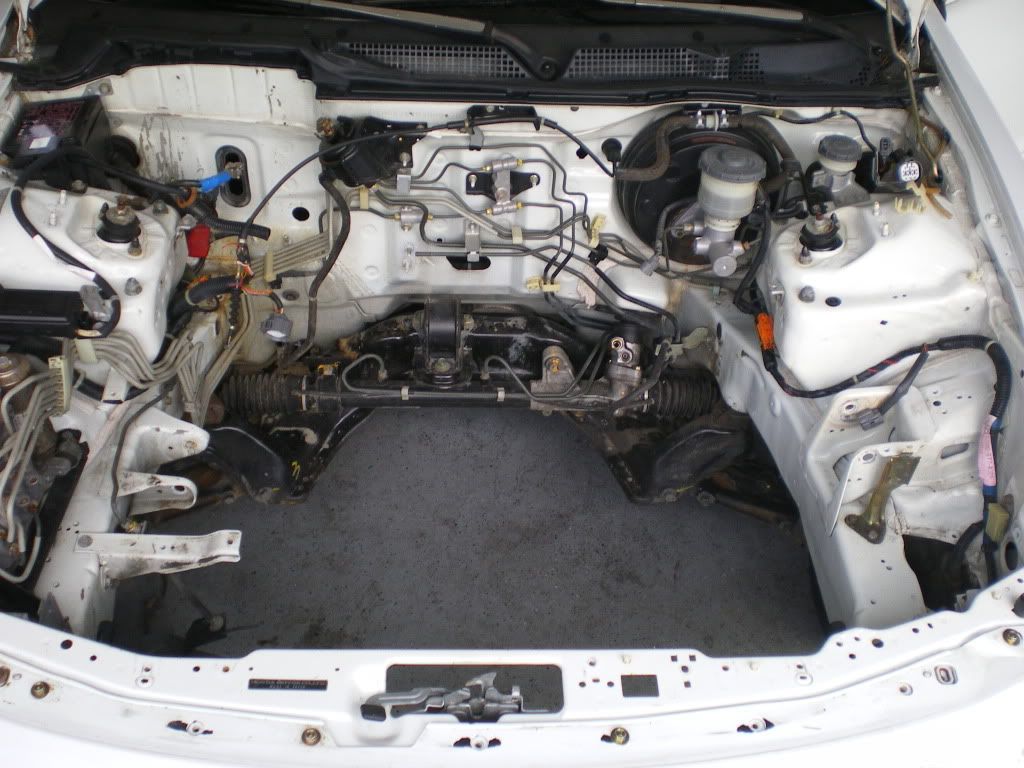

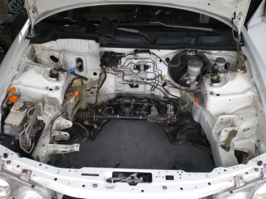

Pulled oil pan that had my return line for my turbo and catch can and replaced with a oem pan. Than pulled valve cove and put the stock obd2 valve cover on. While I had it off I pulled the delta cams and put stock cams back in. Also did a valve adjustment. Swapped out my obd1 dizzy for a obd2 dizzy. Swapped out obd1 alternator for obd2 alternator. Bolted up power steering pump and reservoir.
So tomorrow, Im gona swap out iacv, injectors, fuel tank, bolt up shift linkage, finish up power steering shit, and bleed brakes. So much little shit left to do its not even funny. I wish it didnt take so fucking long for Delray Acura - Online Acura Parts Store sto ship shit out. I need 1 little heater core hose and i dont know if it will be here in time for the dyno day. If not I might just bypass the heater core all together.
So I got a bunch of shit done today.
Bleed brakes, swapped crank pully, put belts on, finished boating down power steering shit, put engine wiring harness on, replaced map sensor plug, put Cai on, put exhaust on. Had to mod up my test pipe....lol this about the 5th project its been on...lol FLUXCORE BITCH!
Got a bunch more stuff to do. Hope to knock out some more work on the weekend.

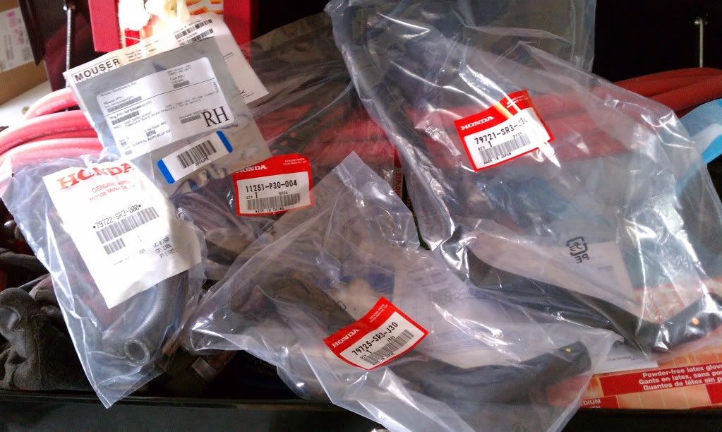

Got all my new coolent hoses in the mail today from acura. Also got my 4bar that I'm gona put in a stock map sensor case.
Put on all the coolent hoses to the heater core and dropped in the radiator in and bolted it down. Also bolted in my pimpin test pipe. Only 1 hose to put on now. From my iacv to the water pump pipe. Also set up a appointment to have my new windshield put in on Tuesday. Getting kinda excited to fire it up. Hope my obd2-1 Ecu harness showed up soon. Also got to borrow some wheels to drive on. We will c how much I can get done this weekend.

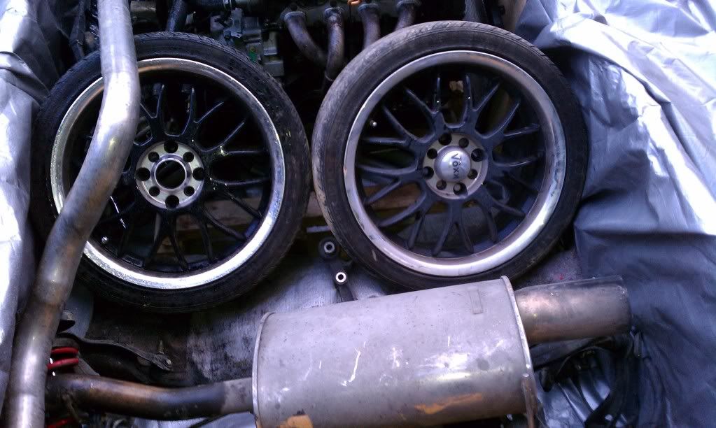

Well jumper harness showed up today from Hong Kong. looks good. Also got some 200se se-r wheels to use until I pick up some o wheels of my own. So now its time to get to work!

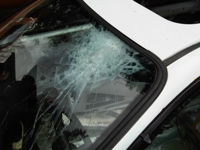

Well got a new windshield today. $240 bucks later... Fuckers.

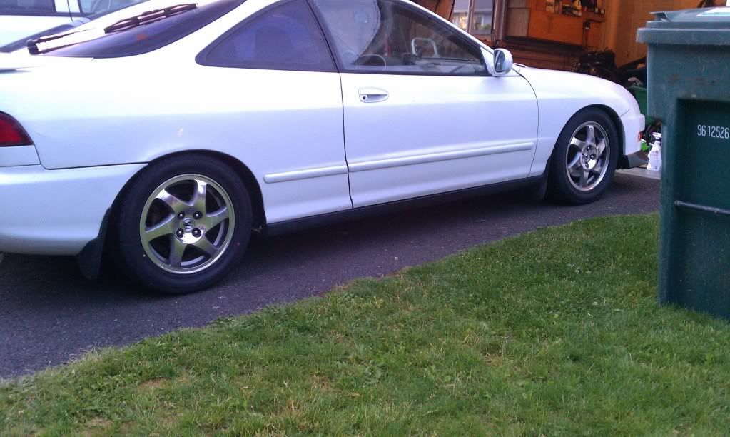

The 200sx ser wheels dont look half bad on the car either. I need to lower the car. Dont know if I will get time to put my coilovers on b4 the weekend, but as long as all goes well I will be driving this whore to the dyno day.

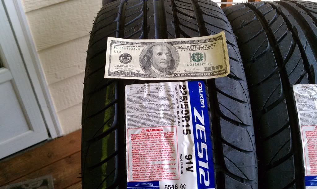

Got home today and guess what was on the front porch.....
THats right..... 225/50-15 :)

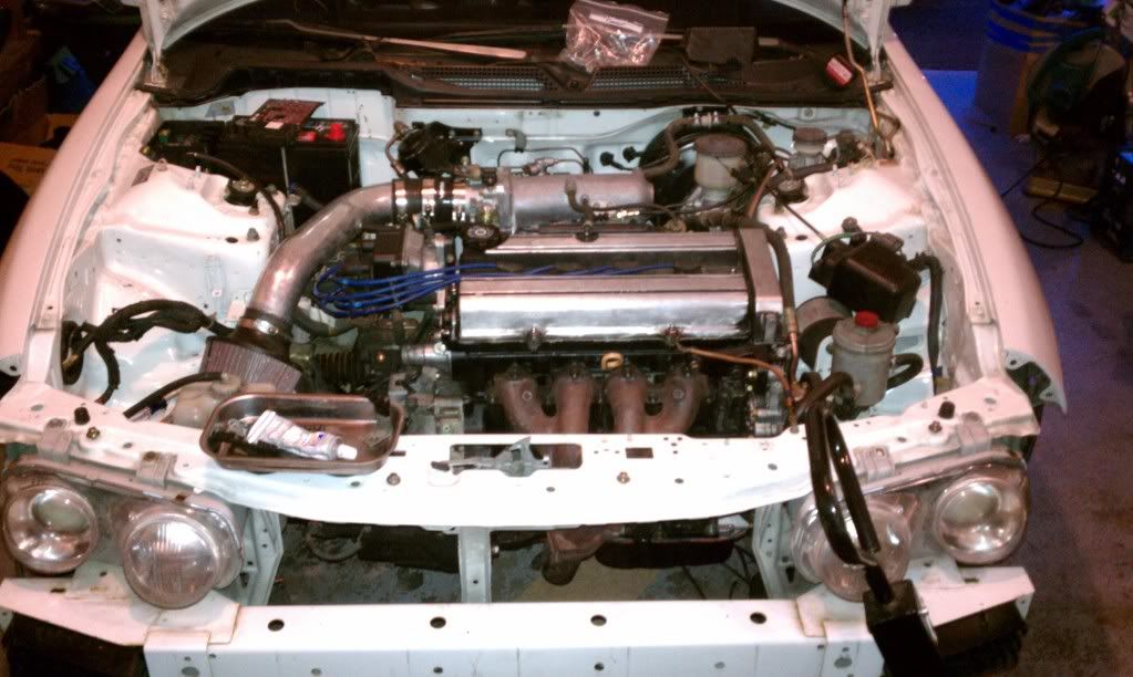

Well I now have the type r head on. Used the speedfactory lsvtec kit. And its weeping oil from the corner of the head where the dowel pins are, I think. I have to clean it up and make sure its not coming from the valve cover, But I have a feeling I will be pulling the head and grinding the dowels down a little bit. Got a basemap from the nog leed and this car runs pretty good. Other than slapping the head on, II haven't touched this car in months. Garage is a fucking wreck. Its full of my sisterinlaws stuff. Im storing it for her for the next few weeks whiles shes in between houses. Once her stuff is out of there Im doing a dump run. Its time to get both of my cars back into the garage for the winter nights. Once all her stuff is out I can start slapping the turbo stuff on my car and get it ready for some nog setting boost!
So thats where im at now.

Man, those tires are dirty cheap. Once I slap the turbo on I don't think I will be able to get traction with any tires. Unless its a dr. With that being said. Running dr on the street for a daily isn't the best idea. And i know that the 512s do great in the snow. And I don't feel bad about burning them up.
