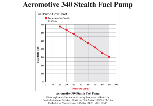

Friend installed 2 340's to replace 2 255 then relized his car was going super lean, rewired the 2 340's and car still went lean. Rip out the 340's and through the 255's back in, issue gone.
255>340....... :?:
Re: Fuel lines
« Reply #16 on: December 19, 2011, 01:29:13 PM »
What dont you like about them. Please tell us. I was thinking about ordering some stuff from them. I got most of my fuel stuff from BR Fittings. Injectors from Tom. Want to redo the whole setup. Thinking about selling the 044 with bracket and fittings, and the TRE 255hp fuel pump(xenocrons). Then do a twin intank 300, 340, or 400.
I would stay away form the 340's, i have already killed one in my car and we have seen 1 die in a customers car for NO apparent reason at all... Twin 255's in parallel setup get pretty damn far and are cheaper than everything else...
255>340....... :?:
Comparing the charts:
Never used the 340 yet but I have 2 cdm 255lph HP sames as the ones Xeno sells and have good flow.
So good that the stock fprs get ruined and my fuel pressure goes past 200psi.  :noel:
But I also have a boost-a-pump digital box to keep the voltage to my pump 15v all the time and bump up to 22v under boost if I want.
