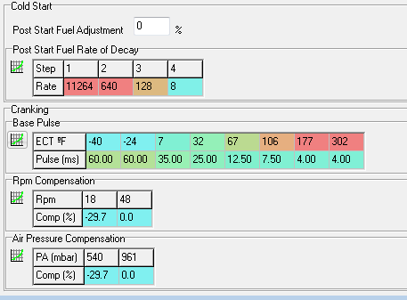

now there is some cranking features that have pulse with that i have not messed with. since you are saying about 1.8ms where do you have this? this is what is in hondatas
so t_cel_t are you suggesting i lower the numbers (pulse ms) in the base pulse table to about 4 (like in 177 degree cell)?

« Reply #16 on: January 04, 2012, 07:38:30 PM »
Injectors are RC 550's and cams are Crower 2 3/4 cams.
as far as plugs they are at stock gap .044 and the plugs look great (tuning the E85 is fine just having problems getting started). I will have him gap them down.
as far as the coil i will have him take it apart and send me photos to see if its burnt.
im pretty sure thats what you need to change, not sure if up or down but around 4ms is a good starting point.

gapped down to .035 and no work +-30 and 60 nothing.
as far as the table i tried 2ms 4ms 10ms and still no start.
going to try .030 gap now. some more info form him it will not start cold or after fully warm. after running letting it cool down about 20min it will start on its own???
