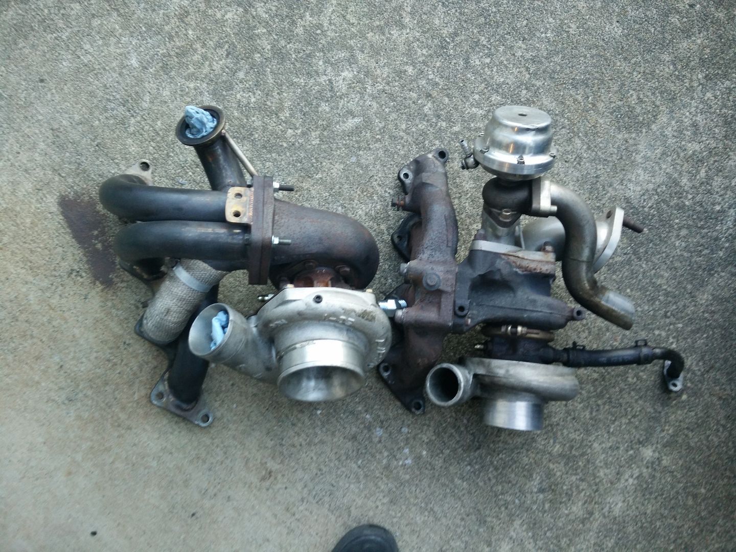

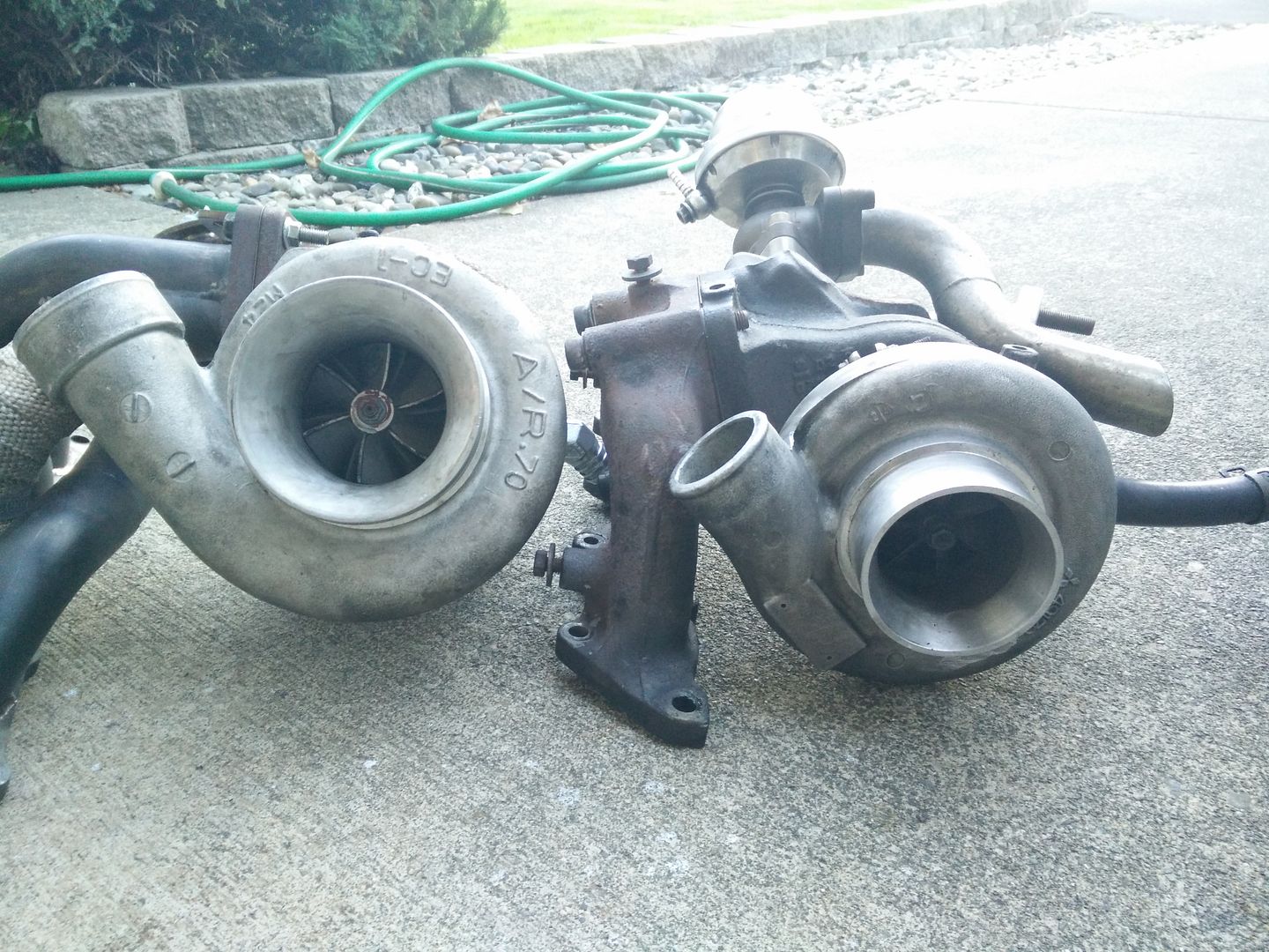

figured a couple comparo shots would be cool.

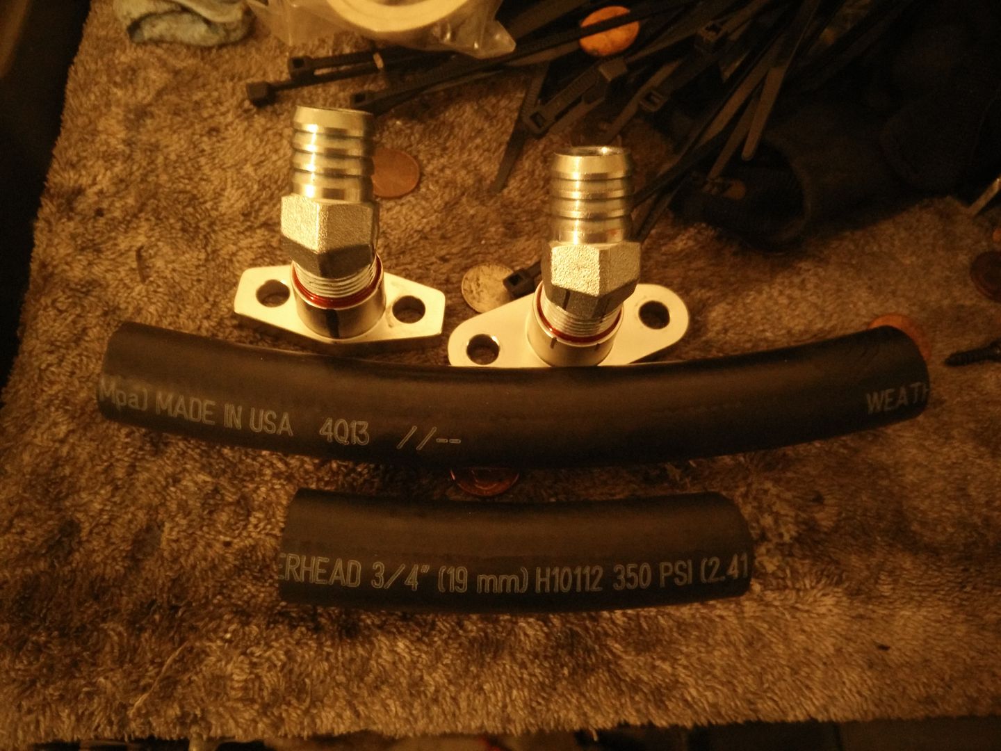

oil line was bothering me. mainly because i need one and need to figure it out. the turbo oil drain is SUPER close to the front motor mount. like the AN fitting that was on there would hit when test fitting. thought after putting my new shit on i was screwed and was going to have a crazy S shaped drain, but came out nice and straight i think, glad i went with 2 90's.
no shot on the car. maybe ill remember later. but this is the drain parts. i got this hose at Napa. i have used it before on the CRX with the 14b, and the oil FP Red that just came off the Galant. seems to work great, so ill use it again.
short piece is to show the part number if anyone else wants to find it.

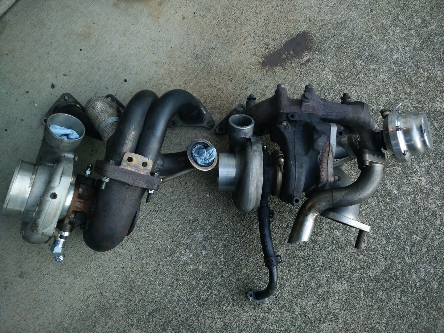

Is the turbo mounted to a standard header with a wg?
That looks so clean  :noel:
nope. that's a Magnus T4 turbo manifold. they made a hand full of them I guess. I have seen a couple come up here and there.

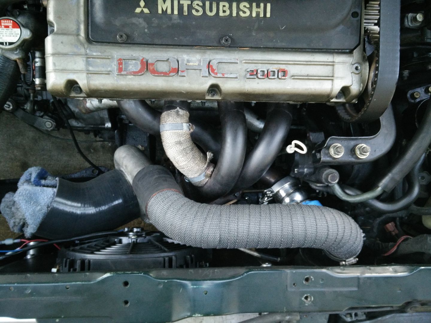

ok. so i guess i only get about an hour of light when i get home now. but thats ok really, as i have a bunch of small tasks to do, rather than large ones.
i finished off the wiring on the new radiator setup yesterday. just had to swap and lengthen connectors. zip tie everything in its place. etc. i should throw the grill back in and decide on weather the radiator needs painted or not... other than paint i think its 100% squared away.

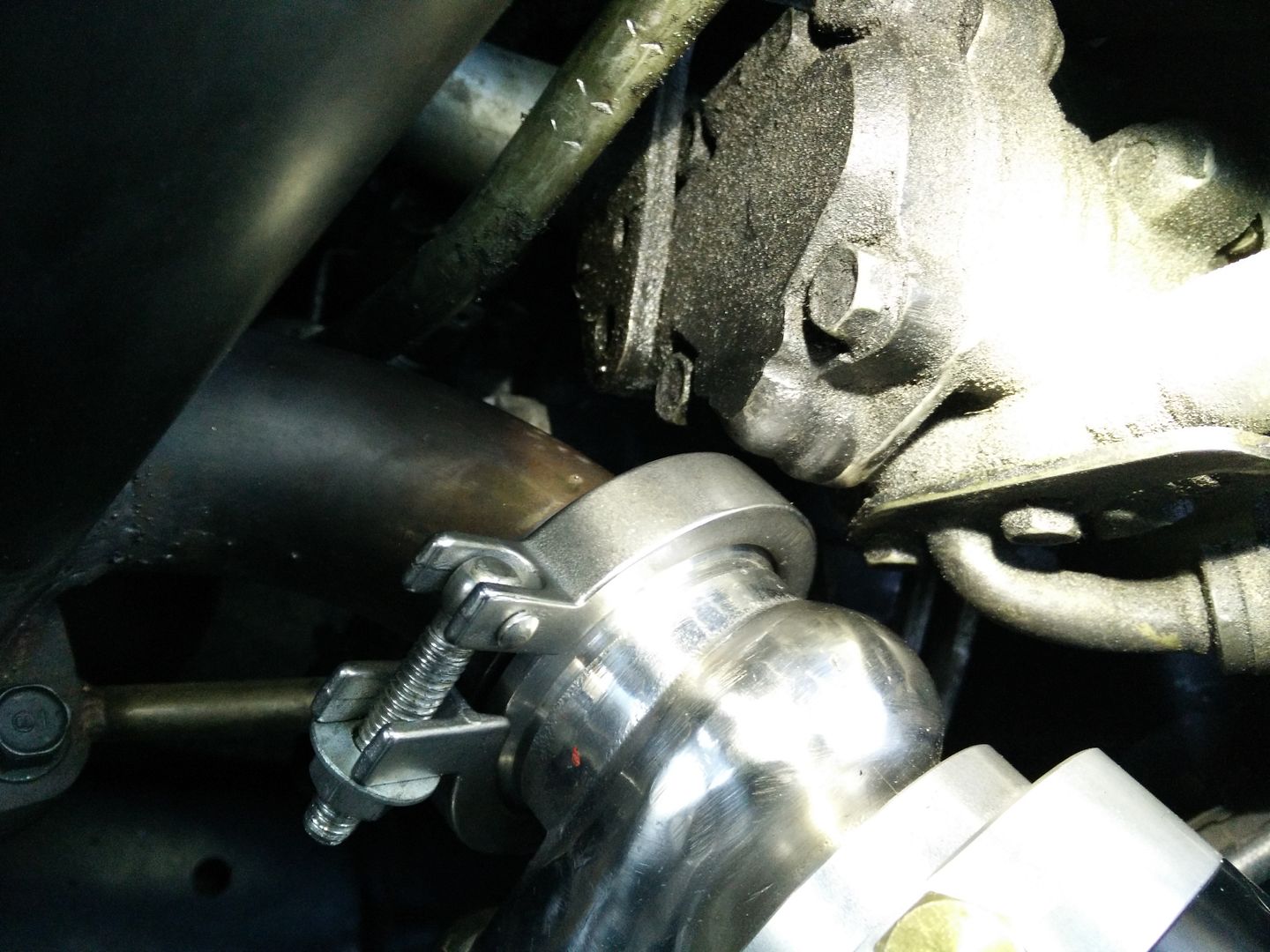

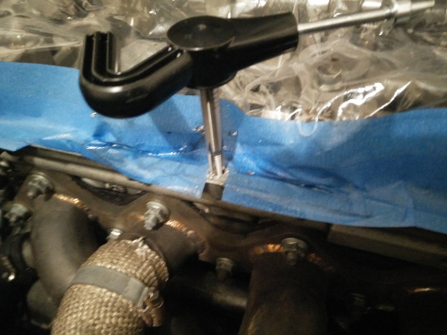

dipstick its wastegate elbow, and wastegate clamp hits power steering pump:
dipstick was easy. if you have never done one slide a 12-17mm wrench down the tube, then push/lean on it. careful not to pinch the top too much. a little bit will hold the dipstick in if there is some backpressure  ;)
power steering:
its oh so close, but way far away now. lol. i just went to the autoparts store in search of shorter belt. grabbed a couple, but it looks like i settled on the belt they listed...mine must be stretched, or labeled wrong, not oem. alternator belt is though.
with those huge victories i went inside and called it a night....

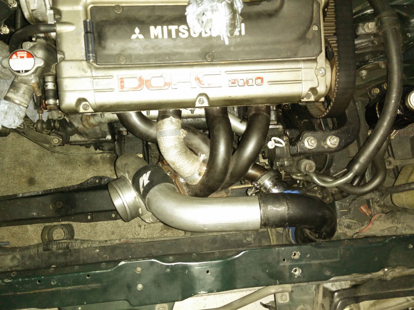

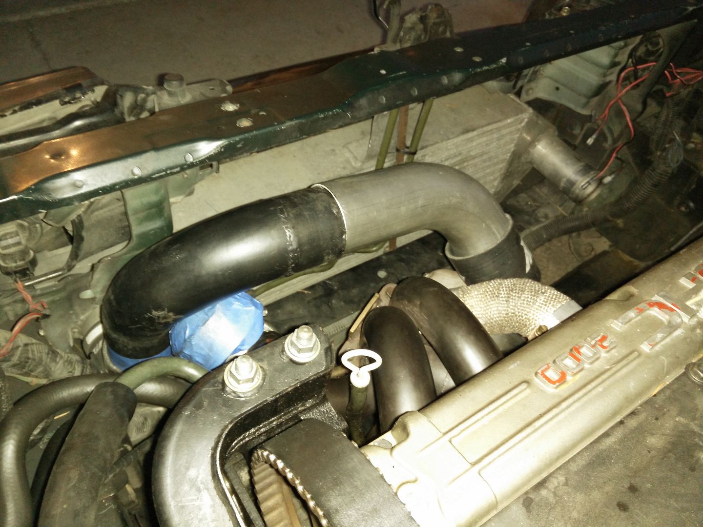

.... ok i was on a roll. so took a pie cut out of the dumptube and it looks like it will clear the crossmember and point right at the downpipe. works for me. didnt want it pointing at the wiring harness, or the oil filter, or sure as hell not the alternator, or the oil drain.... maybe ill wrap the oil drain in aluminum foil or something??
chop saw was out, and if im pissing off the neighbors i might as well drop a couple more cuts.
cool part about this is obviously half of it is the previous chargepipe. and this came out of my scrap bin. and it actually eliminates a 2.5" straight coupler i had in there before (going to weld the two together) and i can now use that on the turbo as it went from 2" to 2.5"  :Jew:
i will most likely be header wrapping that pipe. it got hot as shit before with the Red on there, and i wanted to wrap it then too.

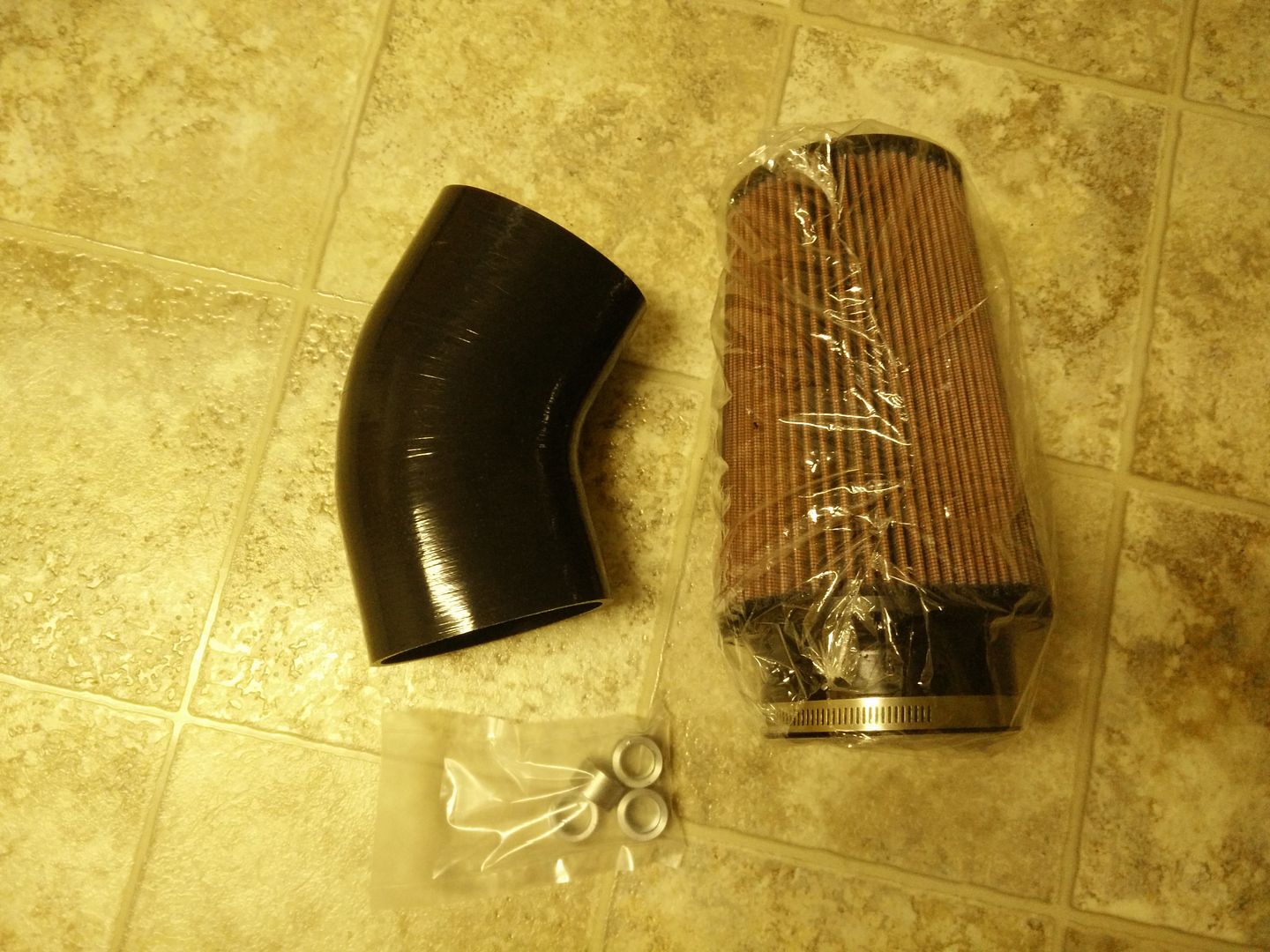

note, order some shit:
4" K&N
4" 45* coupler
O2 bungs
header wrap
For o2 bugs just go to autoparts store, go to help section and get some spark plug anti-foulers. Cut them in half and done. 2 come in a package for about $3.99
way too much work.  ::)  good quick tip though.... might be a little to  O0 for this project. lol.
i like the standard round O2 bungs. found a couple 4-5packs on ebay. think im going to buy one of them. nice to have on hand. and for little more than the price of one at shop down the street.
i did find some rounded off ones that sit nice and flat on exhaust pipe, but not feeling like that big of a spender. i have used a stepped one before too. was nice. makes sure the hole is big enough for the bigger wideband o2. i have used a nut also, hated that. modifying something thats just a simple part for cheap seems dumb to me.
besides i need to order header wrap. cant put it on the downpipe till i get the o2 in. and not putting the turbo in for final until all that is done... project isnt waiting on an o2, its waiting on me to not want a incomplete project  ::)

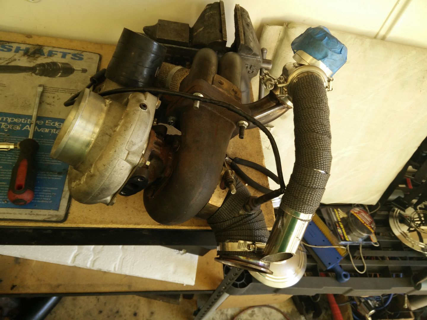

couple parts. got some header wrap too, but it showed up late cuz the seller was an asshat and mislabeled the shipping they use. actually same with the O2 bungs.  :evil:

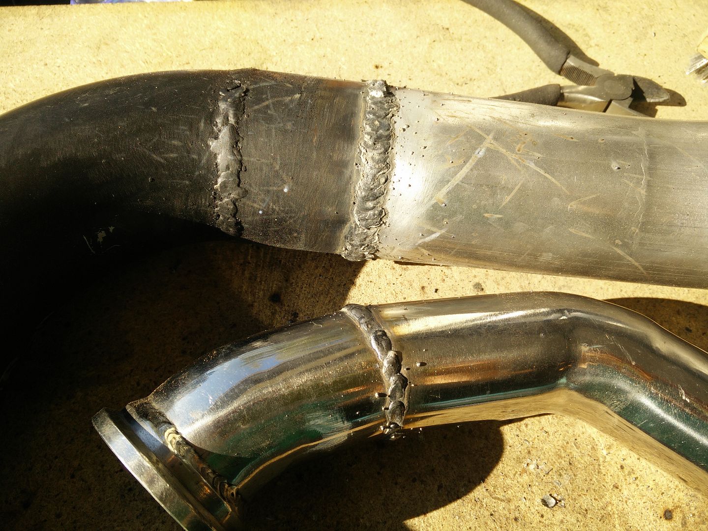

anyway. i got to work even though i was missing my header wrap.
figured i would start with welding some stuff
still using my flux core. feel im actually good at it.

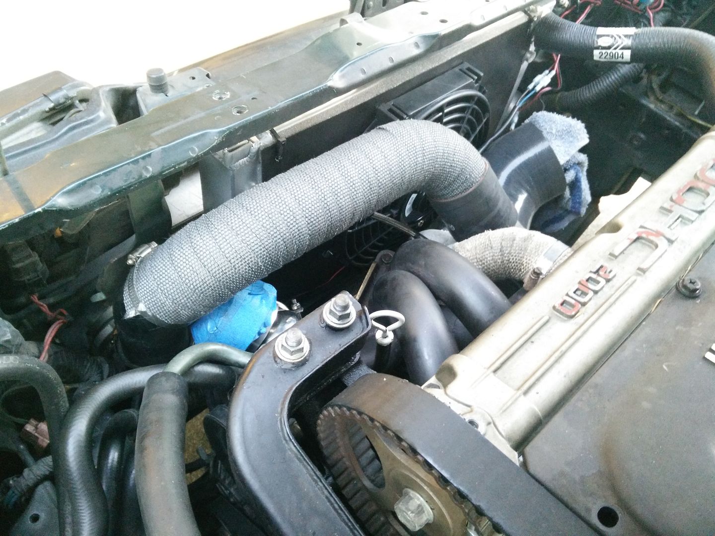

while staring at my completed master pieces, and being pissed about my header wrap i actually went and checked my mail...
super excited about this piece. sometimes its the small things.
i just have put my welder away like 3 times today. welded up pipes, then put away. shit, O2... shit, i need to bead the end of my pipes...  ::)

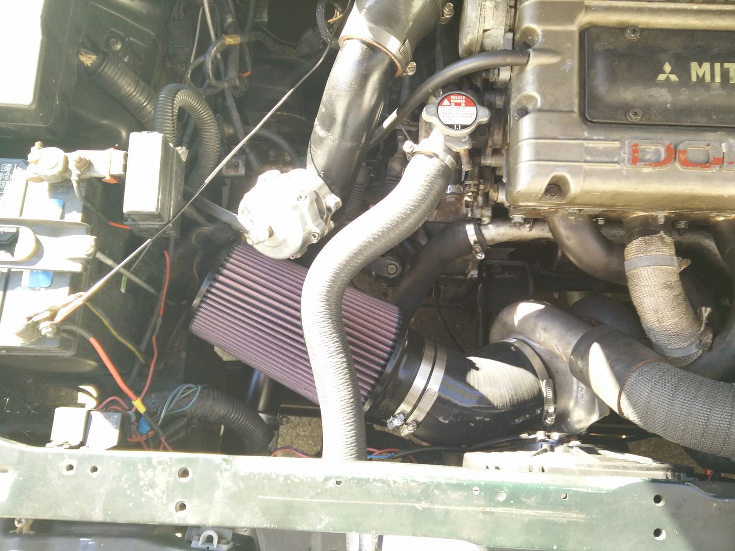

did some test fitting of this giant ass K&N filter. yeah. i had to modify my upper pipe to move the bov towards the throttle body some, give it a turn, etc. i think i have barely enough room now.
no pics of that because i forgot about it after i hung it up to dry after repainting...
my list of things to do is really getting small i do think.... i think because i didnt actually make a list like i should have... ::)
i do need a small ass chunk of 4" pipe to connect filter to coupler elbow. any ideas to locally acquire something like this?

i found the piece i needed. and it had a fuckin divider in it i need to grind out. also got my clamps.1
funny. that looks all nice and good right? it actually fit all together better on the final assembly than it did on my test fits, but thats a win i will take as it doesnt seem to ever work out like that.

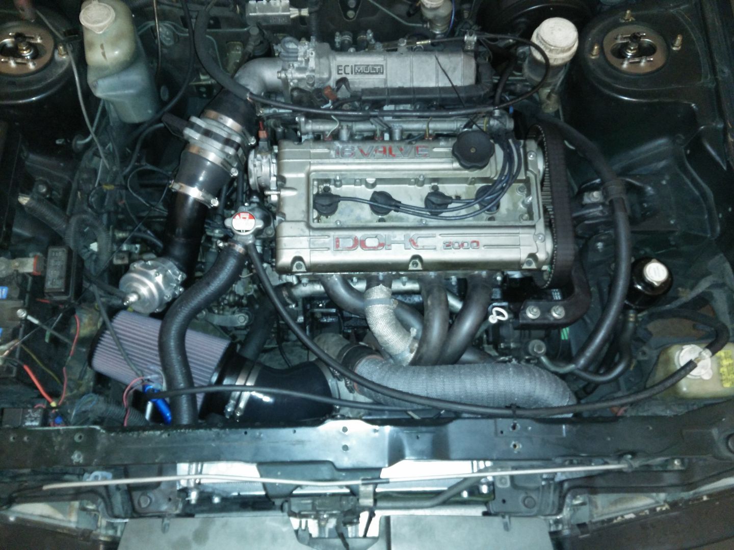

current 'finished' pic...
still more work to be done.

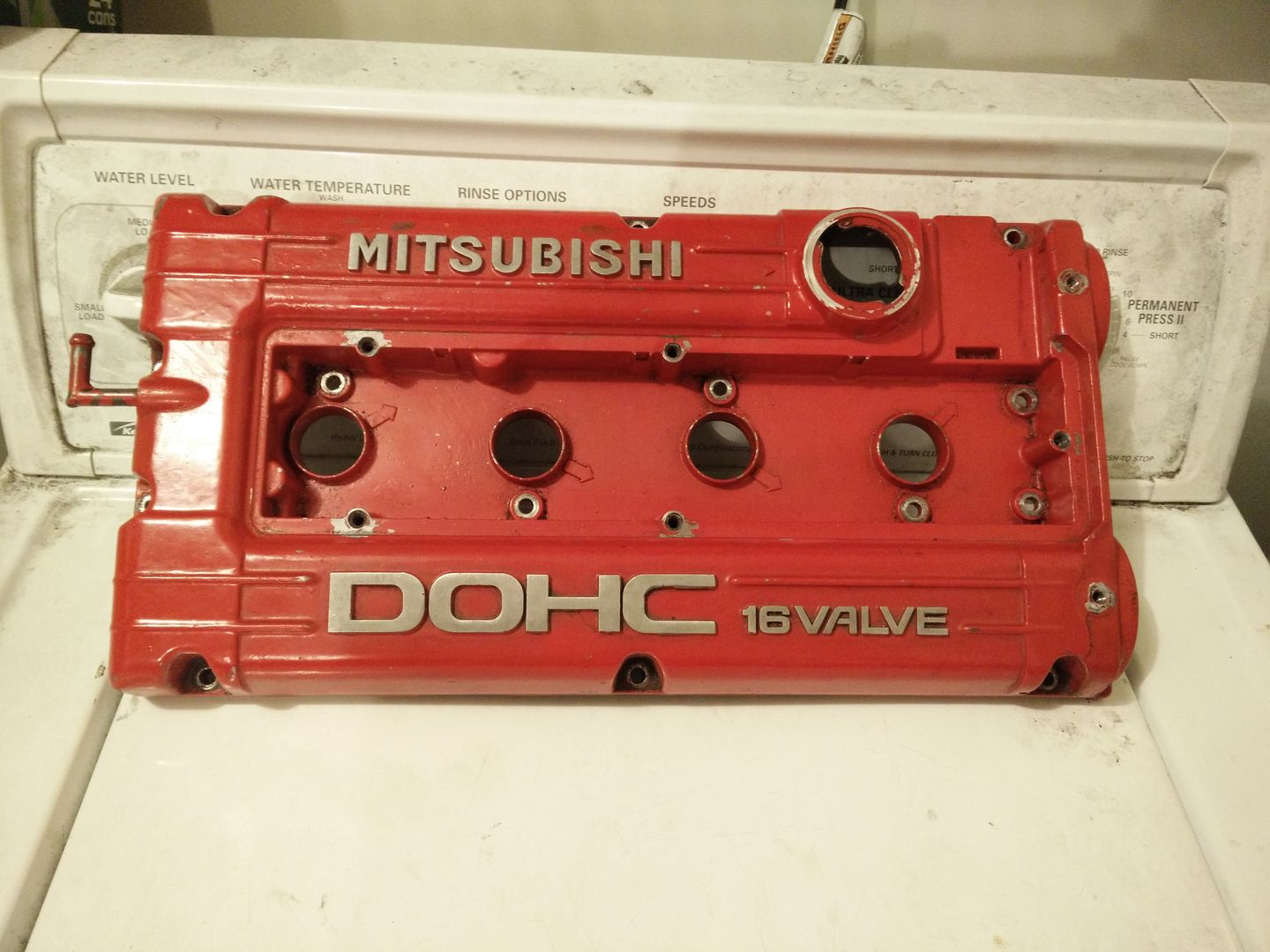

good time to replace that valve cover right? well i cant ever make up my mind on, well most anything. so it showed up last minute of course.
got this off the galantvr4.org forum. i hate the color red. so its not going on yet. but i like this cover. no cracks it seems (common problem from people over torquing) or broken cover bolt holes. i like the Mitsubishi/DOHC/16valve. vs the DOHC/2000 DSM cover on my engine (engine in my car when i got it was out of a 91 Laser), my engine isnt even a 2000cc, its a 2.4 now.
anyway, i want to put this cover threw the parts washer at work, strip the paint, and repaint it... just not sure what color i want. im thinking gloss black?

I went to the store last night and got some paint stripper cuz mine was missing and grabbed some gloss black engine paint... started stripping it last night.
Re: 1991 Galant VR-4....forged 2.4L, AWD, etc... the T4/T67 is on!!!
« Reply #239 on: November 02, 2015, 02:10:35 PM »
Gloss black, once it fully dries I would hit all the letters and raised areas with a file and then clear the whole thing.
