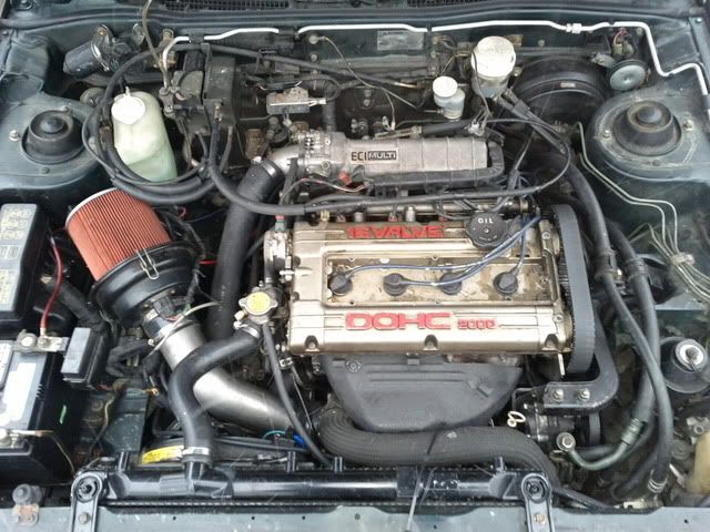

ok im sure if you have been in the chat you have heard me talk about it. well here it is...
1991 Mitsubishi Galant VR-4 #613/2000. for those that dont know, just 3000 of them 2000 in 91, another 1000 in 92. AWD, turbo, 4G63, 4WS, etc.... its like an EVO, before there where EVO's... (Mitsu wanted to rally, so they made the Galant AWD, then used the Lancer Evolution after)... its NOT a DSM. DSM refers to Eclipse/Laser/Talon clusterfuck with Chrysler cuz they couldnt build shit on there own. this is all Mitsubishi.
it has a 6 bolt 4g63 (non-crankwalk), and a 3 bolt rear (weaker)
mods so far:
removed emissions
EVOIII manifold   (with new EVO3 turbo gasket, new EVO8 manifold gasket)
FP Red turbo (ported)
Tial 38mm WG   (open dump)
some baller ceramic o2 housing    (forgot from where)
3" china downpipe
'turbohf' 3" exhaust
Magnaflow muffler (12219)
1g valve
'turbohf' 3" intake
K&N 3" filter
PLX M300 wideband
ACT 2600   clutch
Fidanza flywheel
1g shift boot
'turbohf' shifter
Skunk2 10th Anniversary knob
shit i have, and need to install:
MAF Translator   (what i will be "tuning" this with for now)
3" GM MAF
680cc injectors
Denso/Supra pump (rewired)
IndyRacecore/Spearco 2-216 intercooler
'turbohf' chargepipes
RacingHart Type-C2 wheels
shit i still want:
everything else LOL...
4bolt rear
forged 2.4L
real tuning shit (evo8 ecu? or ecmlink?)
EVO8/9 MR/SE seats
lower this tank on some EVO suspension or coilovers
MOMO steering wheel
E85 w/HiProfile injectors

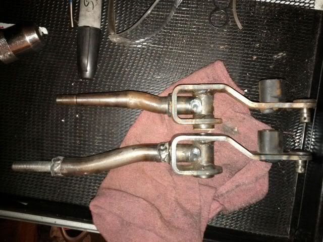

^gay ass stock intake arm... mine was way simpler of a setup.
^weak ass 1g shorter shifter everyone puts in these things SUCKS, so i hacked up the Galant one. for what i call the perfect height (stock Galant was about 1.5inch taller than mine), bent towards me (instead of the stock away) and now uses a 10x1.5 knob (like a Honda)... its cleaned up and black now.

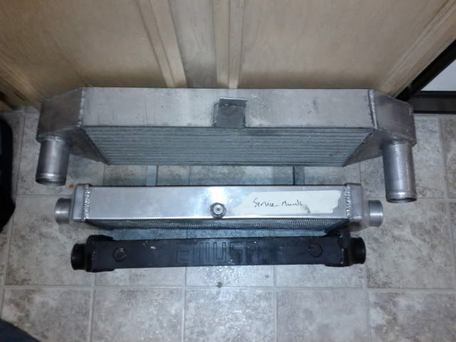

Intercooler?
Re: turbohf ~ new daily/project... 1991 Galant VR-4...
« Reply #5 on: January 16, 2012, 08:22:40 PM »
feck I'm blind
« Reply #6 on: January 16, 2012, 08:28:32 PM »
Intercooler?
it has a fmic stock... if you wanna call it that. its like a mk3 supra one, but 1/2 the size. looks like an oil cooler LOL...
its cold as ballz outside, and snowing. also missing a BOV flange, and at least 1 coupler i need. shits backordered/lazy to find one. so i should get that shit figured out in the next week or 2, and fabbed/installed. ill go out an take a pic of this thing tho. ballin.
« Reply #7 on: January 16, 2012, 08:32:35 PM »
I have two of those old Supra intercoolers if ya want one.  :noel:
« Reply #8 on: January 16, 2012, 08:55:15 PM »
ok... 3 intercoolers.
IndyRaceCore/Spearco 2-216
idk intercooler that was on my 400whp B16A screamer
EMUSA chinacooler off the ITR/CRX (300whp)
2-216 core measures: 24x10.5x3.5  :o

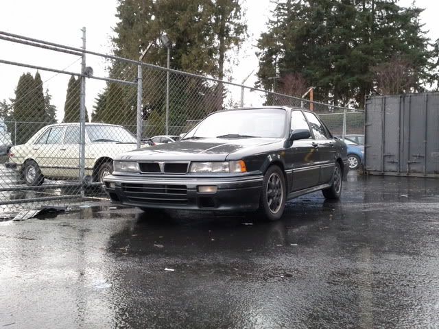

ok. its gonna need some bigger tires forsure. and lowered 3inches.... fuck. im broke. spent all my money...
theidealone
  • Posts: 670
« Reply #20 on: January 29, 2012, 08:26:54 PM »
Those look sick! Thank you for not painting them yet. LOL. Just needs a drop, and youre good to go.
« Reply #21 on: January 29, 2012, 08:32:38 PM »
ehh, still not my style. but it does look good aside from the  :mexi:  status. watching CL right now. think i found some 225-45-17 bridgestones for 150bucks used, 7-8/32... for the 4... the tires on the wheels are minty fresh 205-40-17s... just too small. little shorter than the stock wheels/tires (195-60-15). would be nice to have tire little larger, and definitely wider.
« Reply #22 on: January 30, 2012, 12:49:48 AM »
Those look pretty good. Needs more sidewall and a drop!
« Reply #23 on: January 30, 2012, 12:56:22 AM »
working on the drop. i grabbed that stock EVO IX suspension from my buddy. really looks like it has 57miles on it too lol. now just needs to not rain tomorrow, then i can cut it up.

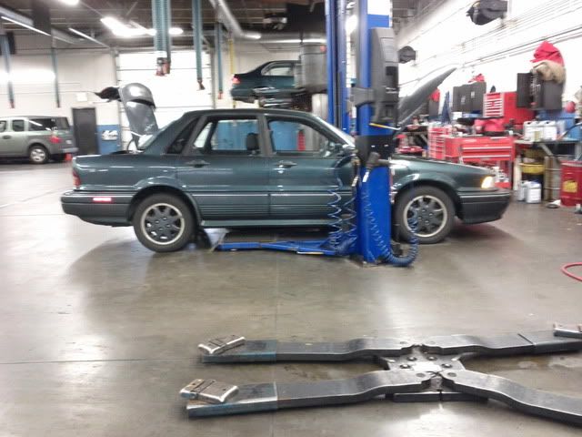

so i got a promotion of sorts at work, and i work mon-fri now. so i was able to sneak my car in the shop at work today lol. did the suspension. the guys on the GVR4 forum have done this many times. im using 57mile '06 EVO IX GSR stock suspension. i cut about 1.5 coils off the front. swapped the Galant top hats to the front. the rear i cut the stock bushing off the Galant shock, and welded it to the EVO shock... RHMT yo!  it rides nice and stiff...kinda like an EVO  ::)
pics:
mid process, just the fronts
pulled it out back to get a decent pic.
i had one of the guys there help me align it real quick. he sets it up then goes "YES!... i dont have to align the rear!" lol. referring to the AWS setup.
got like -.5-.7 camber on the fronts i think. dont recall the rears. drives nice tho. needed aligned even at stock height really.
yes, i realize i could probably use a coil cut out the rear also. but i was running low on time, didnt feel like fuckin with it anymore...
thats all for today. i might work on some fuel/tuning/intercooler shit tomorrow... might. its probably going to rain, then ill bitch out... unless i can push the CRX far enough forward in the garage to sneak the bumper inside?... mmm...
