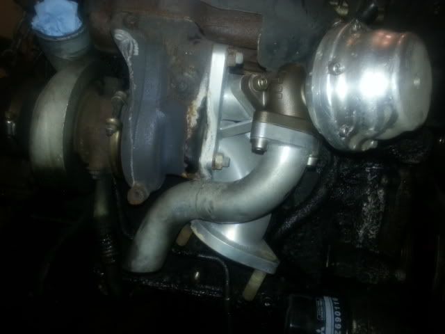

it will be powered by the same turbo as before. which i originally bought cuz i wanted a 2.4...
Forced Performance "RED" turbo...its like a 60-1 compressor, TD06h center section, TD07 ported turbine... idk, something like that. i forget the MHI names. along with that baller coated O2 housing that i cant remember who makes, with TiAL 38mm wastegate vented to atmosphere. turbo manifold is an EVOIII unit w/OEM shield.

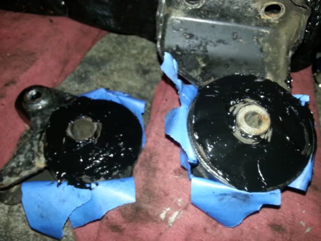

3M WINDO-WELD motor mounts...cuz this is RHMT still. O0
also. i think this may be a first, at least for me, but i used this shit on my windshield lol. trying to stick down the OEM trim that wont stay down.

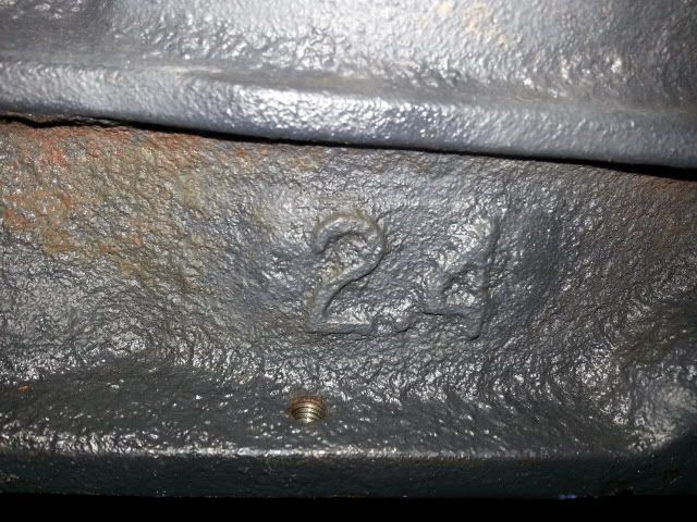

so today i actually picked up my motor.  ;DDD
sorry no pics of the engine on the passenger floor of my CRX...but it was there riding shotgun, lol.

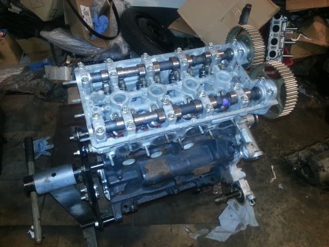

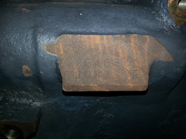

Hyundai G4CS
big block 2.4L  8)
i took pics of the engine internals, uploaded them....then realized i already posted them lol... so yeah, still look the same.

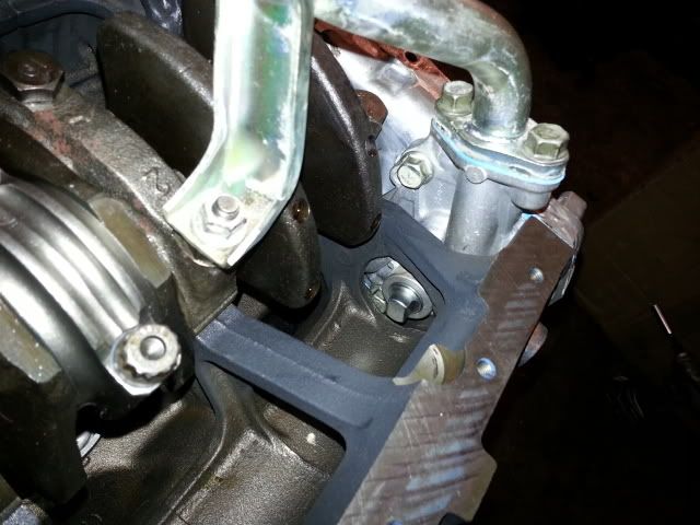

balance shafts deleted. :-*  install this handly little OEM gear stub in the pump, put some BS bearings in wrong (or special delete ones with no oil holes) and rail a freeze plug on the other side to cover the hole from the other shaft.
forgot the ARP headstud w/headgasket installed right before head goes on pic. so classic. oh well.

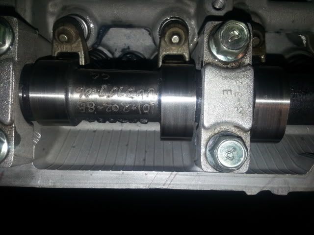

bled all the lifters, thew them in with rockers, and new cams, seals, 2.4 cam gears.etc
oh yeah, those are the cams. FP2's. suppose to throw down little more power mid/top over the standard HKS 272/272 combo, and maybe loose some lowend. gonna be shitloads better than stock ones lol.

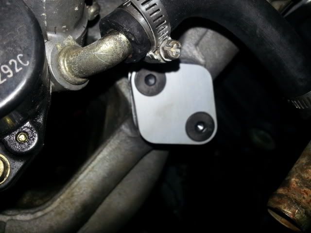

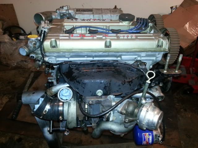

hardware store was closed, autoparts stores are fuckin garbage. gonna get some shit to delete extra sensors and coolant lines, and oil cooler...  idea is to get rid of shit that could cause issues, like leaking/breaking...
 :Jew:
Re: turbohf ~ 1991 Galant VR-4... motorless.....built motor soon.
« Reply #69 on: March 03, 2013, 02:28:44 PM »
good luck, its a dsm, so it will break and leak......... Oh, wait. Its a Hyundai, you'll be fine then.
« Reply #70 on: March 03, 2013, 07:52:36 PM »

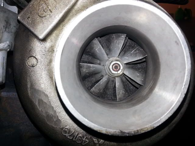

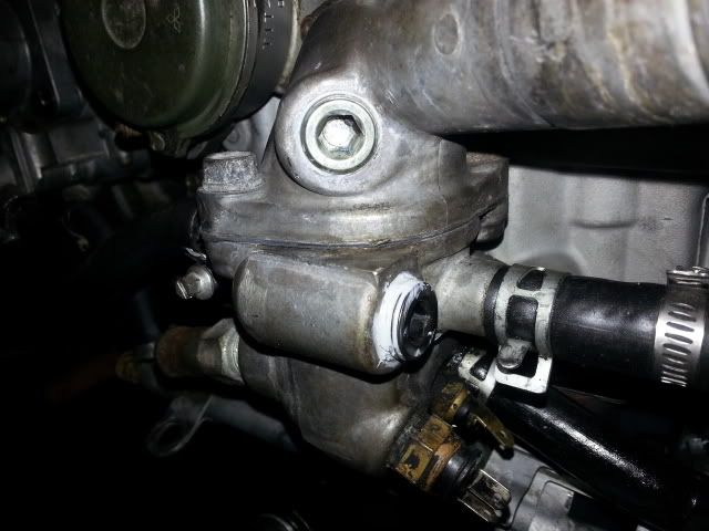

EGR and some misc coolant sensor/vacuum things. sometimes its the little things. also capped off one oil pressure switch thing on the oil filter, moved the other one. some of these are extra i think cuz the motor was not originally a Galant motor.
sure looks like a 60-1 wheel... you can see the FP stamp too.
pretty much set. needs oil pump primed, and a timing belt. that oil filter is for startup, have OEM Mitsu filter after a couple break in miles.

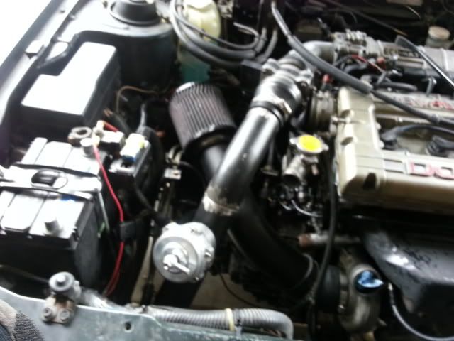

i started work on putting TiAL bov on in place of the 1g DSM valve.
buddy shows up, looks over everything. says thats odd, fucks around with it for a min or two. then grabs hammer and hits it.... well fuck, i was gonna do that ::)  works great, even better after some adjustments.
so yeah, tranny works!... so now i can put axles (with new boots), t-case (bitch), and....

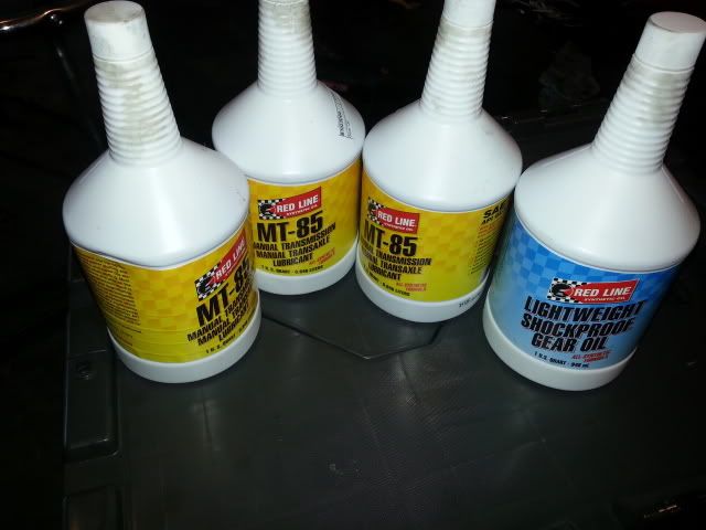

55dollars in oil into them... fuck. and to prove its gay, the MT85 is hot pink, and the shockproof its a nice turquoise? blueish color... ;)
in the dark blurry ass pic...
the TiAL all posted up ready for action.

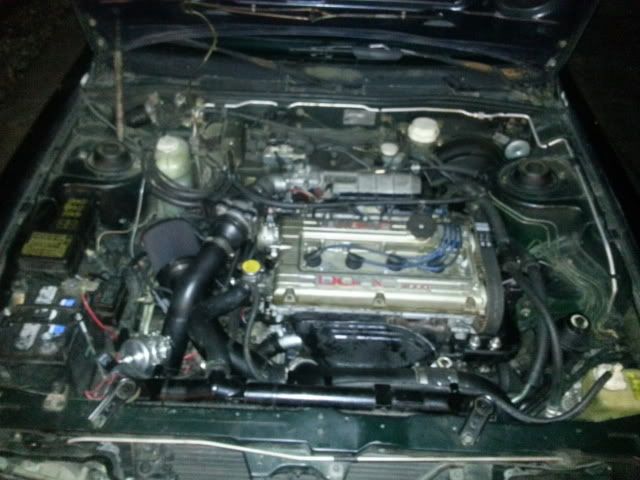

runs, drives, happy.
lifters where noisy as fuck for a while. didnt think one would shut up, finally did. fan wont turn on by its self. jumpers fine. i think i might have shorted out the switch? car runs super cool when moving. even with that HUGE ass intercooler, and the AC condenser taking up space. which btw seem to annoy my friends that came over, they kept pointing a laser thermometer at everything....seemed displeased. apparently her 2.4 is running 20-40* warmer than mine?
MAF-Translator thing is ragingly homosexual. needs DSMLink.

that picture was fallowed by a "start at 20psi"  from one of my friends. ::)

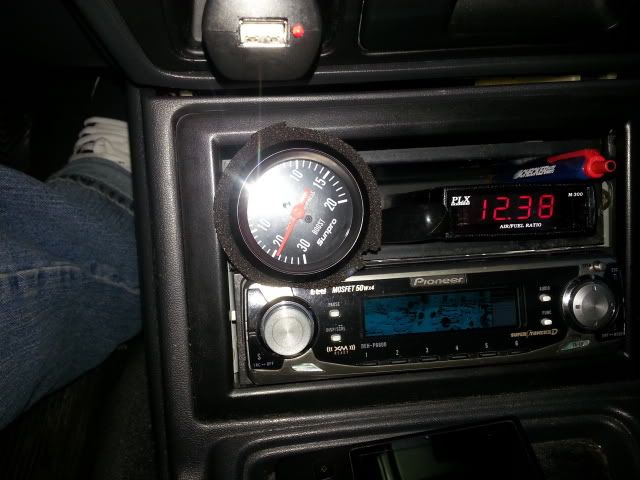

work for now to start dialing it in. looks like 8psi. and an assload of vacuum, didnt think with these cams and 175miles on the motor it would pull that much.
still need to find a legit spot to put a gauge, just kinda railed it in there. seems to work.
