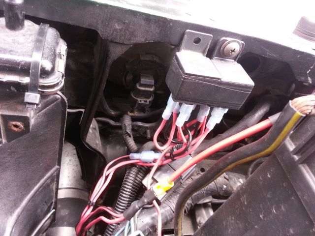

~fan sucked, and would start to get hot in traffic... so i had 1 china 12" fan mounted directly to the radiator. shit sucked. so i hacked up a OEM Civic shrouded fan (fit super nice), rewired/relayed/etc the whole setup. mounted the 12" to the front as a pusher. (ill post pics below)

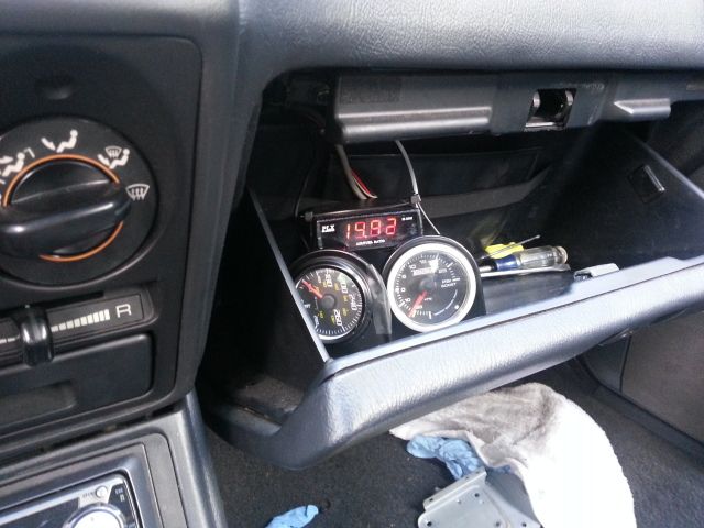

~gauges/radio.... so when i got the car the radio/console shit was all in a tote in the trunk. i assembled it but never really liked it. cut it a little for wideband install, threw a boost gauge in, threw a coolant gauge... just was looking shitty... scored a fresh (and different) OEM radio bezel from a 93 Galant. had a nice velvet/fuzzy pocket (cell phone friendly looking), and didnt look like shit.
moved all the gauges to the glove box, cuz i dont really like gauges, so i want them out of sight when not needed.

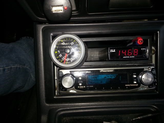

OLD PIC! only one i can really find. that boost gauge was garbage... anyway. had coolant gauge stacked next to boost gauge, then the wideband. all above the radio...  :-X :'(

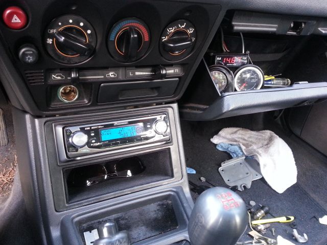

much better. (dont mind the mess on the floor, lot of junk from glove box, gonna vacuum/detail her soon)
little better view. had to set them back a little cuz they will hit when you try to close the glovebox  ::)  rotated the coolant for better view of numbers that matter to me.

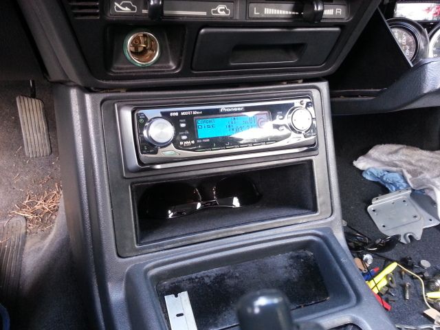

my Pioneer from like 06... might need replaced soon. but thats for another day...
tight fit.

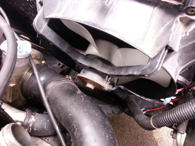

hard to see in the pic. but on your right side is the drivers fan (pusher) and the shitload of room i have between it and the giant ass Spearco intercooler.
new fan relays. system is independent/standalone of the car now.

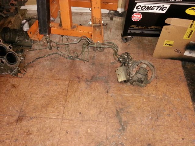

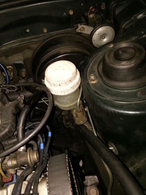

wow that pic sucks ass... ripped the ABS mod/pump/fucker and lines out.... now there wasnt actually a "problem" with this shit... just old circa 1991 ABS system.
pulled the AC pump out the back of there once the MC was out the way.
3G master cylinder. this one is bigger than the OEM. dont remember by how much. but was cheap. and mine was leaking...
forgot to take a pic of the brake lines... but i got both left and right front lines that go to the calipers. and 2 lines that do to the MC... oh and the proportioning valve.
total: $17.64 (lines/valve/DOT3) + way to much labor (i was in no hurry).... oh if you wanna count the 3G MC, i think that was $35 shipped?

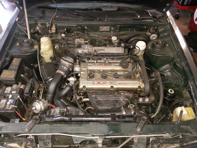

I am going to try to work on beautifying the engine bay here soon. think I found 2-3 colors I may try for the valve cover. same time I want to setup a breather system. couple other things to remove from he engine bay...
Engine paint that orillys sells. LOW GLOBE black. Looks like factory paint. Not like flat, and not glossy like a mexi painted it. Get rid of the cruise control and that will help a lot.
i already removed the cruise control....
was thinking about a gray/blue/green color for the cover. oem is suppose to be wrinkle red, kinda like ITR.
