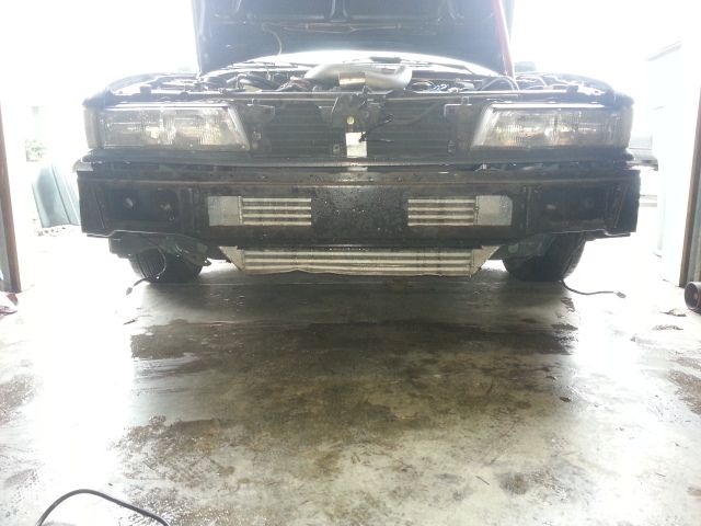

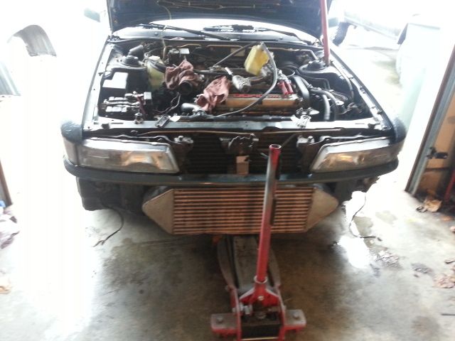

today... i got pissed.  :evil:
but here is some pics...

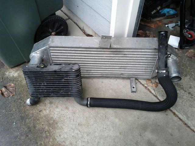

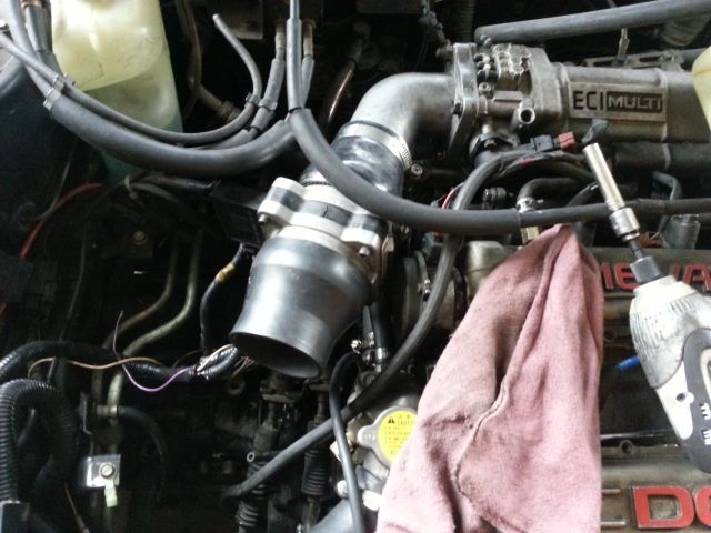

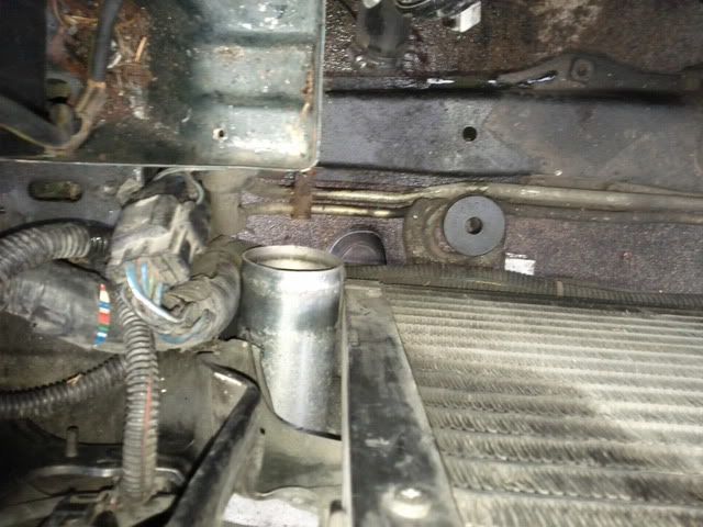

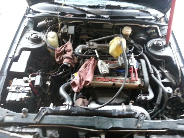

stock intercooler setup is a fuckin joke. rediciously long chargepipes, large oil cooler...err small intercooler. ehh. but there sure is some room for a front mount in there.
 ;DDD
little pic of how close shit is, and how i plan on doing this.
today was just a mockup to see wtf im doing. had to...."trim" some shit to get this intercooler to fit, even with its small size  ::)
also was going to swap fuel pumps, but the fuckin line wont come off the sender.  :evil:
some other shit pissing me off too. but im sure its cuz i hadnt eaten all day. but whatever.

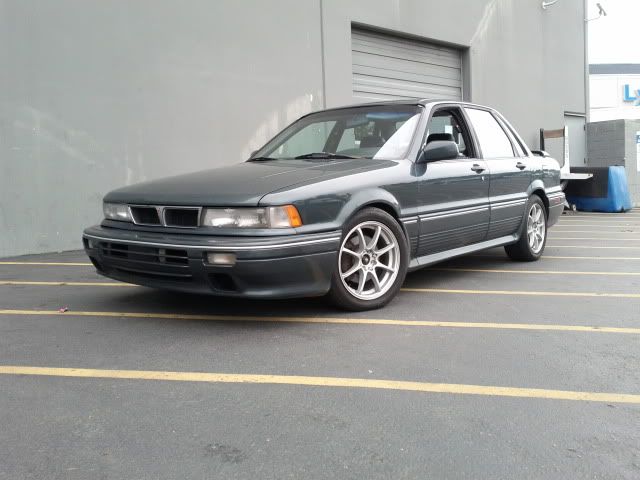

got some new shoes....
16x7 Konig Feather's... jew cheap, of course, from a kid at work that wrecked his Accord. really light wheels. not as light as the stock ones tho.

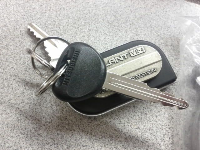

when i was ordering something for my CRX turbo from the dealer i had them cut me a new key. i had a shit ass sheetmetal stamped out key from a locksmith. was weakness. OEM one is just about the same, one above was some number posted on the GVR4 forum. you can also see the keyfob number plate i stuck to the back of my alarm remote lol.
installed the SupraTT/Denso fuel pump a while back, along with the 680s and MAF-Translator. still no intercooler installed. been lazy with mounting the intercooler and finishing the pipes...

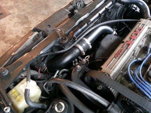

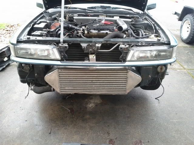

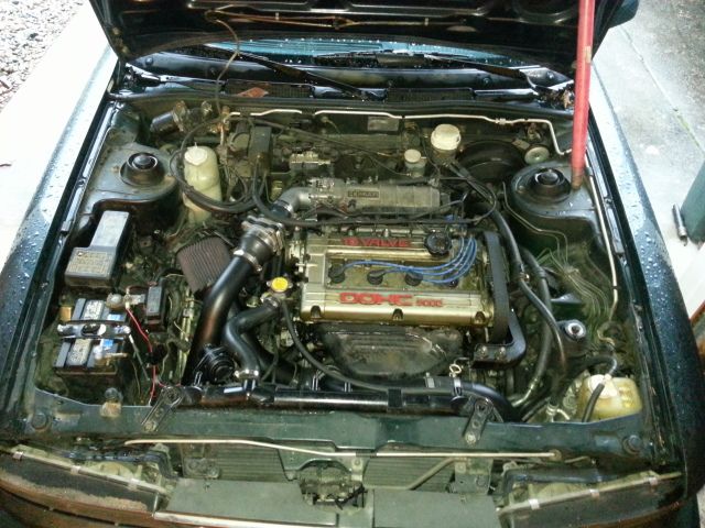

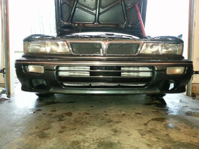

first off, YES I STILL OWN THIS lol. fuck im lazy/ADD...

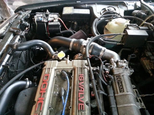

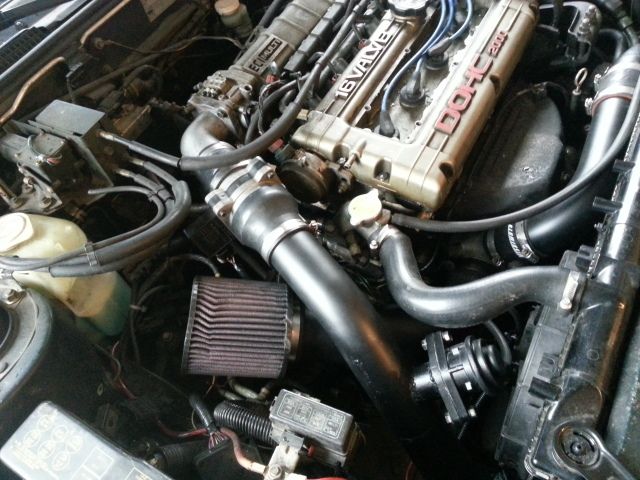

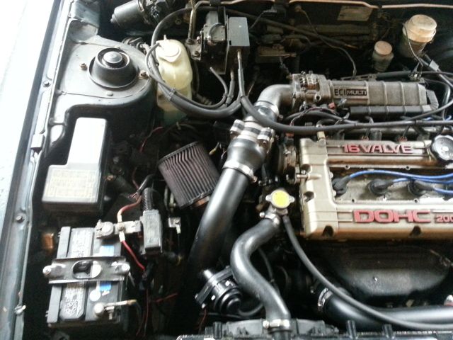

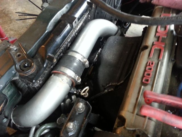

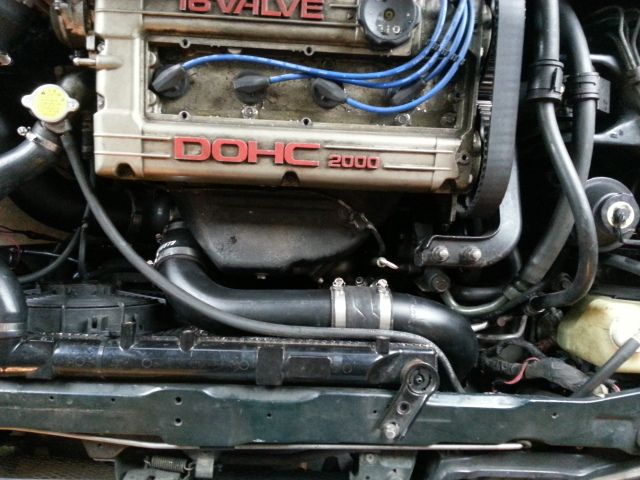

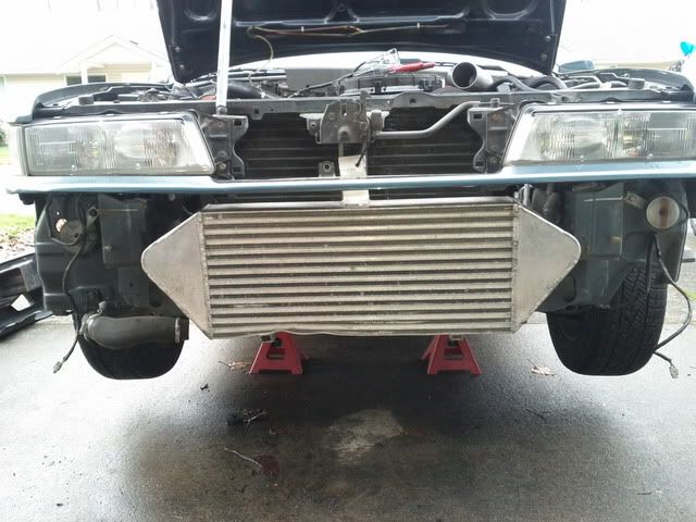

this weekend i finally put the intercooler on. yeah i test fit it and hacked the car up some to get shit to fit. but when the day was done i still didnt think it was gonna fit well. (it didnt)
there where many setbacks, lots of procrastination, and just buying of other shit. this car ran and drove, so ehh. but it could use some more drivablity and boost. everytime it would go into boost it would freak out. im assuming cuz there was a boost leak somewhere.
anyway. me babbling again... here is the car porn...

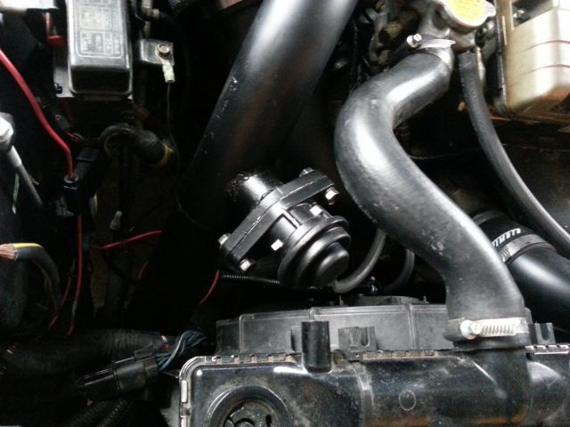

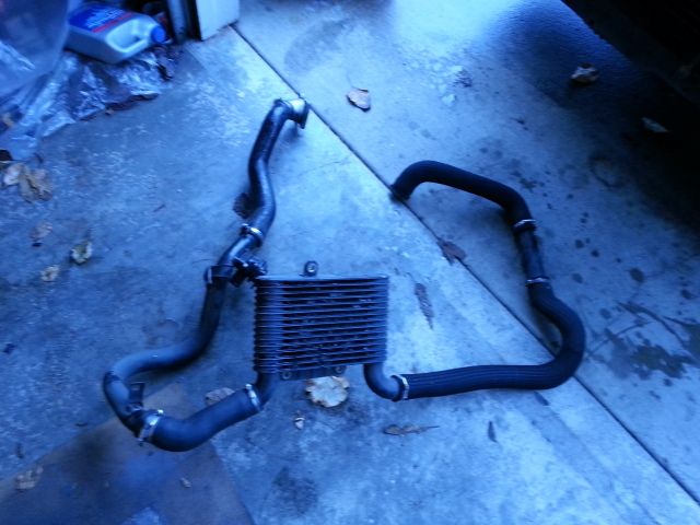

complete shit that was on the GVR4. not sure it was all GVR4, might be some other DSM/EVO8/X shit lol.
only thing i kept off of it was the stock BOV. rest is new.

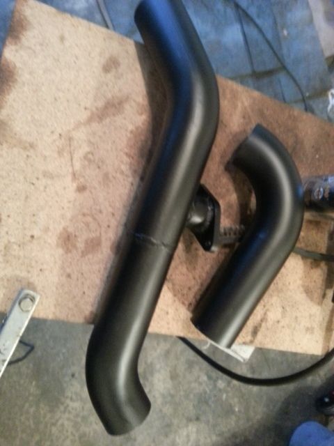

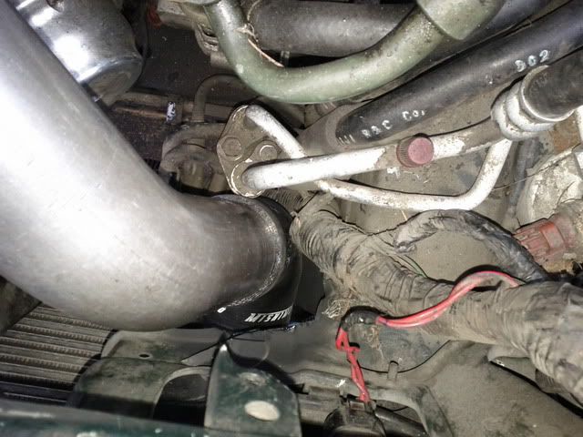

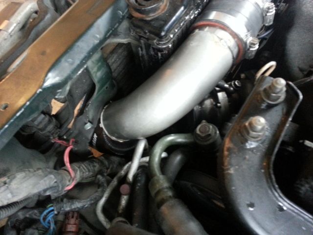

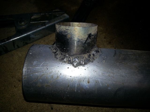

this was the hardest part. stupid ass AC lines and other shit all in the way. had to get creative. but its solid. turned out good.
was going to do one piece, but this seemed simpler to assemble. also the way i have seen others (ETS) do it.
oh yeah this thing. im running a MAF-Traslator 2.06 or something. uses a 3" GM MAF. and it works as a blow-thu setup.

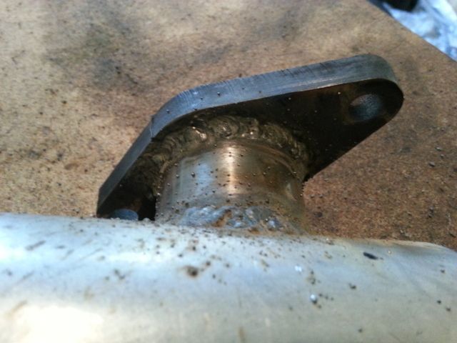

should i be proud that im getting good with welding with the flux core? lol  :Jew:
you can see the cold side pipe assembled. doesnt look like i took a test fit pic. the OEM BOV flange welded on.
i wanted to just chop that fucker off at the mounts. this was all ready pretty cut up when i got the car. was swapped from another GVR4...

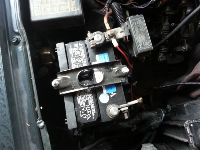

oh yeah. this is all OEM....Honda. lol its a 151R battery. for Fit/Civic Hybrid's. its like a 51R, just 2-3in narrower. plus OEM Honda mounting shit....i work at Honda. also trimmed the battery tray. you can fit 2 of these batteries in the OEM try. this one tested out at 470cca when new. rated at like 340 or something.
money shot.
mean.
thats all 2.5-3" and flanges from Columbia Mandrel. Mishimoto/Innovative/Vibrant couplers, port matched 2g throttle elbow. stock GVR4/1gDSM BOV. K&N air filter. IndyRacecore/Spearco 2-216 intercooler (1g DSM 'race' short pipes intercooler).
think thats all....fuck off.  :-*

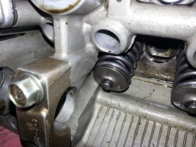

BROKEN.
  • Posts: 3026
Re: turbohf ~ new daily/project... 1991 Galant VR-4...
« Reply #41 on: December 30, 2012, 12:05:42 AM »

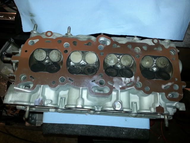

it has two dead holes.... appears to have burnt a couple valves?
buddy has a 2.4L motor (6bolt G4SC?) that he was building for one of his cars and has realized he doesnt need it lol. has offered it to me at cost, just needs assembled and then my head needs a couple valves....
he also knows of some 'HKS' 264/272 cams for deals along with an AEM...one of his buddies is parting a dsm, it might donate some 5lug....
still debating this. but think thats the plan right now....

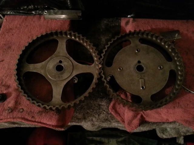

oh, wait, i did get the special 94 Galant GS DOHC cam gears that line up right with the G4CS block with 4g63t head.

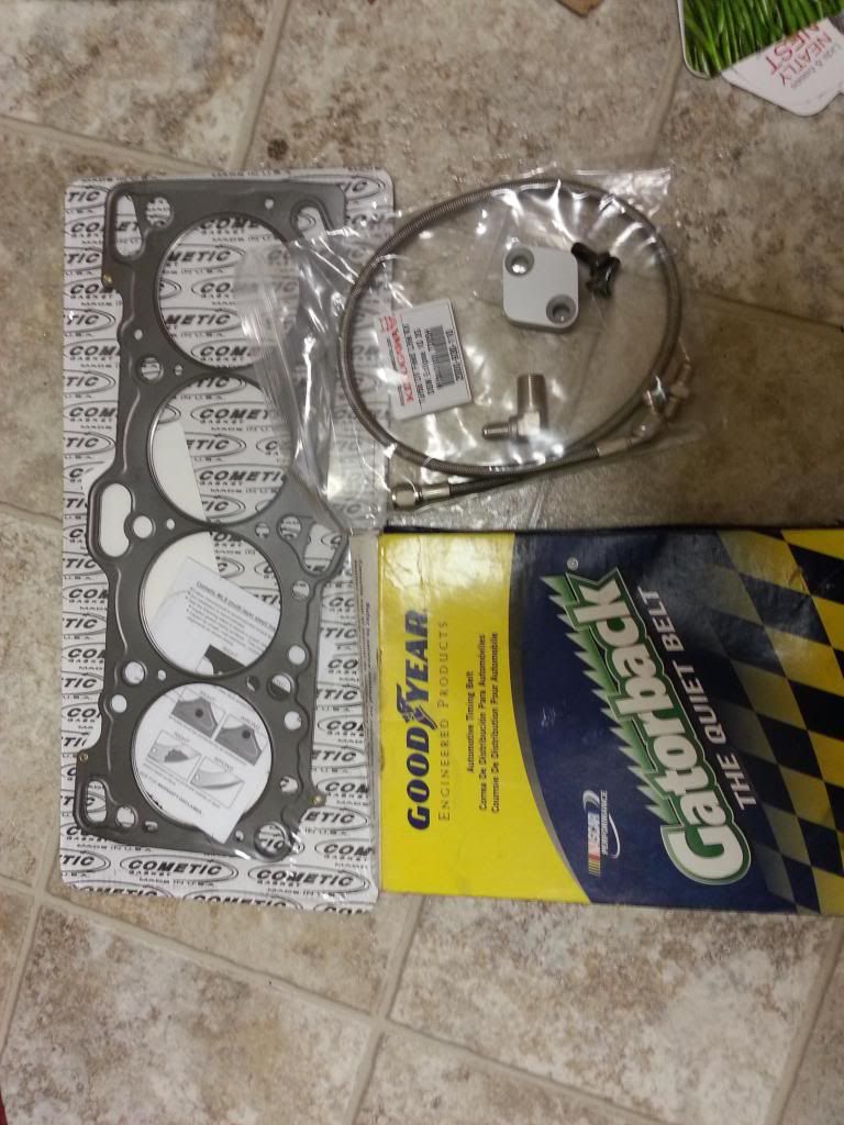

i got some parts rolling in tho...
i said something about needing different cam gears? well there they are. look like every other big ass mitsu cam gears... but these are for a 2.4 DOHC. so the timing marks are off by half a tooth each.
-Cometic MLS HG... .051"/1.3mm thick, 87mm bore.
-SS braided oil line kit. off the oil housings as they call it. this turbo, or high pressure turbos, whatever i guess like direct oil. suggested by DSM homie, and i think Forced performance the maker of my turbo.
-EGR blockoff. that apparently didnt come tagged with some shop name, cool.
-new timing belt. special one year only 94 Galant GS DOHC. jew closeout pricing..

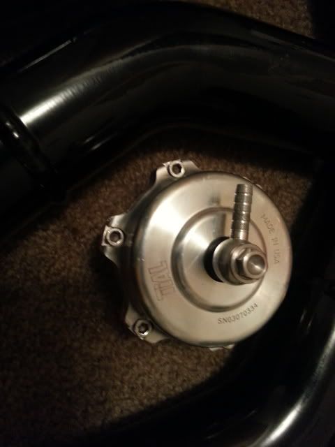

think im jackin the TiAL 50mm bov that was for the EKK project...dont think its getting boost anymore...

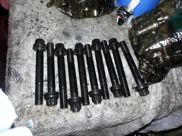

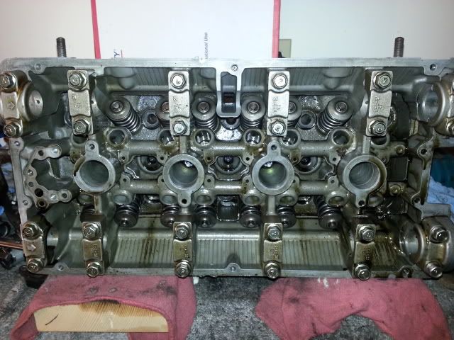

ok so i got some more parts today  ;DDD
head
dual springs
light porting
couple of ARP head studs

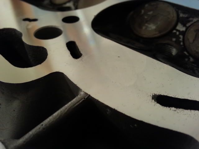

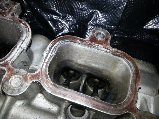

also im not sure how well this will picture...
but does that look like a rough surface? seems rougher than all the Honda shit i have ever done with a MLS headgasket...
thats all. might bring it to work tomorrow to clean up. might bring it to machine shop to get surfaced. want to get ahold of my buddy that suppose to be selling me the block, see whats up.
might do nothing...
 :Jew:

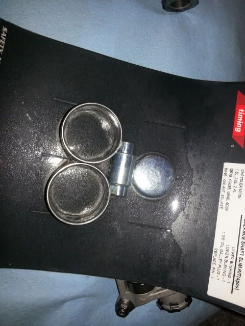

balance shaft delete kit.

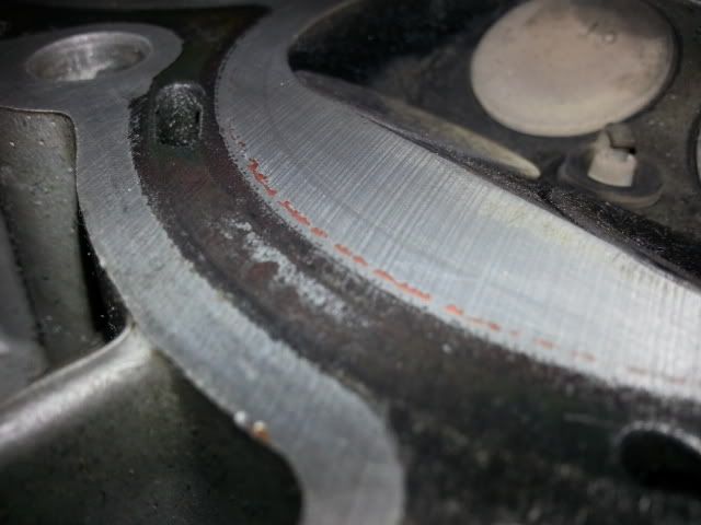

fresh surface for a MLS headgasket. my machine shop guy laughed, said the other finish wouldnt have worked at all.
rest of the head shit cleaned up

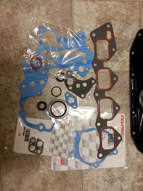

handful of gaskets/seals/orings. oil pump, oil fitler housing, water pump, egr (for my new blockoff plate), intake manifold gasket.

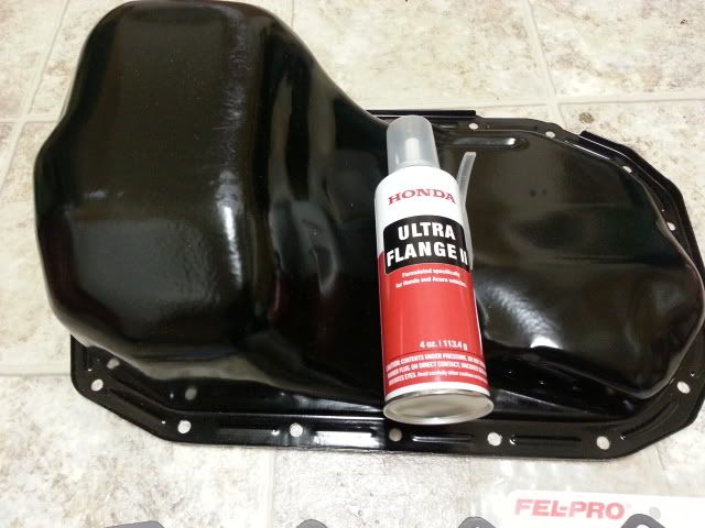

BRAND NEW oil pan. cuz mine has a fat ass dent. homo halfass fixed oil drain. and some Honda Ultra-FlangeII, its the shit we use at work for oil pans that dont use a gasket.

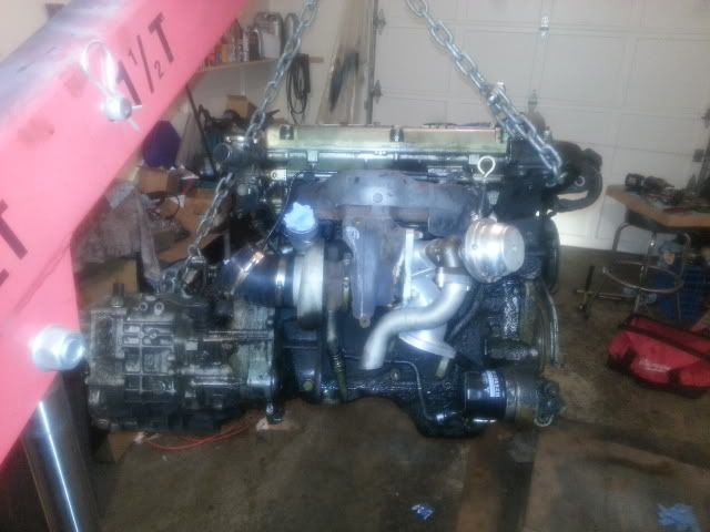

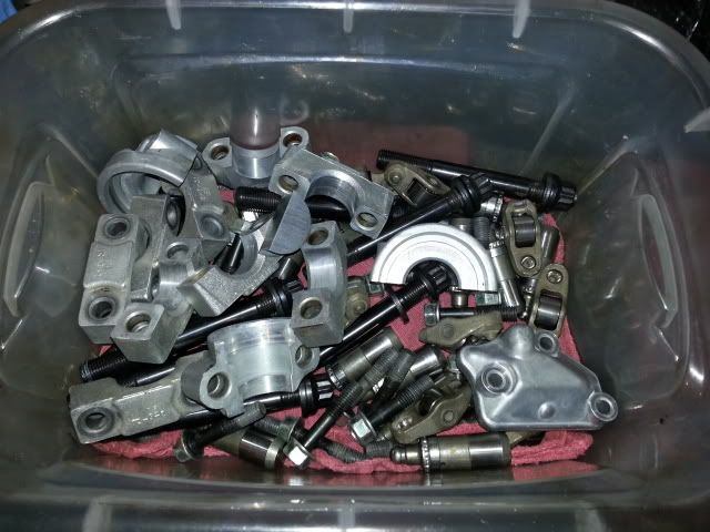

no other pics really cuz i was working, now im tired and lazy... so i got the motor/swap out. not bad i guess for my first (only!) time doing this.
anyway. its out, and mostly torn down to longblock. i dont have an impact, so i cant get the crank gear or flywheel bolts out. so i cant get the pump off. might try a trick or two tomorrow. or bring the hole thing to my homies place and leave it there LOL.
looks like i need to order a clutch disc, and a couple of inner axle boots.   :-\
might be picking up some ForcedPerformace FP2 cams (aka HKS 272/272s) tomorrow also?
 :Jew:

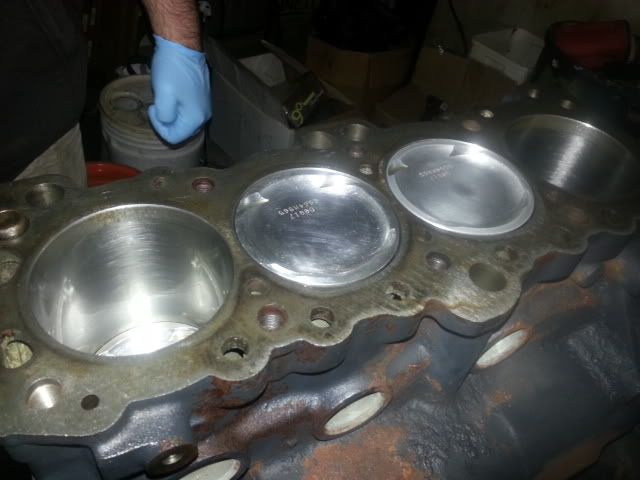

so there it is...

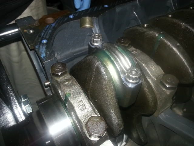

Hyundai G4CS 2.4L block. 86.5mm (6bolt)
Mitsu 100mm crank (6bolt)
Clevite77 bearings (all spec'ed)
Eagle rods (standard length)
Wiesco pistons (.045 P2W, dont remember rings, like .026 and .022... about 8.8:1CR)
left my new head there with gaskets. maybe he will throw it on. also gave him cash to get those FP2 cams.
