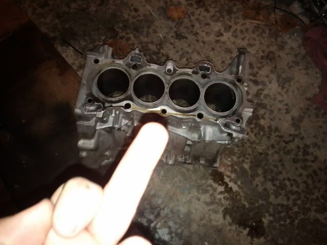

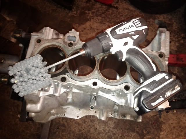

so the other day i started cleaning that huge fuckin mess i call a garage. made nice progress. but still not really clean. still got some more to go. i have several work bench areas (none really sturdy tho) that are all just covered in random shit. like one is just full of misc hardware.
anyway today, i finished? nope. i tore more shit apart LOL.
fuckin EWWW.

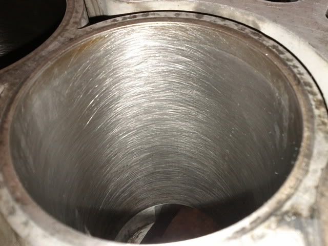

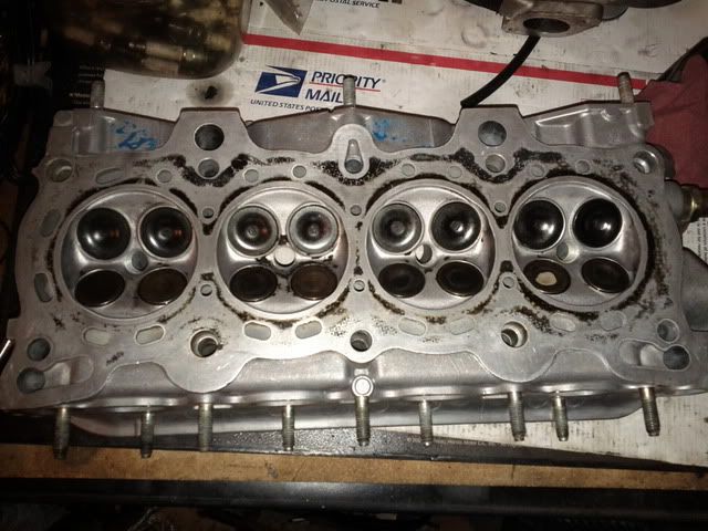

but it all looked OEM. MAINS looked ok'ish. not bad for a shitload of miles. RODS where nice and shiny with slight debris. mains maybe usable, rods no. not that im going to, im just buying a whole set of KING/ACL's.
RINGS. now if you remember (or look up a couple posts) this piece of shit didnt have compression worth a shit on 1&4. nothing really looks amiss with anything. #1 rings appeared to be a little sticky, but not stuck. if anything it was more the oil rings than the compression rings.
pistons slid threw the bores NICE AND EASY lol. bores are pretty smooth, very little cross hatch.
im going to bring all this shit into work for a nice super cleaning. see if i can barrow a bore gauge from one of the guys to see how far this thing is out. but right now the plan is to buy a dingleball hone off ebay (~65bucks) and scratch her up a little. along with of course new rings/bearings/gaskets.

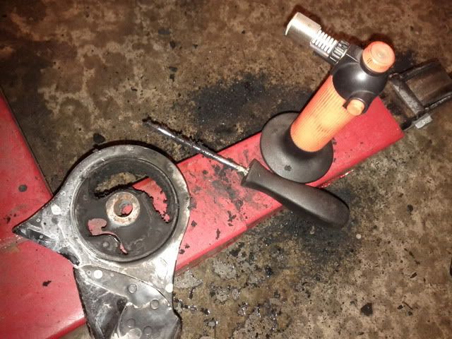

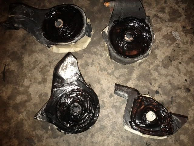

so, you all have known or heard, or done some RHMT Motor mounts right?!?!?!... well, for the kids:
go to your autoparts store...
get that shit. make sure its that part number. i got one in a cardboard tube before. shit blew out and made a fuckin mess. lost a $2 caulking gun lol. speaking of, this shit is THICK! use a good caulking gun, step up to the $5 one. i have used mine a couple times now. solid unit.
also, if its cold as ballz outside like it is here (ok, only like 40*) KEEP IT WARM in the house before starting. when its cold seems to not flow as well.
OH YEAH. DONT GET THIS SHIT ON YOU. its a bitch to get off. seriously. get some gloves.
so i had 3 perfectly good motor mounts (front one is always fubar on a CRX)... so lets destroy some shit!
i took my drill, railled some big holes in the rubber. the burnt some out.... got bored after playing with the fire for a while. besides i needed some structure to it to located the bushing. more urethane the better right? i did end up dropping a decent size metal plug into the mix like Haffa. need to make sure i had enough goo for all the mounts.

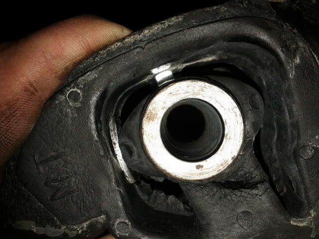

TOLD YA! nice crack most the way threw the mount. just flopping around in there. so i couldnt really cut too much. dremel was acting up (ok, HF china crap one) so i just threw a nut and washer in there to locate the bushing, and act as a limiter of sorts. stiffen up more than the urethane ;)
i only took special care with the front and rear mounts as they are the ones controlling the engine movement. the other 2 are there more to hold the engine/tranny in the car.
TAPE EM UP! probably wanna use better tape. that stuff doesnt stick well, and ended up blowing out a little.
also you notice that i didnt tape it flat. gives more room for the goo to surround the bushing.
when your done. you probably got some goo all over your gloves. use your fingers, smooth that shit out on the mounts. carefully take off gloves and toss them.
btw. i killed the whole can.
DONE?  now let that sit for 2 days...or 2 months. depending on your build timeline.
now that im done. i forgot something. lol. i did a load of research on this before i did it (i have done this like 5times im sure). i was going to use something different this time. but changed my mind.
you know and love some hasport/innovative/place racing/whatever mounts right? they all are sold in "durometers" (or whatever) meaning how solid they are.
62a = "street" (rattled the shit out of the CRX)
80a = "race"
90a = "retard/hardcore"
now i found a liquid urethane 2part mixture for all 3 of those. (just do a search for liquid urethane motor mounts) you can get it on ebay for cheap (sold as motor mount filler) or from mccmaster whatever.

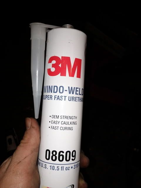

so whats the 3M windo-weld? the spec sheet says 55-60a...  its cheaper, little on the soft side, and the shit was at the autoparts store next to my house.
oh. before i left work i put a bunch of shit in the washing machine...

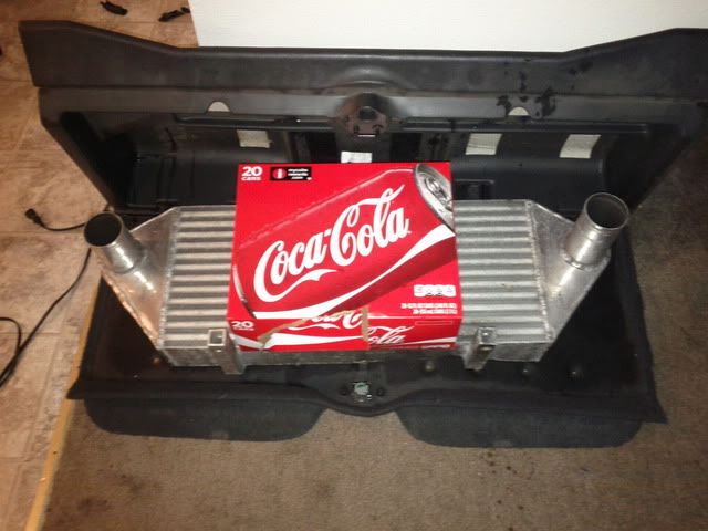

yeah, so my IRC/Spearco 2-216 intercooler seems to be the perfect size, and is heavy. threw a pack of Coke for good measure.

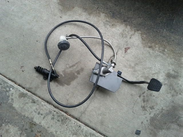

took the hydro swap parts out... FOR SALE! if anyone would like this fine piece in there EF...

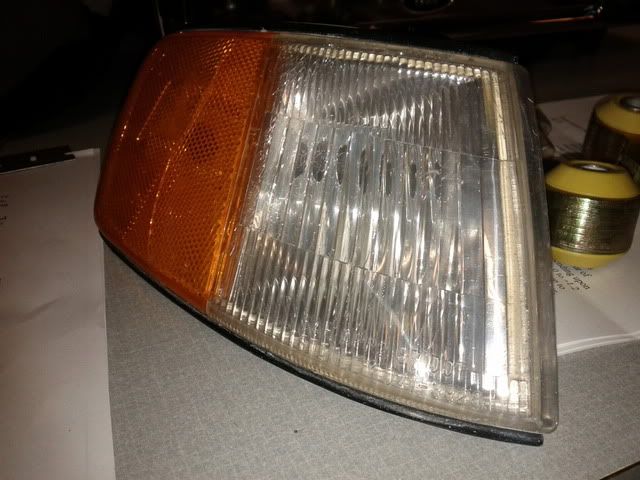

corner light i actually picked up with the cargo cover shit...
after cleaning/buffing it i notices all those little odd cracks on the inside, and the crack on the inside on the reflector??!?! wtf? should i buy a new one all together? or rock it? idk...

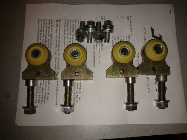

of the millions of camber kits on ebay/world why this one? well i hate aftermarket shit (in general). i had an SPC rear kit that was seized. slider kits just scare me, cuz well they are chinese, and move. i just want to set my shit and leave it.
my car has already been aligned. its square, just cambered more than i want. so i got this. i have had one before that i got at the junkyard. its a knockoff of a Progress Suspension part (like 200bucks). its a solid kit that just offsets the bushing with 2 settings: "low" and "gangsta low". when i put it on my CX that was pretty slammed it damn near zeroed my camber, didnt like that, so i put it on the low setting. got some useable camber. CRX has like -3.5*... so we will see where it ends up. put it on the low side for now. paperwork claims correction of up to 1.75*
rear is just new bolts with a stack of washers. im sure you have seen this before. does the same thing, pushes the control arm back out.

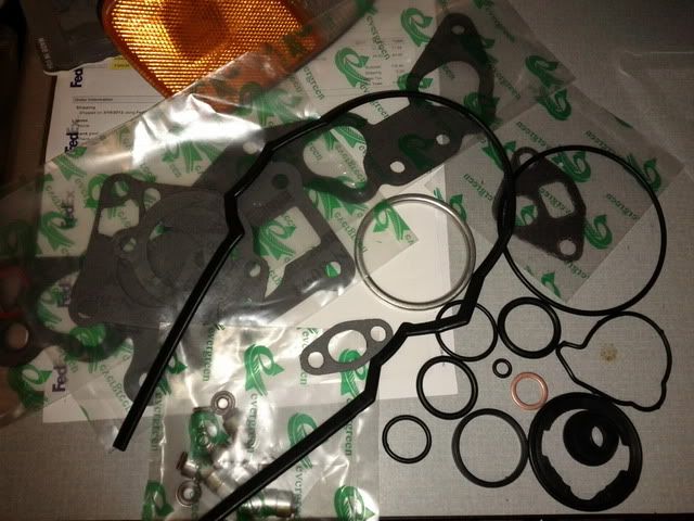

gaskets/seals that i like, and am gonna use. im gonna rock this composite HG. nice multi layer exhaust gasket. random seals/orings for rebuild...
shit in the box that i wont use (cuz it sucks), or i have no idea wtf it is? and some shit thats not even for my motor.
FULL SET? no. notably absent are the injector orings. odd cuz i have been buying from the same vender, with the same parts several times now (B18C5, EK/minime thing, B18C, A6) and those had all 3 injector seals/orings.... so really i have an extra set or two if i need them. lol.
3-4th set of valve steam seals that all 16 look the fuckin same. should be white springs (x8) and a grey/black spring (x8)... these all have white? so....? probably going to buy honda ones.
still, not a bad deal for the price.

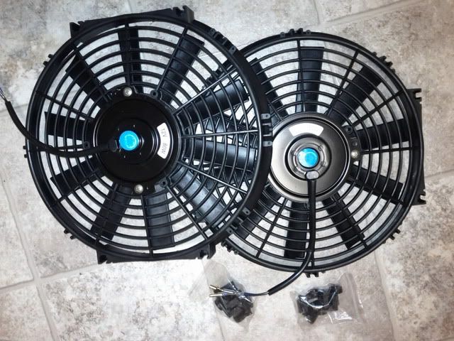

china 12" slim fans.... why 2? well they where cheap ($40shipped). try to get both on the CRX, if that fails (probably) the other will go on the GVR4 (its wearing the CRX fan, reason for new one)...if both fit the CRX, well ill have to buy another for the GVR4 before it gets hot as shit outside/hook the AC back up.

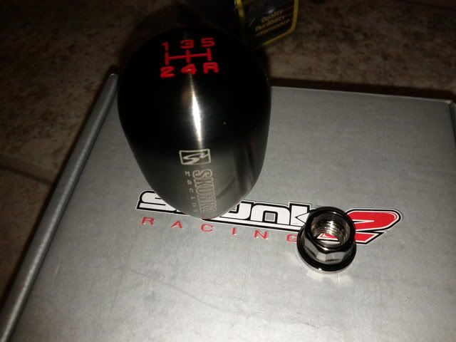

this might be the first shift knob i have bought in 10years...

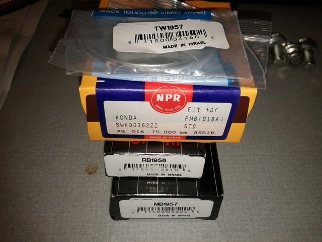

HF to DSM... i also have a HF manifold w/shield around here somewhere...
oh and before i even left work i snagged up some shit... only about half of it lol.
upper/lower/bypass hoses. throwout bearing return spring (i always replace these on cable trannies). x4 corner light retainers (i have a 88 that uses screws, this fixes that). 2 new headbolts (im a jew), my new corner light. SK2 knob i already mentioned. and ES shifter bushings (black).

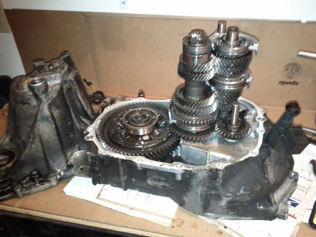

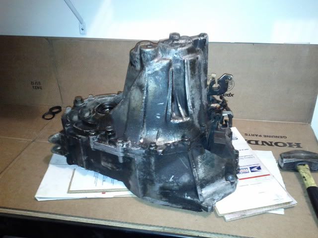

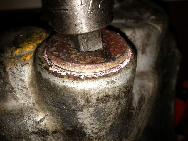

i also started taking the tranny apart for inspection the other night. but got hung up, and gave up too quickly. then ate, and forgot lol.
red loctite....asshole.
looks ok clean. obviously been apart before tho. no fucked up looking teeth/sycros... diff bearing seemed a little tight? but it was sitting for a little bit, probably got some moisture in it. seems to spin fine now?
Re: turbohf ~ never ending CRX project...
« Reply #45 on: March 24, 2012, 12:16:38 AM »
That is not red loctite, that is factory sealant, you popped open a virgin.
I can also tell by the 20+ year old Hondabond it has never been apart.
« Reply #46 on: March 24, 2012, 12:36:20 AM »
really? i thought they used a white/hondabond shit? anyway. cool. tranny seems mint. big thing is that the diff pin looks legit lol. input shaft had like no play.
probably gonna run the cases threw the parts washer, and put it back together. ill do a MF or china lsd in the future.
its getting 2 new axle seals forsure. i popped them out and threw them away already. looked questionable.

get a seal kit and ISB, inspect forks.
When you are ready for a MF LSD + bearings, I get a decent discount.

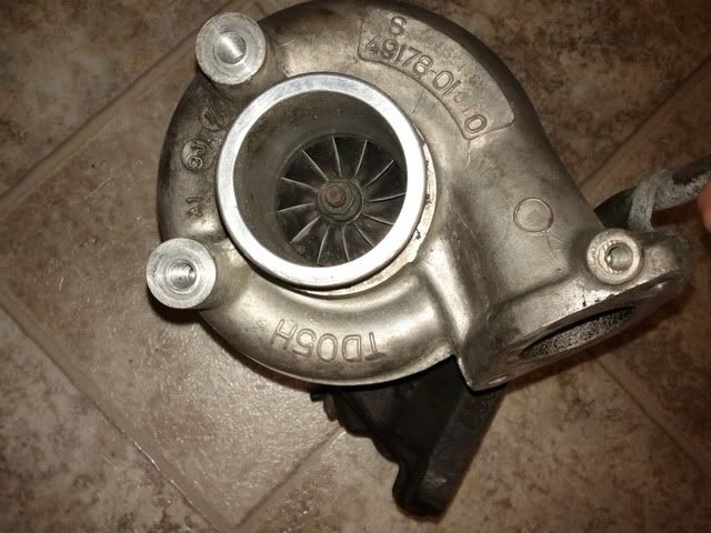

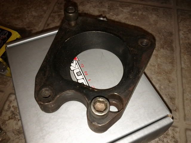

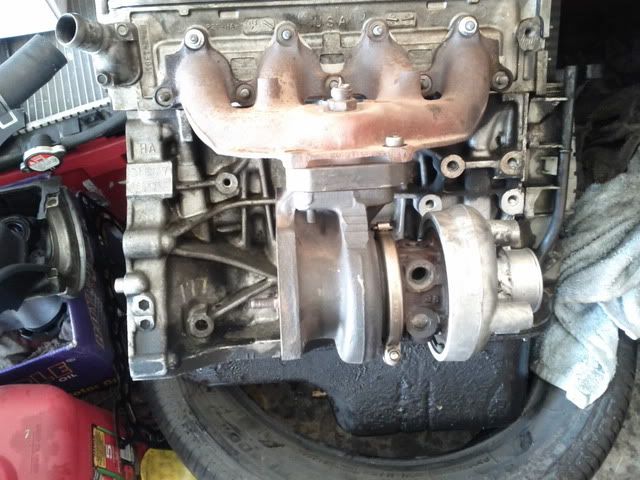

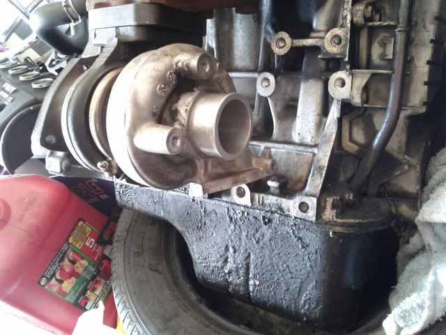

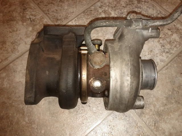

MHI/DSM TD05H 14b turbo.
did some test fitting with the HF mani/plate action... i dont think i like how it fits. but more on that later when i start fabbing turbo install shit i guess...
WORK!
yes, i realized as i was grabbing the stock pan with no oil drain on it...FUCK. shouldnt have hondabonded the gasket lol. well hopefully this way the gasket stays in place when i do modify the pan...
btw:  thats stock PM6 pistons/rods.
 :Jew:

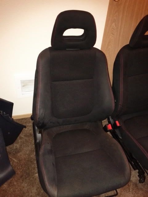

i know i said something about this FOREVER ago. shit i think in my first post...
i picked these up off a good buddy of mine. he hasnt has a honda in years. and one he had was minty/stock, and the other was an ITR lol. and there was like a 2year gap i think between.... he has had these seats for like 4-5 years? im pretty sure he swapped the drivers side out of his ITR cuz it "wasnt broken in" like the one in my 97R that felt perfect lol. so the drivers side i have is MINT!! it was a nice 50k mile ITR.
anyway, heard from another buddy that he was trying to sell them to him. fucker. lol. so i went over tonight and cashed him out. got fronts and rears. selling the rears.
i wont say what i paid. i know what he paid forever ago for them to some kid that needed to pay a ticket/rent or whatever, and got them cheaper for homie hookup  :Jew:

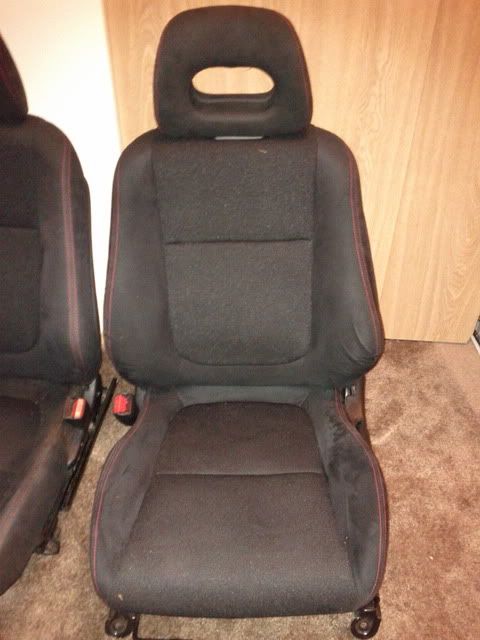

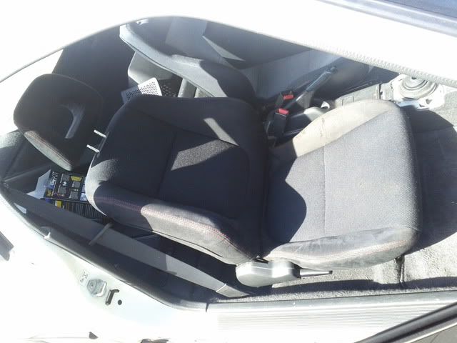

soo. quick look at them, then the 88 CRX DX seats i have... this is gonna be a bitch! from what i hear, the pan swap is easy? but i can tell you now, this isnt gonna work. the headrest have different spacing. there is no lumbar on the CRX seats, and it may be trivial? but the covers/handles arent gonna swap... idk. this might be a welding project too.
oh, and im not just gonna swap the seats in. or make rails or mounts. i have tried some DC2 cloths before. say WAY too high, fit like compete shit. del Sol's fit pretty shitty too. good install height tho.

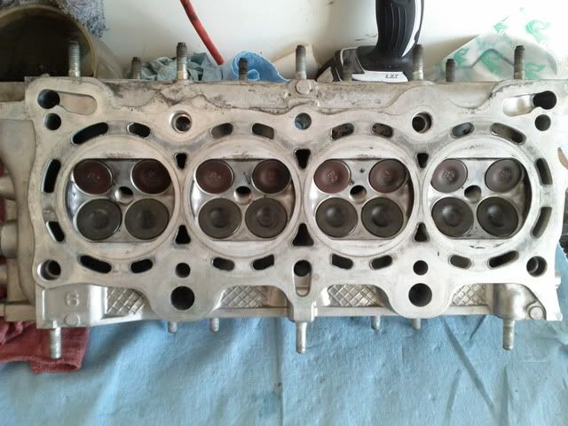

last night i lapped all the valves in (standard drill/vacuum hose)...
finished assembly tonight. i know i missed cleaning a valve. fuckin carbon just wouldnt come off, gave up.
i got the cam and rockers in...forgot to take a pic i guess...
PARTS!
ITR shift boot... not liking the way it fits so much, might need some trimming... but old one was NASTY! plus this matches the ITR seats, shift knob (red letters), and Spoon steering wheel...
JDM ITR chrome dual bend shifter. matches the boot  ;)  little modifying needed for CRX linkage...aka bend the shit out of it till it fits.

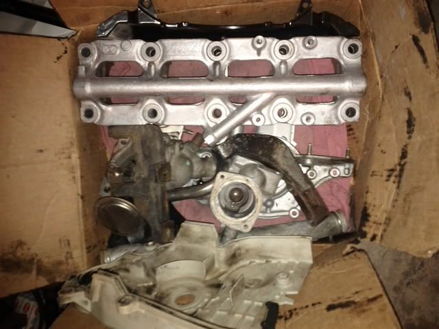

oh yeah.... THIS MOTOR IS JUNK!... 3 of the headbolts wont torque down. after some debate (yes i said that) i wont be running this motor. gonna part it down....
NOT ALL IS LOST...well on that POS it is. im sure you can just helicoil/timecert it. but im not putting that work into this... im gonna steal parts off it i need...
MAD JEW DEALZ WARNING...
called homies far and wide to keep eyes out. i get a call with several motors from a complete running swap to a Y8 longblock with a rod knock. after some back and forth between homie and homie, he calls me and says its yours for $40, no markup, you want it, its yours.  :Jew:
D16Y8 longblock. no manifolds. has VTEC solenoid, and alternator. rod knocker on #1. everything looks crusty and old like the one above. its all torn down, dropped the hone down it. all in my trunk to bring to work and clean the shit out of it... pics later of clean parts lol...

« Reply #54 on: April 10, 2012, 06:28:06 AM »
I really wouldn't recommend those fans, esp if it's not a new radiator and really not if you also don't use a shroud. They really suck that much ass. $90 for a single SPAL fan is a better deal when you figure out why you're temp won't stay down.

WORK!
fuck you! i stripped the A6 down, cuz i needed the crank and bearings out of it for the new Y8 build. dont think there is much else i can use off it. rings are different size. oh well.
Y8 head. all fresh and clean. lapped in valves, replaced seals, put back together. you can see my makeshift spring tool. worked ok.
was fuckin around checking shit over. looks like ring gap will be ok... think piston to wall is a little high. but ehh. whatever.
little turbo mock/test fit action. why the fuck couldnt MHI just use bolts for the housings? the clamp was cool, but the big ass C clip was a whore. then both where pinned to put back together the right way...great! if your putting it back together the right way, and of course im not.
shit ass picture im sure (sun/phone) but thats an 01 US ITR seat on a CRX pan, meaning it bolts in with no welding or super ghetto shit. well, aside from the perma gangsta lean lol. ill fix that for the drivers side. install height seems same as CRX seats, weight is about the same (all teh heavy teggy shit isnt put back on).

14b = 125 i think
manifold = 20
plate = 50?
