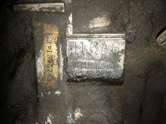

all stock, old lady driven 135k mile....or whatever bullshit story you wanna hear... D16A6 swap. everything you see there. for, well  :Jew:
dizzy is pending sale, i wont be using the intake/tb/injectors, ECU, or those knuckles he gave me. so if you want those PM me, i would like to recoup the rest of my money.
its from a 1990 CRX Si. so its got the bigger cam (LOL) and bigger flywheel (bonus), oh yeah, non-homo splined tranny. swap is suppose to be mint other than its grimy appearance.

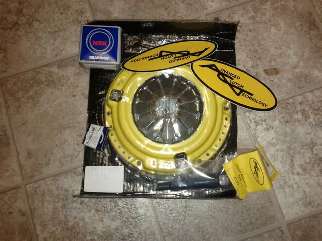

so there was a deal of a clutch on ebay... but i didnt want to buy it cuz it had an unsprung 4puck... didnt even meet the reserve...
lol. told him i wanted that shit still, minus the puk. new this clutch is 350bucks... he wanted like half that on ebay... and of course i got it for less...  :Jew:
its an ACT Heavy Duty Pressure Plate. with bearings, and tool... cant forget the stickers... i will be buying a new 96-00 Civic friction disc from Honda. making this an HDSS... light clutch, but hold my power if i get up to a 16g turbo...

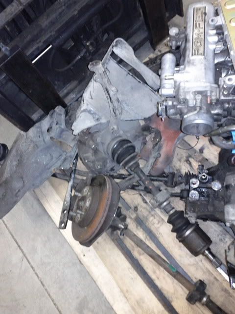

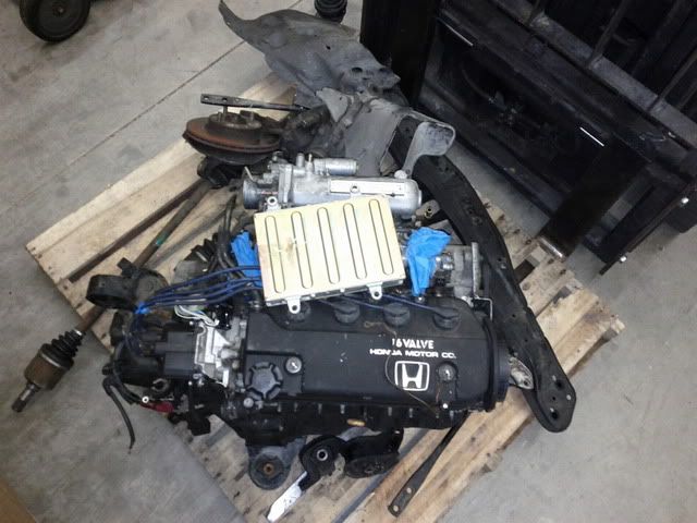

engine on a pallet compression test did its job....
... FUCK. the numbers:  60-210-210-90...ish.. went back and forth. didnt even sound good cranking on the dead holes. plugs looked the BEST on those holes. idk. dont care anymore. pull the head...
...so i start with pulling the intake. of the nuts that where there, most where exhaust nuts... sweet. think it was missing 2-3 altogether. shit ass felpro gasket...matched the exhaust gasket...
...#1 (center intake side) headbolt? fucker was barely passed finger tight... dont worry it had a couple more friends along the way.
dropped the head in the parts washer for ~30mins (i think) and walked away, and almost left work without it LOL. pressure washed it some also. still got some carbon. havent taken a close look at it or torn it down.
took the clutch off and threw it away... verified that a 96-00/P2E clutch disc fits the tranny/flywheel. so we are good there. also spun that heavy A6 pulley off, got a HF one being turned down.
engine/tranny/head are all at home.... might strip them down tomorrow... might not. i have a B18C im in the middle of building for a friend also. short on room lol.

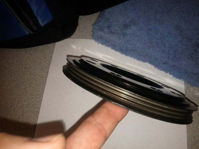

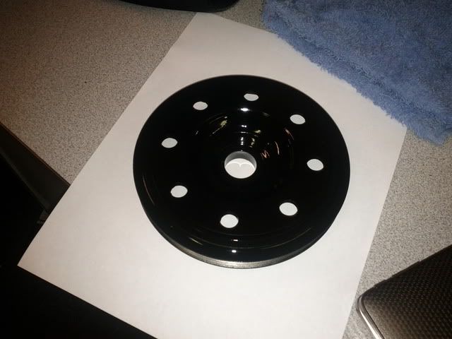

and one of the guys at work has a real lathe, so i figured he might do better than we did on the brake lathe last time with the crank pulley. lol  told him what i wanted, and didnt expect much. take your time, when your bored, etc... must have been bored, cuz to both our suprize it turned out nice.
hard to see cuz he painted it gloss black, i might paint it flat black....i probably will actually.
i think that this pulley was off an HF motor. i dont remember. i have litterly been using it as a door stop for years. it was light, no stupid rubber piece in the middle, and looked like it could loose a couple LBS. oh and it was free.  :Jew:

Don't u want some rubber in there to dampen vibrations?
Re: turbohf ~ never ending CRX project...
« Reply #21 on: February 21, 2012, 01:58:00 AM »
i dont believe in that shit. honda builds solid motors, not less than half ass thrown together, nothing close to balanced, domestic shit.
thats an OEM pulley cut down, and it didnt have the rubber in it. shit lots of honda ones dont have that.

Back in the day people were having problems with oil pumps shitting the bed with ctr pullys because they didn't have anything to dampen the harmonics. But then again I don't think you'll be spinning this thing to 10k either. :P
« Reply #23 on: February 21, 2012, 02:54:46 PM »
A lot of D's came stock with all steel pullies. I have one I have considered cutting down like that for my GRM car.
