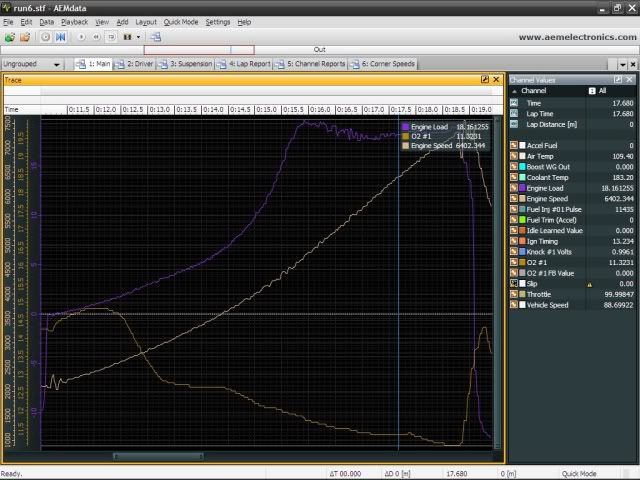

so I fired up the lappy. seems we left it on and it was stone dead lol.
looks like the dyno was loading up a little better than the street. about 18psi stable. with it spiking 20psi first. most the runs look like 17-18psi.

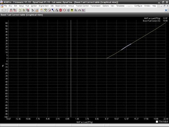

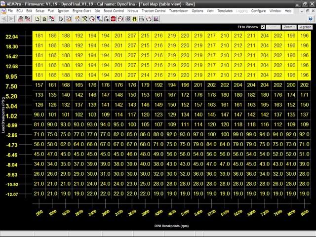

so "Boost Comp"... this is a hybrid map from what I gather. I just tuned the lowest stable boost level, 10psi in this case.
so that's my map. then made everything above that the same number.
then you just add fuel as pressure goes up. by a percentage.... seems to work well.
I noticed you can also do similar thing for VTEC.
