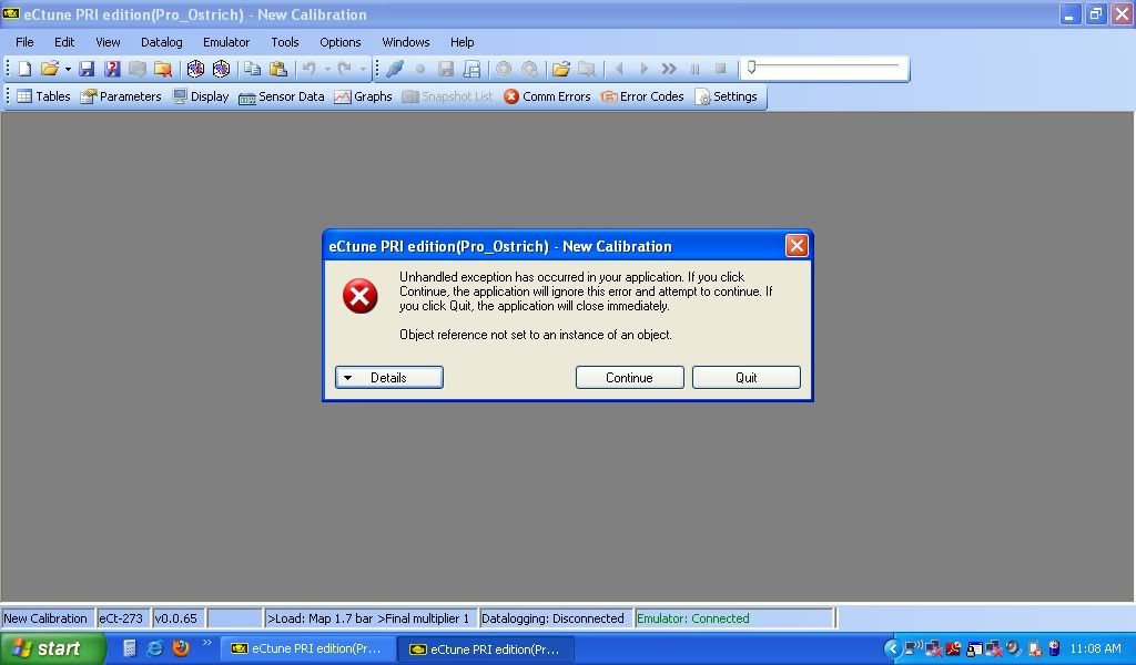

Fuck me so now when I try to upload a file to my ostrich I get this
Re: please help me with ectune b4 I crush this fucking laptop!
« Reply #28 on: February 02, 2012, 03:21:13 PM »
It does load my basemap but is it gona have some underlying fuckup in the rom thats gona make my shit blow up?
