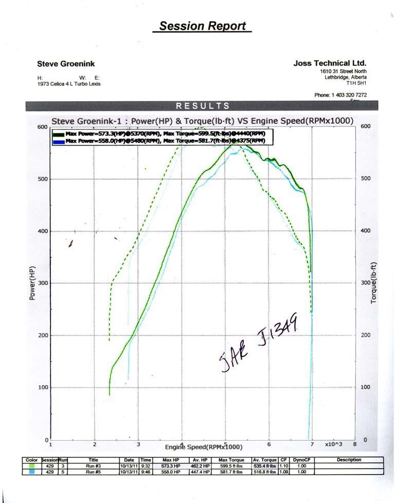

1uzfe an SC300, 1uz's can be had for absolutely dirty cheap in bagged on SC400's.
Dyno of a bone stock internals 1uz from a Canuck yota forum, Megasquirt and Precision Turbo Billet 6262

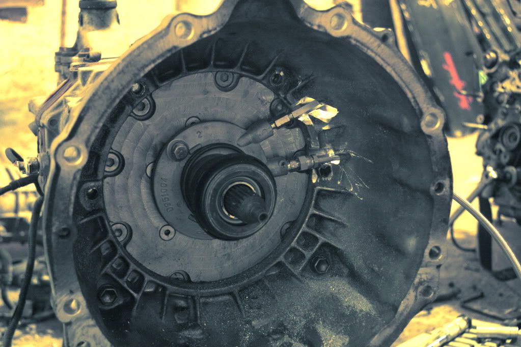

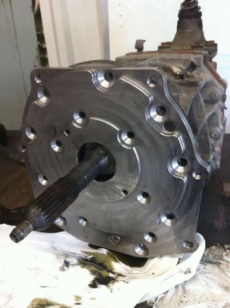

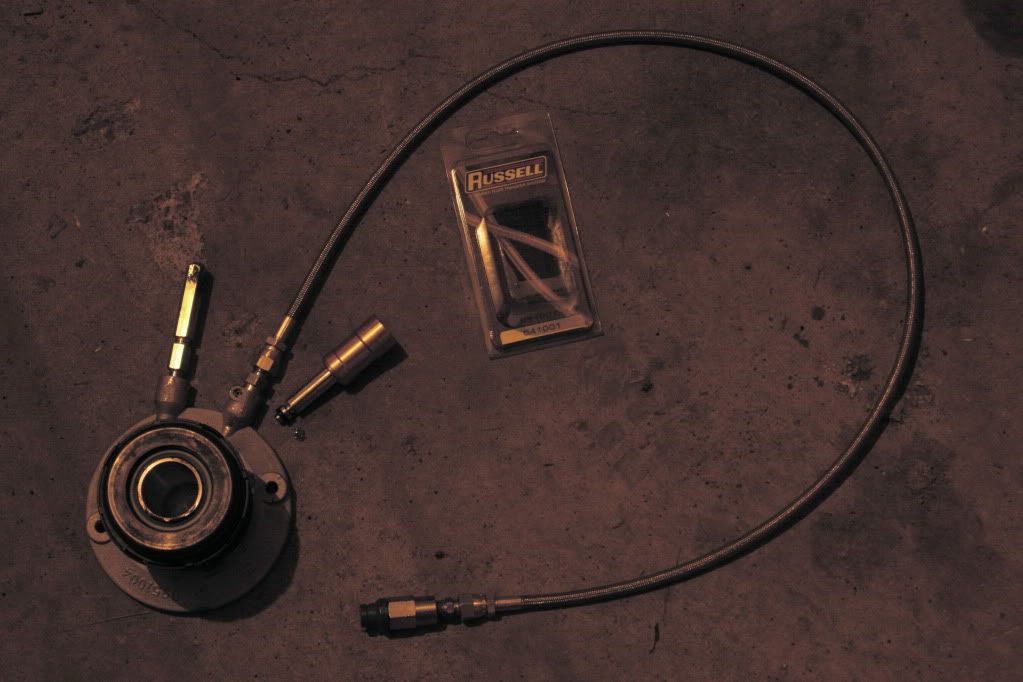

There are cheap way's and expensive ways to make it 5 speed.  The transmissions you would be after would be either W series or R series out of Toyota P/U's or 80's/early 90's Supras
Expensive is he A1turbos R154 kit, 2k landed it is a cast bellhousing, flywheel, clutch& pressure plate and throw out/slave.  the R154 is a MKIII Supra Turbo (86.5-1991?) and are a dime a dozen and can take some serious power. The guy's car that ran the dyno plot above uses that exact setup.
That said you can use an KS racing ebay bellhousing $479 shipped (they also have a bellhousing for the weaker W58/W57/W56 out of a N/A 85-1991 Supra and some trucks)
http://www.ebay.ca/itm/1uz-1uzfe-toyota-Bellhousing-R154-gearbox-FREE-SHIP-/280825467673?pt=Motors_Car_Truck_Parts_Accessories&hash=item4162809319#ht_890wt_1156
Saab9000 hydraulic slave with stock auto bellhousing and a home made steel adapter for W58.  Dirty cheap.
Stock Auto bellhousing  with R150 truck tranny, adapter plate is from http://www.northwestfab.com/ Not sure its even listed on their site. Camaro Hydro slave. I think the adapter was $250ish.
Clutch and flywheel you can use a redrilled 3vze flywheel.
Do it.
