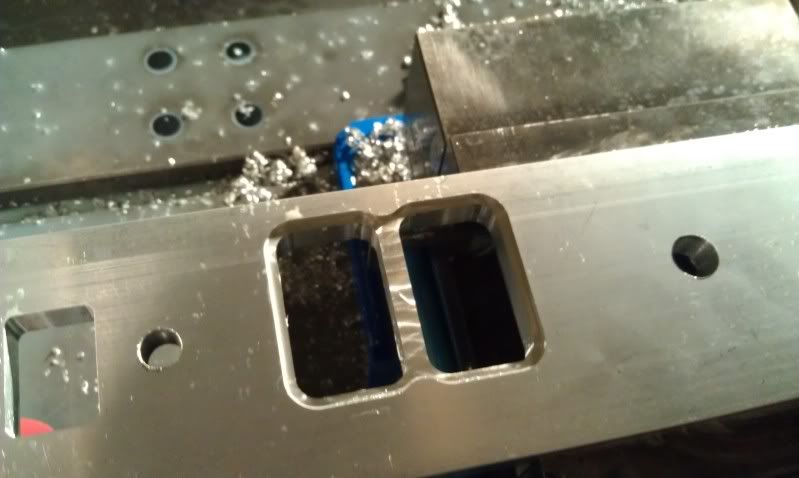

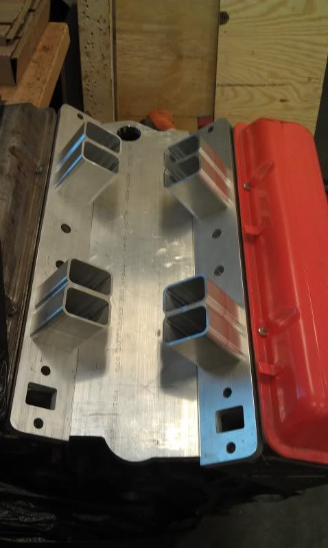

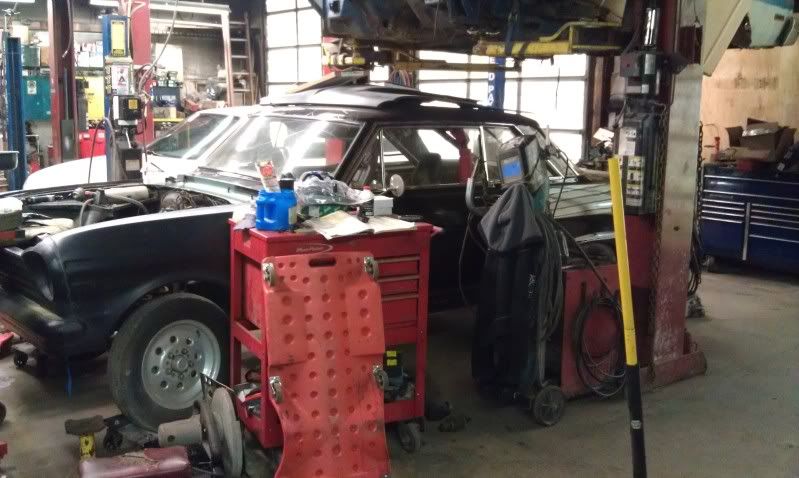

Figured I'd throw this in fab since that's 90% of this build.

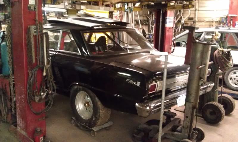

Car is a 65 Nova. Kinda hard to get a good pic of it. Too much shit in the shop.
The owner, lol

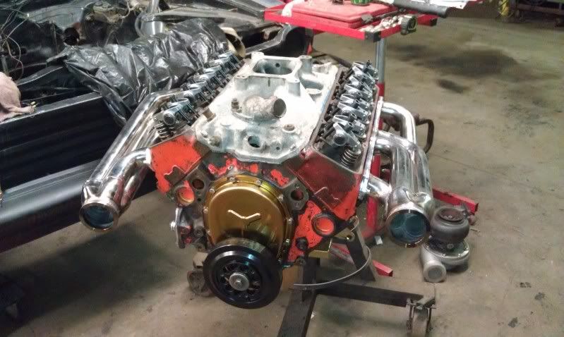

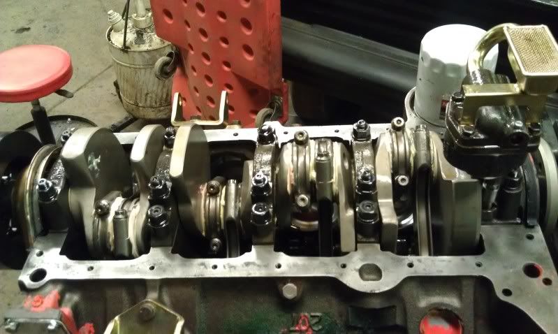

Motor is a fresh 358 with Eagle crank, rods and JE pistons.ARP main studs, head studs etc. Its gonna be running Megasquirt 2 with wasted spark.
Still need to paint it and get rid of that orange.

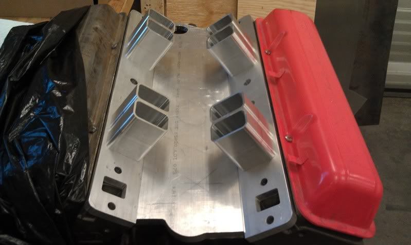

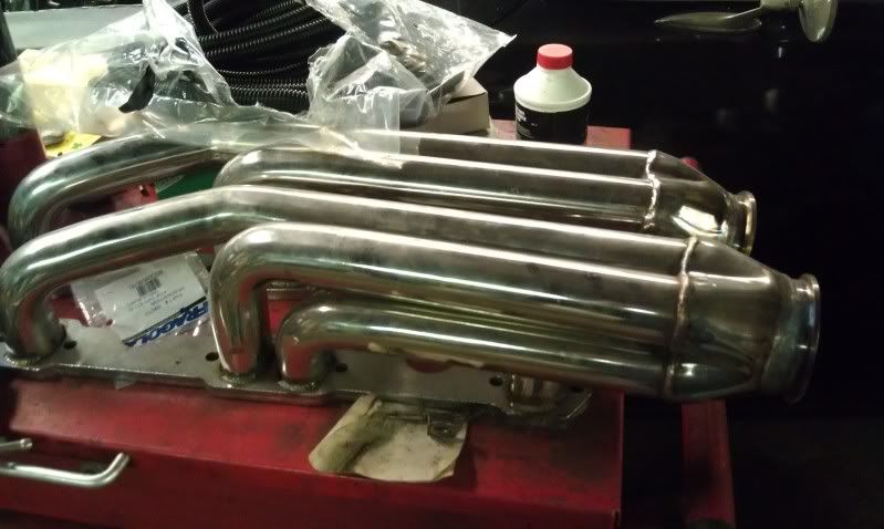

Ebay manifolds with some v-bands welded on.

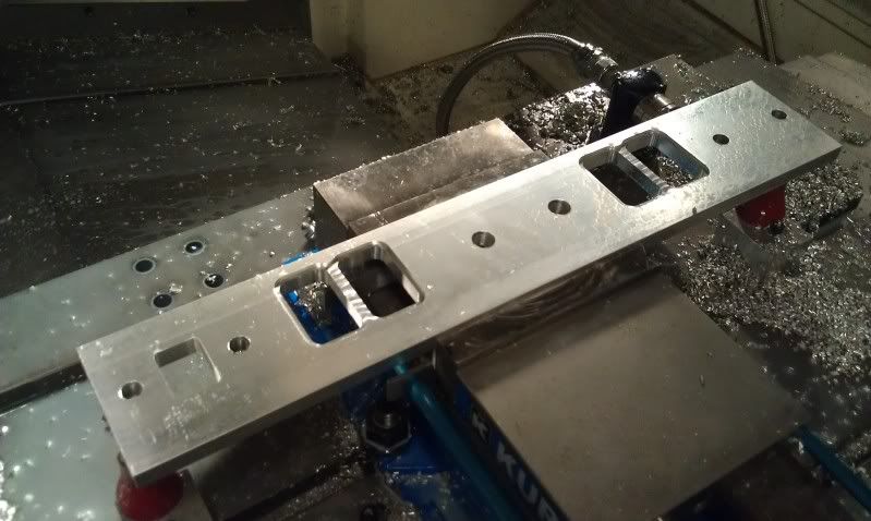

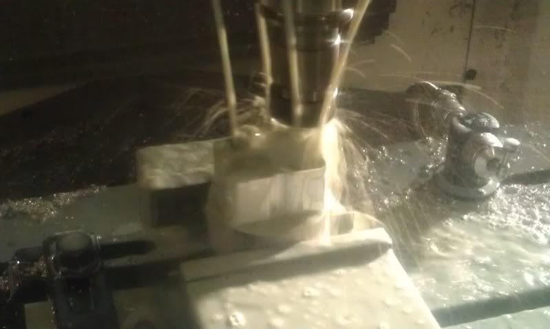

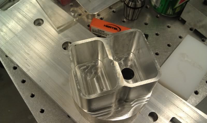

Fabbing up an efi manifold for it. I'm also using this car for my senior project which is tunable PWM water/meth injection.
We have three days scheduled to get a good tune on the car then do testing on the water/meth injection starting sat march 31st, so this is gonna move pretty quickly.

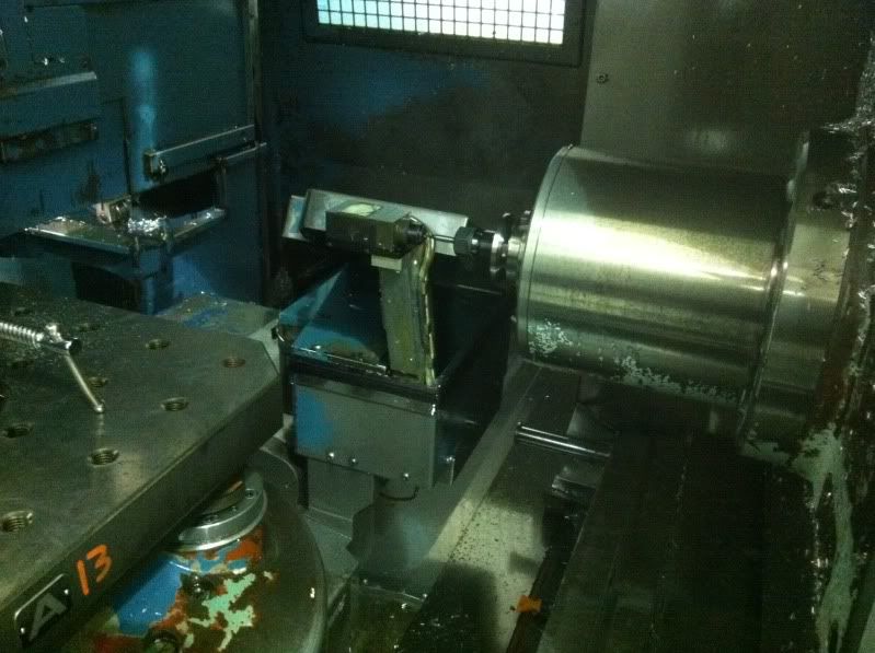

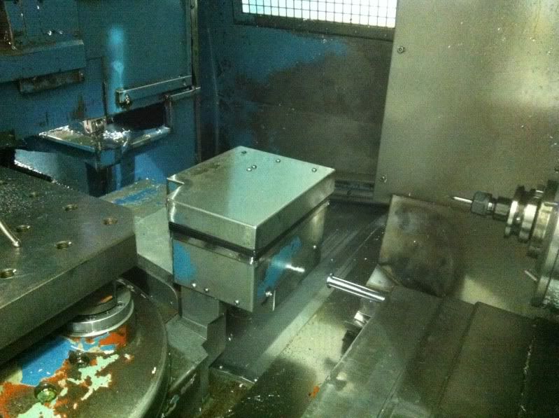

How do you keep chips off the tool setter? Or do you just use it for initial length register (you would obviously be able to keep it clean then) and not for tool life management?

I have never used the probe. Probably cause I don't know how, lol. When I change a tool out, I indicate it the old fashioned way. Is it supposed to covered or something?
Balls dude. Tool touch probes are so much faster, more accurate/repeatable.
Yeah mine are all covered, I'll try to snap a couple pictures.

Here are a couple pics of my tool probe on my hmc:
Once you use a tool setter you never go back. If you need any help figuring it out I'm sure I could help.

tool setters are over rated, just another thing to get abused
 Faster to use a macro program to write the offset in using a block. The hell with guessing how far tools are sticking out to run the tool setter program, especially when setting fifty some tools back to back. However I could see using it if you used alot of regrinds to measure the diameter tho

Bull shit. Why are you guessing your tool length? Even manually a tool eye is more repeatable and faster.

The Rienshaw tool setter that I have used requires you to give an approximate length before you run the tool setting program,  this way it rapids a few inches above the tool setter, feeds down twice and writes the offset. Compared to writing a macro program using a unused g function "G14" for example, just about every machine that is in my work has the macro loaded and you just call up G14 in MDI, it writes the offset retracts the head and changes to the next tool. I have no problem settings tools within .0001 all day long off a 1-2-3 block.

If the block is calibrated to 1 tenthousandth your tool isn't going to set to that every time .0005 is about as low as I'd measure for sure before you start to get strange shit fucking with your numbers.
