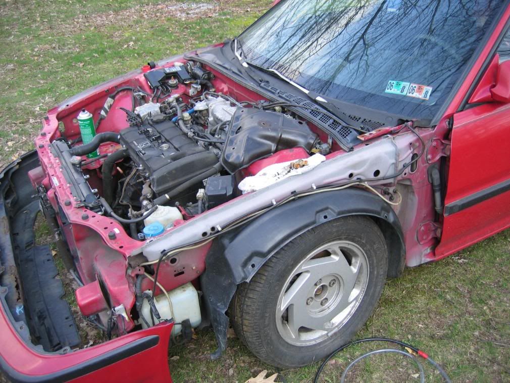

I bought this pos as someone's failed b16 swap.
I fixed the ls that was in it and slowly got rid of the altezzas, projectors, z3 fiberglass fender shit.
Sold all of that and eventually the b16 to fund the project.
Added an HX-35 kit and blew a few pistons.
Sold a local a chipped ecu, 3 bar, 450's and tuned his ls/vtec.  He hit a pole a couple weeks later so I bought the swap (with all the extras) for stupid cheap.  Sold off the extras, had the mount welded on the block, and sold that too.

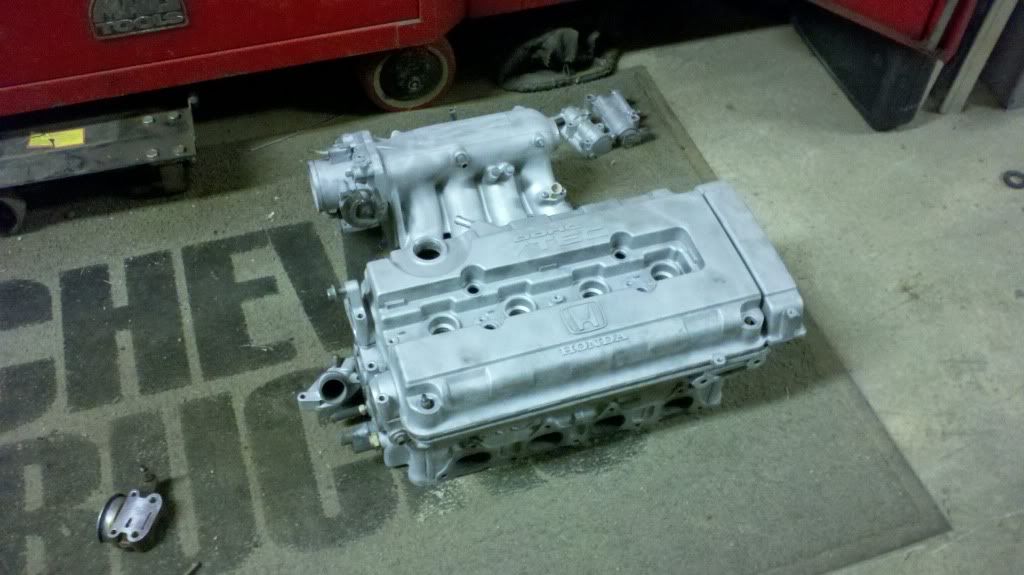

Cleaned up the head

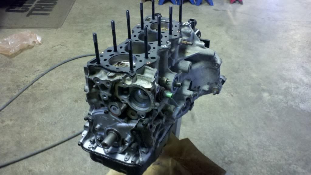

Rebuilt the bottom end (first one, hope she lasts)
Picked up a set of arps for $40

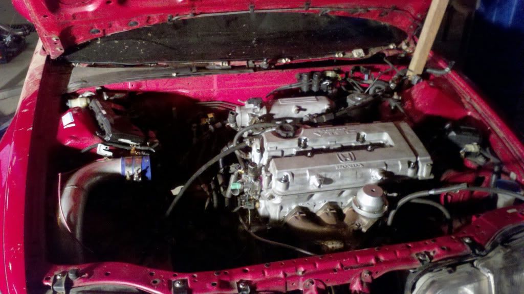

Then I was in the right spot at the right time and picked up a b20z for $30  It even had a moroso oil pan still on it.
Threw it in late one night.

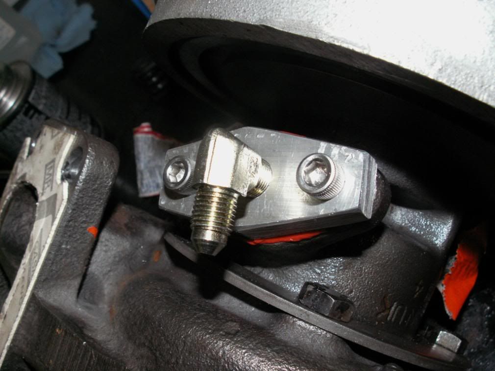

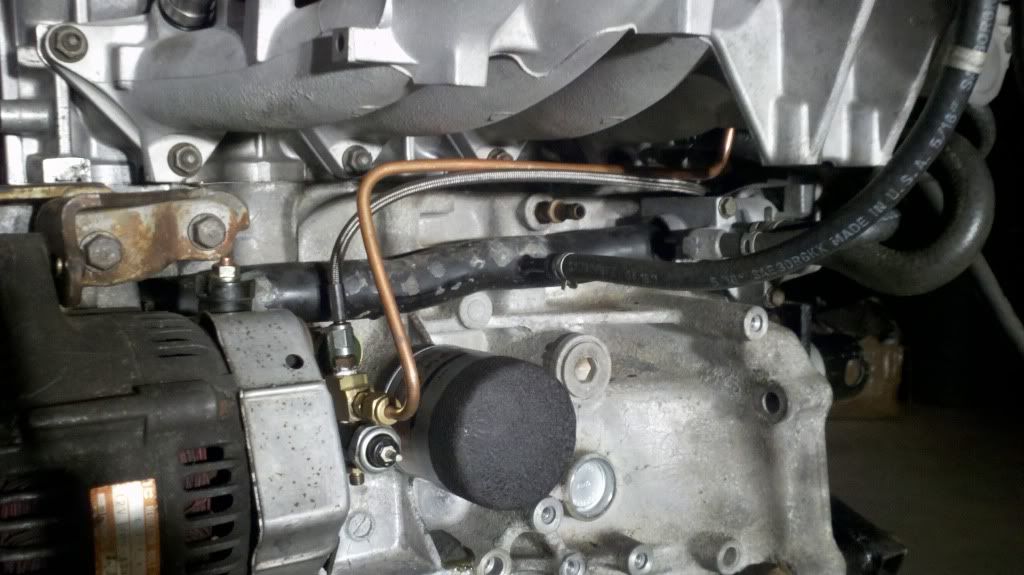

I ran a ghetto oil line for the vtec, still have to test if it will have enough volume.  I haven't reved it into vtec yet since its not tuned.  Hell I havent even wired it up yet.

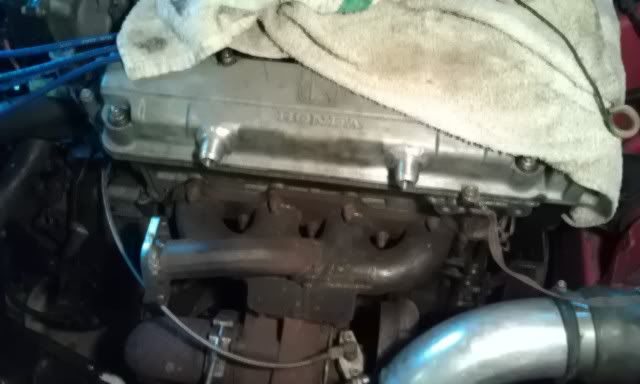

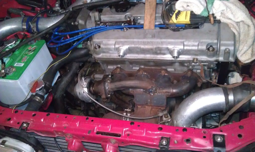

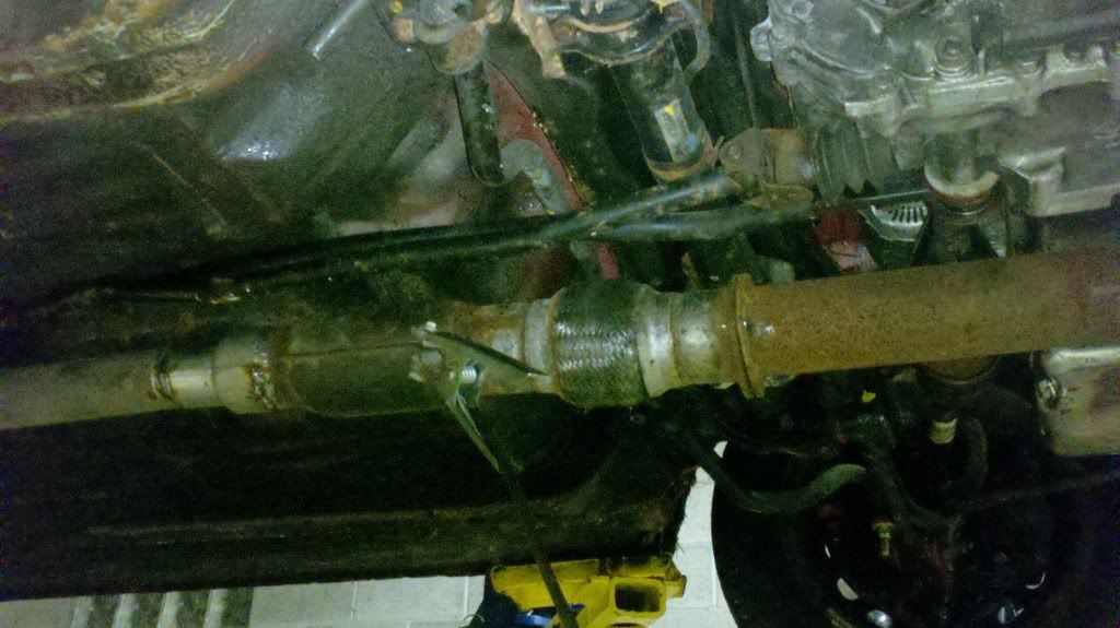

Welded a vband onto the turbo outlet, got tired of drilling and tapping broken bolts anytime I had to pull the exhaust.
Of course this killed the tiny bit of clearance I had between the rad so I threw another manifold on.  It wasn't any better so I had to 'fix' it.

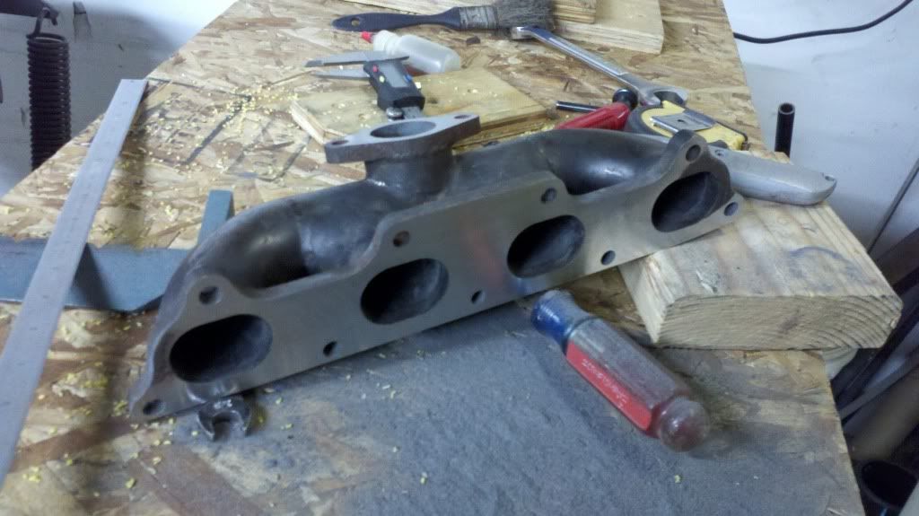

I warped the shit out of the manifold.  had to sand about an 1/8" out of the center to get it flat.

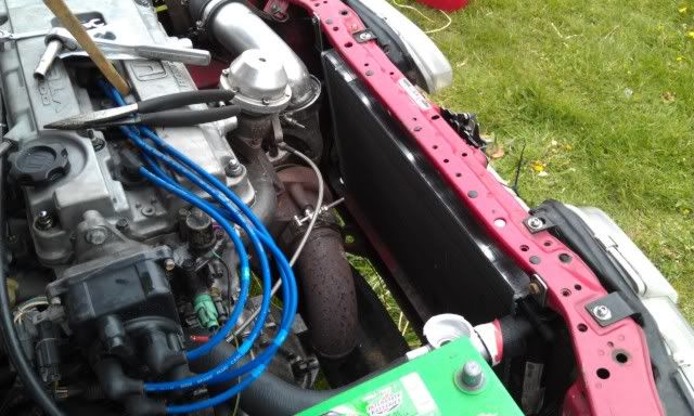

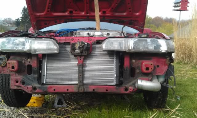

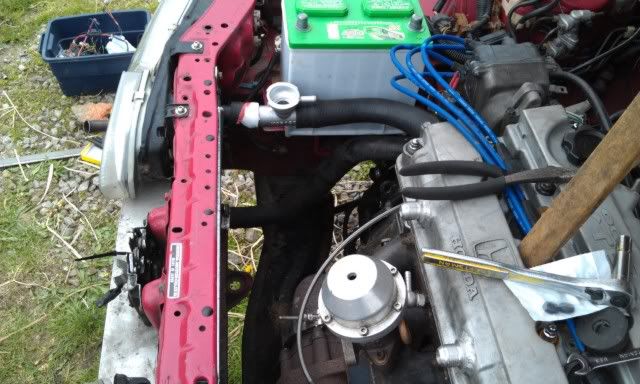

That was last year sometime.  Today I finally got around to pulling out the half rad that fit like shit.
Threw in a vw scirocco rad, fits like it was made for it.
This was ripped straight from a thread http://www.realhomemadeturbo.com/forum/index.php/topic,2391.0.html
Thanks, ratcityrex

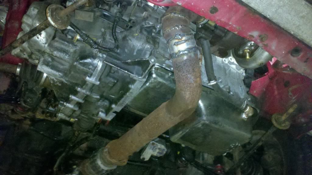

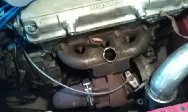

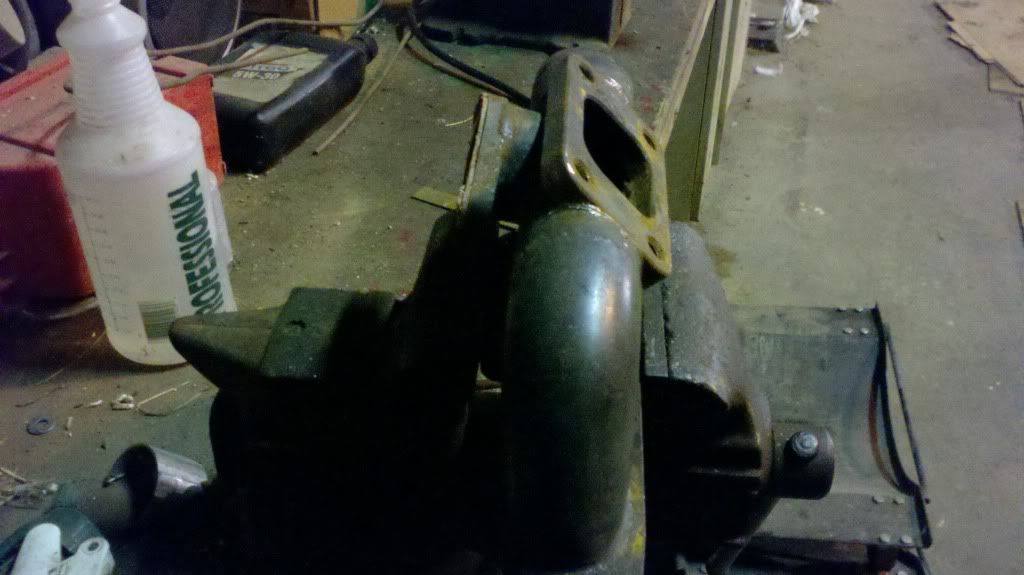

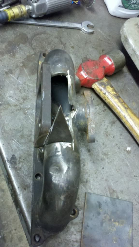

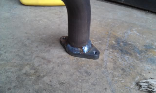

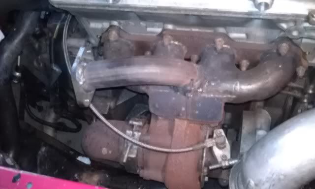

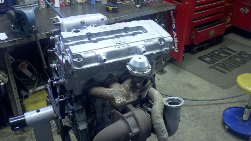

Ive been wanting to connect a boost solenoid to the top of the wastegate, and install my new hood.  But every manifold I've had needs the webbing of the hood hammered to shit.  So once again I had to 'fix' the manifold.

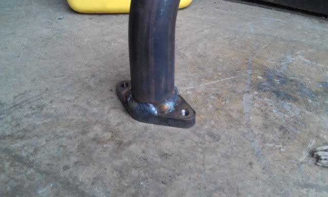

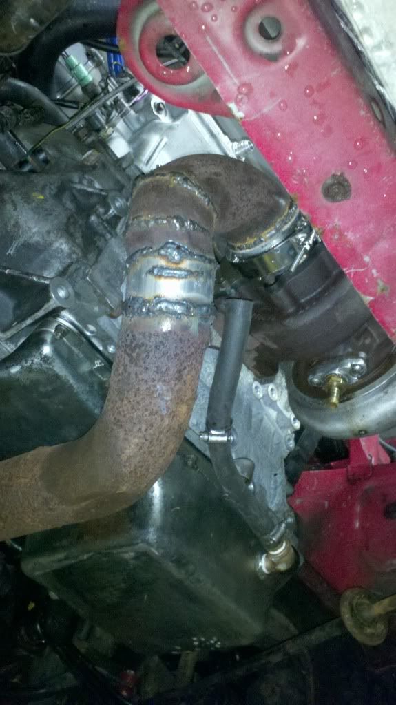

I cut the flange off, and the tubing undernieth was much bigger than the elbow I was using.  I had to cut a bunch of slits and hammer it smaller.
Then I welded the flange onto the other end of the elbow (random chunk of a stock h22 manifold)
Few more wires to connect and then get it tuned by Tom

Haha thanks guys. I just hope the wastegate tubing isn't too small and fucked up of an angle. Also hope the.engine stays together.  I still have the.b20 on.standby, and a semi built badass engine sitting on the shelf, so I'm not real worried about it.  Roller Vids will follow soon.
Re: 92 Integra, lsvtec, holset, take 3
« Reply #4 on: April 15, 2012, 09:28:13 AM »
Tubing size looks ok, but it looks really far from the manifold. I don't know how the gas will like to go that far.
I like the build. Probably because it looks like my first attempt (success attempt ;) ) to boost my red integra!

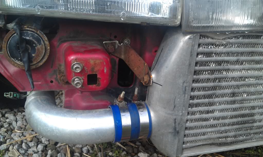

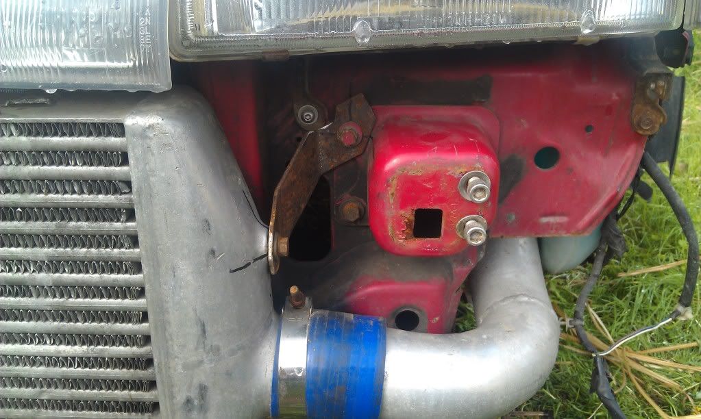

Forgot to post pics of the intercooler mounts I made.
I couldn't get the zip ties off so I had to cut them. I've been reusing the same ones I put on probably 5 years ago, I think you can see them in the pics with the orange duct tape.
Anyway I had a cutoff wheel, drill, and hammer.
I could probably stand on this bastard now.

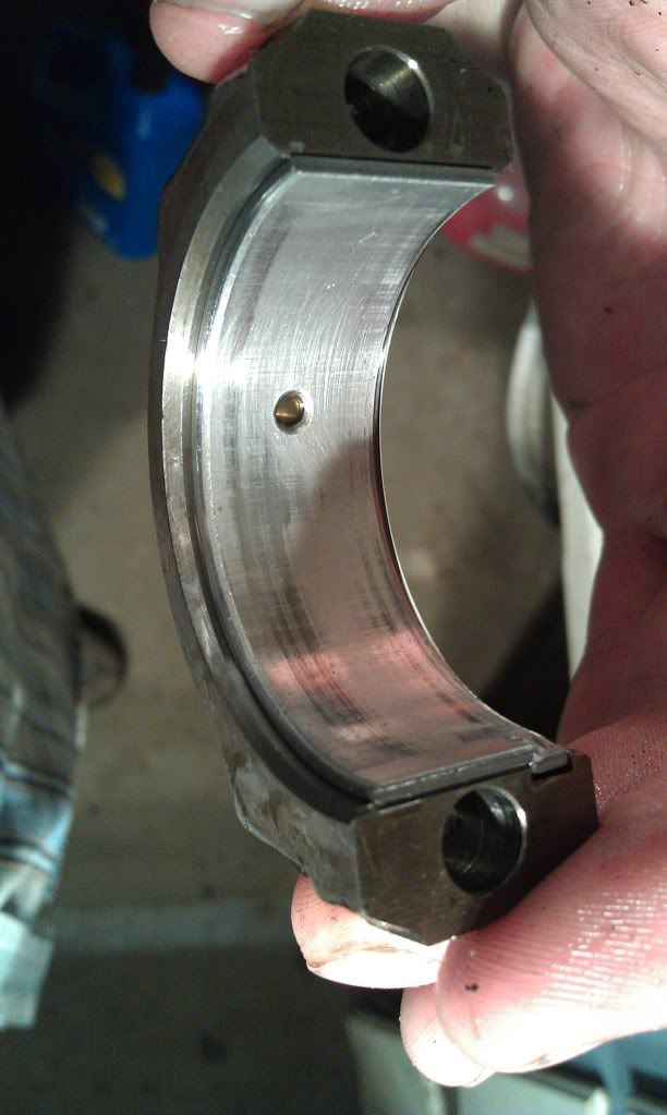

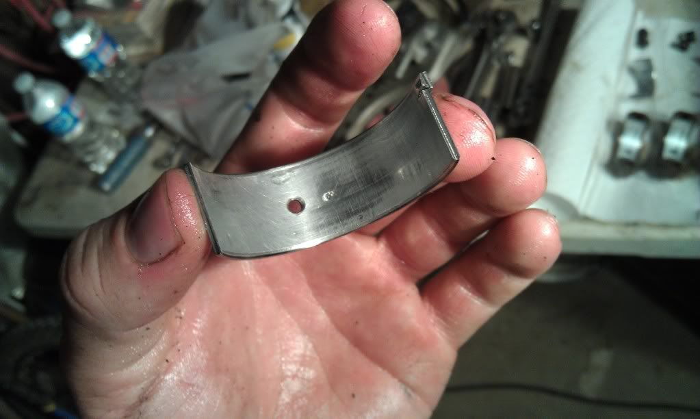

Pulled the pan to plastigage my bearings cause tom had me worried.
They were all wearing fucked up, glad I checked.
He thinks they were too tight so now I need to swap in a looser set and recheck.
I'll post some shitty pics later.

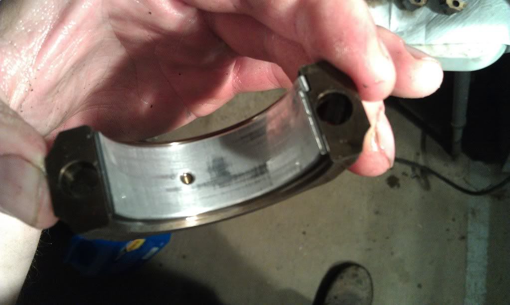

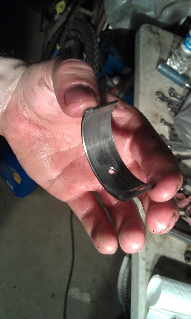

« Reply #8 on: April 20, 2012, 11:07:16 AM »

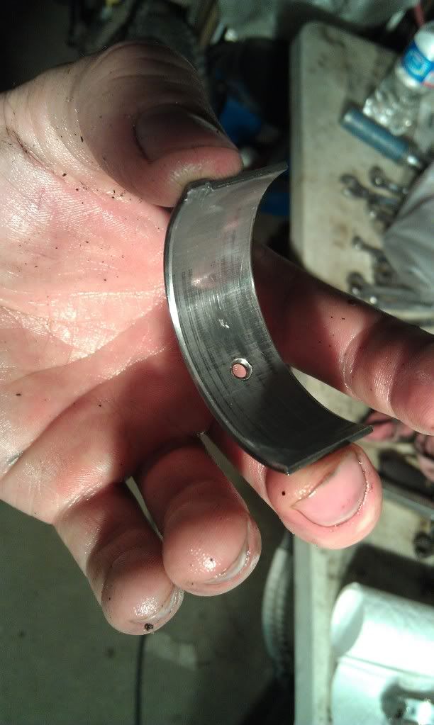

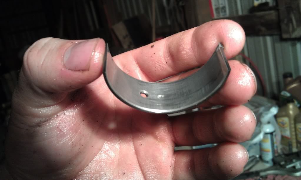

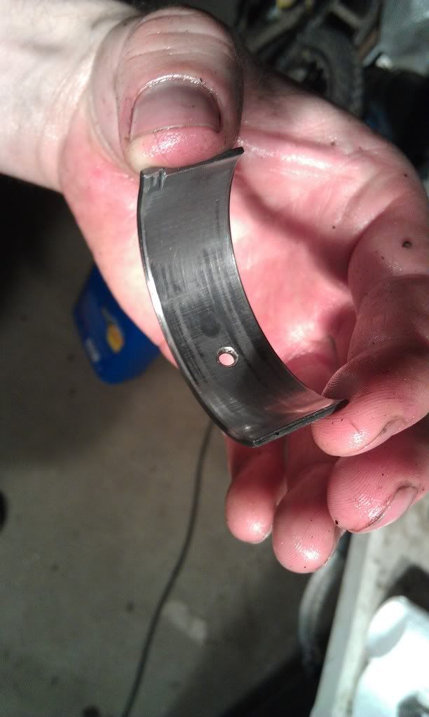

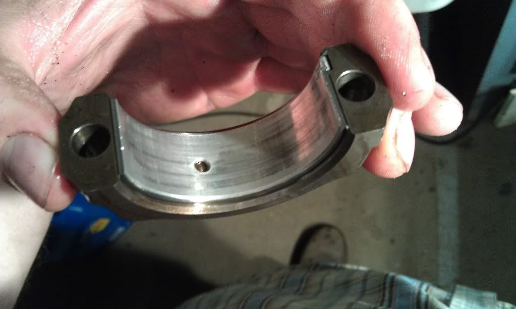

Ok check these pics out and see if they tell you anything.
I'll try and get it back on the lift and plastigage them to see what that tells me, but maybe these marks will tell someone something.
  • Posts: 6864
« Reply #10 on: April 20, 2012, 04:49:15 PM »
Looks normal, maybe use a bit more assembly lube next time, but looks OK to me.  :noel:
JaredKaragen
  • Posts: 364
« Reply #11 on: April 21, 2012, 03:20:19 AM »
Looks ok...  But;  if u have a bore mic, check the rod end for roundness...  And crank journal.  If all is ok; should be fine.

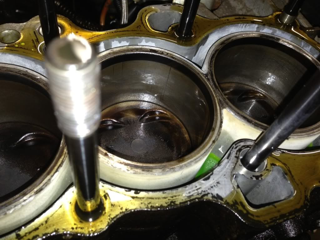

« Reply #24 on: May 26, 2013, 04:45:13 AM »

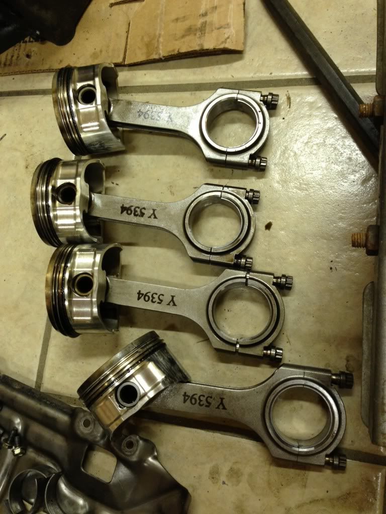

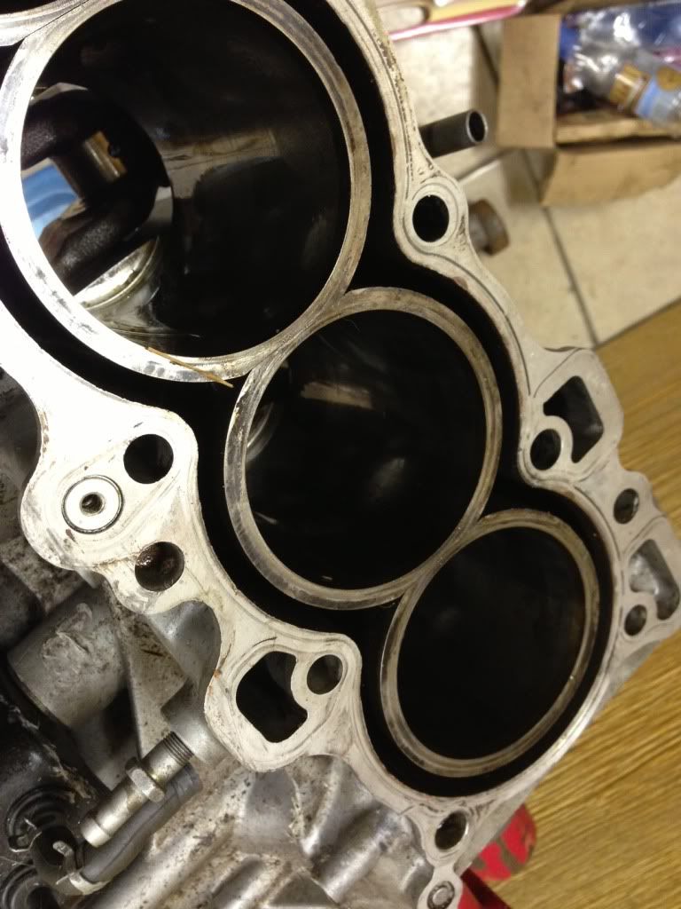

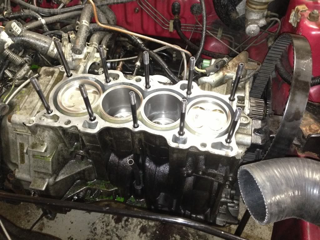

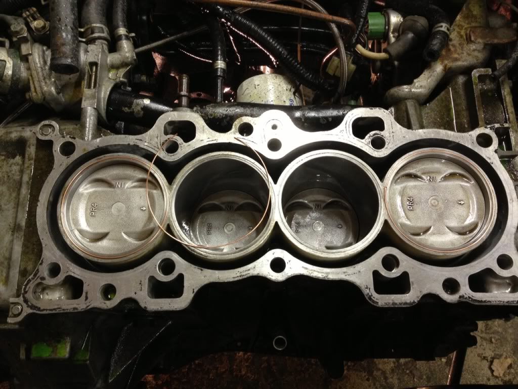

Still haven't had a chance to crank the boost yet, doing some little shit that is taking way to long. Car has been down a couple weeks.
Bearings looked like they just came out of the box, cyl 3 had a huge scratch from some unknown reason. Slapped it back together fuck it.
Buddy bought a bottom end I was interested in last week while i was on vacation. Dropped it in my garage and said it was mine? Supposed to be forged rod piston with a smoked piston and bore. Turns out it was 3 smoked pistons but it was a sleeved block no one knew about, I'm pumped. Need to measure the bore and see if it is usable.

Thanks Quadnie, I have a love hate relationship with this car.  I pile parts and plan things, then throw the nice shit on the shelf and last minute slap something together instead.  I'm weird like that, Fuck it, this engine was only supposed to be last summers build anyway.  Car is turning into such a hack job but its fun to beat on.
It finally runs, no pictures worth anything of course, but some of my scratched cylinder and shitty practice oring job.
Going to take it to Tom tonight and see what breaks er maxes out first.
