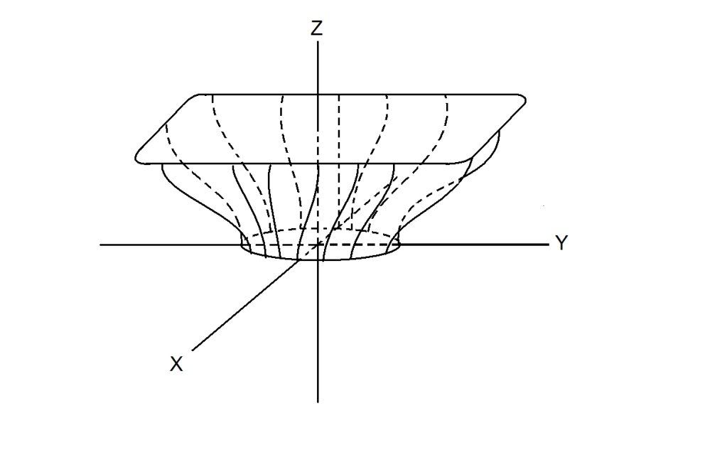

Second part
I also wanna build a fiberglass funnel looking thing. Basically it will be a funnel that has an oval on one end (to hook to the oval opening of the miata bumper) and a rectangular exit to hook to my first heat exchanger. The purpose if this is to direct air flow through the heat exchangers and to maximize the pressure differential across the heat exchangers as to maximize cooling potential at all times. The goofey shaped thing will help increase pressure in front of the heat exchangers. Called Bernoulli's equation. You smoothly slow the air down and it compresses.
Anyways, I'm thinking I'll build a big block of foam, sand it with a rasp and sand paper till it's the right shape, then wrap it in something and glass over it, then pop it off of the mold and whalah.
So how would I make a big foam thingy that's like 3'x2'x1'? Lots of triple expanding foam?
Terrible pic of what the funnel thing will look like.

Reminds me of how bathtubs are made but with a vacumn pump. ;D

Go to the hardwaye store and ask for a dock flote. Like the ones you put under floting docks on lakes. I think they are 14"x24"x96"
I use to sell them at my lumber yard I use to work at. Or you could go to home depot and ask them if they carry anything/order anything. You could always get a 2"x48"x96" sheet of the pink stryofoam and cut it down and glue it together and start shaping it to the size you need.
Just my .02

speaker box fabric works good for custom fit stuff, i don't know if that is what you are looking for, i always glassed right to the shit

I tried pink foam insulation and it was a pain to cut as it liked to break in chunks when cut. I still have a pretty big section in my garage I may try again to build a tank for my bike.

make a heated wire knife
piece of nickle chromium wire and a battery charger

I always used a wood coping (i think thats how its spelled)saw, and then finished with a file

if the big foam block idea is not what your trying to do just lay some tin foil in the trunk then get some of that foam shit that you mix together (i think marine stores carry it) pour it in, then wait for it to cure then remove it sand it down some then fiberglass over it with tin foil on it and voi la you have exactly what your looking for that would probably be the easiest beside what ratcity said
to hook to the oval opening of the miata bumper and a rectangular exit to hook to my first heat exchanger.
IN the trunk would be great if thats where he was working  ;)
Hes kinda working on the other end of his car.

You know, this makes me realize a potential problem... If I did what you're saying, I don't think I could get the big foam piece out because the opening to the trunk isn't that big. That said. I'm not sure if I do this the tank will be removable.  :somb: Gonna go pull some measurements. Might have to make this a spec smaller, or one side square so it's narrow enough one way to go in.
