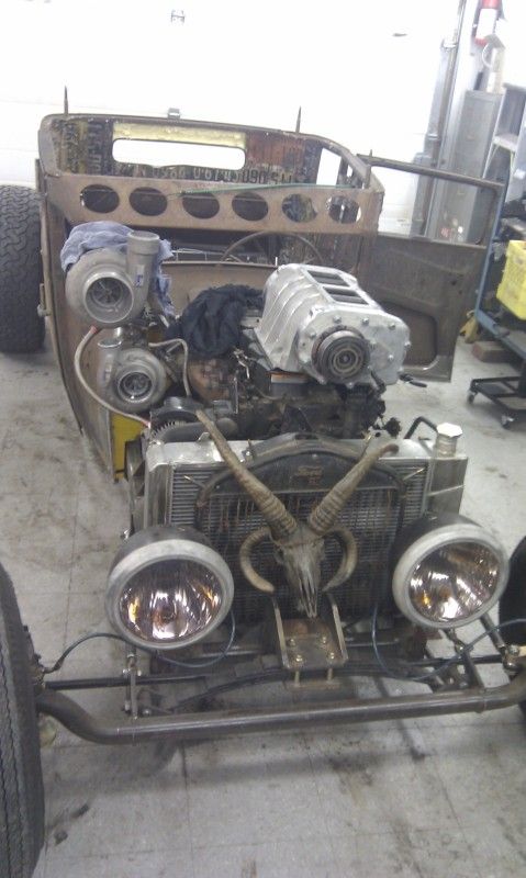

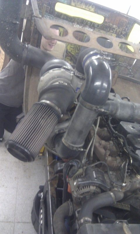

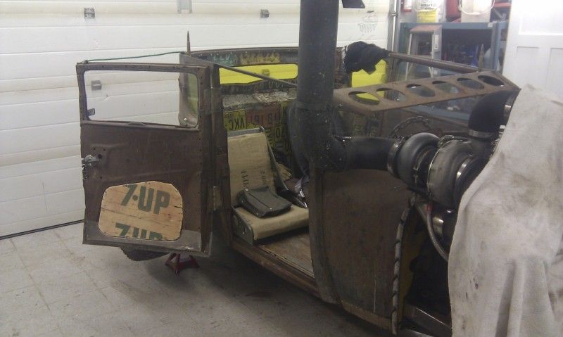

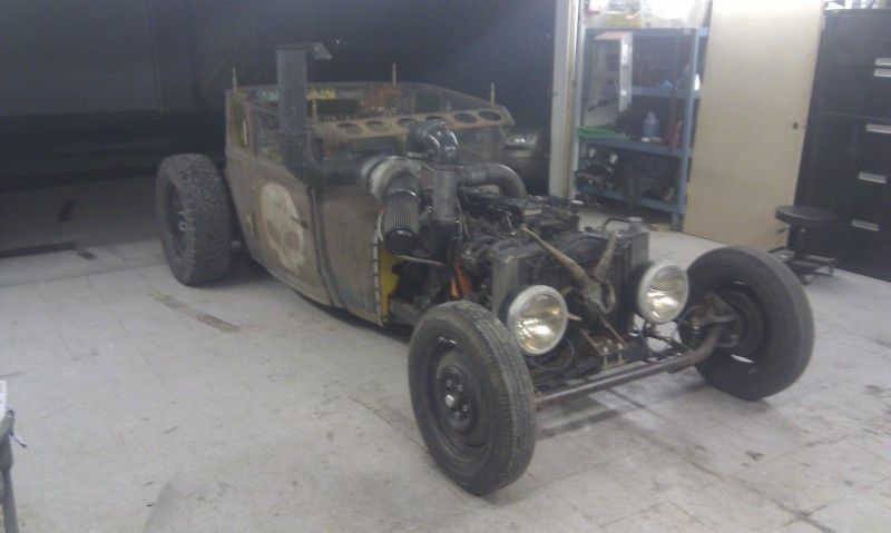

Sorry don't have any build up pics, in fact I just snapped these tonight after doing some tuning. Other then the body shell this was 100% hand built in his garage over the last couple years. He just got it on the road about a month ago and we have been doing a little tuning. It is probably about 450hp /900ft-lbs right now and weighs about 3000lbs. On our quick little test run after putting injectors in tonight it made 60psi of boost (was still climbing fast) with a quick stab of the throttle, the head lights are pretty iffy, and it is scary enough when you can see. Runs a Jag IRS rear end, and a 94 cummins 5.9 12v, with a 47RH transmission.

That is as RHMT and rat rod as possible. Solid work. Can we get better engine pics? Maybe a ripper vid?

Looks like every other cummins 12v out there.  :P Yeah I will try to get some clearer engine pics this weekend.
Same with vids, we are supposed to do some early morning tuning on Saturday. So I will try to get a ripper vid then.

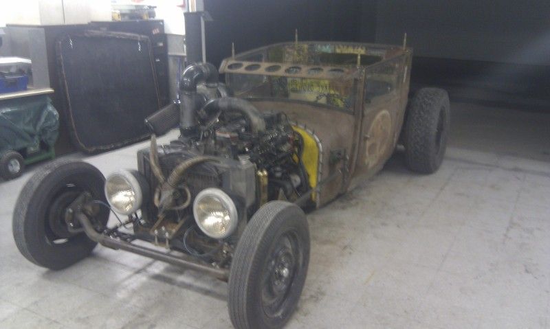

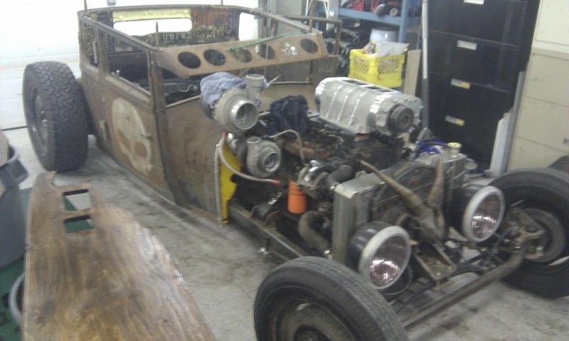

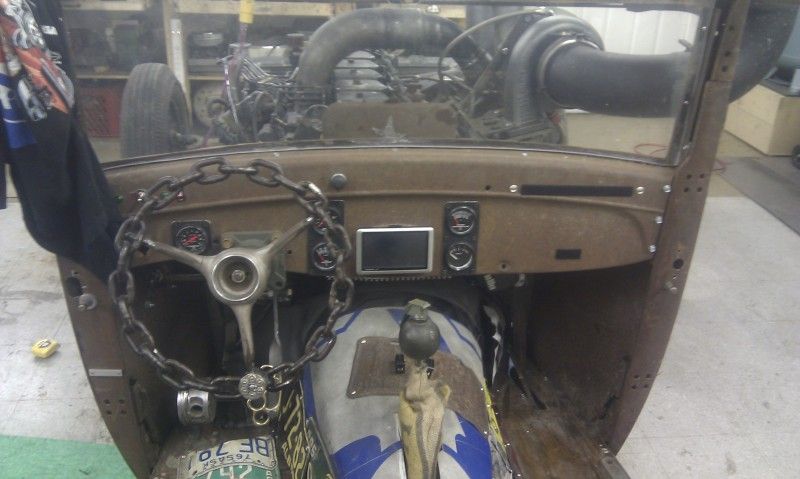

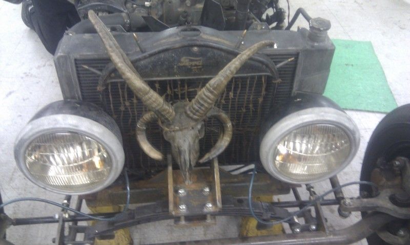

I was over there again tonight we were bumping the line pressure on the transmission, hoping to get it to live for the summer. I couldn't remember the year when I made the OP, but it is a 1927 coupe. Here are a couple more pics for people that asked for more. Didn't do any test drives tonight so no ripper vids yet.

looks like a deathtrap hope that thing is gonna get some harnesses :o might have gone a lil overboard with the random ass trinkets/junk though that said i'd drive the shit out of it.

It is surprisingly stable, but nope just staying with lap belts.

Love the barb wire grill.

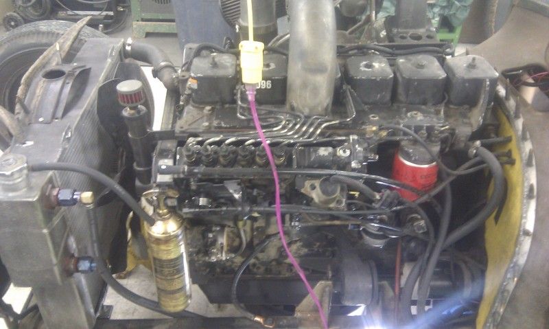

T4 HX40 secondary, HT3B primary, 7x0.010 SDX sticks, Mack rack plug (just put it in haven't run it yet since) no plate, 4kgsk, and about 20 degrees of timing, on a 160 pump. The owner monkey'd around with the afc some as well, but it hasn't been modded or setup yet.

Here are a couple earlier pics when it was still under construction (forgot I had these) Shows the turbo's a little more clearly. The owner was throwing around the idea of building an a/w intercooler into that blower case, and using the pulley on the case to drive a water pump for the setup. Ultimately he decided it was already hard to see out of it, and with that big blower case right in his field of vision it was better left as it is now.
