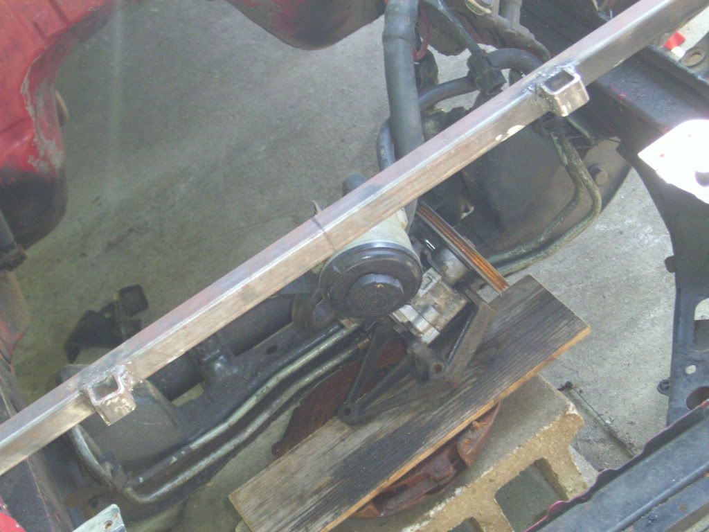

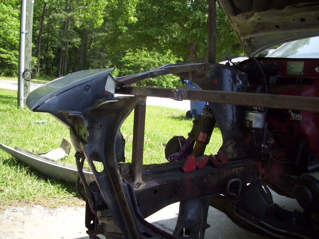

I'm working on getting the He351ve in the mix on my car.
So if I do this
I have to move radiator and cut a lot in the new radiator support .
If I do this
I do not have to move the radiator, and I have almost direct line to the exhaust.
Problem I see is may have weird oil drainage angle.

I think the thrust bearings will last about 2 minutes and then you will have a garbage turbo like that.
Re: Turbo Mounting Idea
« Reply #2 on: April 26, 2012, 01:44:26 AM »
So what is the min. angle I should use?  :noel:
« Reply #3 on: April 26, 2012, 01:47:09 AM »
No more then about 15-20 degrees from horizontal in any direction.
« Reply #4 on: April 27, 2012, 09:26:45 AM »
i believe garrett suggests no more than 15 degrees.
the twin charge setup i did a few years back was 10 degrees.

What about changing the radiator to the VW one that fits under the front t bar?
« Reply #9 on: May 01, 2012, 08:16:10 AM »
Thought about this until I got the turbo in and a lot of it tucks under the support.

« Reply #12 on: May 01, 2012, 09:51:10 AM »
Please tell me you are going to support that silly turbo from something other then just the flange on the manifold.
« Reply #13 on: May 01, 2012, 11:11:13 AM »
Yeap the compressor housing is up against the supercharger all nice and snug.
With it located like that in the pic, what about looking for a radiator that can fit under the front rad support.  Im sure theres something out there.
