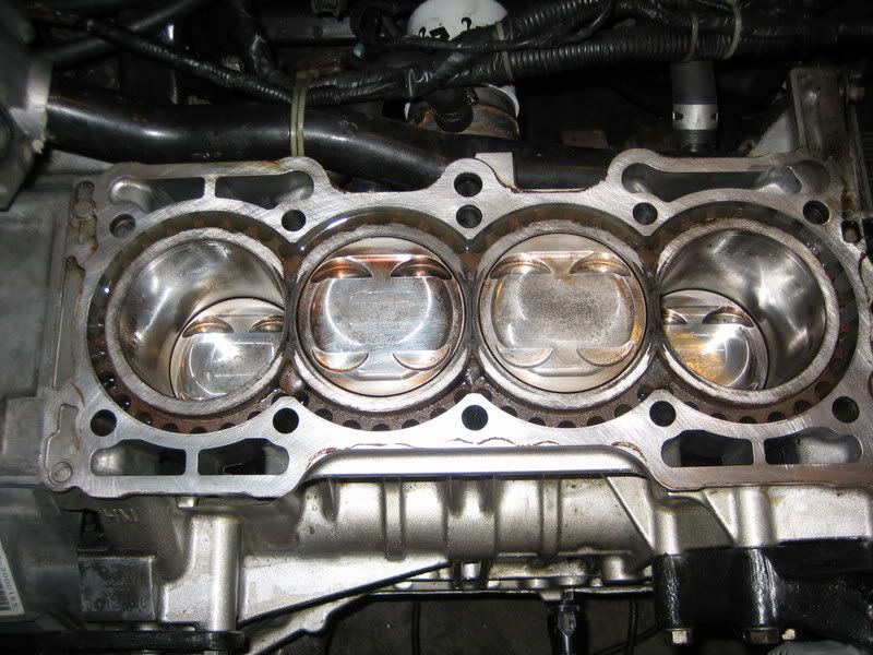

Narf, that looks like a lot of protrusion on those rings, what were they set at?

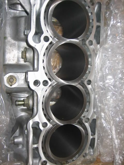

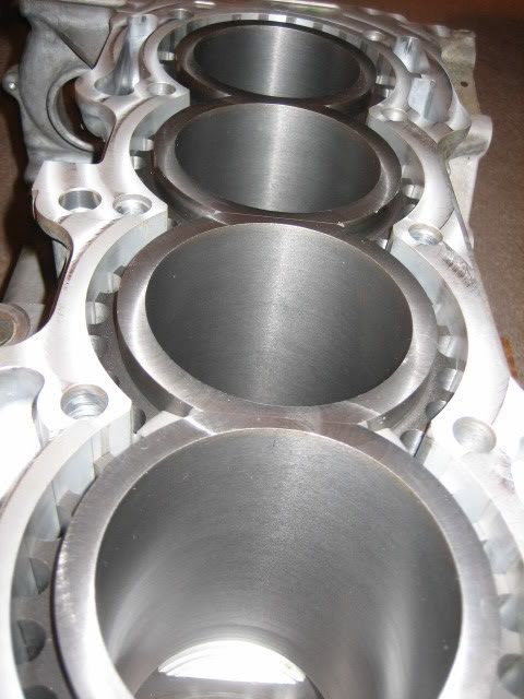

Standard GE HD sleeves with O-ring grooves... The Supports sit all the way on the top of the shelf thats machined in the block to receive them. They CANNOT "sink". The Supports are about 2 inches tall, its not just a thin ring around the top of the sleeve like a Darton. Nor do they leak like Bensons Dartons (which I have seen wiith my own eyes, as has Ross).
They use a .002 stepdeck.
Same shizz I got. I sent them a block (UPS on me)... For 930 they sent me it sleeved back in 3 weeks. K and H motors they charge an extra 100 to sleeve... I got mine done through CAMP 1320, Tom had a deal with them where it was actually cheaper to cgo through camp than directly through GE.
I didnt have them do any machining other than the stepdeck. Didnt need to have a line bore or anything after getting it back.
Solid.
Still in the wood crate they shipped it back in
Last time the head was off a couple years ago:

What is a stepdeck?
Re: UI's 703hp Purple beast - She is injured
« Reply #1250 on: June 23, 2010, 01:53:49 PM »
What is a stepdeck?
Just like what it sounds, there is a few thou taken off the area of the block where the fire ring of the head gasket sits, so that when it is clamped it provides more of a mechanical seal.
A true fire ring setup they do the step deck, a receiver grove in the head, and then cut out the fire ring in the head gasket, and use a wire fire ring.
All just different approaches to keeping the cylinder pressure, in the cylinder.

Actually its the opposite, step deck is when you machine the area outside the sleeves about .001-.002" lower than the sleeve deck, so that the sleeves sit higher than the rest of the block.
I might be doing a engine pretty soon here where I will do a true fire ring, and no headgasket at all :D
