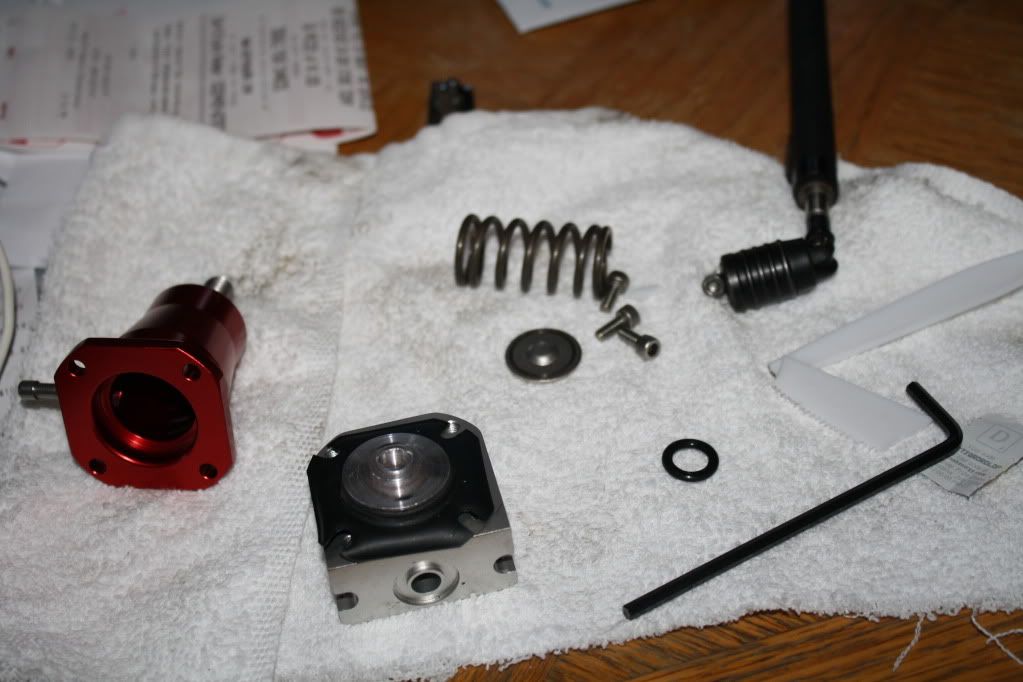

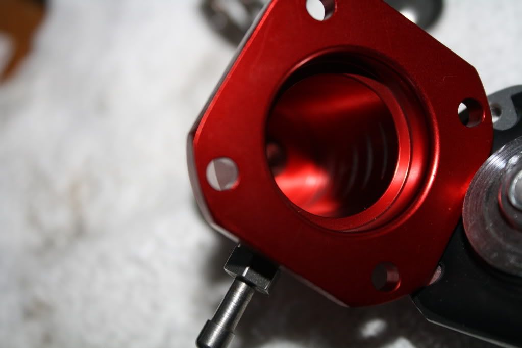

But I pulled apart the FPR, it looks nice and clean, only concern is that inside where the spring area is. There is grooves into the housing where the spring is sitting.
They are at least a couple thou deep. I found another gauge I will throw on and see fuel pressures, might just attach a barb, put some re-enforced hose from my fuel fail
into my car and see what it does for pressures.

Weird eh? Spring riding on the side of the fpr?

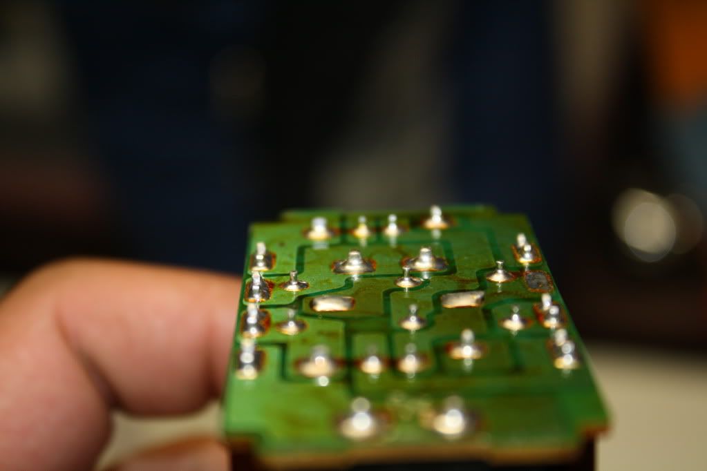

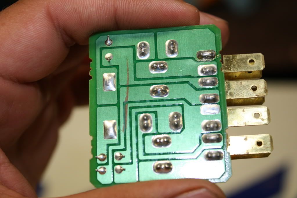

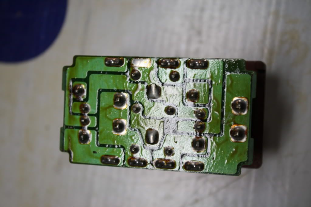

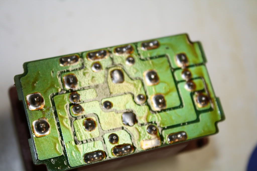

I pulled apart the main relay. and there is some weird brown gunk shit all over on the board soughter board.
It smells like the fucking ecu I fried, I will post pictures of it tonight when I get back from class. Also changing plugs because Josh thinks

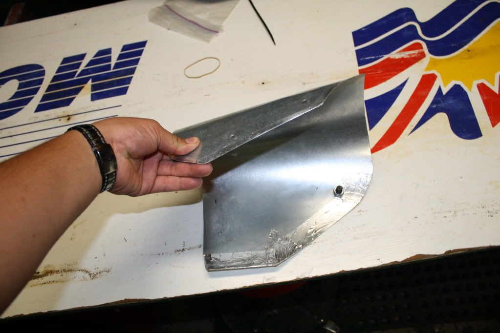

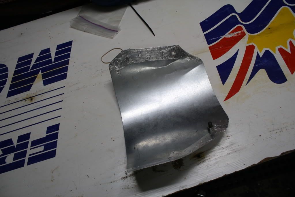

Ok so my friends dad is a sheetmetalist by trade and made me this in about 10 minutes of actual work.
Took 3 prototypes but we got it done.
pics are just of it alone, non yet of it installed. hopefully tomorrow after I change my main relay and plugs.

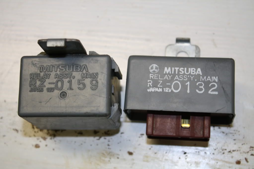

main relay pics. see that brown gunky shit? Meaning bad relay perhaps?
mine is 0132
Apparently clean one the 0159

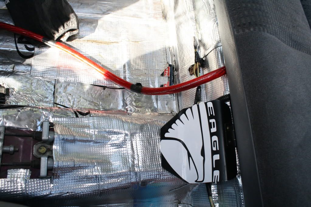

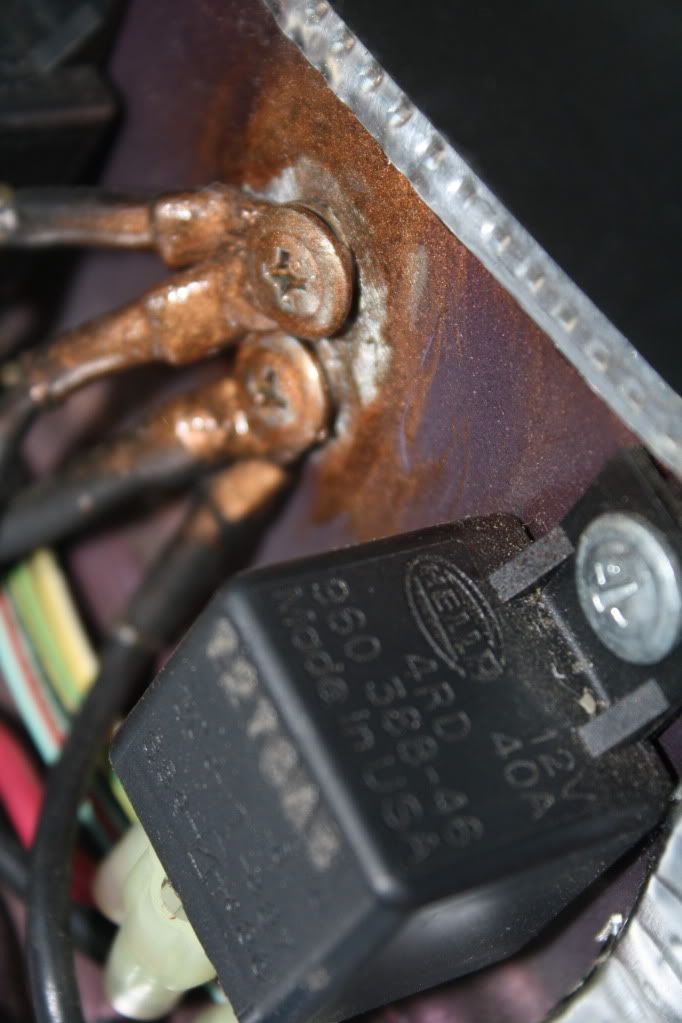

Fuel pump relay & ground before i knew what a ground was ground.
I am going to just piggyback that 1ga awg wire for my fuel pump ground. Should be good, no need to send another bunch of cables to the front of the car.

that brown shit on the board is flux for the solder joints, an easy fix for a main relay on the fritz is to apply heat to all solder joints and allow them to reflow, sometimes fixes, sometimes doesn't

looks like some fat ass power cable there Levi!

Correct, Rob, he's n00b postless.  And wrong.  The only main relays I've seen that reflowing didn't fix permanently were EDs and DAs.
I cant use copper spray as a grounding material?
Is this true because I use that shit on everything
Where the fuck is your noob post faggot?
You said the same thing he did, so it is safe to say that it may or may not work on your car. So how was he wrong?  :?:
