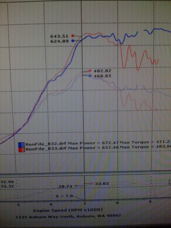

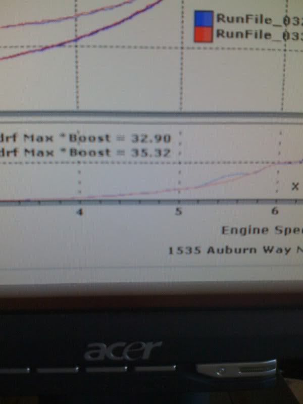

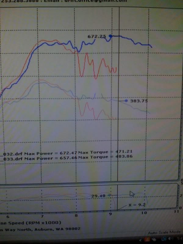

Here are the dyno sheets from the clown that said your sheet looks "lazy"  He claims his power (680 is what he calls it, OK Ill go with that much) at 26 PSI....
 Um no, in reality he hits 35+ PSI ( a tad higher on a spike actually) then it quickly falls on its face up top to the tune of 26, sooo he claims 26  (insert dunce smiley). He swares itll make 750 with a non chingy FMIC that I admit will help but wow... He claims he kills you everywhere... LOL... Not tyo mention this is on a Dynojet...  Albeit a KNOWN good oine thats not a dream dyno.  I had to ALSO point out that you were on a Mustang dymo as well... I dont know what his issue ie... I think you hurt his feelings and should appologize...  :evil: :evil: :evil: :evil:
Point is hes the same dood that was at the dyno day arguing that Tommys dyno was off since Joes car didnt make what it made at the "other place".  I dont want to drag them into this as theyre all really cool cats, and asctually so is Bryce (untill he speaks...  LOL, he knows it all)...but is it just me or does that graph look like shiiiiiiiiit.????
Like I mentioned out of the blue he texted me about how he layed his graph over yours and you only make 700 on a spike (looks more like you spiun a tad up top to me, as the line would have continued to where you got anyways... despite the bimmer fags claiming it to be a lean spot caused by letting off the gas and the TB closing causing it.... That shit almost pissed me off enough to get an account ovfer there but I couldnt stop laughing at those poor queers... hahahah
Bryce just talks alot... He got a bit lippy about how hes supposedly the fastest guy up here behond Kevin (SPeedfactory 9.50 car that has 8s in it)...  But I assure you it took him SHITTTTLOAQDS of pases and a couple motors as tens illuded him for a goooood long minute... Actually a good long minute and ALOT of passes.

damn I'd say wheels spin it is. LOL if the throttle closed the gragh would hit the deck.
Ignition break up maybe? in that case torque would have just hit the floor as well.

Fuel and/or fire related misfire.  You get to a certain airmass where the AF mix is too hard, or too rich, to light off for the ignition system.
Looks like a nasty car that needs a tiny bit more work, but I wouldn't be calling out anyone whose car runs correctly under power.  He gets off that inertia dyno and tries to lay that power down in 4th gear on a track and it's going to start breaking up at a "lower" power level because the engine is properly loaded.
