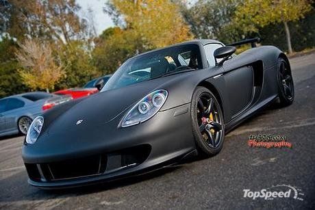

what do you think of color choice?
did you know those cars are not actually painted right? they are covered in a foil that said to protect paint, I've seen the R8 before, I have a friend who had it done to his new c class, and know a guy who got it done to his ep3, because it was cheaper than actual paint, it cost 1000 euros to do on cars. 3m
 last i remembered it was paint. But i could be wrong..
Since i was going to paint my car that color. I'd hate to have paid $300 a pint for foil :-\
It's Satin Black!!
Tuned by you know who! ;-)
ScorpioMk
  • Posts: 13
3m scotchcal 85. comes in lots of colors.
most of those pictured are probably a nice black paint job with the flattening agent added to the clear coat.
Re: Urban Indians Build on the HX-52/2.0L GSR, 703hp 459ftlbs 35psi, 10.88 @124
« Reply #550 on: October 27, 2009, 12:52:35 AM »
I know. THAT IS WHAT I SAID
theidealone
  • Posts: 670
Its actually called "Matte Clear". Its a bitch to spray evenly. Its more commonly used to spray engine bays, and jams that dont have a shiny finish to them.
And I think Rudeboy was talking about Vinyl wrap. I saw a VW that was wrapped with argyle. It was pretty cool, but not worth the cash IMO.

Satin Black is decently easy to spray. I've sprayed whole cars down to small parts. I've always used a single stage to do it tho. with the flattened clear it is VERY hard to make consistent even for a really good painter. Any fluctuations in temperature make it flatter or leave it with more of a sheen in some places. with the single stage if you have a temperature controlled room you wont have a problem.

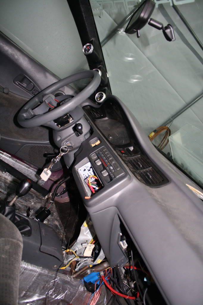

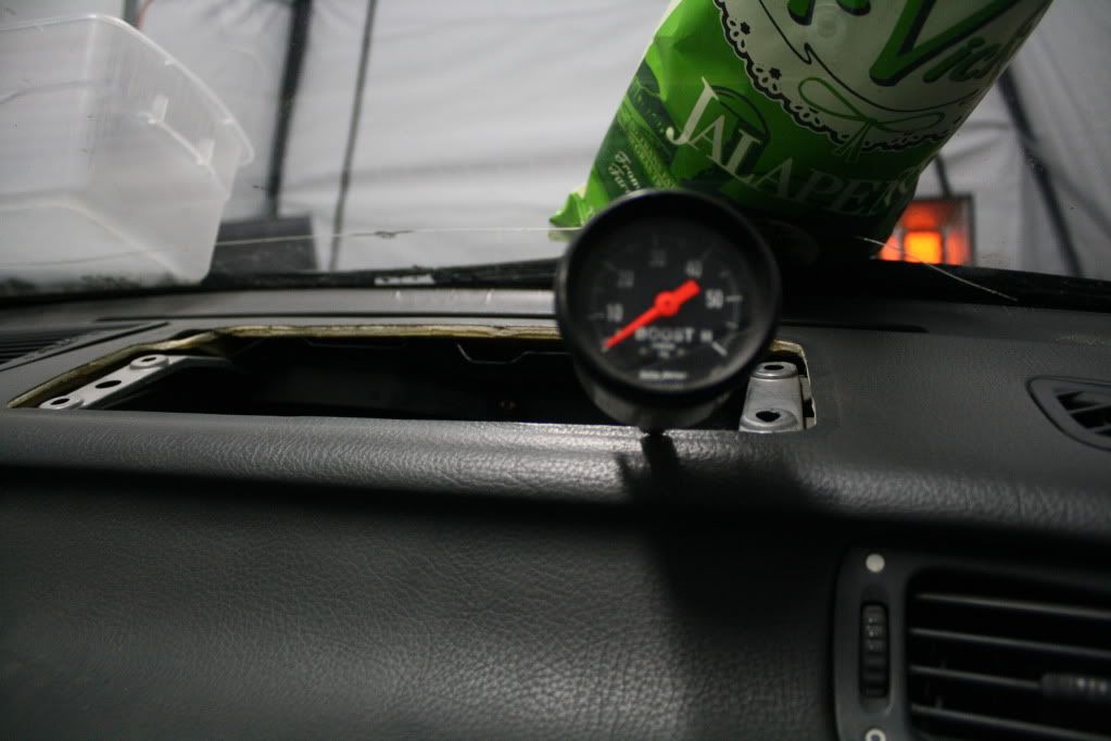

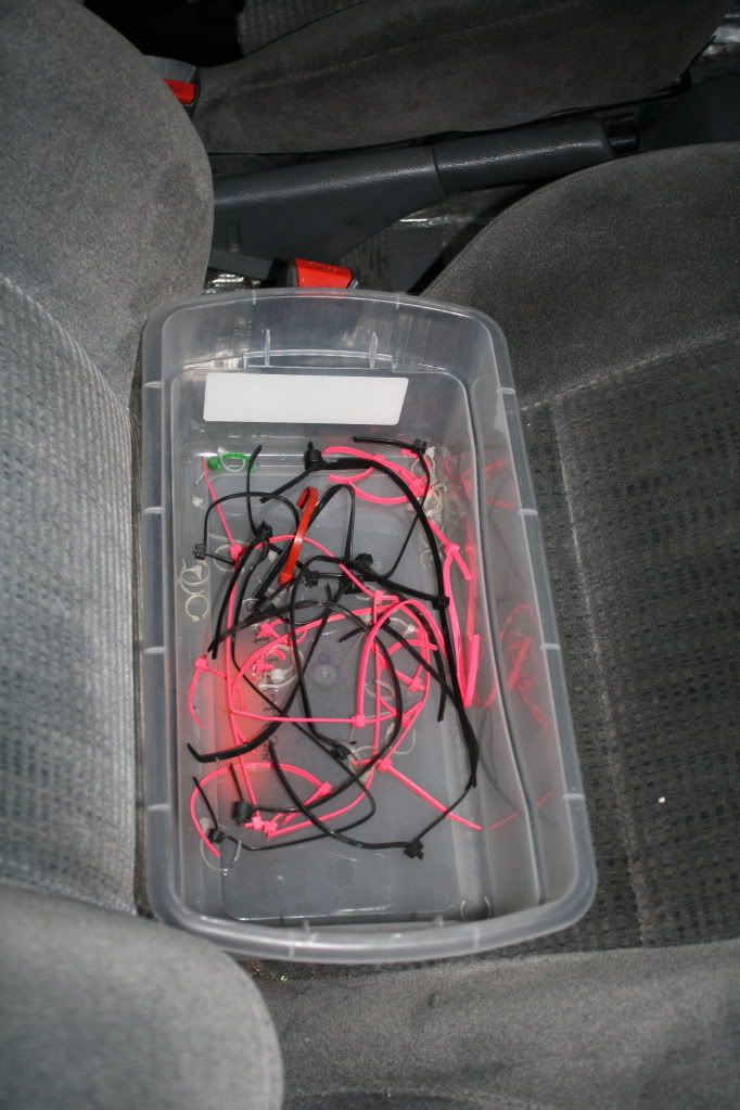

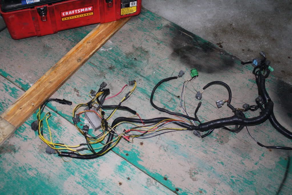

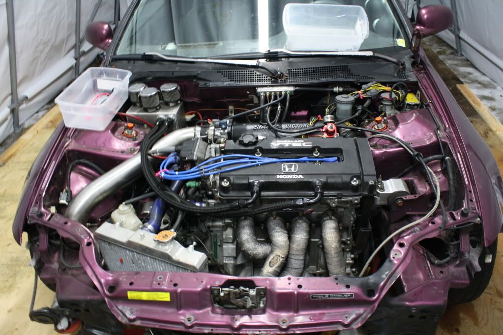

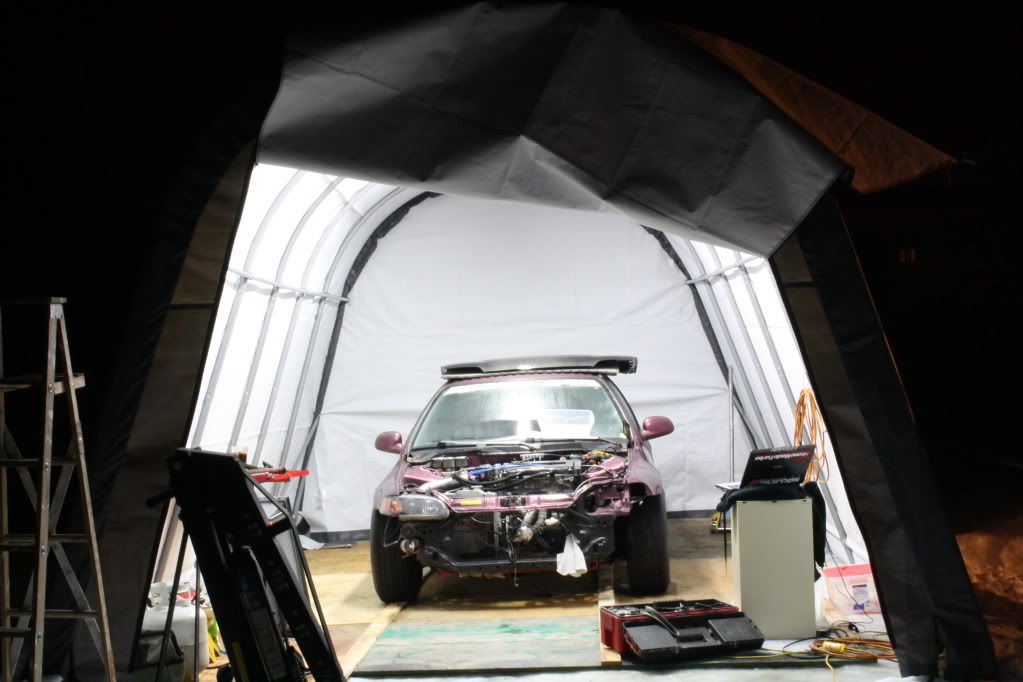

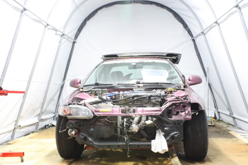

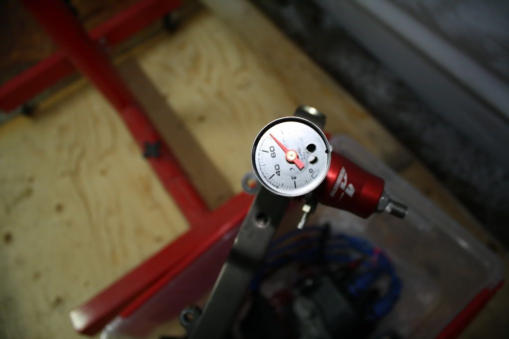

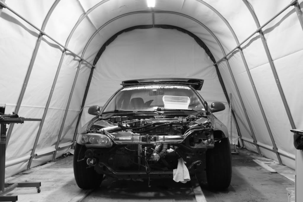

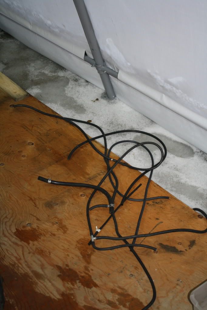

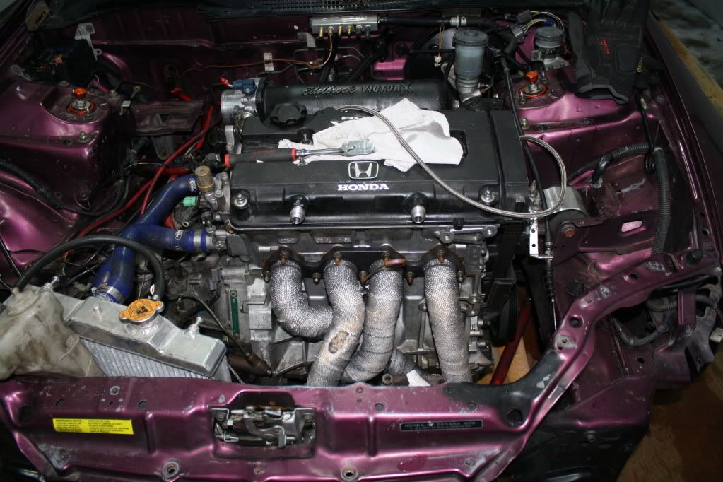

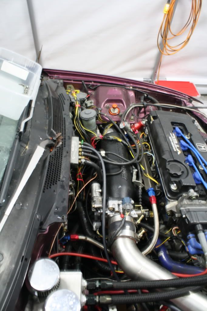

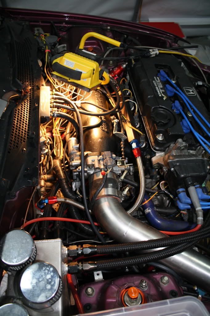

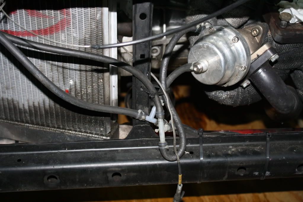

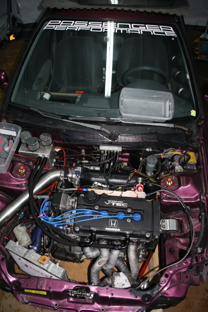

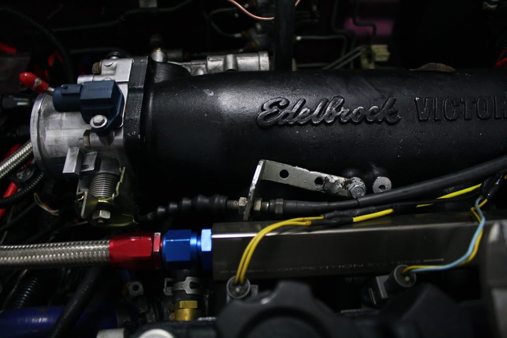

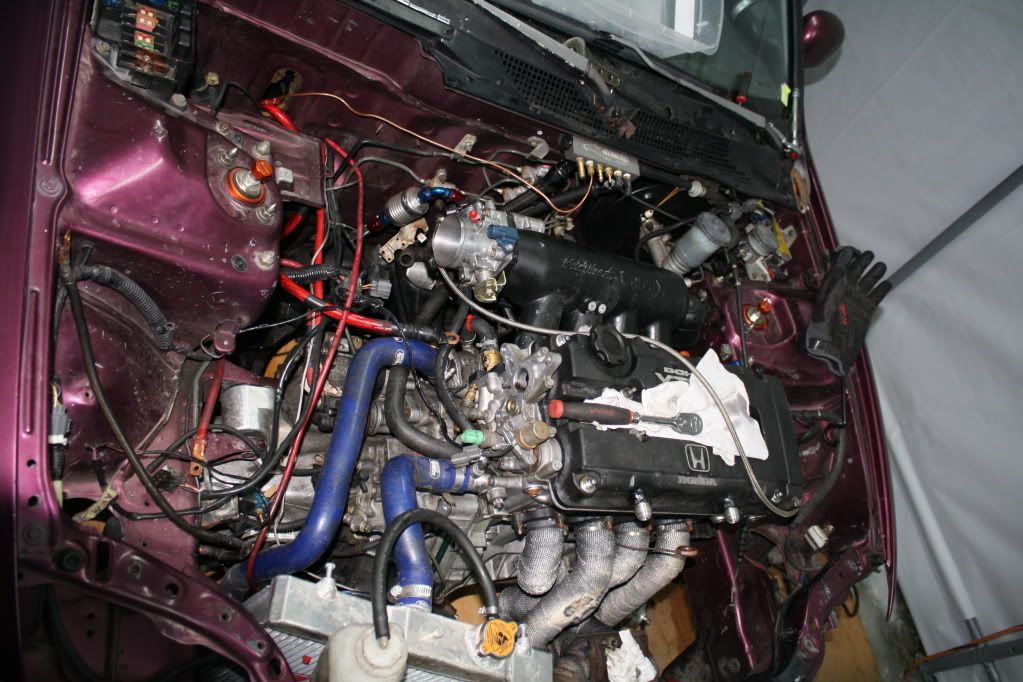

ALRIGHT
Time to de fucking nigger rig this bitch
first step was removing all wire, zip ties, vacuum lines etc etc. pulling the motor etc etc
a couple teaser pictures

badass nog. get that shit done. im currently fixing all the problems with my crx, replacing alot of shit, painting the engine bay.... everything it really needs. before i make power so it dosent feel like its going to fall apart.

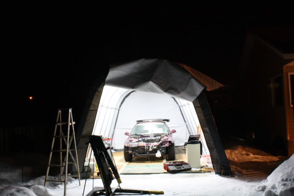

Is that a new and improved teepee you enjins use these days?
Re: UI's 703hp Purple beast - DE NEGRO RIGGING pg 19
« Reply #565 on: February 06, 2010, 05:05:21 AM »
That is it.
Wires are out, dash is out. motor is basically unbolted
« Reply #566 on: February 06, 2010, 05:46:06 AM »
i hope the rebuild includes a larger intercooler

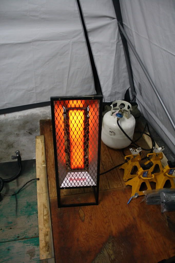

Damn now that is some  O0 riging. Clean that shit up, no wonder you had a lot of problems. Other wise I like. How warm is the tent inside?
