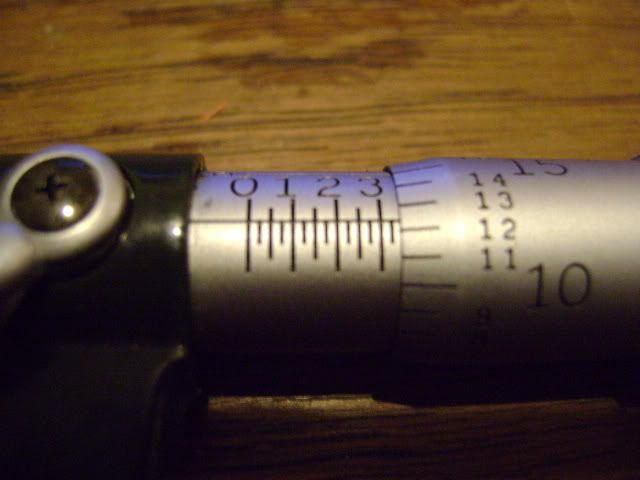

Now how do you read what you got?
This is a 2-3" mic so all your readings will be from 2.0001 to 3.0001
The horizontal "ruler" (sleeve) is X.  2.X001.  Each dash mark represent .25.
The numbers on the thimble (the thing that spins) are 2.0XX1.
As you can see, the line on the sleeve is between 12 and 13 and the thimble is lined up beyond the 3.  So as of right now, our number is 2.3XXX.  Each small line is .25 so add .25 and .12 and you get .37 and the next two numbers in the measurement, 2.337X
For the last number in the measurement, look at the last picture.  You want to find the line that matches best with the other and that will be your last number.  in this case it is 5 and gives us a final measurement of the yuengling bottle of 2.3375"
