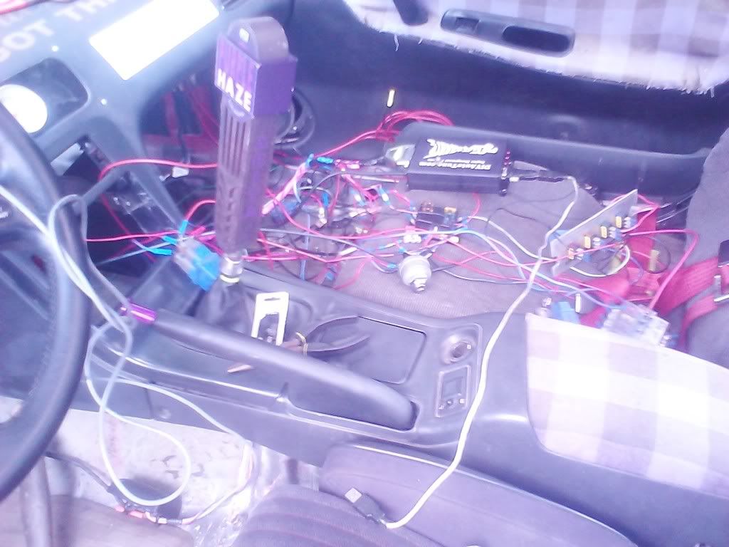

I pulled the number one plug wire and stuck it to the strut tower.   Maybe my ignition relay isn't right or what.  I'm not sure.  the 4th crank over she ALMOST started yet plug on strut tower yields no spark.
She's not acting like she's 180 out.  I popped the dizzy cap off and i'm verifying number 1 at tdc on compression stroke.  Well was before it started raining.   Here i sit.  Hey, random phat ass white girl with crazy hair and tats...
I will have to check my coil relay as well.  DIdn't want to direct draw so i have some fatty 12 gauge running that straight from the batt to relay to coil.  Triggering from 12v on a 20a fuse.  Maybe that fuse quit?  Bout to give that a lookover too and make sure it's operating.
Maybe today, maybe tomorrow.  Nothing want's to cooperate.
Good news is both sensors and my wideband are functioning IN THE CAR.  Map sensor is reading correctly.  Injectors are firing (may try simulaneous injection over alternating batch fire? anyone object?) and i def have cas signal to the megajizz and she DOES crank and DID act like she wanted to start.  Could play with cranking pulswidth also.  May be too high...
My dick literally twitched when i heard exhaust pulse from the downpipe when she was being a tease......  I'm still shaking thinking about it.  I saw her "side boob" for the first time.

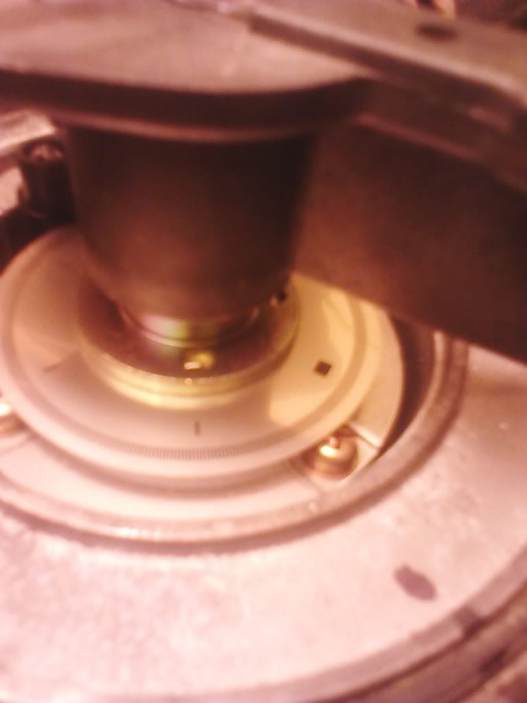

Back on motherfuckin topic.  Lol.        Played around with tuner studio settings to get somewhere and still not much improvement.   I dunno what the fuck.  I haven't got a clue.  This is why we troubleshoot.  THe cas disk is under a plate held in by two screws.  This thing is so fucking old i had to drill one out.  My drill had it's chance to have the cord repaired today over it.  I swear if anyone saw that short out and my reaction they would have died laughing.  Here's what i found.   Of course it's 60* trigger six slot as i expected.  THe fact there's a square slit and 5 normal slits may have me onto something.....i hope.  Bout to get the decoder disk and go get some more distributors maybe. Asked questions, did some more homework and hopefully a solution is found soon.
Get this.  Spark plug one doesn't arc off at all.   That square is right under plug one.  Check my sharpie mark for the cyl 1 point.  I will try testing out on the others tomorrow hopefully!  If this is the issue i'll be pumped.  When i did this procedure the engine acted like it wanted to go into "RUN".     When i was taking this apart the rotor screw was allowing the rotor to rattle around freely.....hmmmmmm!  So maybe trigger sync with the falling edge of the square and the other 5 slits is off enough to mess with things and i just need to do a bit more adjustment.....so i hope.

J30 sohc 3rd gen maxima dizzy.  The square slot is about 160* away from the end of the rotor.  Where as the other dizzy was right under the end of the rotor.  Maybe 5* in relation to it.
That's irrelevant considering i'm still getting tach signal/injector click click.  Just no spark output.  Either it's the coil (ohm'd out to fsm spec so doubtful), coil wiring (poles mixed up?) or my board connections for my coil driver (onboard unit) are incorrect DESPITE following the manuals instructions the letter.....   So in fear of washign my rings down i unplugged power to the injectors and am focusing solely on spark now....

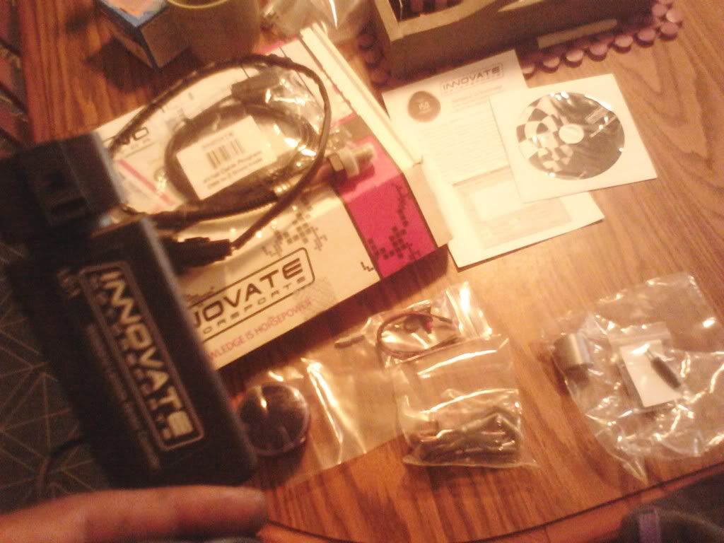

It's now 7pm so banks are closed.  TOmorrow i'll be ordering my LC-1.    Bpsx is officially on some fuck shit.  Will read some numbers.  Just not display afr.  I calibrated it once and it was giving me 13.80 or something in the pipe (slam full of fuel vapor).  Then i cut the car off and it goes back to reading weird shit like it was during pre-calibration.  Now it wont read AFR at all regardless of button mashing sequences and i'd like nothing more than to string Rick P up from the nearest tree with the wire harness from it.  That's my experience with it.  Fucking junk.  Didn't fuck with ego/wideband switch points either.  Still at 100kpa for open loop to run off my fueling tables.

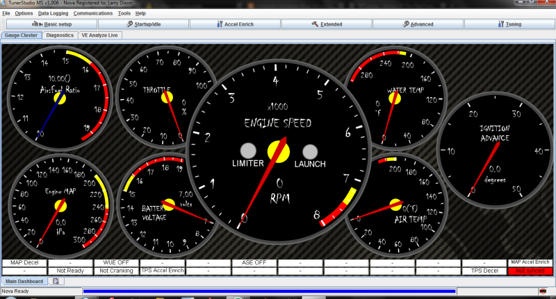

Also, I have a pretty sweet dash I made up for TS if you want it. The stock gauge layout sucks.

That's pretty sick.  The font hurts my eyes though.

Ordered my LC1 thismorning.  I would like to know what my brief whatever idle is at.  I contacted bpsx, let em know what was up and they're helping me out in my best interest.  That's fucking legit.  So yeah, haters gonna hate i guess and then try to sway others to feel the same.  You know what happens to stupid fucking lambs?  They get a nail in the head and turn into rugs and chops.  Dont let that be you.

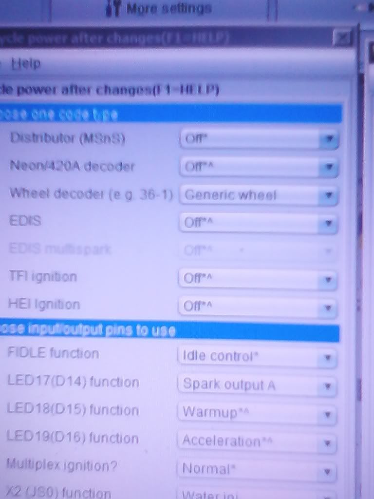

Now i'm using standard MSNS distributor "ON" at the moment.   What happens if i use this setting?
Also not sure if Led 18 needs to be irq trigger or warmup......  I have tried both with similar results.   Fun times.

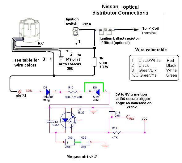

Though i did not get spark UNTIL D5 was jumpered.  Took two days before i said "fuck it, i'm going to try it".  Other sources have said to jumper it anyway......
STOCK NISSAN 6 SLOT CAS.  5 even slots, one square.  Optical trigger.  Single coil.  Single ignitor chip/power transistor.  Actually here is the exact ignitor i'm using.
Schematic to the letter to how it's installed on my board.
I set my required fuel as high as 680cc (460cc are in there mind you) and was still getting too much fuel.  I mean if it wanted to act like it was gonna idle after i killed the fuel pump i figured i ask.    Fingers were pointed at my regulator.  I get back from doing some errands, pop the hood, yank the vac line off and sure enough, fuel.
This would be time to upgrade vs throwing in a stock one.
Edit:  I did trim my ve tables down and was trying to go off 18*-20* timing.   This pains me because good fprs are NOT cheap.  If you know of good workign cheap ones do hit me up.  I'll go cdm IF the shit is rebuildable with legit parts.

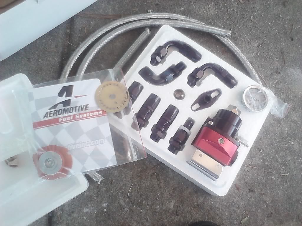

Going CDM.  Turns out Aeromotive diaphragm fits the knock off aeromotive FPR.   :noel: :Jew: :noel:
I just ordered the full kit (oil filled gauge, chinamotive regulator, a shitload of -6an fittings and lengths of -6 ss hose) $88 shipped w/1yr warranty....lol.  Warranty.....
My warranty comes in the form of the Aeromotive diaphragm kit 13001.  $31 shipped

Im on my phone right now but do you have a V2.2 board? Looks like you have the newer diyautotune case so I dont know why you would.

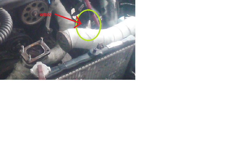

 With my wb02 sensor mounted here it'd be a good idea to get some copper to make a heat sink out of wouldn't it?

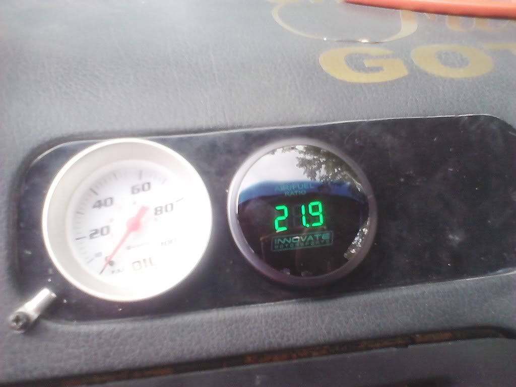

Retard huh?  Glad i left this sticker on my dash.....
Free air read i got before i stuffed the new sensor into the downpipe.   So hot inside the car my face melted off during the install.

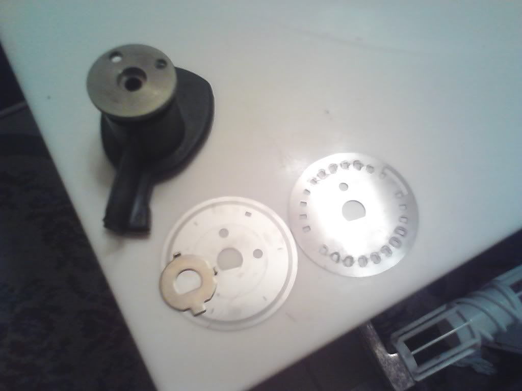

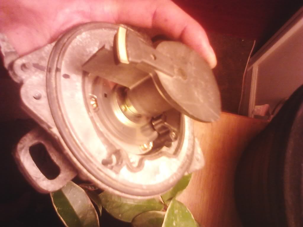

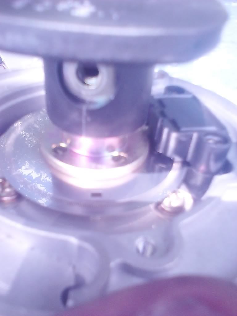

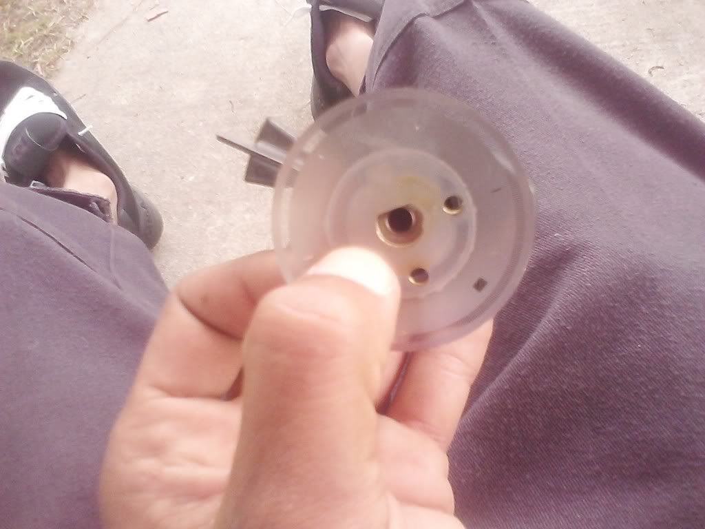

As far as touching ignition i swapped back and forth between two different distributors in because of THIS SHIT:
Look at the square slot in relation to the rotor.  I hope you can see why i was chasing ignition issues first.  I had no spark for two days then found out the clocking was different between both of these dizzys even though they come from the same engine (vg30e).

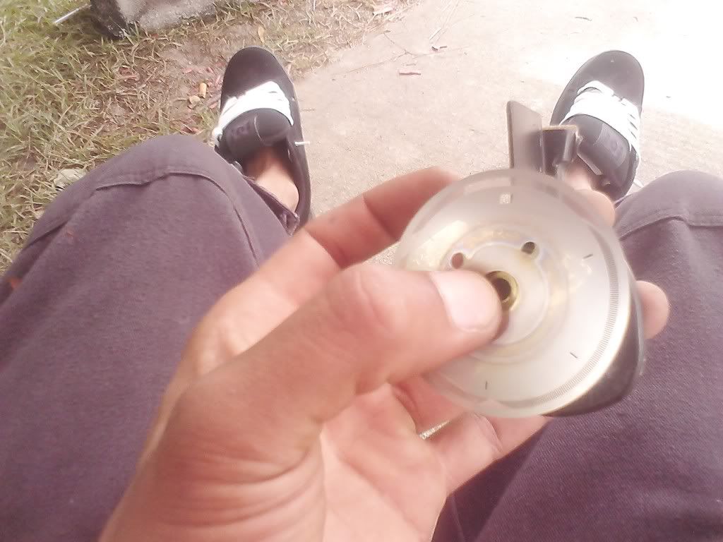

Picked up the trigger wheel because i can.  I wont fuck with it until after the new reg is installed.  I'm going to see what 30psi at idle does on the original map with the new wideband config setup then sending the msq off to a trusted advisor for review before i proceed.

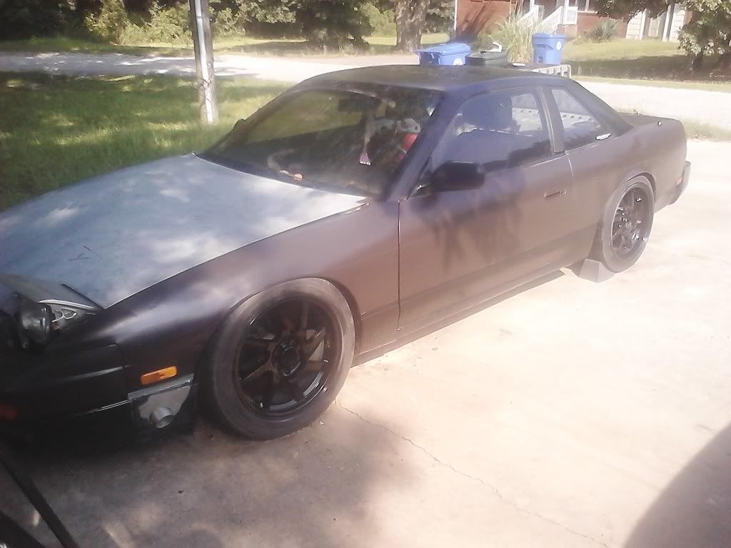

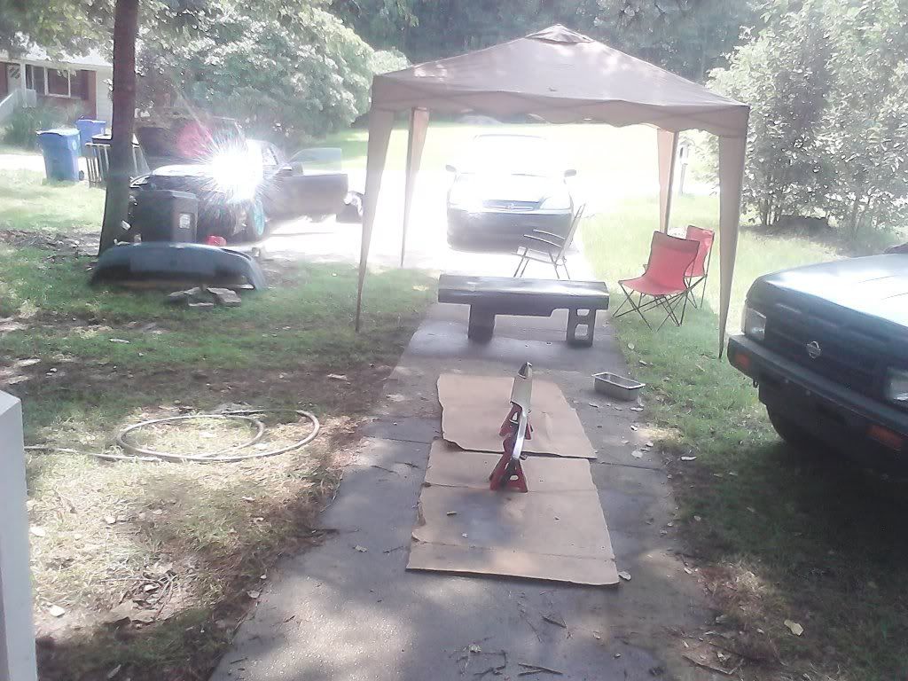

I did some more body painting about 2 days ago. Got a hobo shade tent to drag over me when i start wiring the lights/windows and shit.  Forgot to mention it i think.....  Whatever.  Blue wheels is not working well with this but whenever i got time i'll fix that too.

Installed all but trigger disk.   The control is to get it as close as i can with an oem first.   The timing loop i'm generating is still not proper.  CLoser.  Was actually able to get out of the car today and look at the laptop while she was purring, no crazy bratatata coming out of it.  Just smooth running.  As soon as my eyes hit screen, stalled out.  I'm damn close.
Phil, i tried hard to find a linkable tubgirl picture for you without luck....  Strange.   Seems like the lord IS on your side after all.
The little shim the rotor sleeve and disk sits on needs  one of the alignment tabs cut off.  I MIGHT cut off both.  Infinite position clocking regardless of distributor so the canadian z31 faggots can choke on it for trying to tell me what to do.  MEgasquirt doesn't give a fuck about the square slot.  It's only picking up trailing edge and my trigger log looks normal to me with the oe disk.

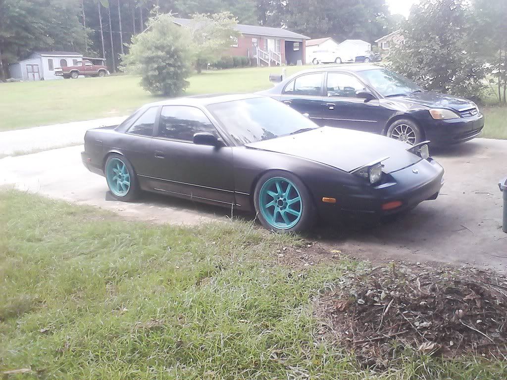

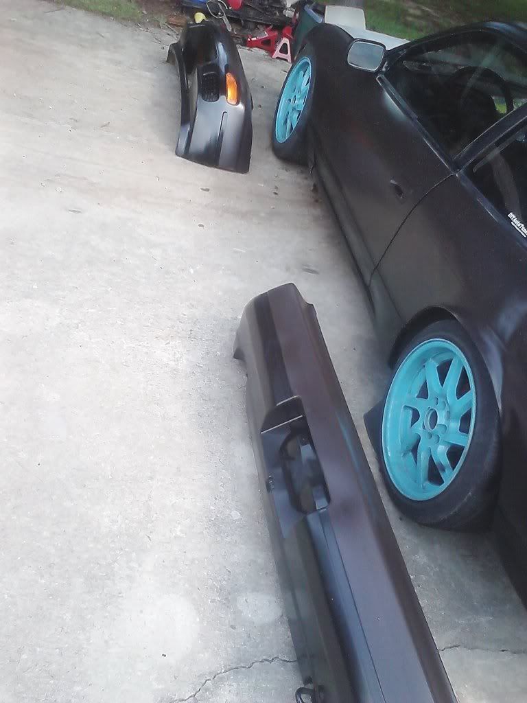

Annnnnd blue wheels gone.  I dig it.  Cannot cut down exposure/glare on my phone's cam.  Deal with it.

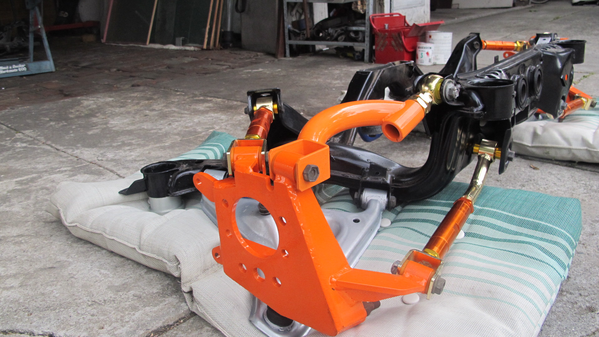

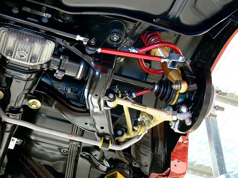

Rear upper control arm.  Needed for camber adjustment on these cars.  However, you can only adjust so much before you completely fuck up the geometry and that's where the traction rod adjustment comes in.  They move in an arc together.
This is the subframe oriented how it would sit on the car.  The curved arm is the ruca.  Strut goes up through there to the chassis.  It's bolted to the knuckle.  Knuckle is bolted to lca.   The traction rod is the shorter orange rod on the left.  The toe rod is the long orange rod on the right.
Orientation on vehicle for better idea how they work together.  Ignore the adjustable rear lower control arm (triangular gold arm) as i wont be running those.  Modded and boxed oem is plenty strong and good enough for what i want to do.

Before i forget the following items are now on their way:
1.  Fragola 45* push loc -10an.   Oil drain line's leaky as fuck standard -10 cdm off brand swivel fitting will be thrown at high velocity at the next asshat ricer who runs past my house like they got a pair.
2. Sturrin wheel and hub.  I can't heel toe proper with the oe steering wheel in comfort.  If i dont feel comfortable in the car, what's the point?  Steering wheel is woodgrain as fuck, 350mm and will be overnighted literally from japan.  No telling how many slant eye hands have beasted the mountain or wrecked their shit over a curb into a palm tree with that thing.  Hopefully it brings the car some good karma and keeps my knee from screaming fuck you at me......
3.  RUCA/TRACTION RODS.   Never seen em before.  Ruca has pinch bolt style locking mechanism which i like.  We'll see how those are when they get here.  Paid $89 shipped for new product listed as "s13 camber kit" on ebay.   Take that you jdm whore's who stumbled upon this thinking this shit is ultra jdm, ya fgtsssssss.
4. My GFORCE scca/sfi appoved harnesses came without the shoulder strap mount thingies.  Ordered a pair from summit.  Cost me about $15.  That's good because the passenger can rock the 2" sabelt standard single clasp harness i have and i can use the complicated bulky 3" gforce.  Coincidentally, i sold the one that came with the car for the same price i bought this one for.  So shit will be safe.    I need seatbelts.  I can't drive my best if i dont feel comfortable and safe.
Uh....that's about all i got.  I'll snap some shots from under the car at my ruca/coilover/subframe shit so you can see how it looks.  Def not rust treated or baller......  Proud of my bright ass green coilovers though.  They ever blow i'm sending em to fortune auto so they can work their magic.  I have a place about 5 minutes from my address i can weigh my car.  Cornerbalance is a different story.
