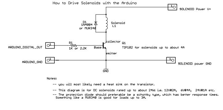

Found a hardware diagram that will work PERFECT for this project. I have already simulated this circuit and tested it for feasibility with standard MAC solenoids used (AEM, Hondata, Neptune, eCtune, ect) and it looks good.
Hardware needed would be the driver circuit above, arduino, solenoid, potentiometer and to do something about voltages. No biggie.

BTW with a small mosfet, you wouldn't need a heat sink. I have one that deals with 4+ amps driving injectors, and it doesn't even get warm.

Thanks for the tip about the mosfet. I found that diagram searching online and simulated to check it against my project. It is overkill (I calculate a bit over 0.5 amps sunk from the solenoid) but I will test the hardware soon.

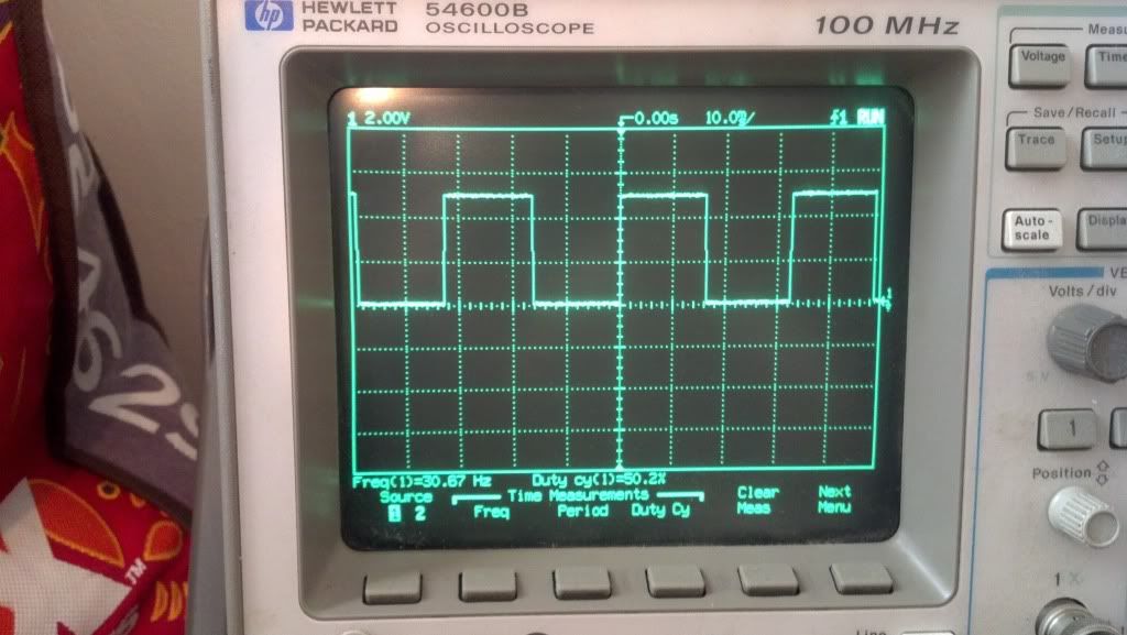

I got a bit further with this. I have integrated my potentiometer code with the PWM code. Now I can adjust duty cycle with a knob. Here is the vid:

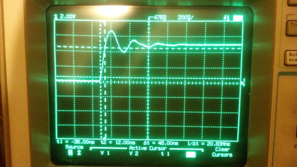

whats the rise and fall time on that squarewave? Shit looks better than most function generators, but it could be the time setting on your scope.
DSMR
  • Posts: 72
Re: Electronic Boost Controllers
« Reply #18 on: November 13, 2012, 02:54:33 AM »
Rise time is really small. At 200ns/division it is 48ns.
Looks like a nasty ring up there! Its not really that bad for this application though. The base resistor eliminates this ring.

Rise time is still really good and even the rings not that bad. Better than I expected from an arduino.
