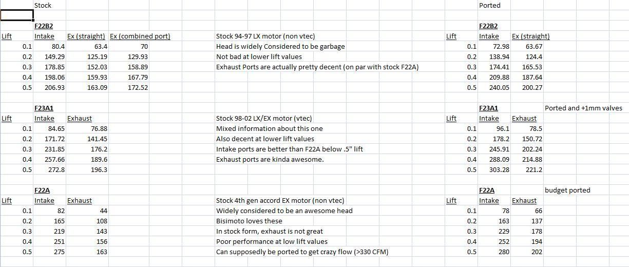

Once the swap is done and all the bugs are sorted, it will come out for k20 pistons, unknown rods(haven't decided), f22a6 head, a cam of some sort and I'll make my own intake manifold.
Honestly in stock form the F23A1 head outflows the F22Ax.  F22A's have pretty shitty exhaust ports (in stock form), the real advantage there is that as far as I know they don't have a water jacket around the exhaust ports, so you can open them up a whole lot more.  Another advantage is that you can put a dual runner intake mani on them (both the F22A6 and H23A1 intake's fit).
But yeah, unless you are gonna do port work, just keep the F23 head on the motor.
The F22B1 and B2 heads are pretty lousy though.
I always heard the opposite of this, that f22a's flow a lot more but the cam makes it lack luster.

I think a lot of the skewed info is because the F23 has the word "VTEC" on the valve cover. The head flows well, but the camshaft sucks balls. I presume it's closer in lift/duration to e-vtec than anything - low lift and duration won't make much power on any head. Most people have access to the F22A head, and can get a Bisi or Delta cam much easier, which is why it's modded by more people. The F22A cars are also a lot cheaper and lighter, making them more enticing.
Here's an interesting pic I found while researching not long ago:
edit: clarified some shit, fixed pic
Take a wild guess who compiled that info...
Here it is, slightly bigger and clearer, that looks like it was saved and uploaded and compressed a couple times:
Anyways, if you aren't touching the ports beyond cleaning up casting flaws, it seems like F23A head plus cam that doesn't suck balls is the way to go.

The F23A cam only has 4 more lobes to regrind (20 vs 16), so I'd guess Delta would do it under $130. If I was doing it, I'd go 260* or a step lower for primary intake, 272 or 282 for the vtec secondary lobes, and either 260 or 272 for exhaust. I'd go with the lesser duration if it was mostly a street motor.
From what I've seen, a basic 272 Delta with pull 150-160whp with just I/H/E vs a stock I/H/E H22 that will do ~165whp. A 12:1 F22A6/F23 combo with a Delta 272 will do near 200whp, so a better head and bigger vtec lobes should push an high-CR F23 over 200whp.
