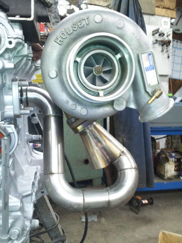

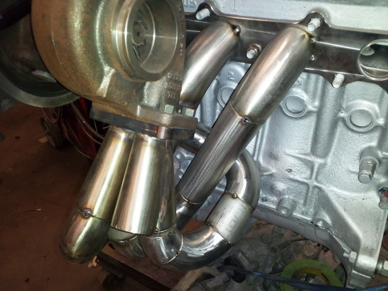

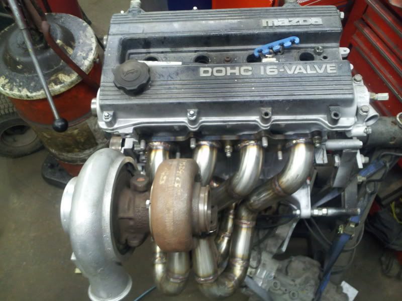

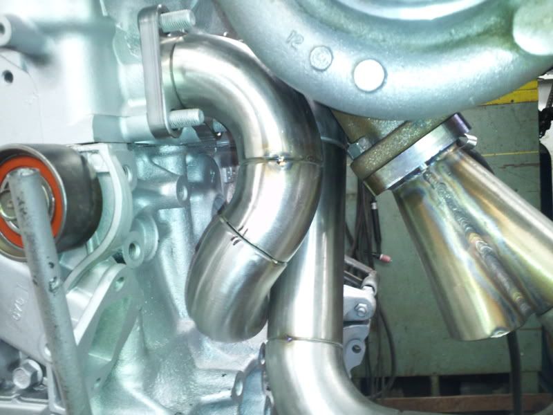

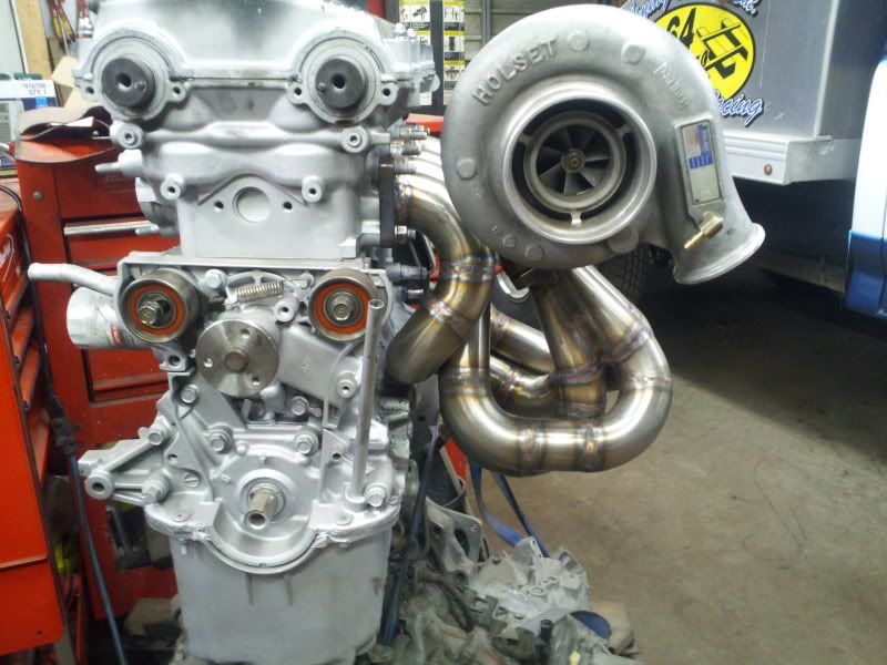

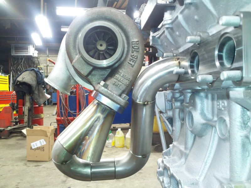

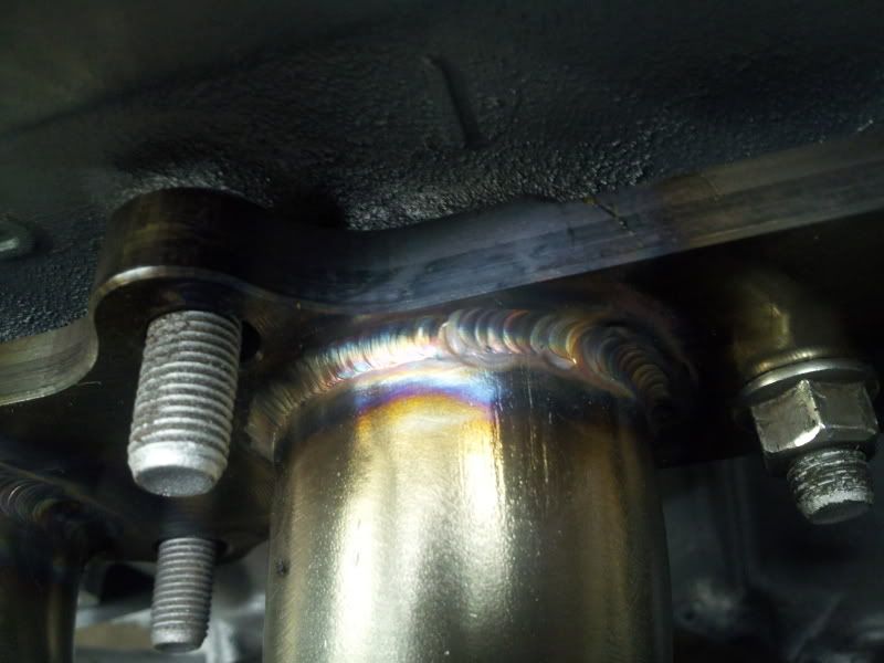

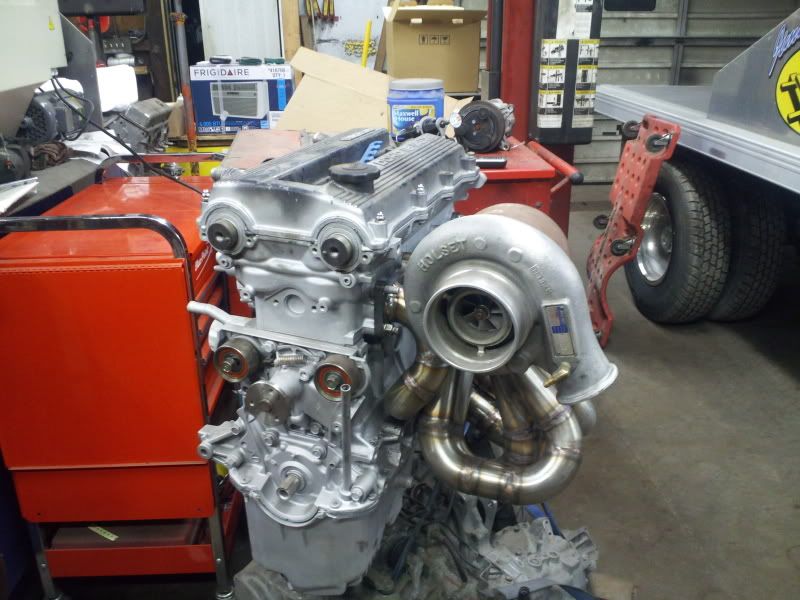

Nice now I know who to hit up if I need another twin scroll collector :noel:
It was alot easier than building a 4 to 1 collector. I even went gangster on it and cut the angles by hand cause my chop saw broke.
Shit my first attempt at cutting it by hand was a bit lop sided  :mexi:

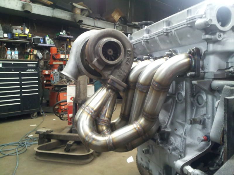

At this rate, the car should be done by the time I'm ready to retire. Taking a car vacation in a couple weeks but I think I'm gonna fix my 850R so I can bring it down to the BeastCoast meet  :noel:
Re: AWD Escort GT Build
« Reply #42 on: April 30, 2013, 06:18:46 PM »
that looks good  :noel:
carkrazed
  • Posts: 3422
« Reply #43 on: April 30, 2013, 06:30:54 PM »
Thanks homie. I probably would have got it done but I ran out of shit. Gotta order a couple more bends and some straight pipe.

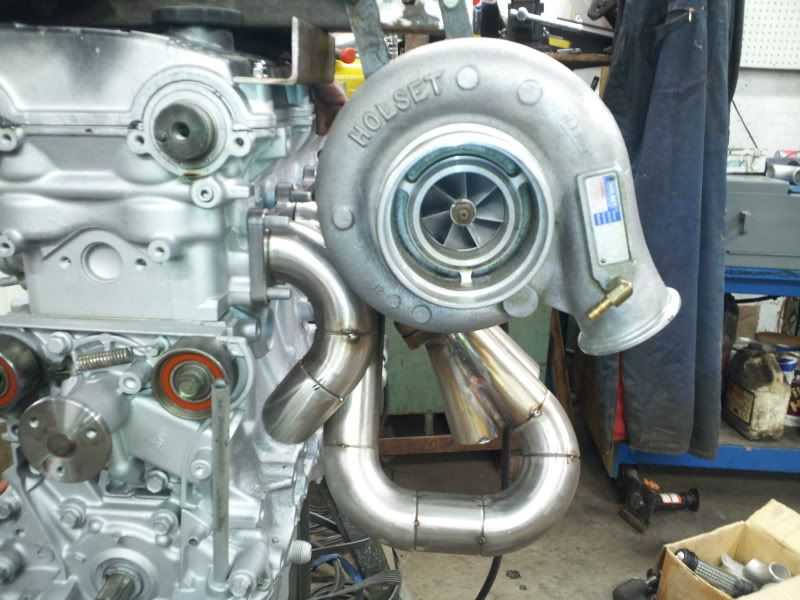

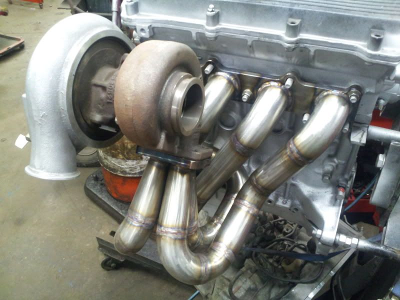

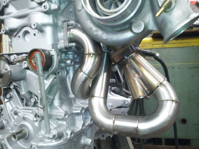

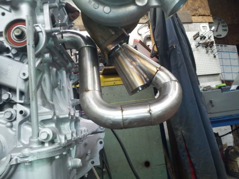

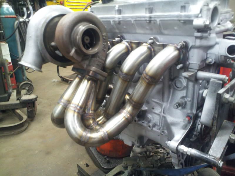

Manifold is pretty much done. Beast Coast meet has motivated me to actually get some shit done on this.

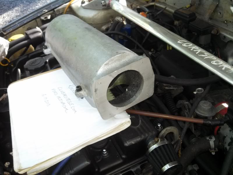

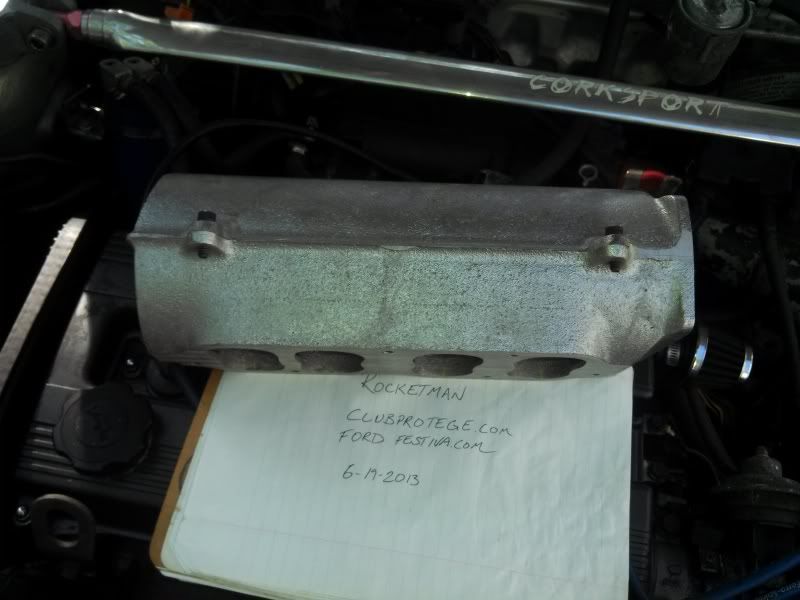

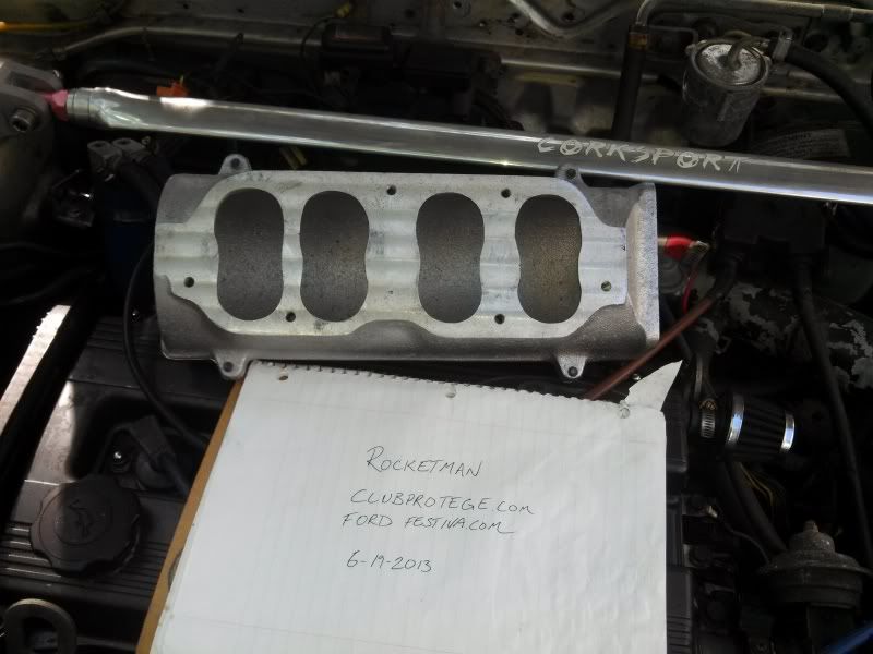

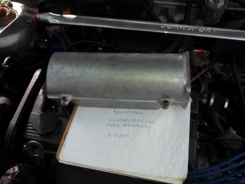

Opinions on this manifold
It bolts to the stock lower manifold.
Dude says the plenum volume is greater than 2 liters. Wants 150 for it.
« Reply #48 on: June 24, 2013, 11:42:43 PM »
id say go for it. thats a lot of volume.
« Reply #49 on: June 25, 2013, 12:00:20 AM »
Long ass runners. Or maybe its just the angle of the photo. I'd rock it. What's the stock one look like?
carkrazed
  • Posts: 3422
« Reply #50 on: June 25, 2013, 08:26:32 AM »
Stock gt manifold
gtx manifold that i'm running right now.
I think that plenum on a cut bottom like this would killer matched with a 75mm TB.
This bottom has butterflies in it like a gsr manifold and once they are cut out, it looks like this. I like how you essentially have 1 runner that shrinks to half its size by the time it reaches the head port.
Just sent dude a pm, gonna check it out.
« Reply #51 on: June 25, 2013, 10:49:41 AM »
I think those runners opened up and tapered where they meet that plenum with it ported to match would be badass.
carkrazed
  • Posts: 3422
« Reply #52 on: June 25, 2013, 11:19:00 AM »
Ya, then taper the inlet on the plenum kind of like a velocity stack.
I think I could also shorten the runners up by half pretty easily.
« Reply #53 on: June 25, 2013, 01:57:19 PM »
Looks way better then what you have. At the same time, you got some badass fab skills why not just make a custom one!?
carkrazed
