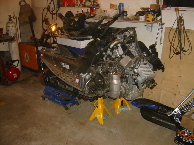

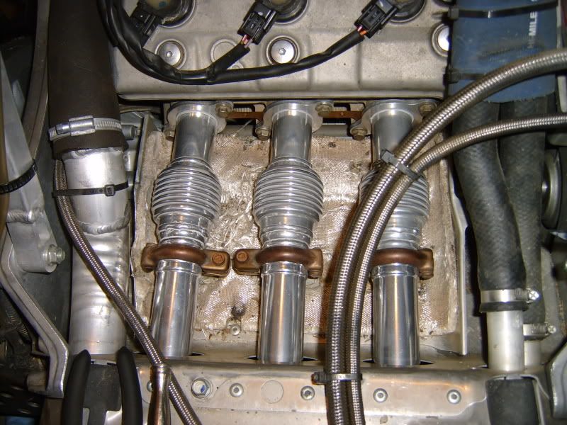

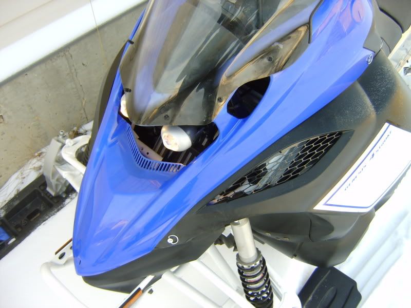

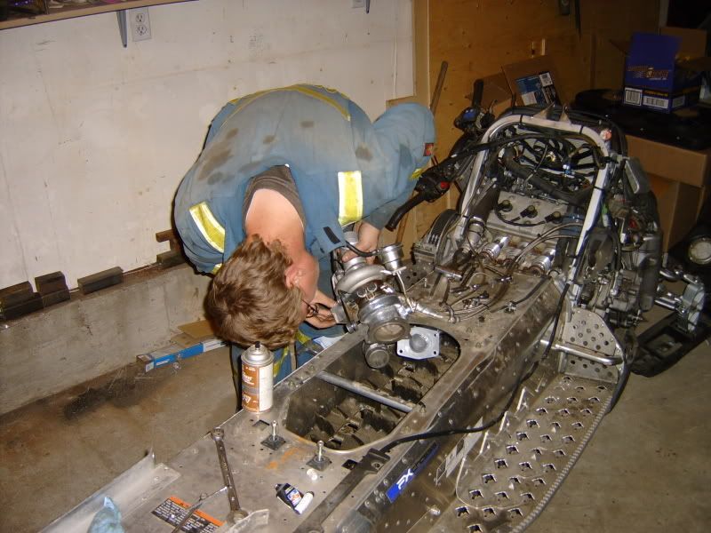

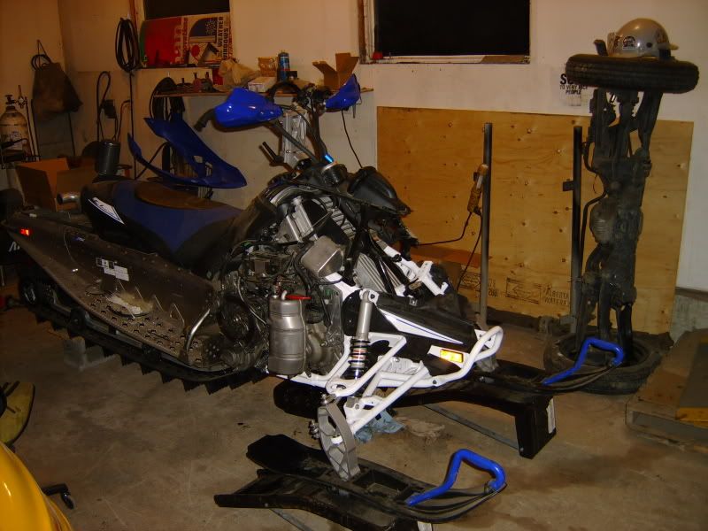

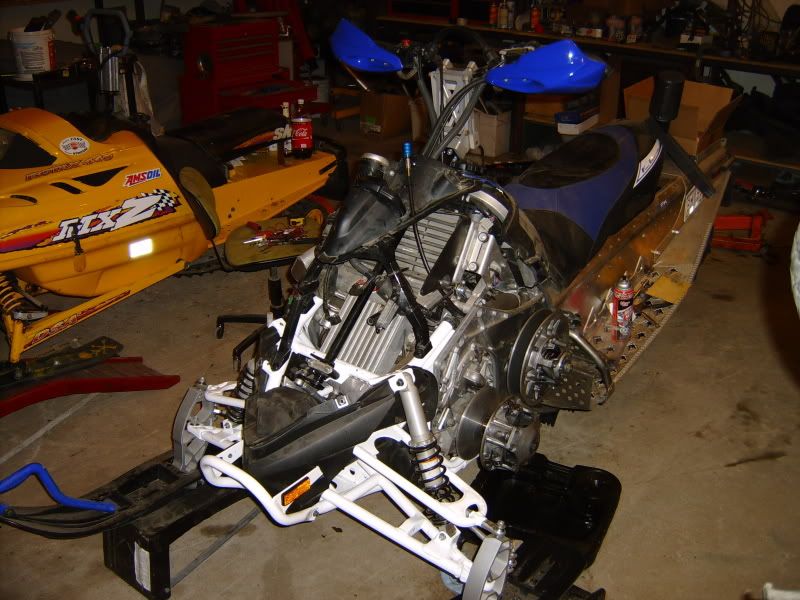

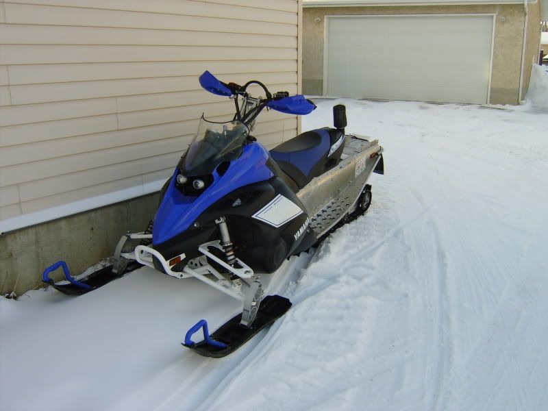

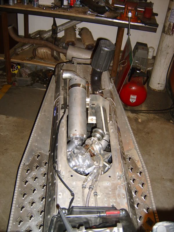

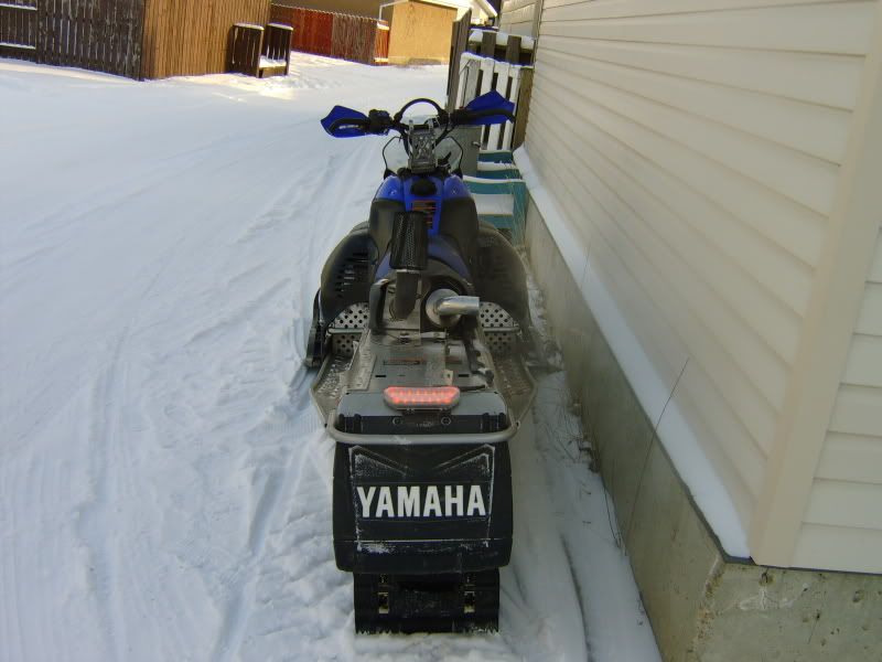

2008 Yamaha Nytro MTX, 4 stroke, 3 cylinder 1050cc, ITB's, stock 135ish crank HP

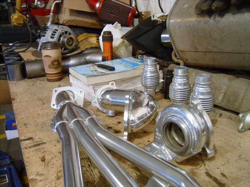

MCX turbo kit, 10psi of boost, ceramic coated exhaust and turbine housing, headshim to drop static compression and cams reset to eliminate overlap (more boost friendly)    extra fuel control is done through extra injectors inside the IC, one pointing into each TB, controlled with a microsquirt module.

if i had to guess a number at this time, i'd say i'm probably running around 200bhp.  thinking of making a new exhaust manifold and doing a more front mounted setup, should get faster spool up and have better response as well as freeing up the back of the sled for more storage.  would be a fun summer project.

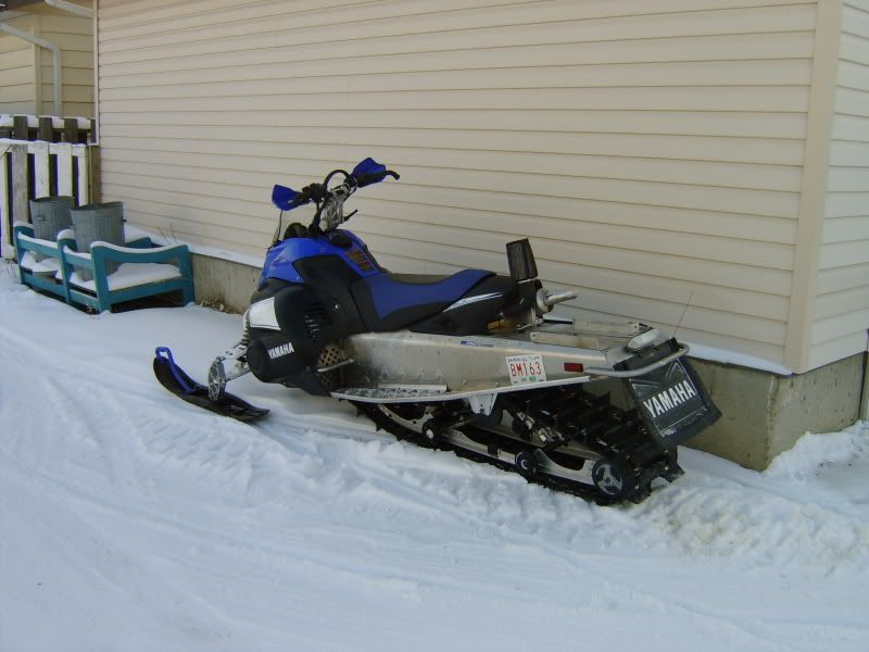

Is that an Alberta plate ic on the sled?

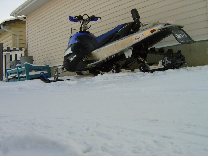

ya its an alberta plate, no where to store the plate on this machine, so i riveted it to the tunnel.

confUsed, the kit is rated at 235 at .9bar, i'm only running 10psi, so i would say 200, maybe a little over.   hard to say really, but its more than enough, the stock suspension has a hard time keeping the skis down so getting even more power at this time isn't a priority.

theres no real lag on my setup, and if i redo it then it will have even less lag.  while climbing i'm already on boost even when at part throttle so its really easy to blip the throttle to get around things.   i can tighten up the boost controller if i want and then the boost hits even quicker and harder as well.

i don't know what turbo kit is on that sled you rode but there is a big differance between some of the kits in both turbo size, turbo location, etc.    mine is probably the smallest turbo you can get for premade Nytro kits, and then i ceramic coated the exhaust (which made a noticeable improvement)
