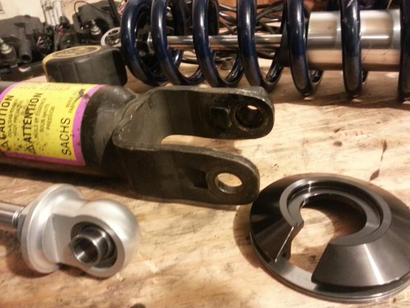

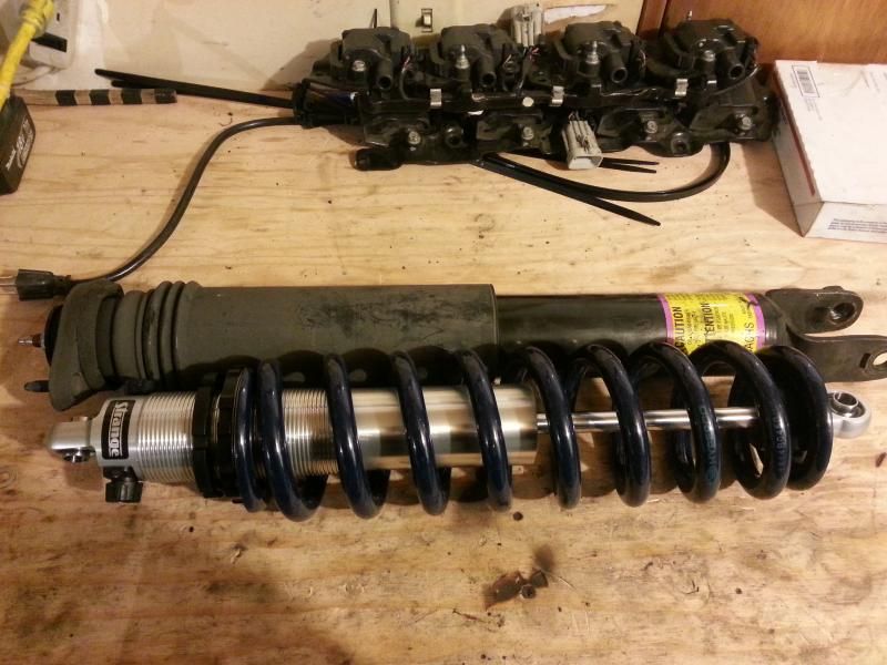

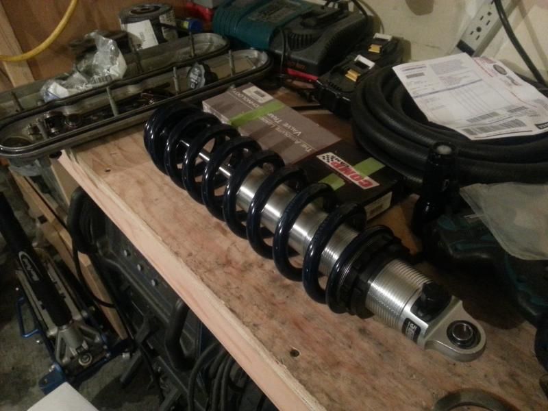

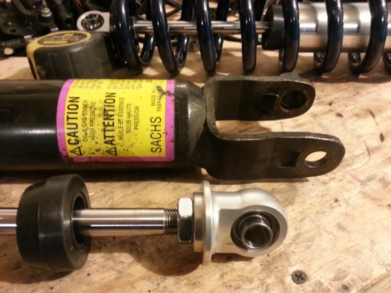

got some Strange Double Adjustable Coil-Overs on the way to help put the power down. its going to take some costom fab work to get them in the car as they dont make anything for the V
Re: my twin turbo rear mount CTS-V
« Reply #87 on: April 03, 2013, 04:32:51 AM »

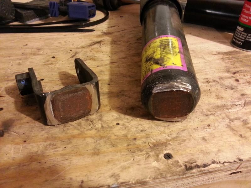

so i couldnt find any coilovers that were more drag race oriented for the v1s and all the decent coil-overs that i did find  are in the 2600$$ range and up.

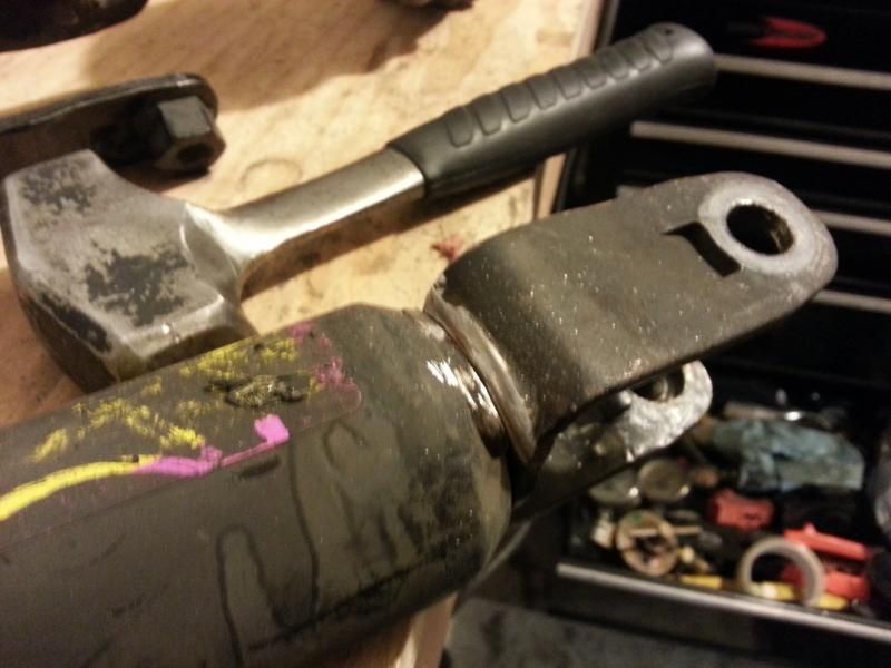

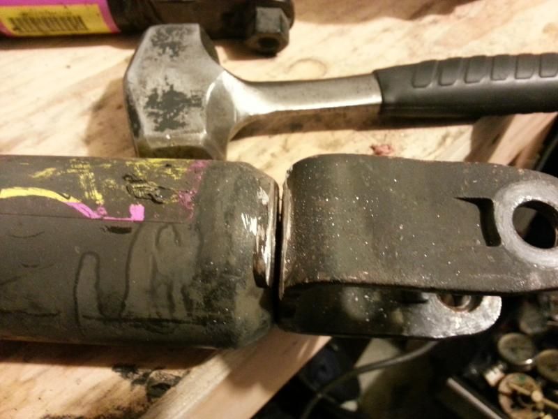

sadly strange dosnt sell any thing that will work off the self in the double adjustable version.  so i am going to modify the strange ones they do sell. after measuring the stockers i found thtat strange had one that was almost the same stroke and length. just the mounts on both side of the new ones are spherical bushings. i  need atlest one side to have a fork style mount to attach to the lower shock mount on the knuckle.the best way i can see to adapt the new socks is to unscrew the baring off the shaft side and make a new steel piece with the same 2 steps in it that the old one had to hold the spring perch. im going to reuse the forks off the stock shocks to cut down on cost and i think they are plenty strong enough. the adptor will be made of steel so i can weld the stock fork to it.
the top mounts are going to be much easier, just a plate a little bigger then the old one with some tabs on it for the shock to mount to. for some added strength ill sandwich a 1/8" plate  top and bottom
im still waiting on my guy to cut the parts for me but i post what i have so far
kinda scary cutting a chrged shcok, i went very slow with a grinder and then finished the cut off with a fine toothed sawzall

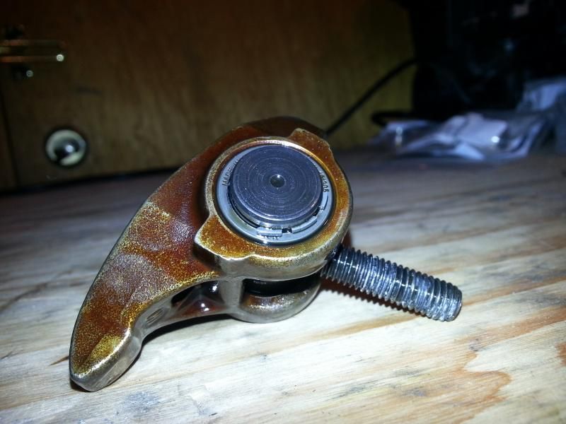

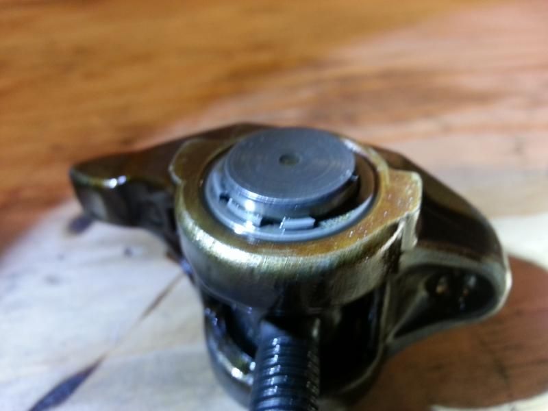

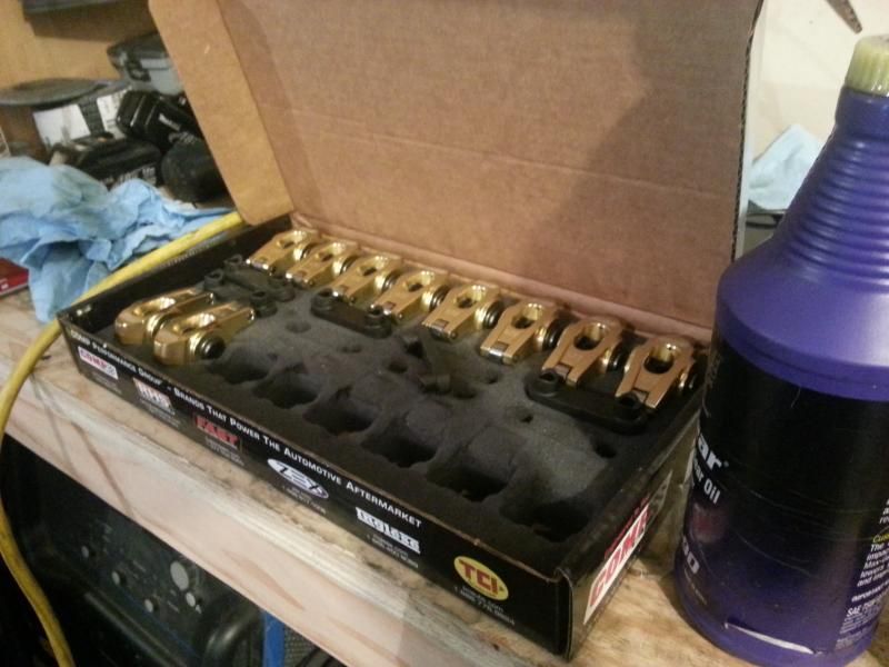

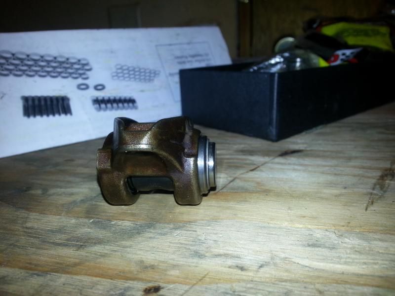

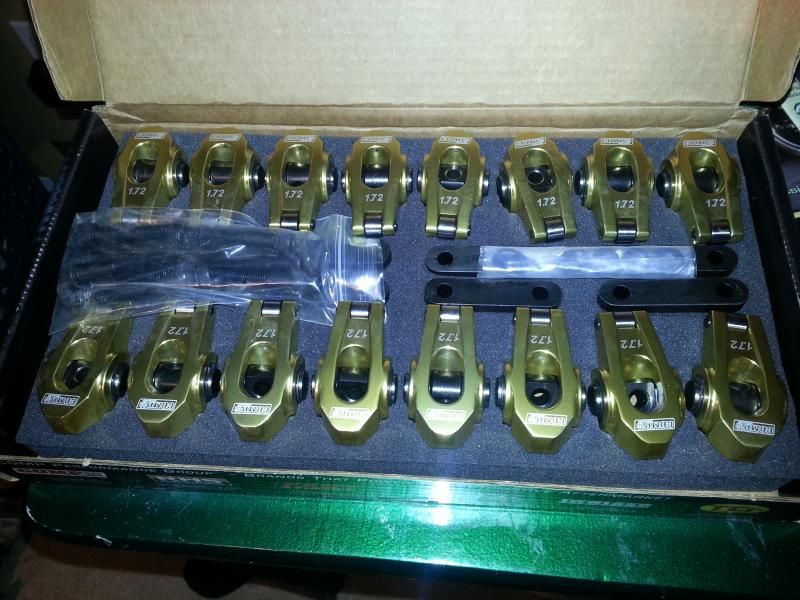

while my car was up on jack stands i figured i do a oil change and clean some other stuff up.by the grace of god while the oil cap was off i grabbed  a  flash light and looked in the hole. low and behold the rocker next to the oil cap is missing the C-clip to hold the baring on, well most of the C-clip is missing. i pulled the VCs and found 3 others that were ether missing or mostly missing. i also found about 1/3 of a C-clip next to one of the valve springs. WTF
long story short after alot of effing around and phone calls i ended up getting a set of comp ultra golds to eliminate the problem of the shity comp trunuin upgrade kit.
the baring walking out the opposite side

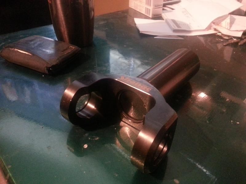

billet cromoly yoke

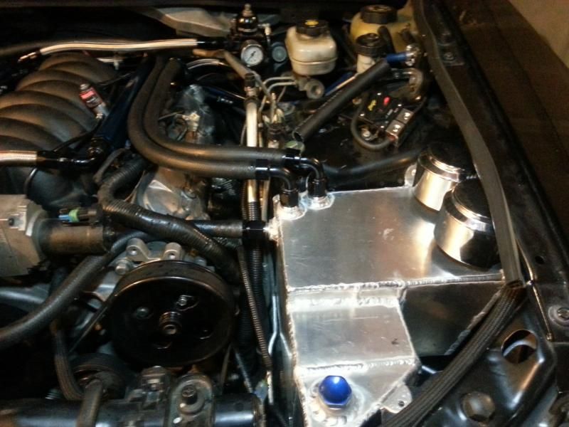

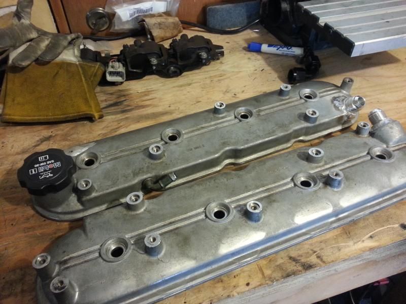

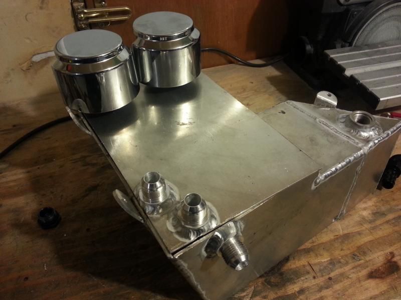

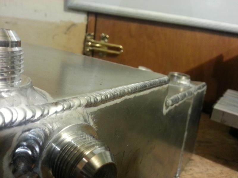

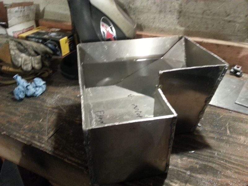

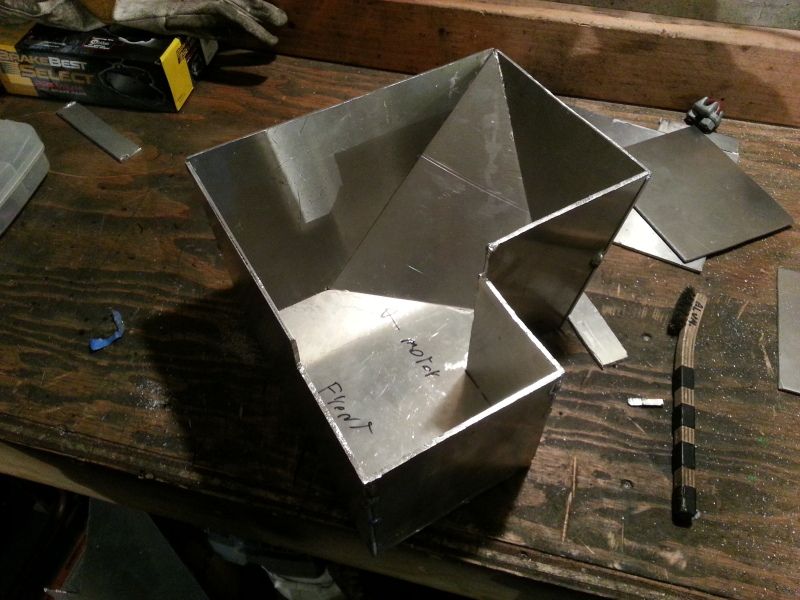

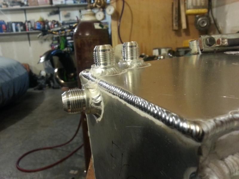

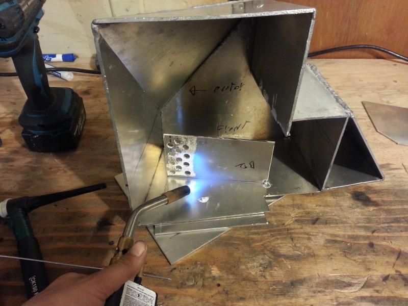

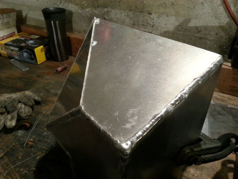

i figured it was time to get this thing built as i have had the parts laying around   for a bit.

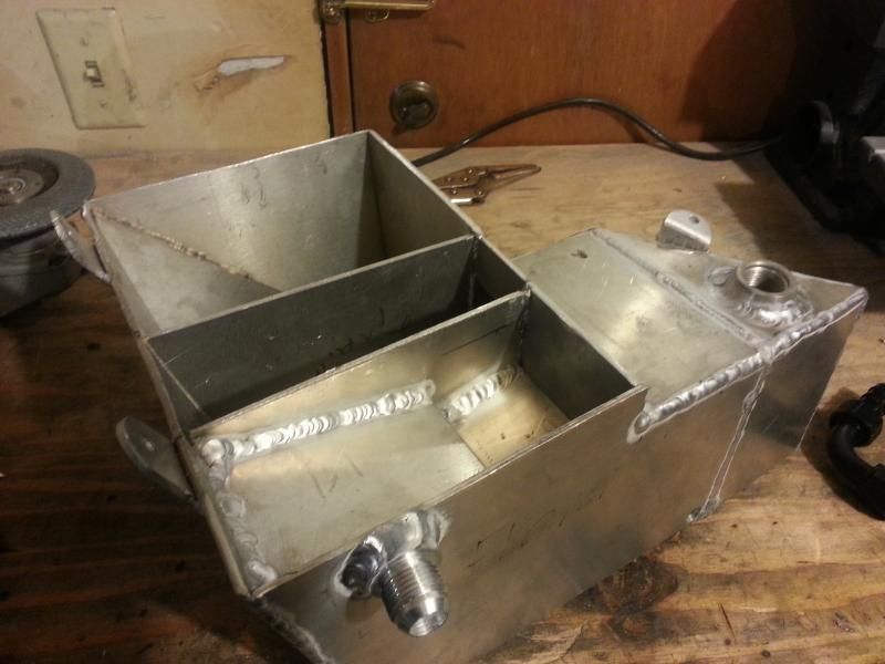

i planed n running 5 -10 AN lines originally but cut it down to 3. i think it will be just fine with the 3 -10 AN lines.
it passed the water test, cant ask for alot more then that

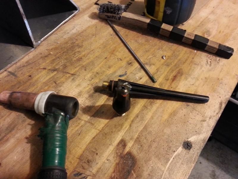

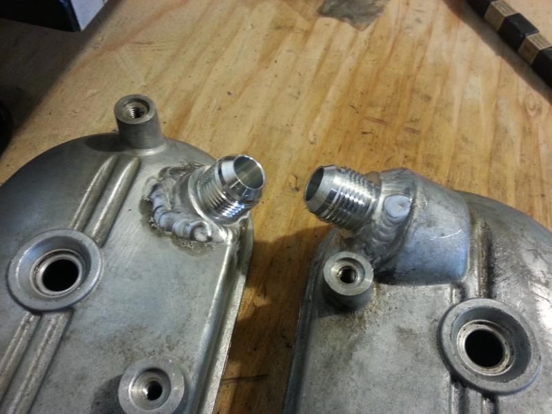

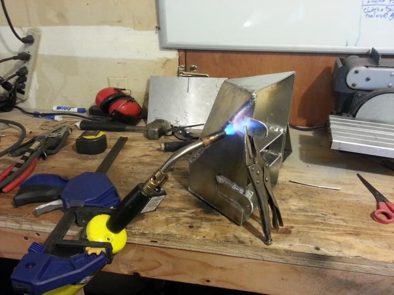

 im welding on a 30amp breaker so i have to pre heat so i can weld @ 110 amps instead of 180+
had to make a custom short back cap to get in the tight spaces.

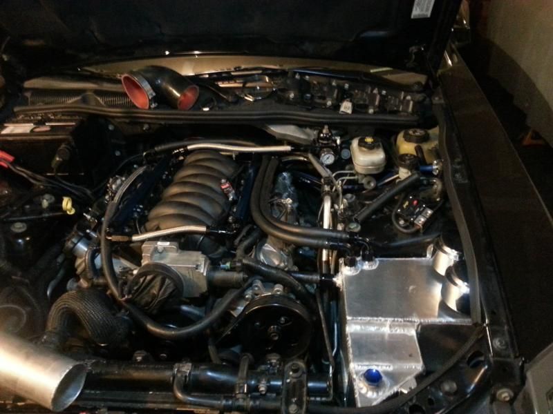

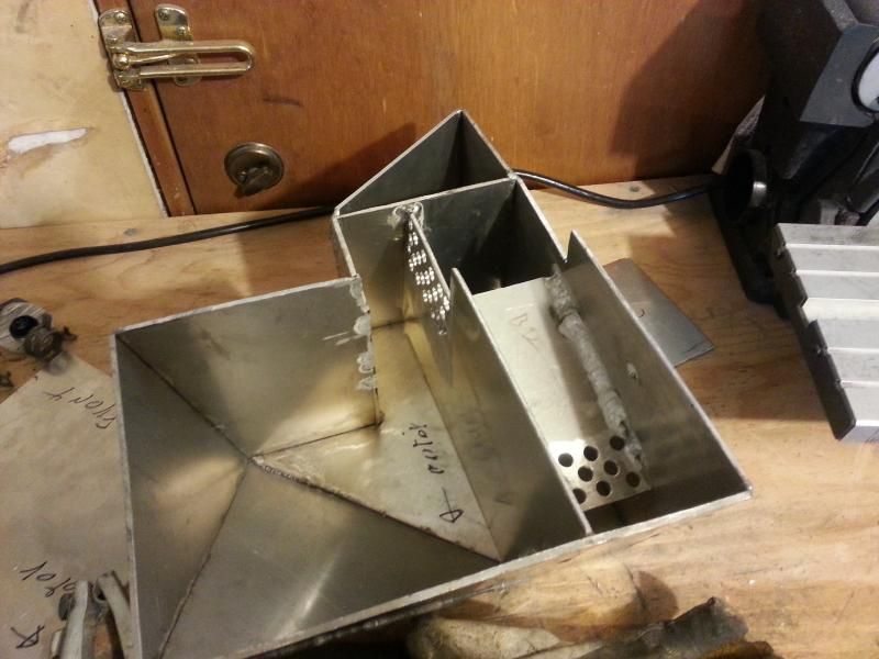

you can see that i added  a triangle to the end of the breather that will be a PS reservoir.
more preheating with my custom torch  holder.
i almost forgot the VCs

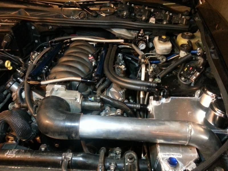

Nice. What breathers are those?
