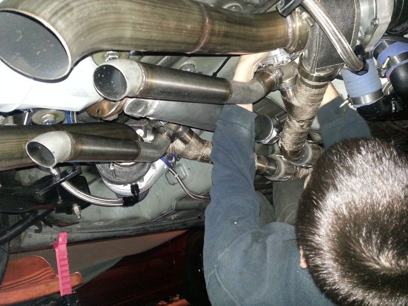

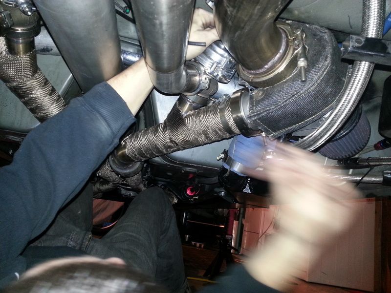

Here are some pics I took right before I got the vids:

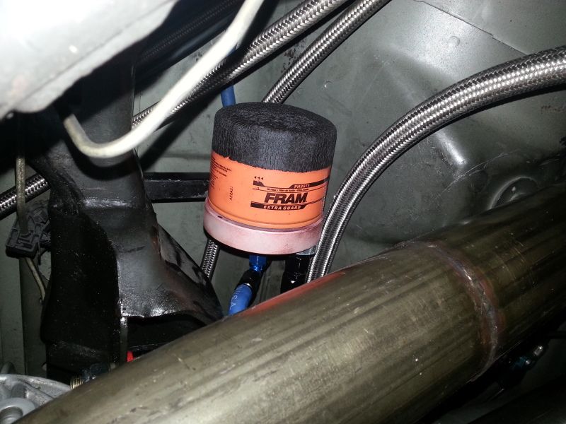

What scavenge pump(s) did you go with?
Re: my twin turbo rear mount CTS-V
« Reply #38 on: January 18, 2013, 11:06:51 AM »
i used the turbowerx exo pump, as far as im concerned there is no other pump to use. on the old set up the pump had no problem supplying both turbos with 70psi of oil, now i just have it scavenging oil but its a great pump

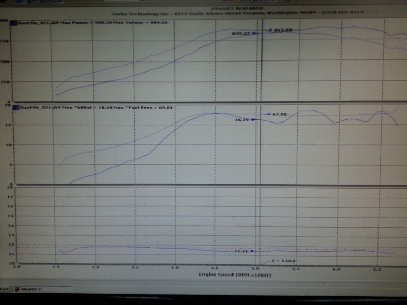

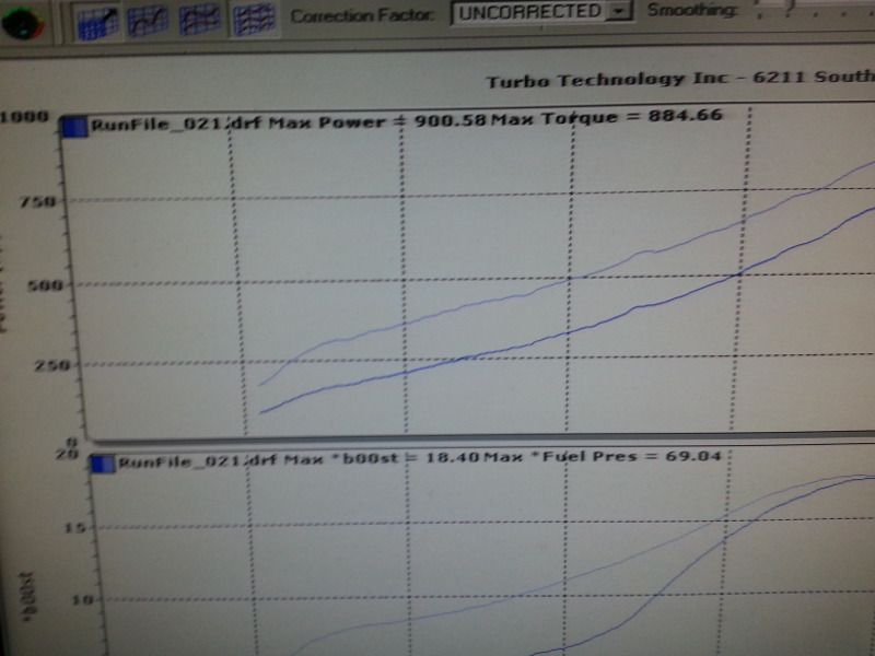

the #s are in
805/794 on pump/meth @17psi
shes going to be a nasty cunt!
probably could make alittle more but they lost power at the shop and had to stop for the day

The verdict is in.
Picked the car up today. Pump 92 and meth numbers. No E85 tune done.  Its enough  ;O)

Kick ass job. Why does boost fluctuate so much after 5k?

The boost control was not fully set up yet.
« Reply #59 on: January 24, 2013, 10:20:17 PM »
Uncorrected and the smoothing on 1?  Not your usual Dynojet shop.
