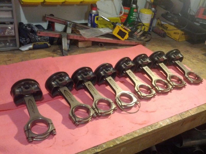

10-1 comp wiesco piston

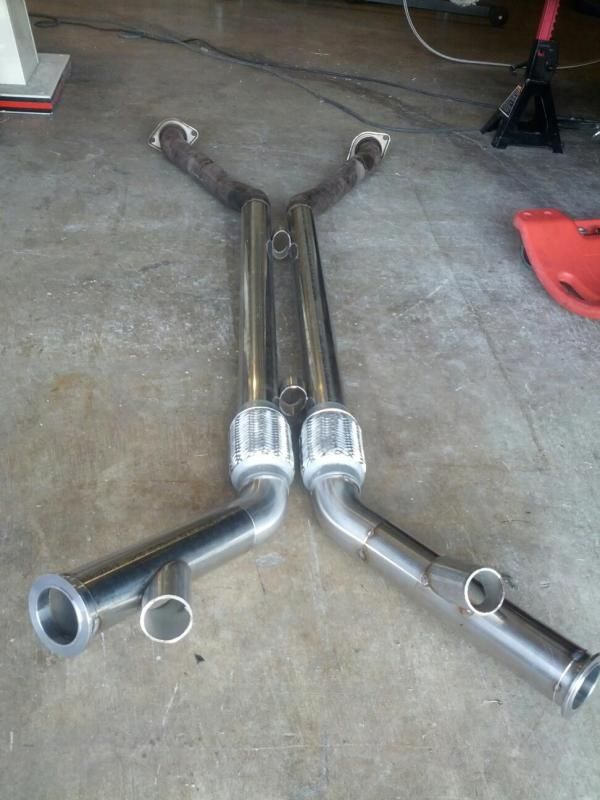

pacesetter coated long tubes 1 3/4

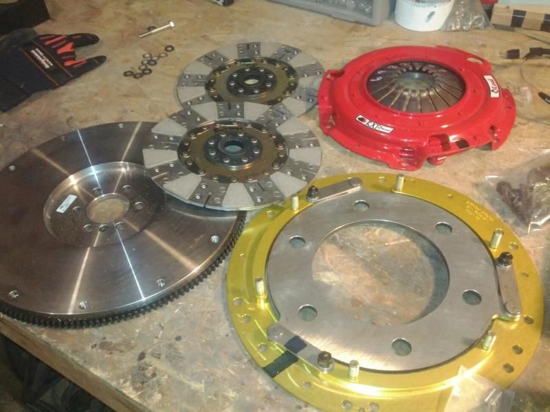

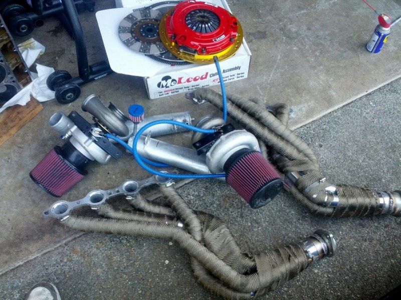

mcloead rxt twin and steel flywheel

twin PT billit 5858 v band in and out .82 ex
twin tial mv-r 44mm waste gates

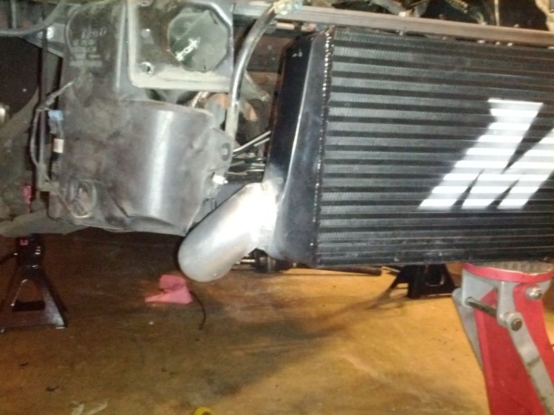

ebay intercooler 4" core

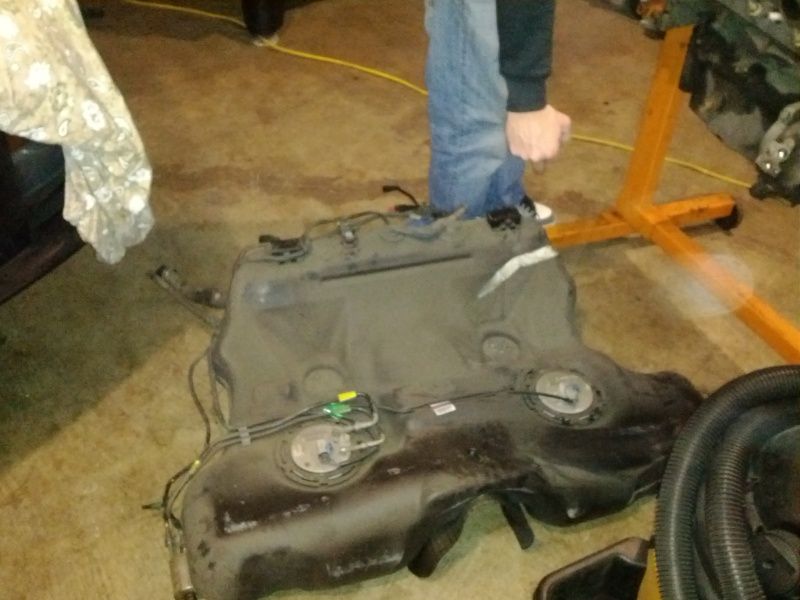

jaz 16 gallon fuel cell in spare tire well

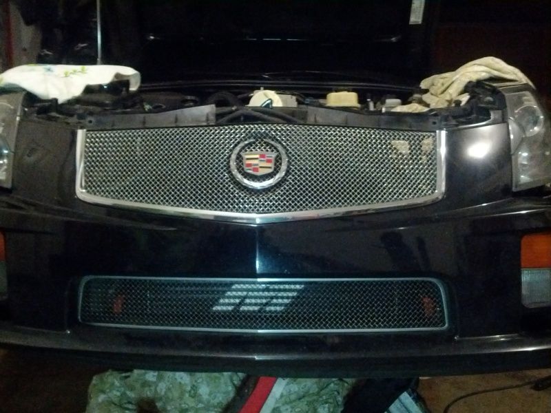

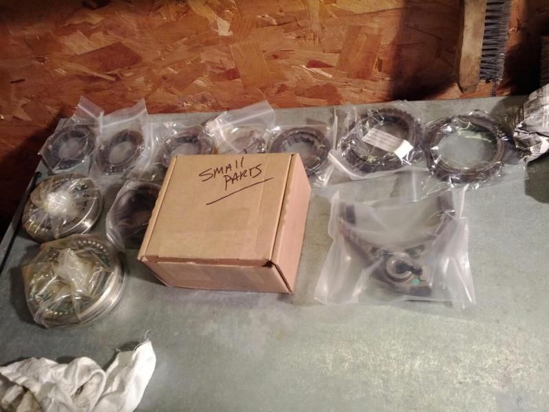

some pics are form the fist go around with the tubos, some are from this go around

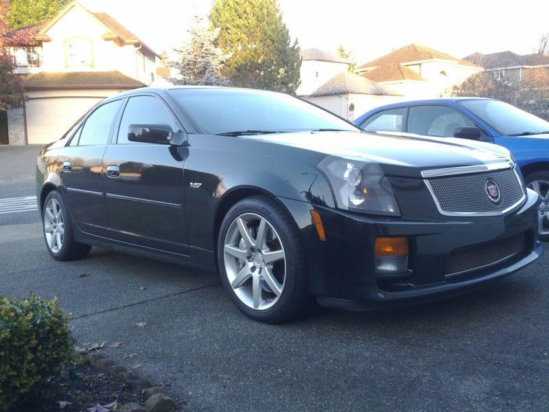

the day i brought her home last year

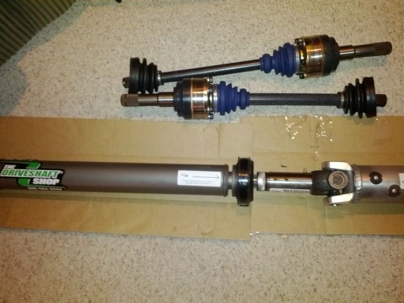

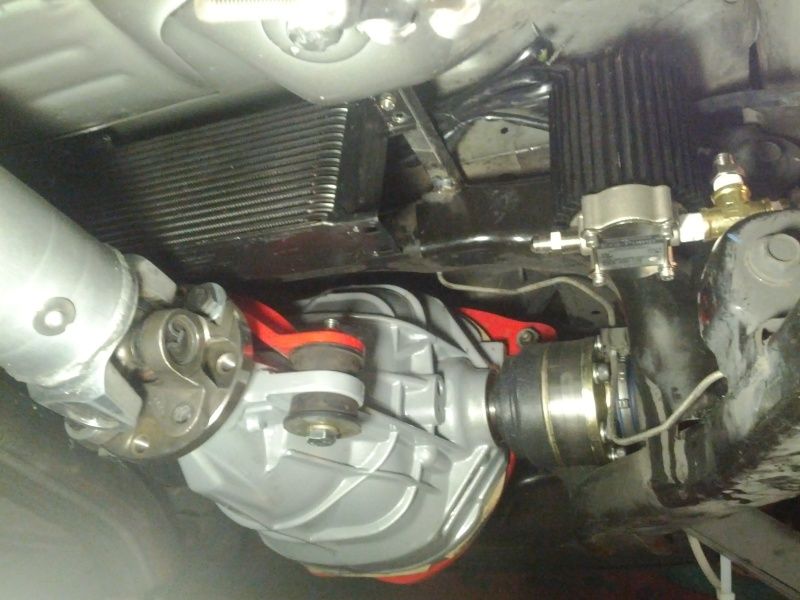

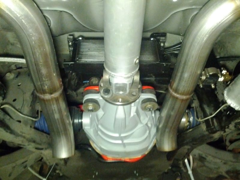

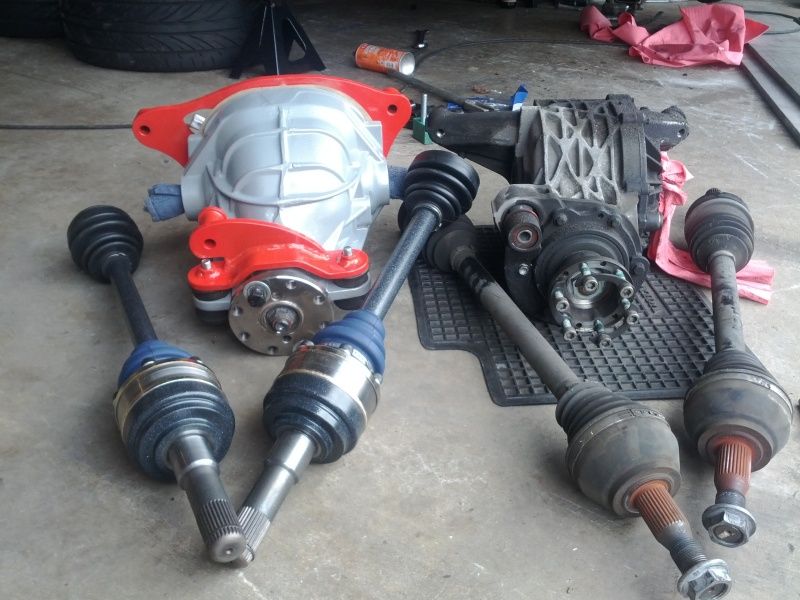

axels and drive shaft for the 8.8 swap
old vs new

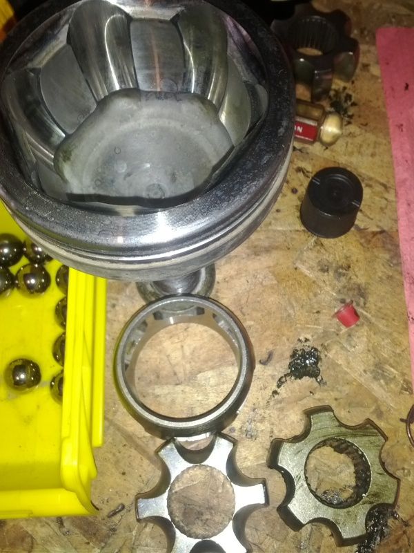

putting the stock cv outer on the new axels

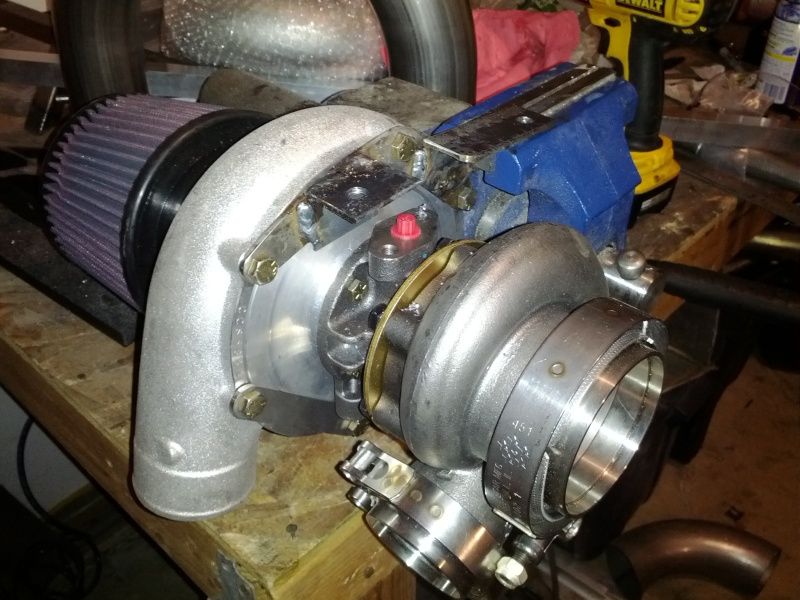

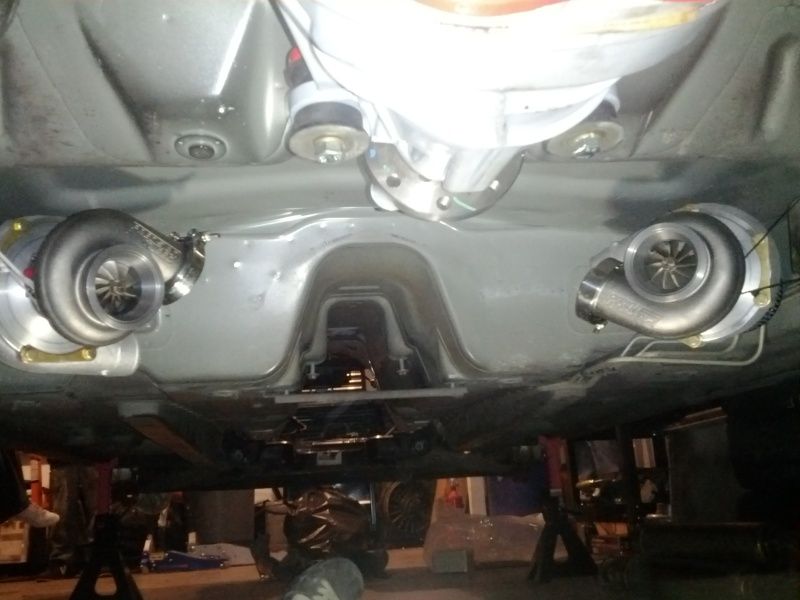

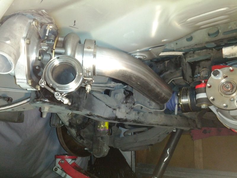

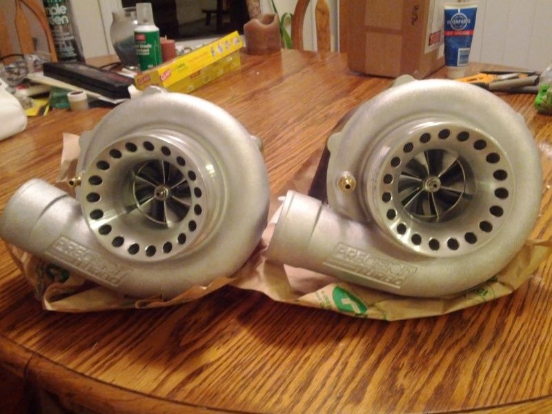

the turbos

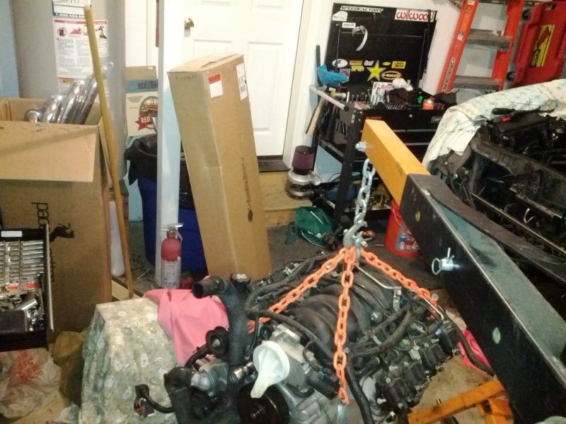

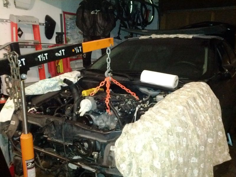

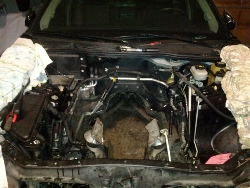

out with the ls6

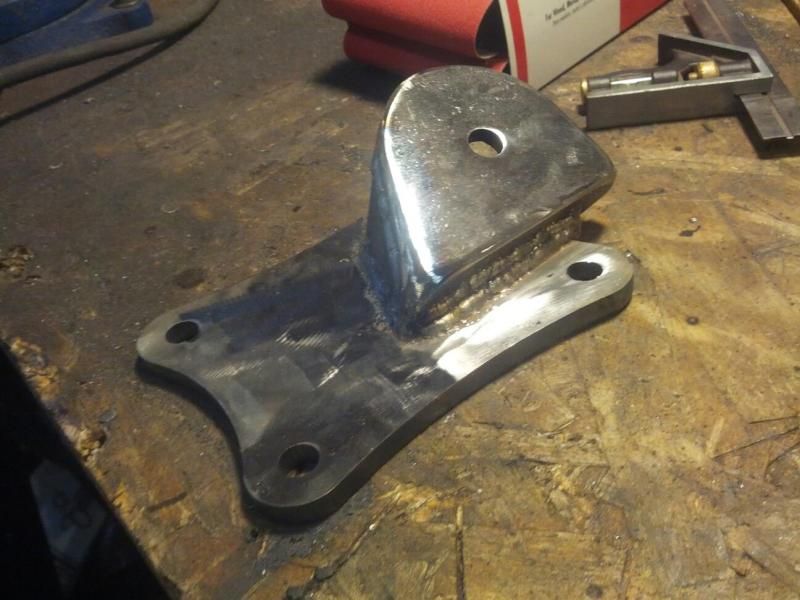

1 off motor mount for the iron 5.3 into the V1
time to make some room for the fun stuff.

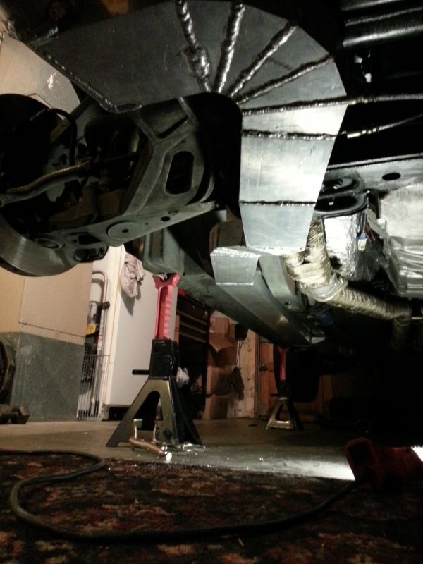

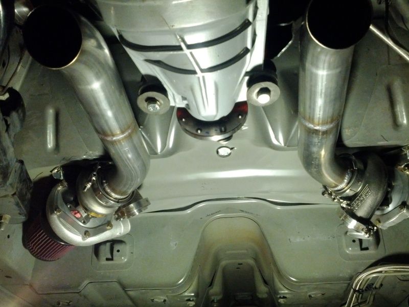

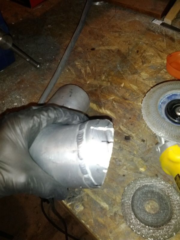

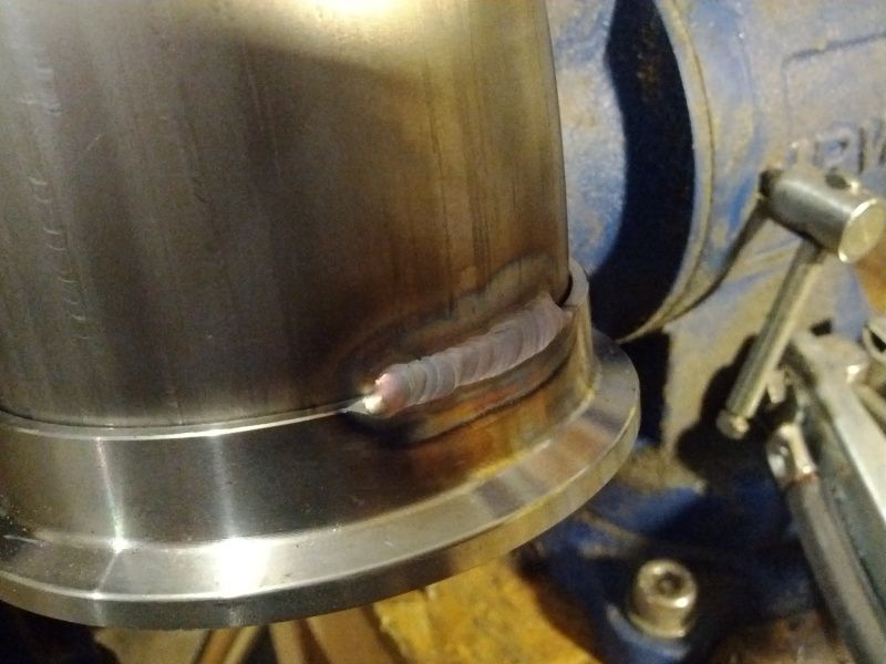

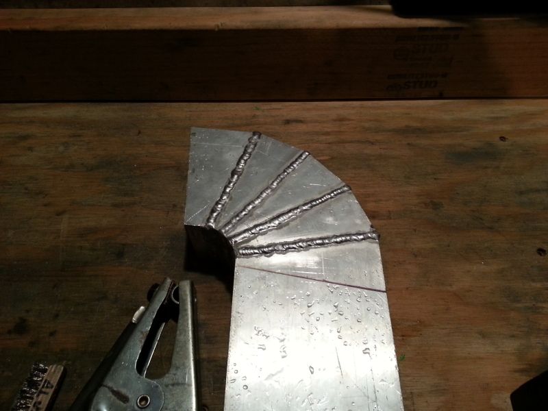

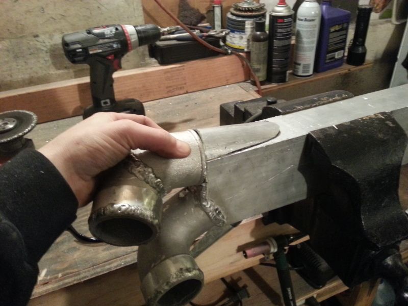

1st ss weld
the only way i could think to mount the turbos

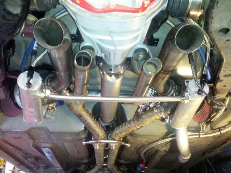

the turbo oil cooler gone now
old one of the 1st setup all done

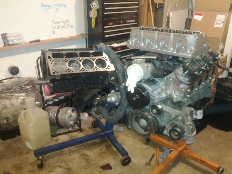

getting started on the motor stuff

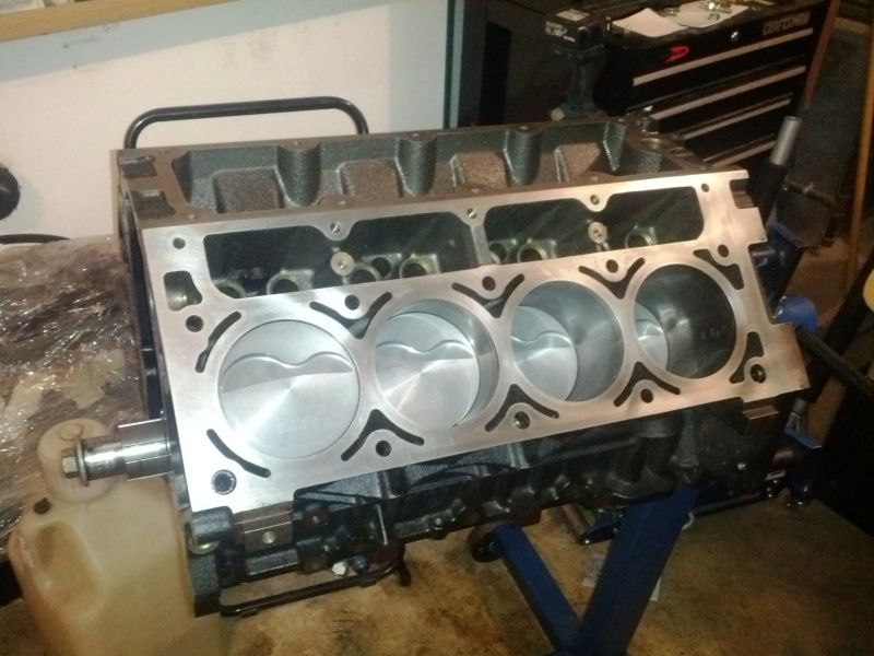

wiseco 10-1 pistons and compstar 6.125 rods
old and new

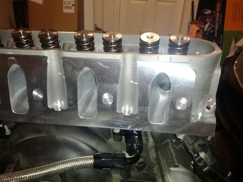

PRC 2.5 317s with 72cc chamber

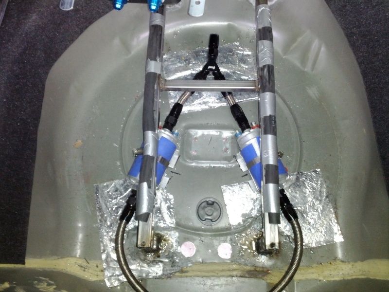

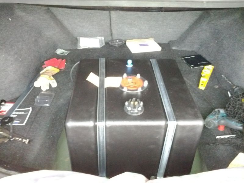

twin 044s in the spare tire well

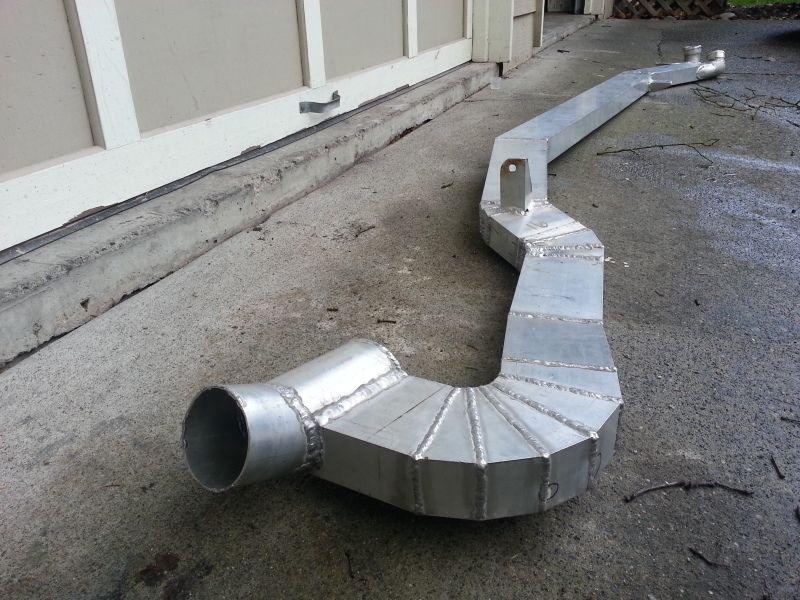

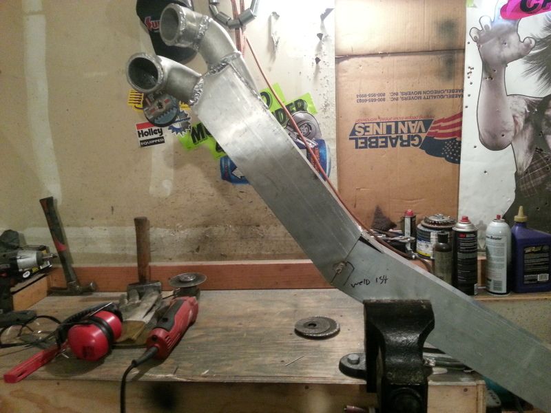

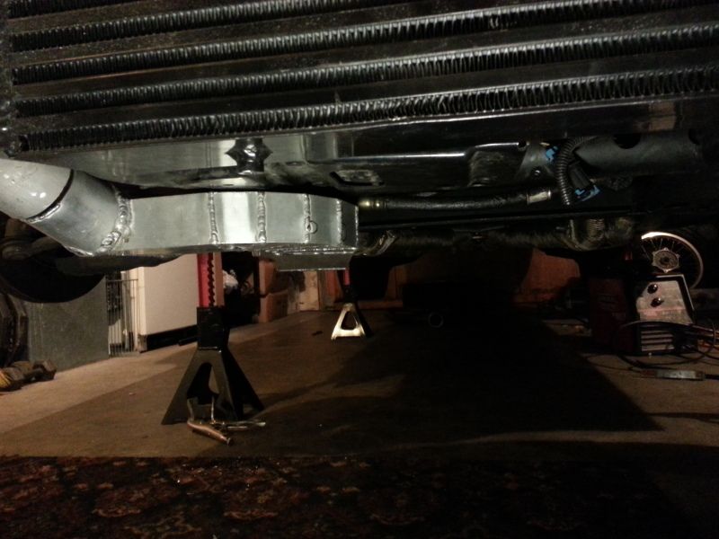

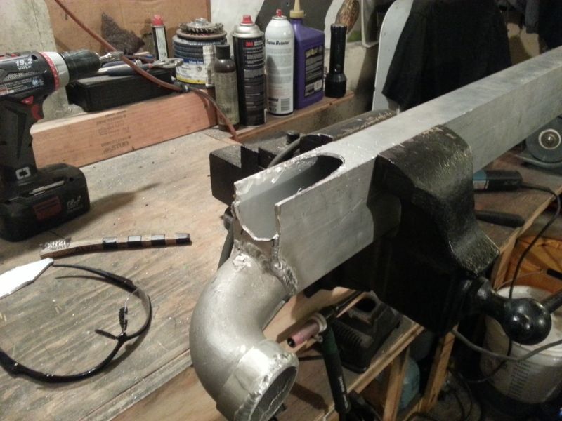

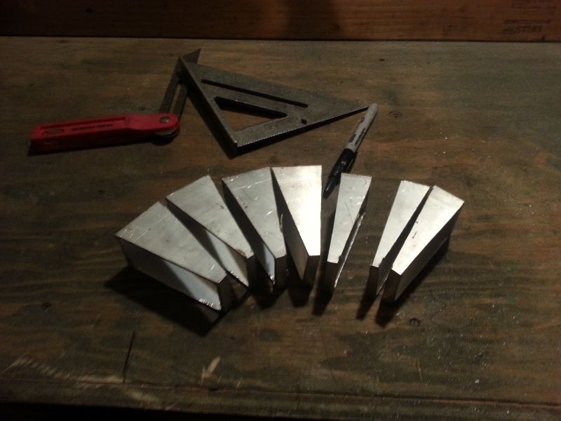

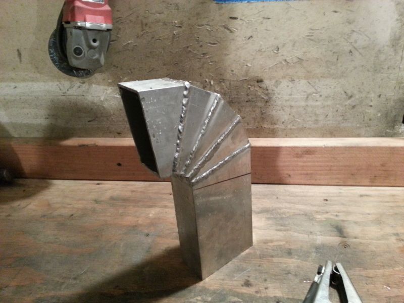

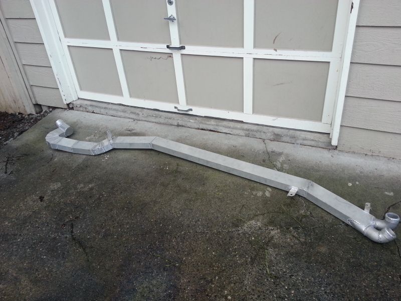

my new charge pipe.2x4  1/8" wall. the old one was 3" round and a 1 1/2" off the ground under the x-member and at the back of the car.

i also started taking everything of the car for paint and final Assembly.
too some pics of the charge pipe off the car to. man its a monster

Damn that bitch is longer then my crx :o
