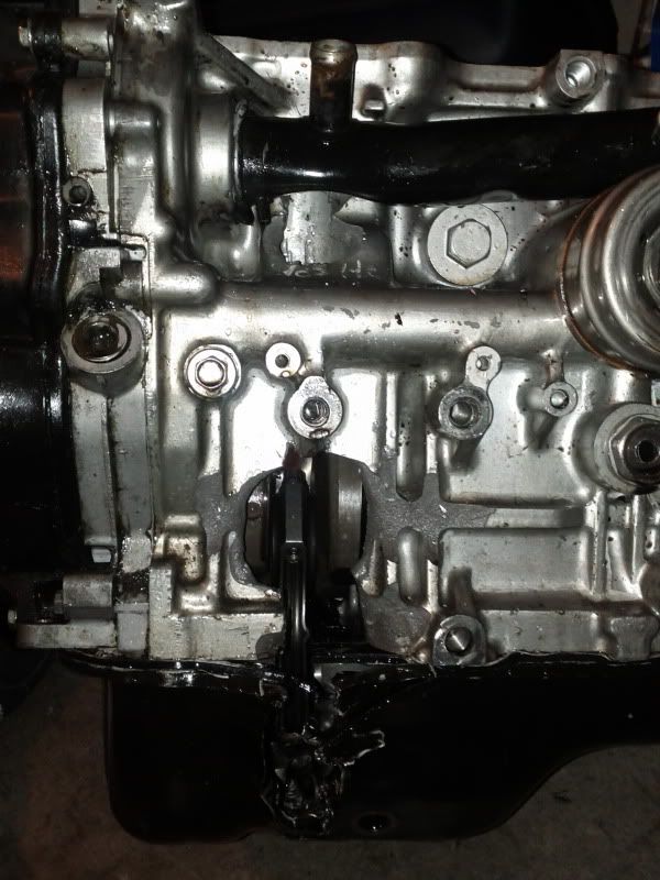

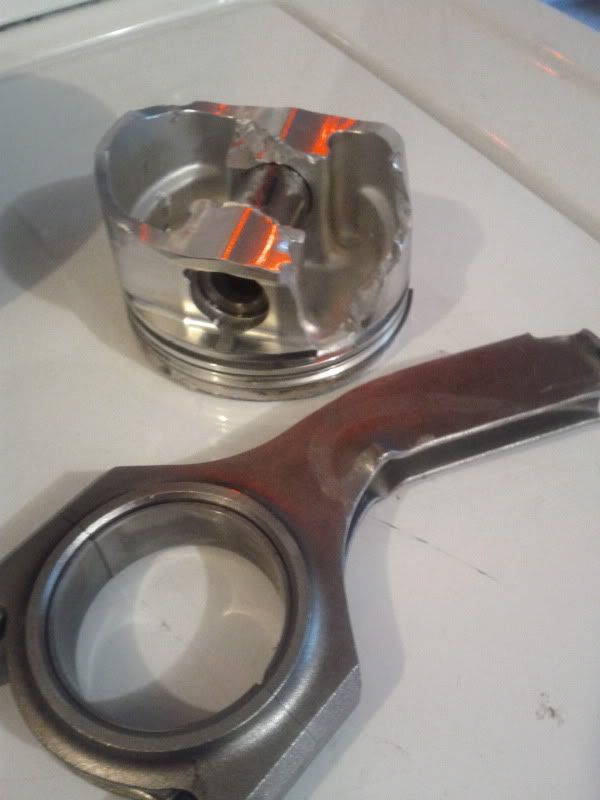

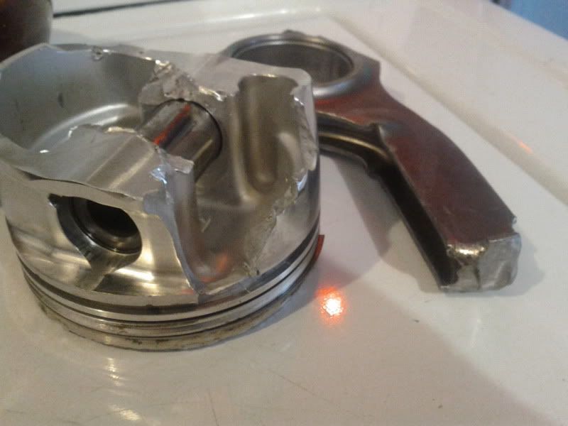

Haven't been on alot lately, but long story short the old motor finally took its final shit after a slutty faithful 6 years of being face fucked and hurting grown mens feelings. Lost a rod and completely destroyed the block finally (as when I had welded her shut from the previous hole in it, I went to 89 mm... The last on the sleeves that could be done.). The small end of number one rod (Eagle) opened up spinning fourth gear off the limiter at 110 MPH on pump and meth (coincidentally with the kid that was going to buy the long block in the car as I had already planned on building a completely new motor, E85, bigger turbo cams and a cage anyways)... Plans have changed now, but car is getting caged still... Just the build will be slightly hotter than Last time.
Was taking him for a test drive and 3rd pull she let loose  LOL. Not sure if this vid will come up (Its on his FB) but he was recording  :noel: . Shifted fourth it spun, I peddled it and Boom. Too bad too, upon dis-assembly All the bearings and pistons other than number 1  were perfect. Crank, perfect... Bent 2 ex valves, but other than that Head was Ok too. Sold the head and some other stuff and threw everything else away. Had too. Shortblock was fucking ravaged.
https://www.facebook.com/photo.php?v=426724004056905&set=vb.100001579287313&type=3&theater

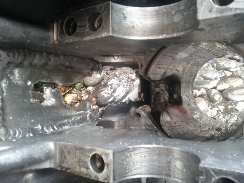

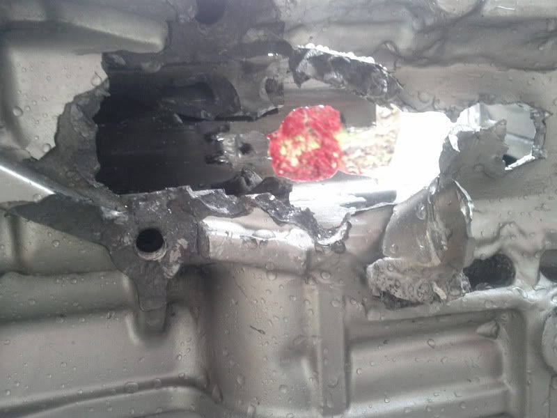

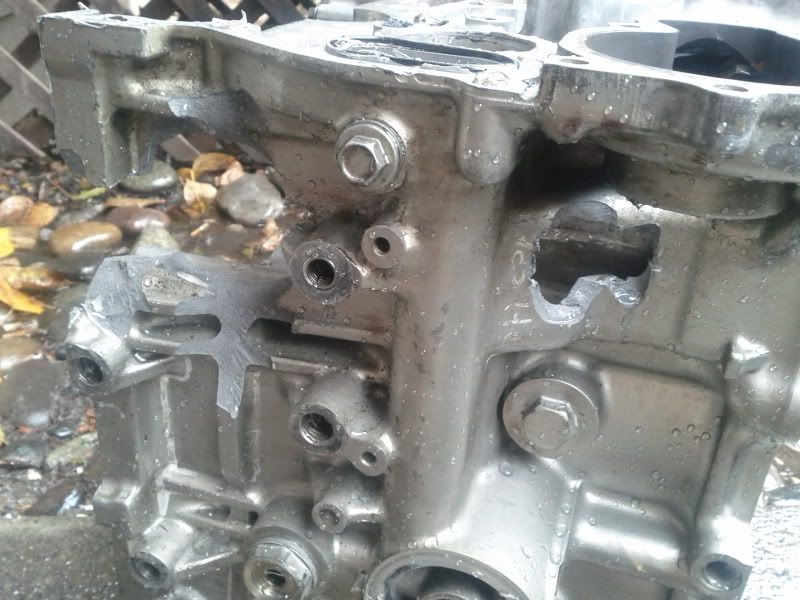

Carnage:

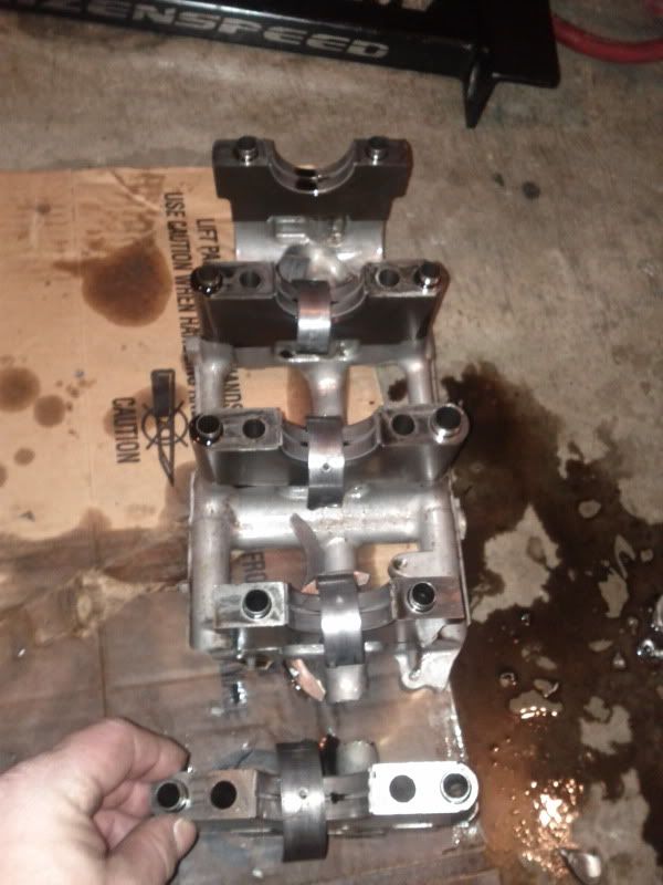

Cut the crank bridge in half

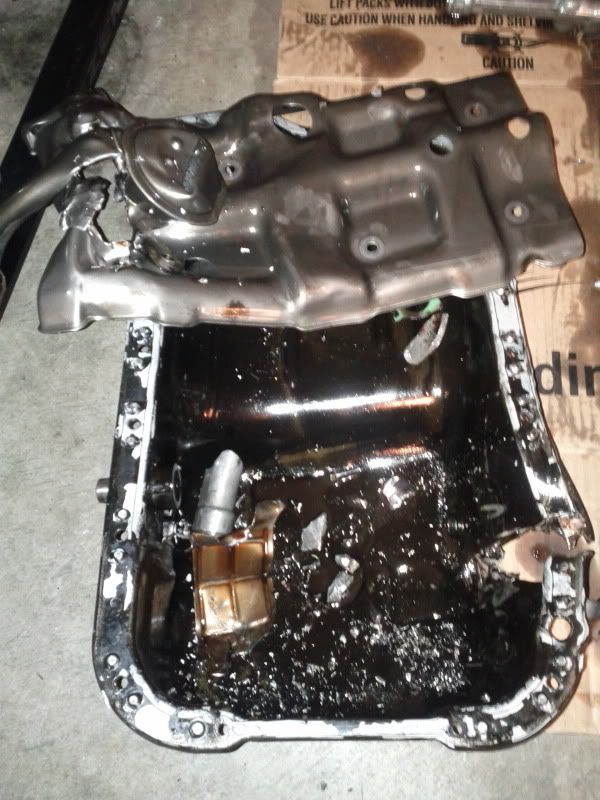

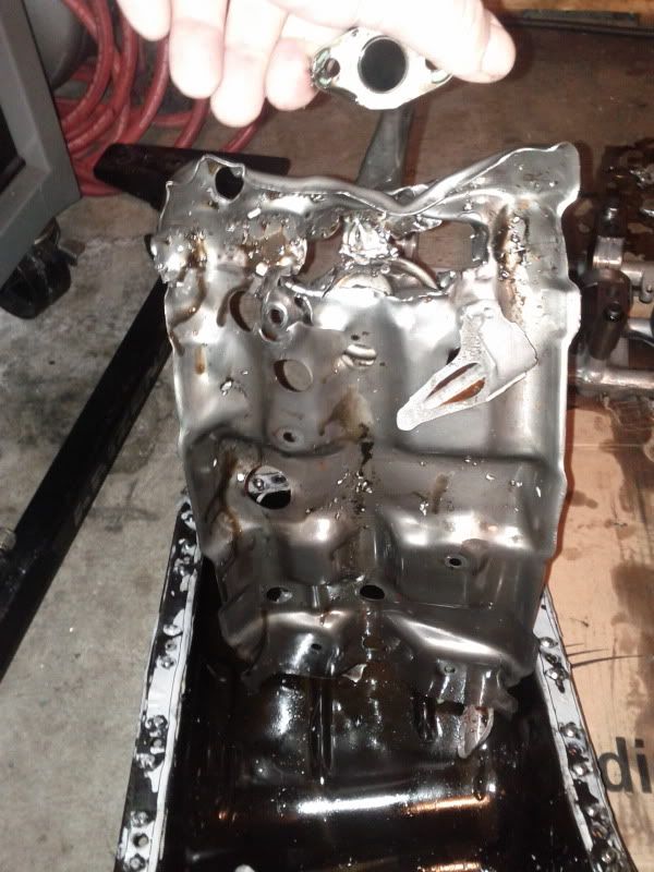

Pan and windage tray had holes and were fucked:
And the money:
Rod and piston (Wristpin bushing was sitting on the tranny LOL):

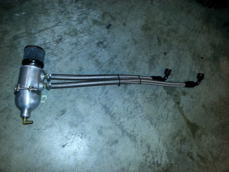

 Also this weekend starting the ABS delete and putting a bigger PCV catch can where it was.
Bought Mitches old Benson sleeved H22A1 closed deck block that was in the Prelude for 200 bucks with caps and crank bridge (It was at 87.5mm, going to 88mm on this build)  It had a much less traumatic breakage before mine did the first time so... you guessed it... I had Ricky @ Speedfactory weld the fucking hole up and Im building of it. No real structural damage at all ;O)  Before and afters:

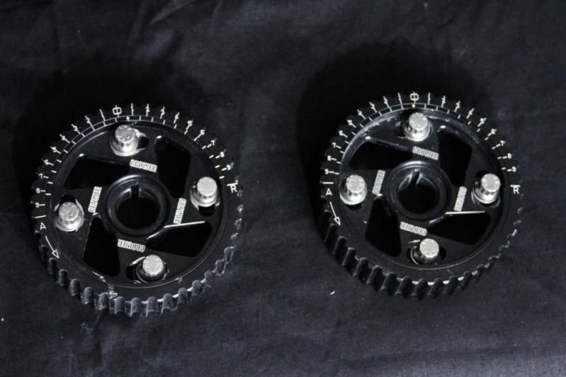

Set of Crower Cam gears I scored for 50 shipped (There will be Pro 1s in it this time) :O)

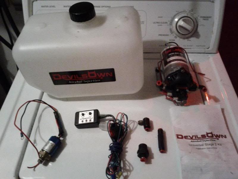

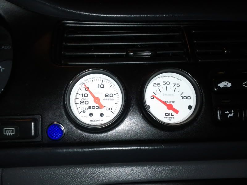

Im using a Devils own progressive controller, 12 GPH nozzle with a 2.5 gallon tank and an asjustable pressure switch for a fail safe. There is a check valve right at the chargepipe as well, as to stop vacuum from wicking meth into the chargepipe when nor in boost as well.
I run 75/25 VP M1-distilled water
Kit kicks in at 14 pounds and is all in by 20. I made a touch over 600 wheel on it at 26 Pounds.
Mitch had this setup in his car and used the switch to switch timing maps so when the switch sees no pressure from meth, it pulls all the timing out of the map... WHich... Worked as I was racing him one time and the tank went dry and It pulled the timing out and I heard it work right next to me. 620 WHP to whatever with 0 timing but the same boost really sounded horrible, and I thought there had to be a better way.
I HAVE IT setup to where the Switch IS THE NOGGLE button. So, if there is line pressure... The ecu lets the car go on the hi boost settings (Using GPO input). If there is no line pressure, It only falls back on the pump safe boost, no more timing pulled like what Mitch had. That way, No weird shit from falling back onto a map making a bunch of boost with no timing at all. I tested it and the switch registers instantaneously, and the ecu adjusts instantly switching from Hi to low boost tables. It works PERFECT!
Also, I have a big VERY BRIGHT Blue LED on the dash that lights up when the kit comes in... It flutters when its ramping up and comes on solid when the pump is in 100 percent so I know whats going on  :O)
Its worked fantastic.

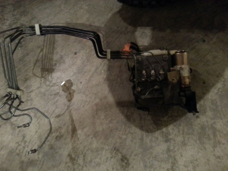

ABS delete...
Going with a 40/ 40 prop valve and Type-R MC with the 1" piston. The corner will be filled by a new Catch can setup that has an integrated tank for PS fluid.
FUCK YOU
Plenty of room for a new setup. GOt to get rid of a BUNCH of wiring harness too. Its going to look pretty slick.
