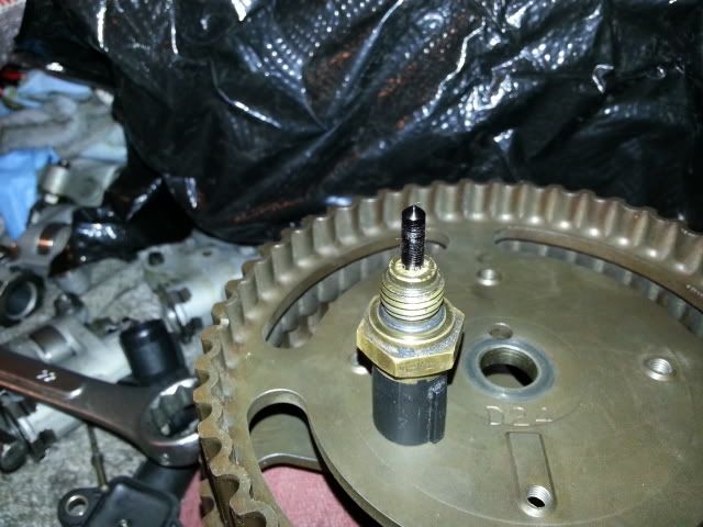

btw that pic i posted is of a ECT sensor, with the brass piece cut off the end.
