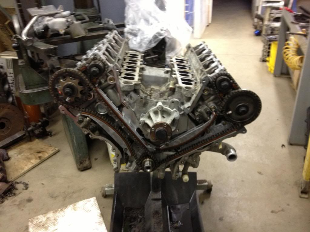

So here's my semi build thread. Non turbo so I know most of you won't care but I'm posting it anyway. I picked up my 1998 gt a while ago and it was bone stock. With the anemic non pi 4.6 and automatic I was bored with driving it pretty quick. I decided it needed a dohc 4.6. I picked up one from a 1998 mark viii. They have an aluminum teksid block. I also decided to add a flowmaster exhaust, 4.10 gears, a 2500 stall converter and added a 125 shot of nitrous.
The car the day I got it.

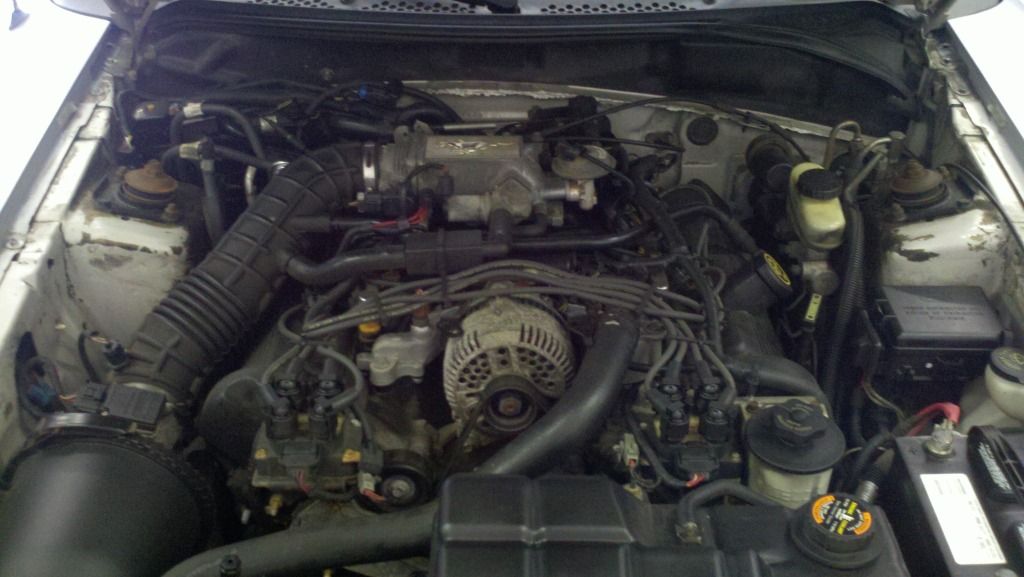

The old engine.
The new one.

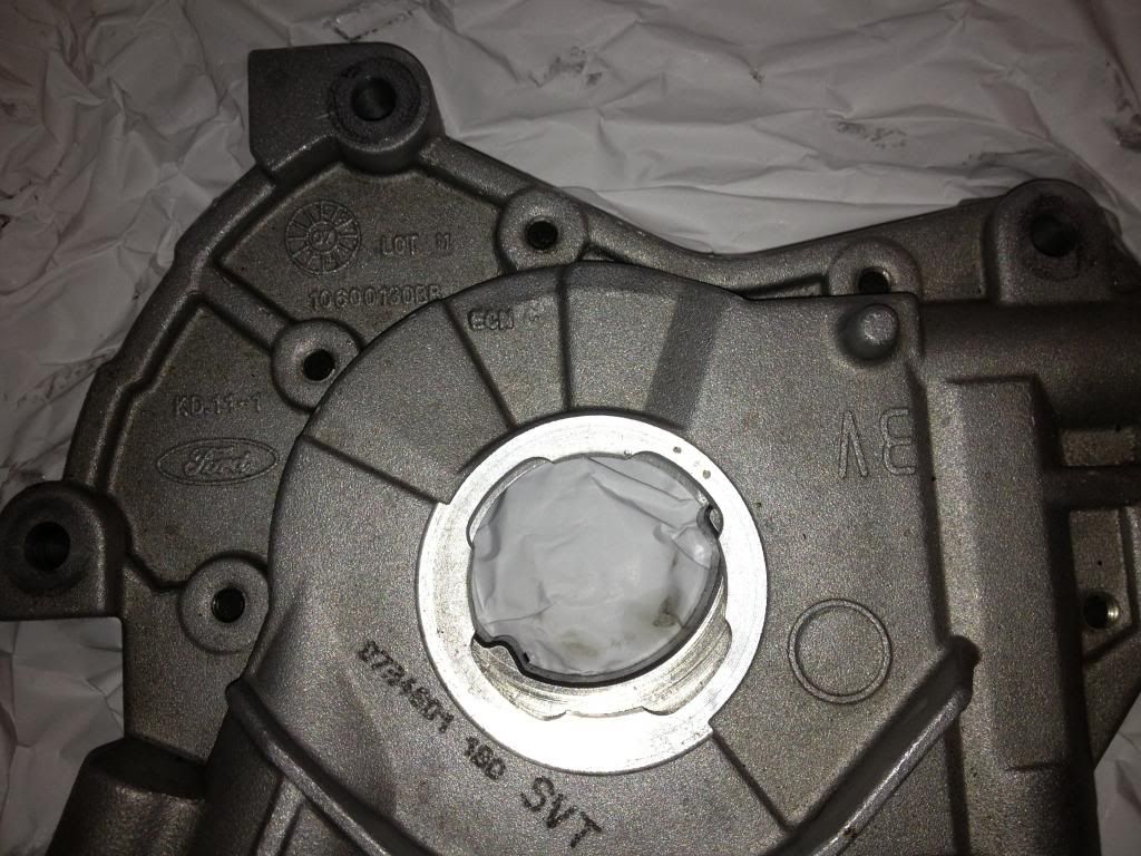

I beat on this one for 15,000 miles with zero issues but it's still slow. So I decided to upgrade a little. On a very limited budget okay I just didn't want to spend much I began hoarding some parts. I picked up a low mile gt500 oil pump.

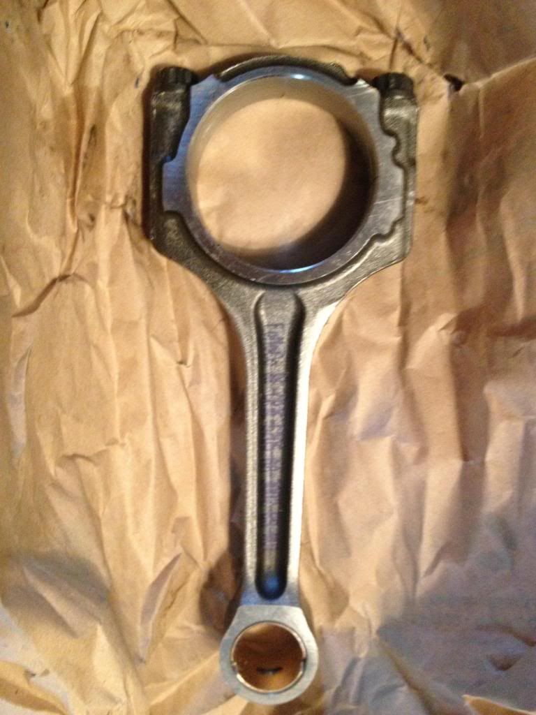

Some new in box boss 302 connecting rods (proven to hold over 1000 hp and 8,000 rpm).

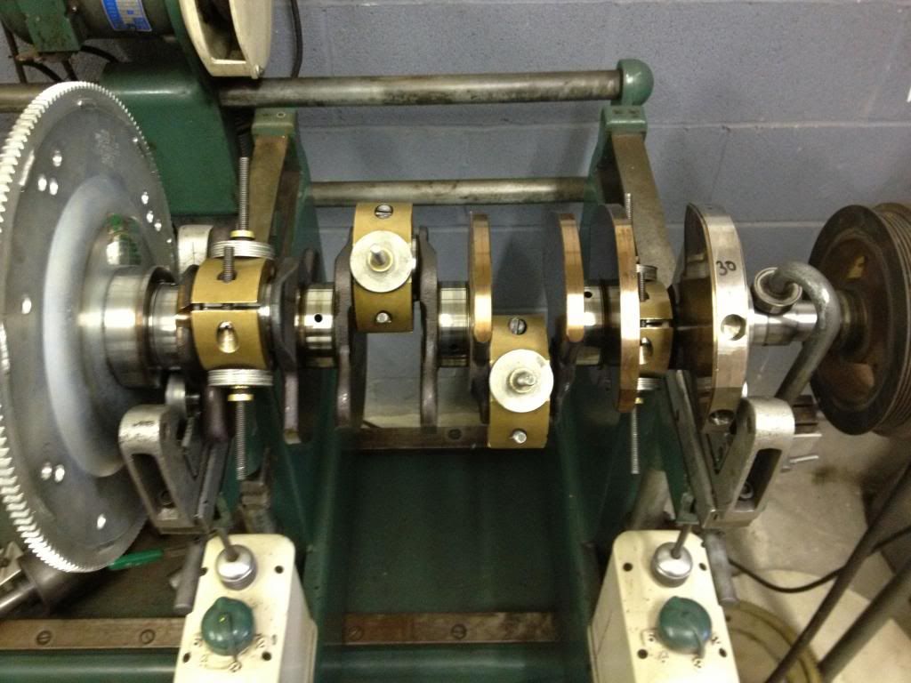

I also picked up a factory kellogg forged crankshaft. I had a set of 7 good manley pistons and ordered one to make it a complete set. I balanced the rotating assembly on our balancer.

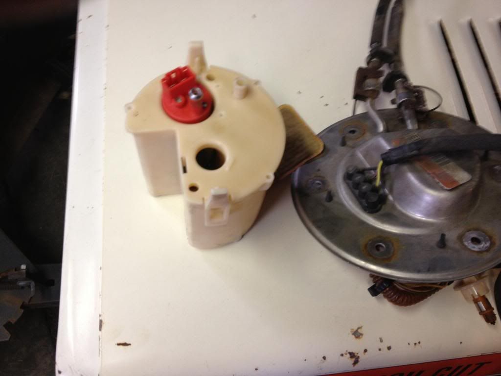

Picked up an aeromotive stealth 340 lph pump and modded the stock basket for it to fit.

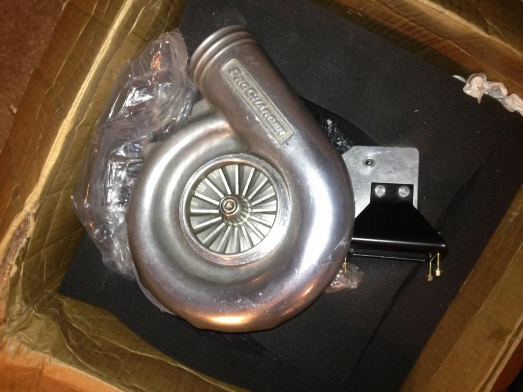

Scored on a super low mile procharger p1sc.

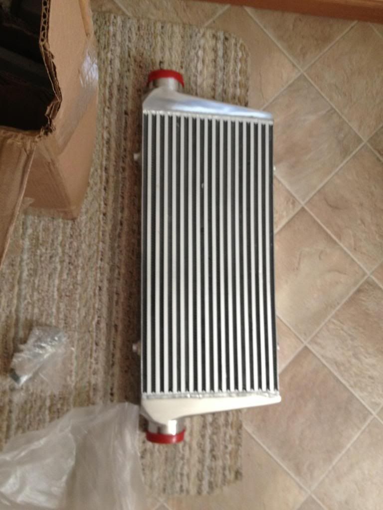

I'm broke so I ordered an ebay intercooler and piping kit.

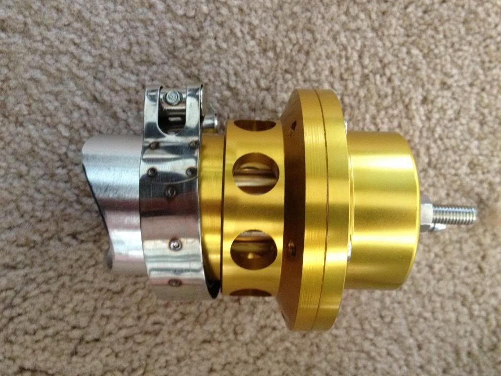

« Reply #13 on: May 01, 2013, 07:57:25 PM »
This showed up today!
Re: My non turbo failure of a build thread!
« Reply #14 on: May 01, 2013, 10:18:52 PM »
wtf is that? new style china 50mm bov?
« Reply #15 on: May 01, 2013, 10:46:29 PM »
I hope so. The tial knock off was always my favorite bov. They have gotten expensive and hard to find

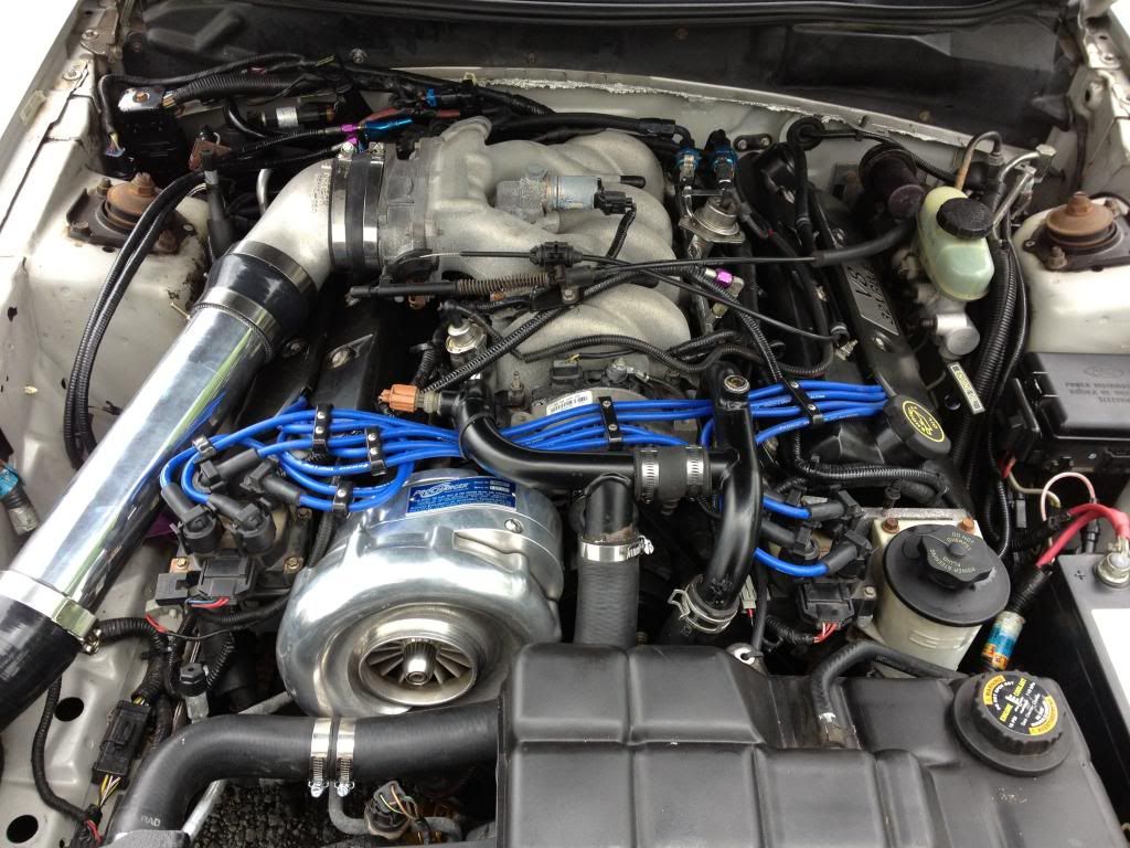

« Reply #17 on: June 08, 2013, 07:40:27 PM »

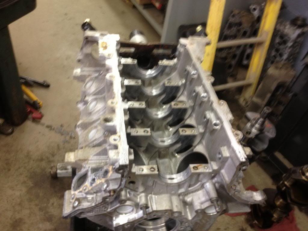

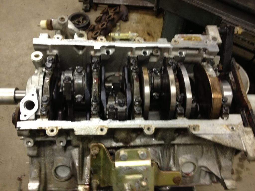

So I made some progress. Pulled the engine and installed the forged internals. Here's the block fresh out of the jet wash cabinet.

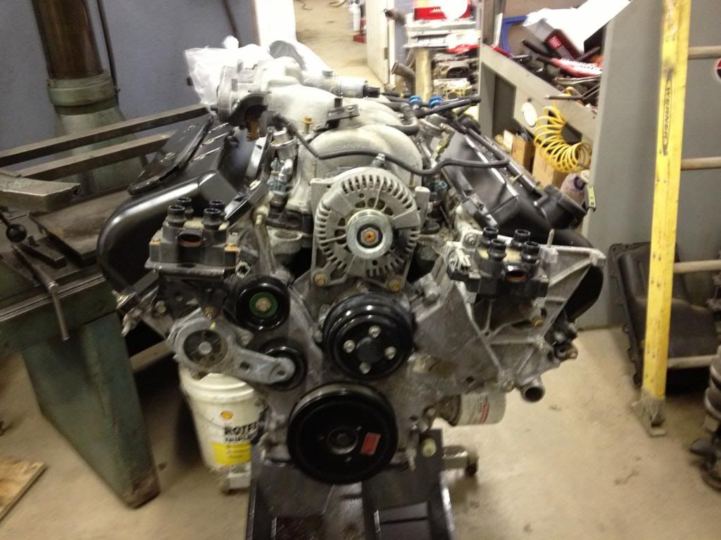

The engine being assembled.

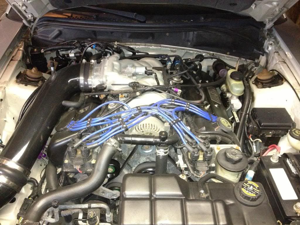

Got the engine in and broke it in n/a for a few miles. Finally got off my ass and installed the intercooler, piping, and supercharger.
« Reply #18 on: June 08, 2013, 08:33:52 PM »
what engine management is powering and slated to be powering this failboat?
Minor Threat
  • Posts: 2401
« Reply #19 on: June 08, 2013, 08:44:04 PM »
he's a ford owner so probably an FMU
« Reply #20 on: June 08, 2013, 09:20:01 PM »
didnt see one in the pics, so i was kinda scared he forgot it put it on or something....maybe its tucked out of sight?
Who needs engine management?
Minor Threat
  • Posts: 2401
« Reply #23 on: June 09, 2013, 10:04:43 PM »
You're swapping in a carb?

« Reply #26 on: June 10, 2013, 01:05:01 AM »
is this a maf or sd? What did you pay for the Pro charger?
79fairmont
  • Posts: 1709
« Reply #27 on: June 10, 2013, 07:08:46 AM »
It's a maf car. I will tune it using sct software. We have pushed these cars to over 1000 hp on the factory PCM with no issues. I paid around 1,000 for the procharger.
