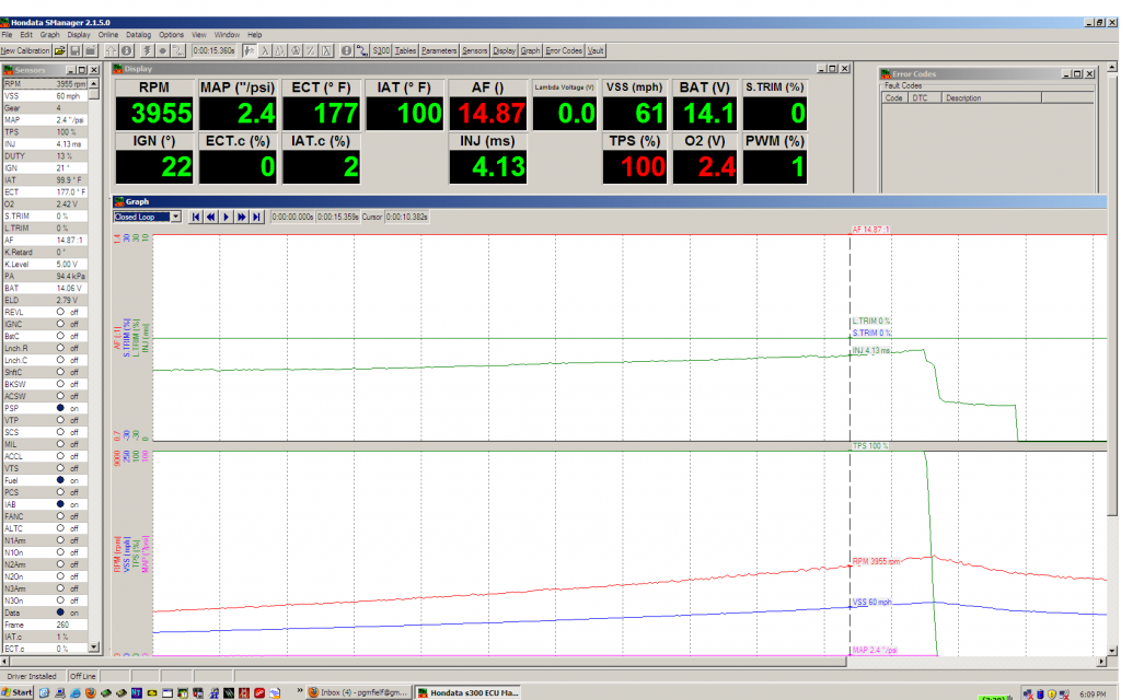

(01:57:48) Fred: http://www.realhomemadeturbo.com/forum/index.php/topic,22534.0.html < You're Bob, btw. Thoughts?
(17/06/13 00:00:01) Day changed to 17 Jun 2013
(02:56:20) Bob: my thoughts is that the particular car started and ran fine with a different ECU connected to Crome
(02:57:08) Fred: you're up late
(02:57:15) Bob: I just got home
(02:57:18) Fred: :-)
(02:58:46) Bob: and the particular S300 does communicate and all
(02:59:00) Fred: doesn't?
(02:59:05) Bob: it does
(02:59:16) Fred: woops, read "at all" not "and all"
(02:59:41) Bob: but the engine just doesn't want to start reliably, no matter what fuel injector sizing I tell it
(02:59:56) Bob: and no matter what I do to the cranking fuel tables
(03:00:45) Bob: it sometimes does start but is very inclined to stall instead of idle
(03:01:17) Fred: ok
(03:01:21) Bob: the UI of Smanager just doesn't help
(03:01:35) Bob: and the data readout is full of shit
(03:02:04) Bob: for example, I couldn't see any indication of what the actual injector pulsewidth was
(03:02:07) Bob: while cranking
(03:02:42) Fred: that's pretty poor...
(03:02:50) Bob: which is the sort of information you need to know to diagnose bad starting behaviour
(03:03:16) Bob: since it's not easy to figure out what the ECU is doing by just reading the user configurable options
(03:03:26) Fred: of course not
(03:03:42) Bob: a direct indicator of what's going on is pretty essential to have
(03:03:48) Fred: +1
(17:03:07) Fred: can i "Bob" you out of the above and paste this into that thread?
Not only can injector pulse be populated in the display bar by right click-->add new gauge, it appears by default as the sixth value down on the sensors tab at the far left.  It can also be made to appear in datalogs by selecting it via template options.
Bob needs to slow down, stop making assumptions, and start questioning the premises by which he has reached these conclusions.  Being cocky like that is old dog syndrome, and is a form of failure as it leads to cognitive breakdowns such as this.  This - tuning - is a hard way to make a living as the job is not simple, and every car is a problem car, but I'm free to be openly critical due to Bob's anonymity.  I've cleaned up a few cars in the last two years after a guy whose name I used to read in Hot Rod magazine as a teen, who has set some make-specific records.  Basic fucking errors.  In my mind he is still a legend, but he has old dog syndrome as well as the sin of pride.  I look forward to who I may one day become and I'm scared I'll turn out like him - a tired old man, a fraction of what I once was.  His polar opposite, inasmuch as I can claim any deep understanding of men met only in passing, is Bill Hendren who I met a few years before he passed.  Bill was as full of curiosity as he was knowledge.  A wise old man.
