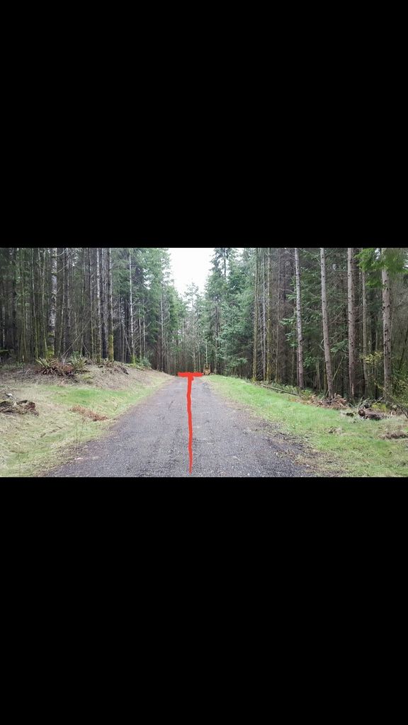

So I went out to the property on wednesday7/13, and friday 7/15 and staked out the whole drainfield and the reserve area for the septic system because the owner felt that I might have had the building envelope for the house on top of the drain field. Nope, I didn't so we're good to go there.
That's all for now. Kinda keeping this build as a log of everything on the land and house so I can go back and use it like a journal/log of the whole process.

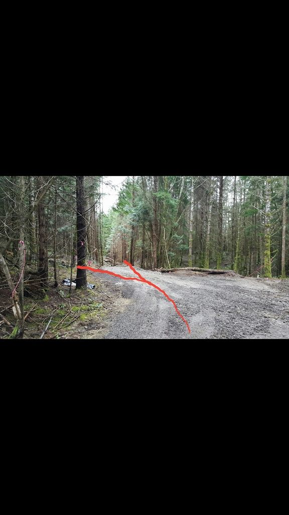

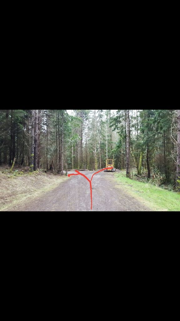

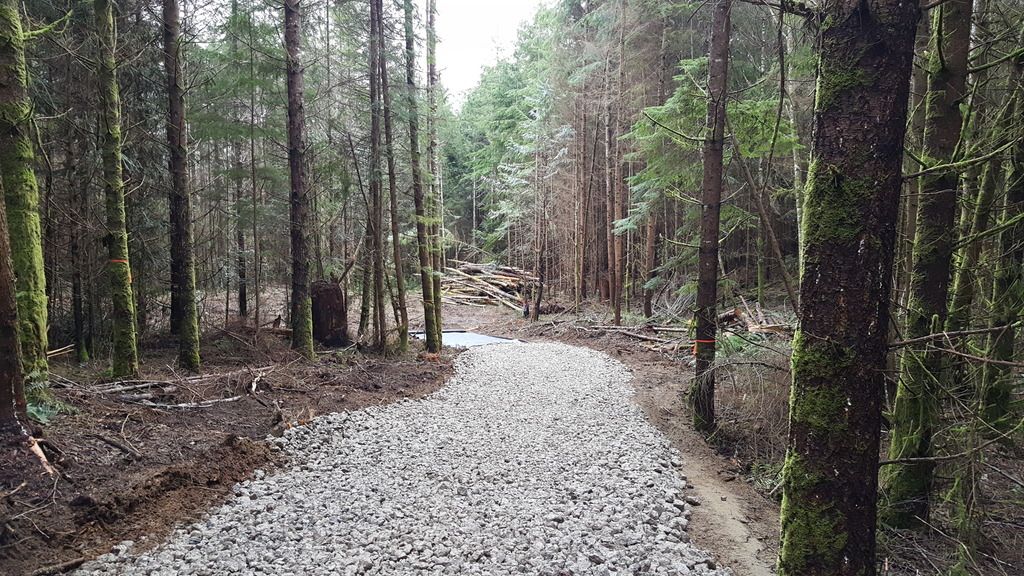

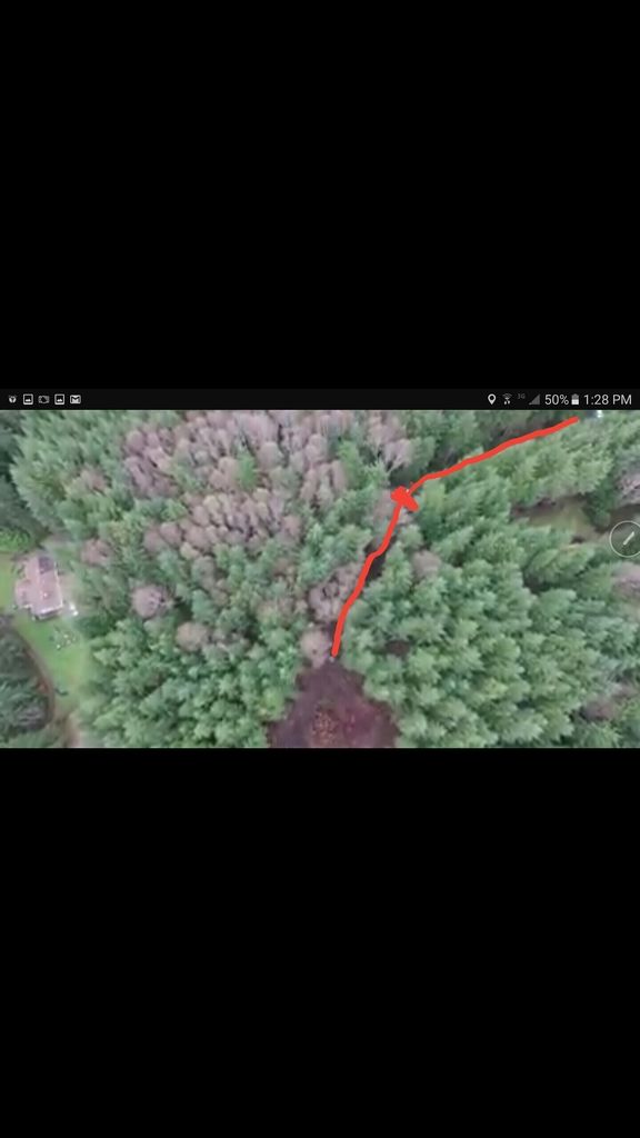

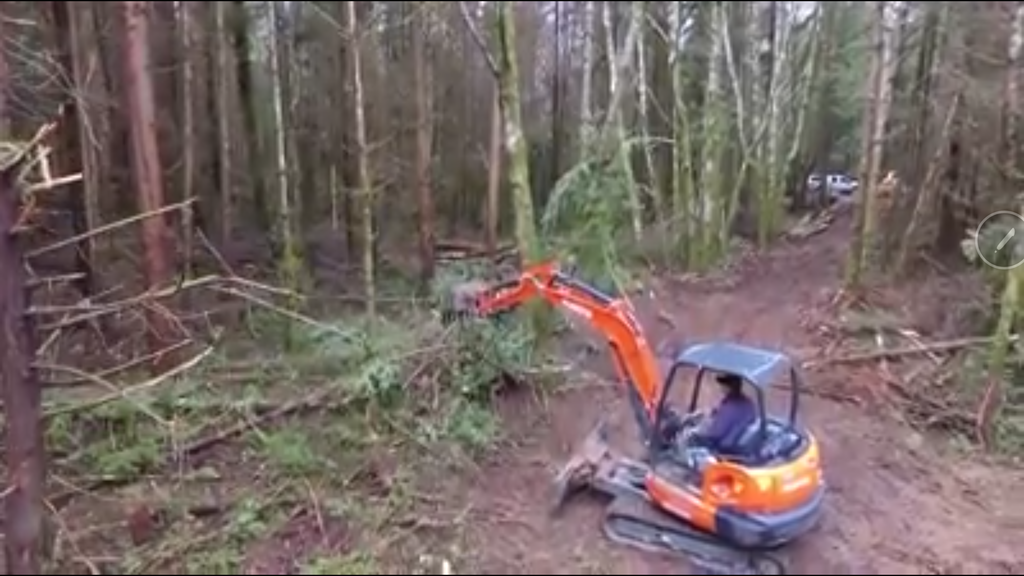

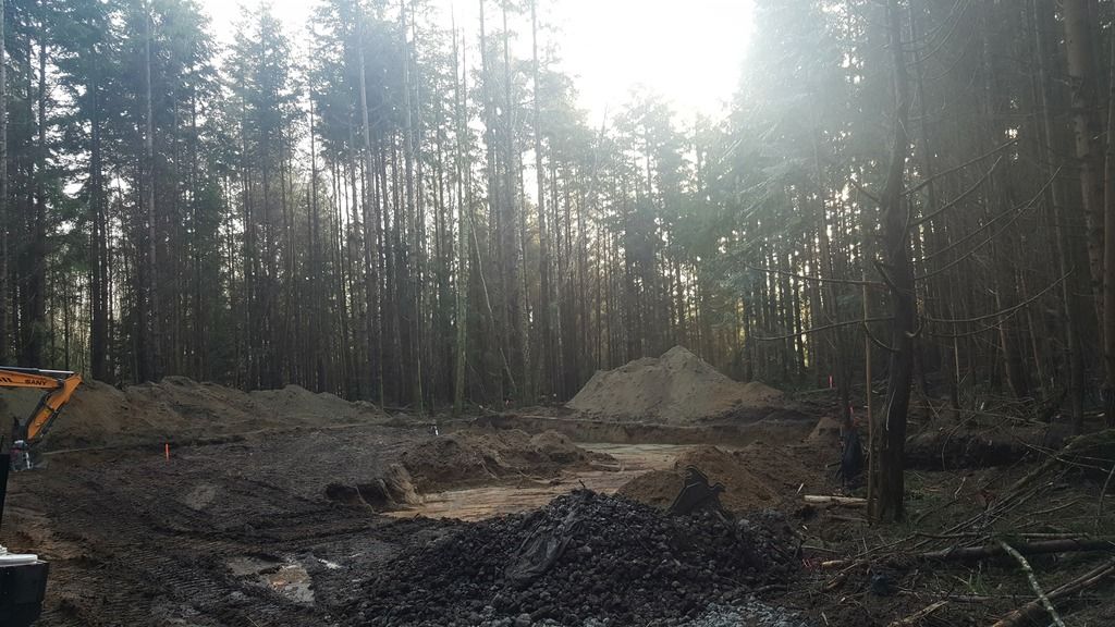

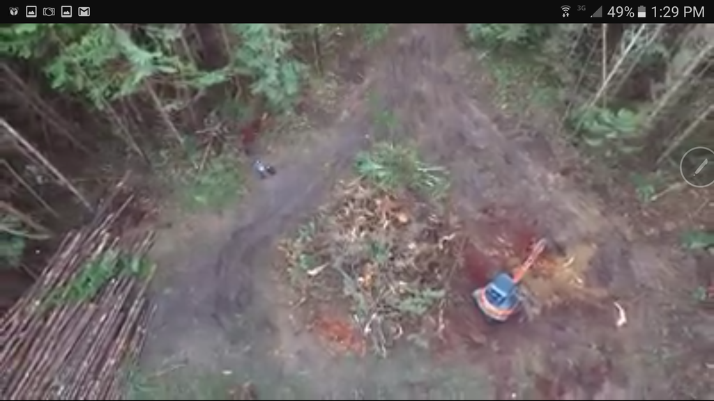

So not much to really look at because they are screens shots of video, but some are actual pics I took today.

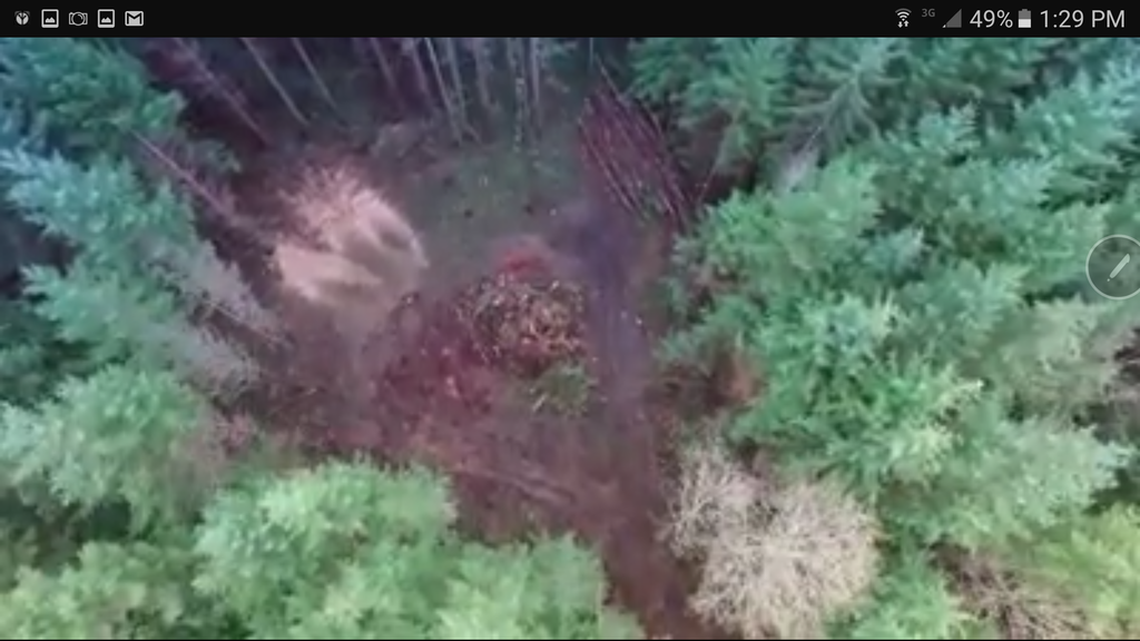

Had a friend come fly his drone over my property and got some pretty cool shots of it. Here's what I got. Will have lots more to come.

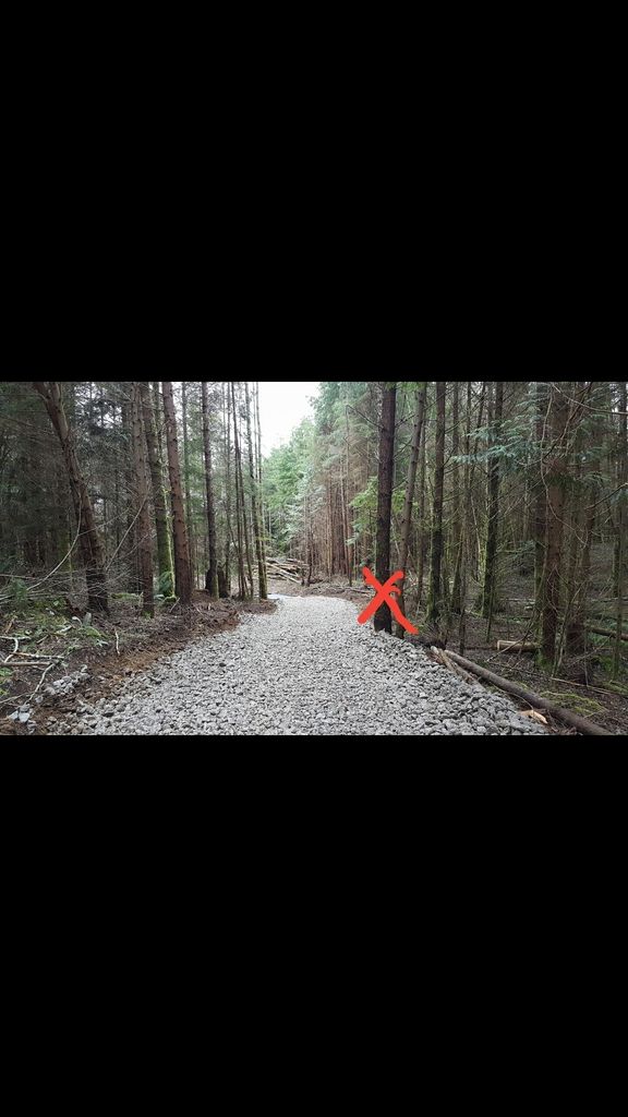

Taking Tree with red x down.
Bringing in another 12 yards of gravel b4 we excavate for our foundation. Then another 12 after we backfill and that will take it right up to our garage. Then I need to bring in about 60 yards of five is he'd gravel when it's all said and done and compact it all down.
Also don't know why it's hot linking my photos but what ever.

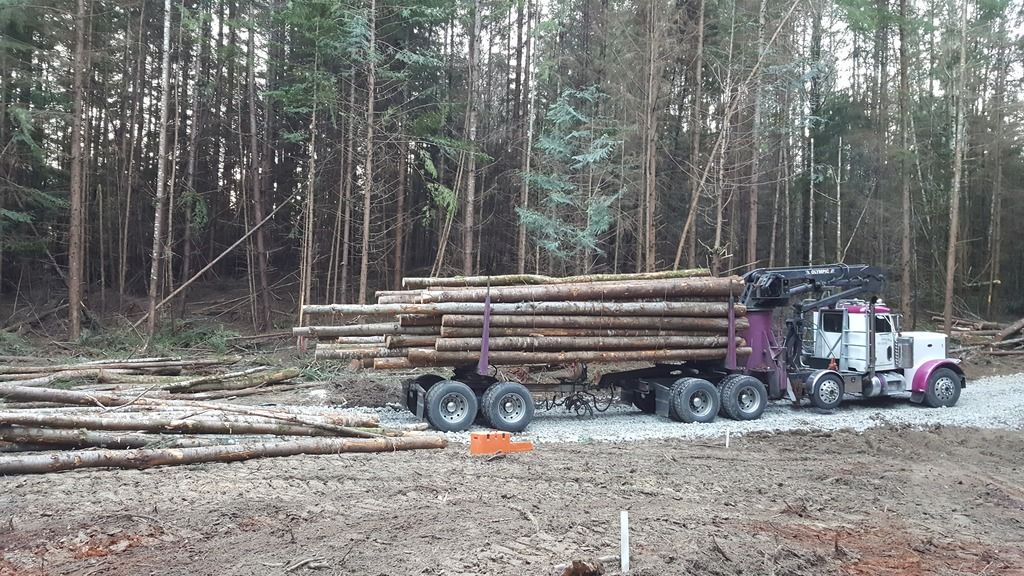

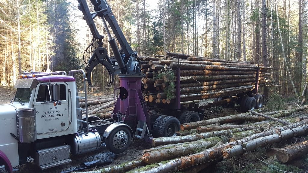

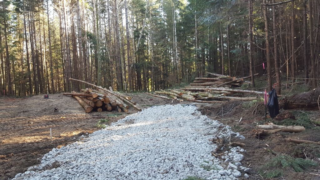

I had a hell of a time trying to get the firewood guys to come pick up this timber so we could make our deadline. Called and called for weeks and kept getting the runaround. Pulled a few strings and spoke to a guy with a self loading timber truck and he took all but about 30 sticks to the mill. I had to cut the rest of the stick up into 12 chick's so I could move it off the build site. What a pia!! But it's done. So then the guys I hired to do the site excavation showed up and kicked ass!  So we made it. Everything had to be dug out and ready for them to come set up rear and forms by the 26th. We were done on the 23rd. Contacted the build he said that someone should set up a meeting with me in the next week or so to talk about the foundation and what's next. I'm pretty pissed off that I had to fucking kill myself trying to get this shit done in a quick manner for him to tell me they builder is gonna take there sweet fucking Tim to get shit done!
Anyways pics....
First lumber load, just pulp wood.

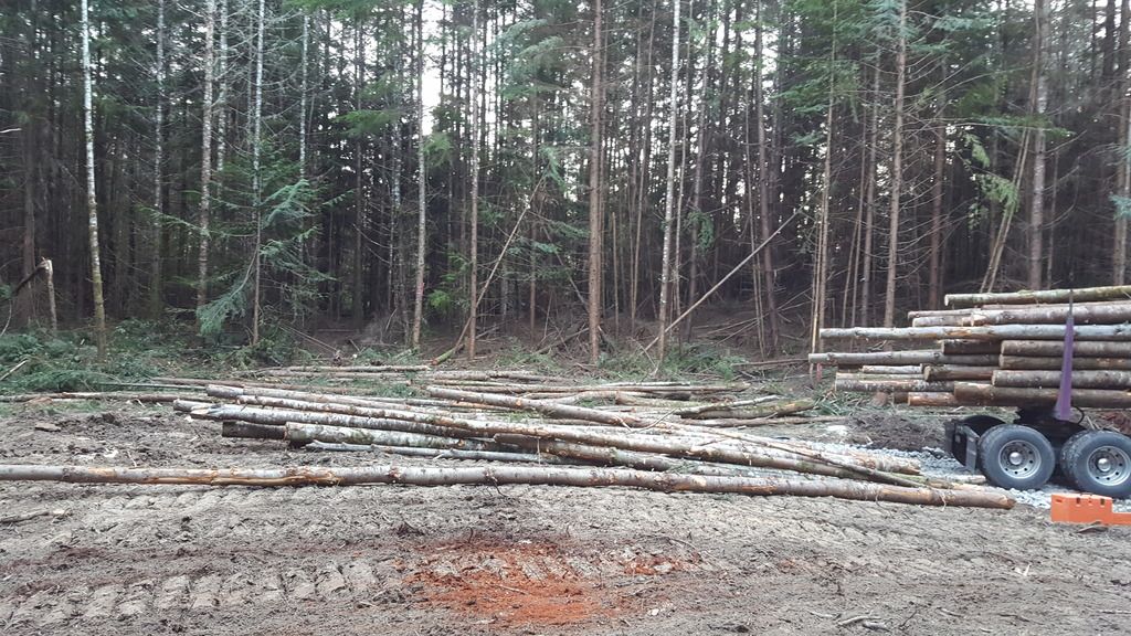

Leftovers after first load, this is going to be chipping n saw wood
Second load of timber chip n saw

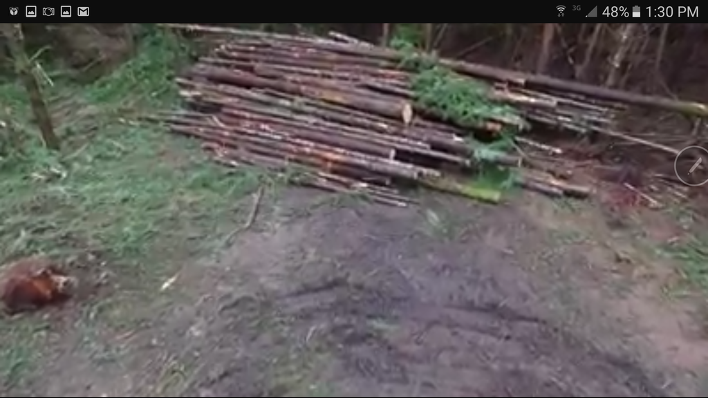

Left over stick I had to move by hand. What a fucking bitch to do.
Guy's out doing the cut. Got it all done on December 22nd.

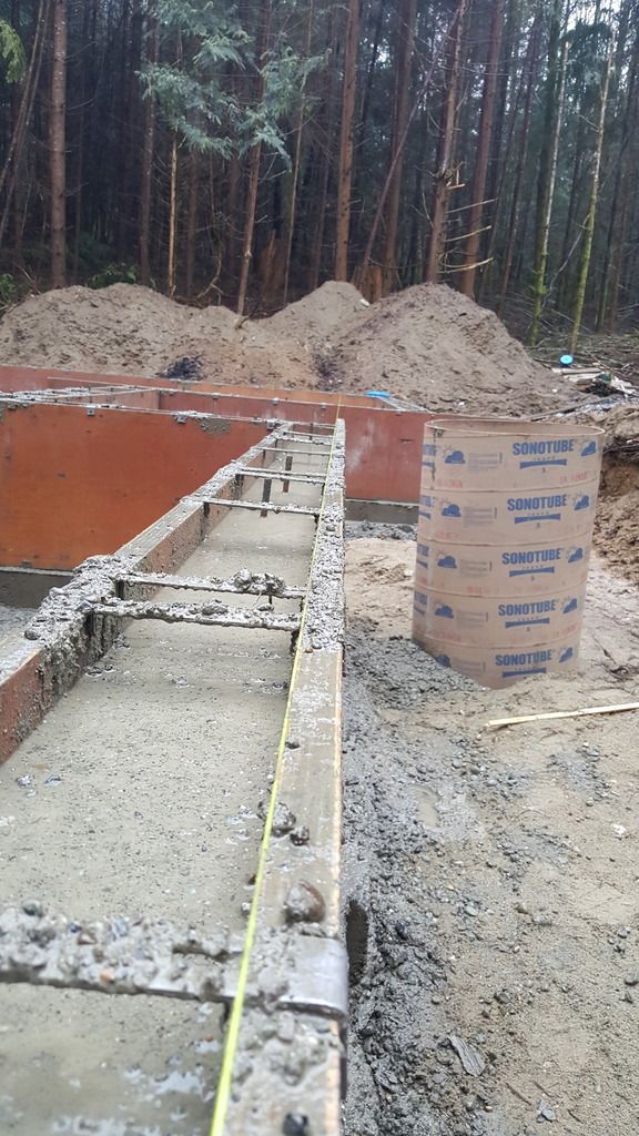

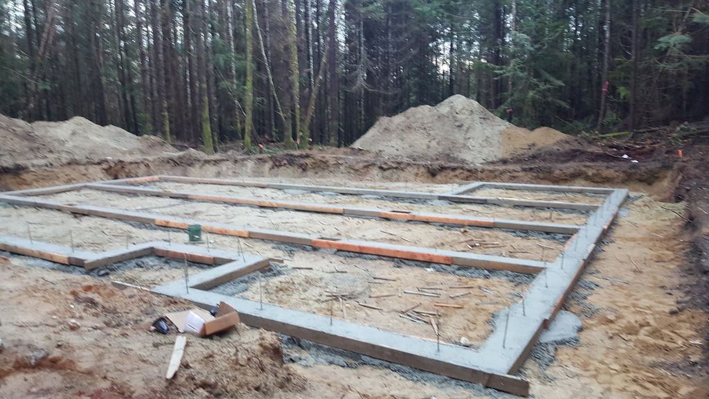

Well they poured the footings today. Stripping the forms tomorrow and hopefully start setting up stem wall forms next week.

Sooooooo, inspection of stem walls on Wednesday Feb 1st. If all goes well they are set to pour the rest of the foundation on friday and strip forms sat morning. I'm going to go out there on Saturday afternoon around 1 and hopefully start doing downspout drainage and cleanouts. Then on monday I'm going to finish up what I didn't get done on Saturday and then do footing drains and I hope to have everything done by Monday afternoon. Gonna be a pretty good push for that to happen. Might also get up early on Sunday and go out for a couple of hours in the morning and do work.

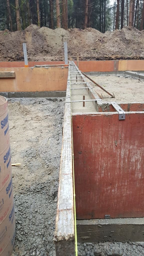

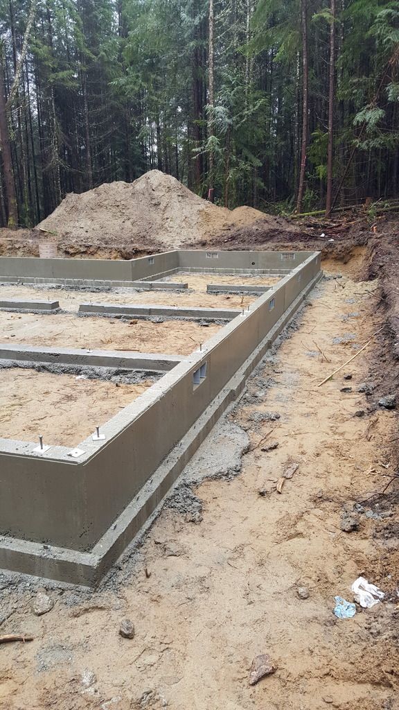

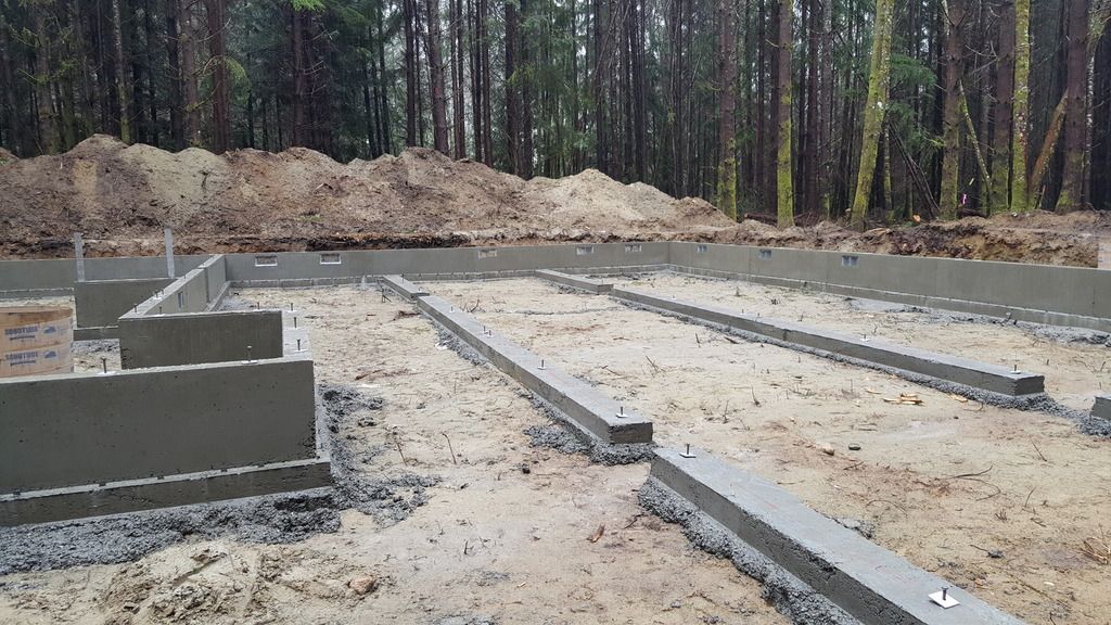

They came, they poured and they stripped!! Poured on friday Feb 3rd and stripped on Saturday and we're gone by noon.
Now I'm doing a little drainage work. All of the gutter downspout drains enter into 4" solid wall pvc pipe and go to a sump basin and then get pumped to a infiltration pit. I got most of the pvc done Saturday afternoon.
After i finish up the rest if the pvc, i have to do footing drains around the footing of the foundation. I have 4"×100' rolls of ADS perforated drain pipe to put down, then i put down drain rock over the top of it and cover it with silt barrier.
Im going to take today off and head back out on Monday. They are calling for 3-6" of snow today which is going to fuck me for tomrrows drain work. I'm suppose to have 10 yards of 1.5" drain rock delivered Monday. Don't know if the dump truck will be able to make it in the snow.
Anyways on to the pics.

thats awesome  O0  im sure every step is cool, but concrete. shit is solid and getting real.
