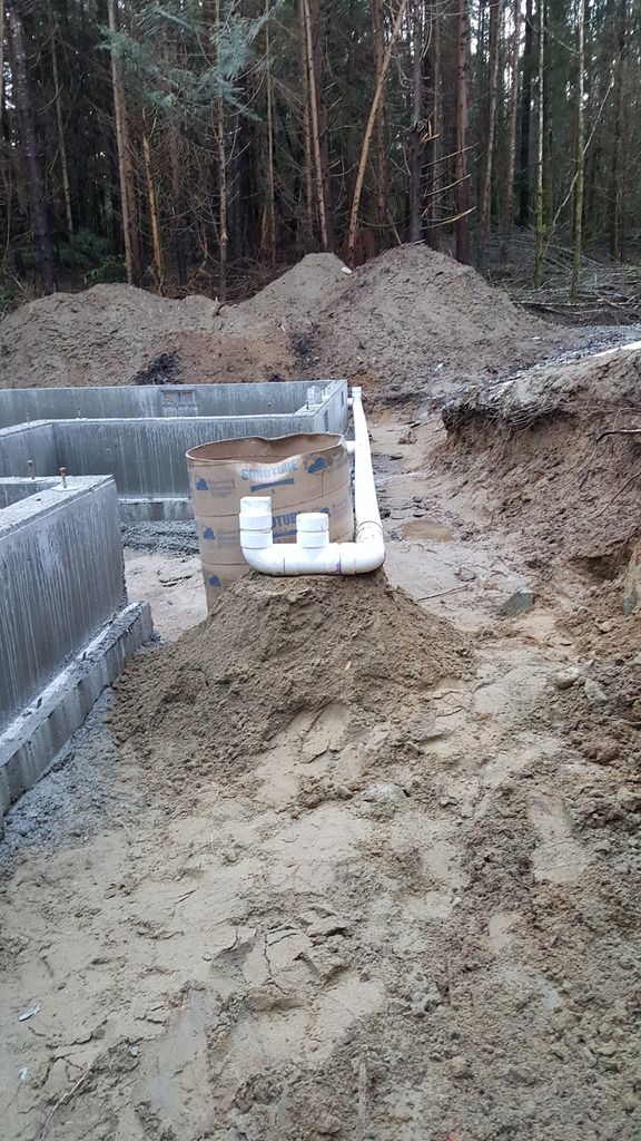

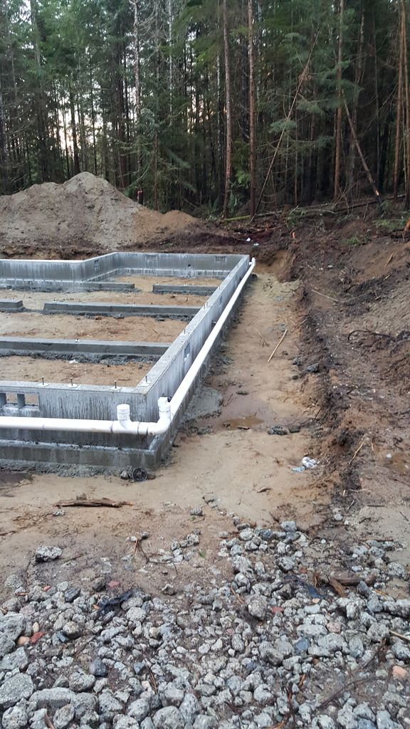

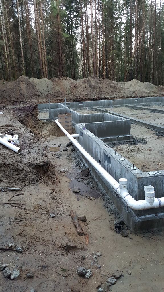

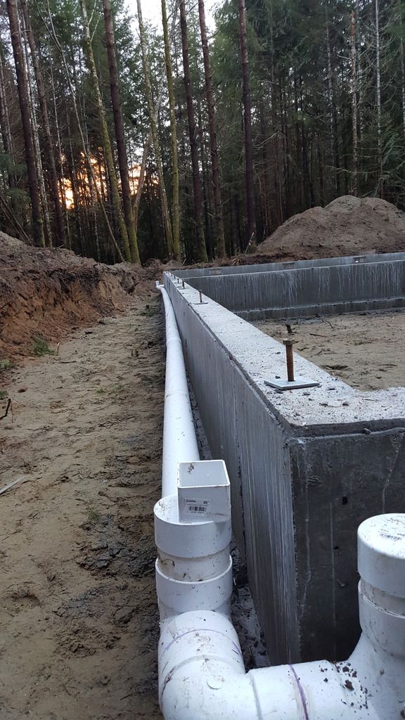

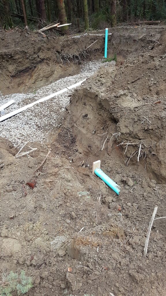

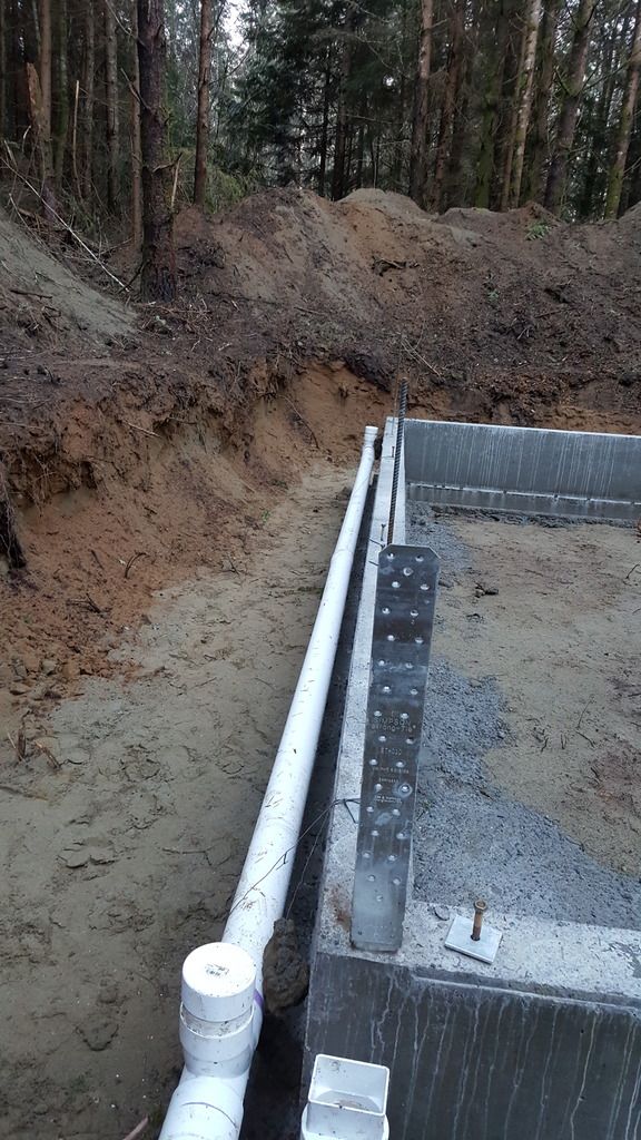

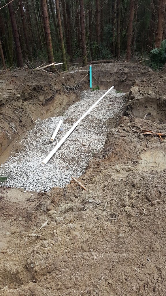

Okay, so I lay pipe like a pro!! Finished all my infiltration pit piping. Got 10 yards of 1.5" drain rock delivered today. Called for inspection from the county. They will be out Monday the 13th to check it all out. I'm going to head out after work for a few hours and lay down my footing drain pipe and gravel.
Here's some pics from today.

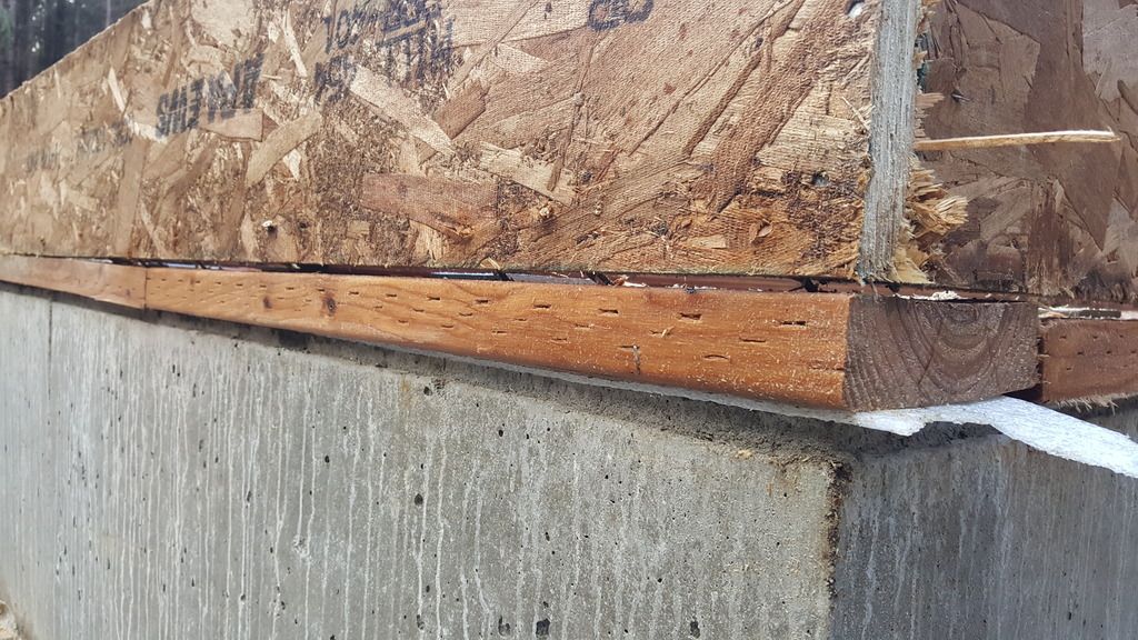

They do do basements in Washington State. It's just that this house is almost 2300 square foot, and if I did a basement I would be over 5000 square feet. And my property taxes are already going to be $5,000 a year as is. So if I doubled my square footage, my property taxes probably be somewhere around the $7,000 mark. That being said, not very many slabs are poured up here and then built on top of. I don't know if it's because of earthquake code, or because it would be cold year-round because a ground temperature never gets above 55 degrees.
And yes, we will bolt a pressure treated 2 by 6 down on top of the concrete, and then we will set are 10 inch BCI floor joist on it

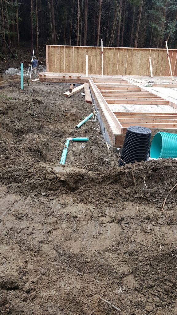

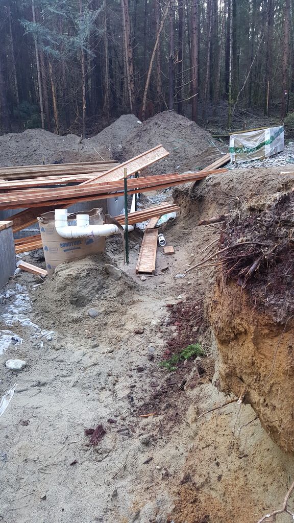

Okay lots happening.....
After my last update we have had a bunch of fucked up shit go down.

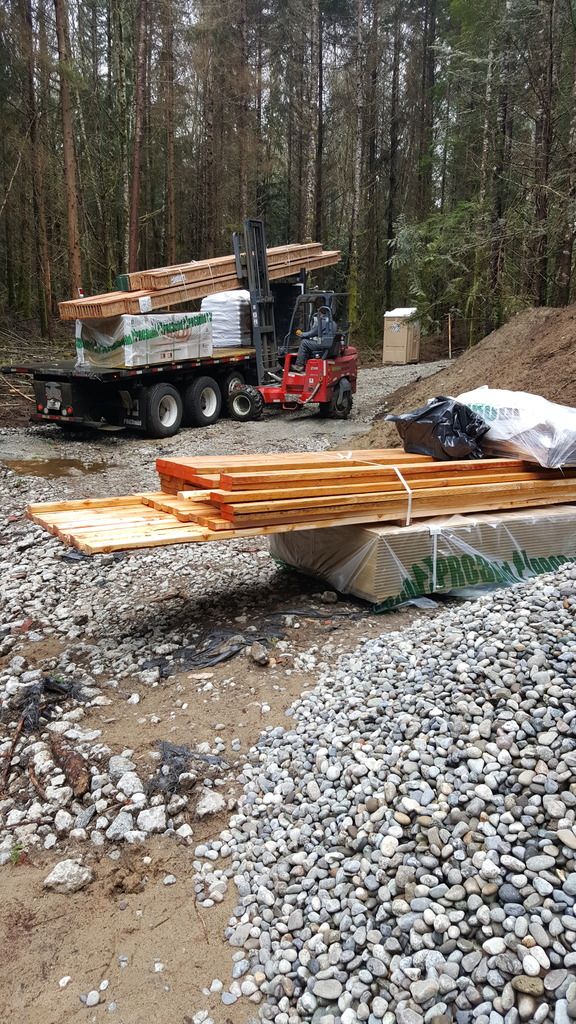

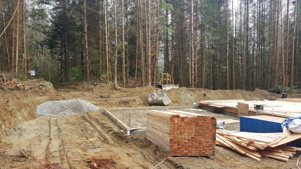

On the 2/10/17 I went out to the site to do a little drainage work and this was happining.....
Lumber! I was pretty pumped for it, but I didn't know why we were getting it. Our site foreman said once we back filled our dirt, we would then get our lumber delivered. Can't backfill until our drainage gets signed off on. Talked to the foreman of Friday the 10 and asked him what was going on? He said framers were going to start building the floor and have it done by the 14th. So once we passed inspection we could backfill because framing would be done and lumber wouldn't be in the way of the dirt guys.
I though okay, we will just be a week ahead of schedule. Well, sat the 11th comes, no framer. I took sunday off. Go out to the site on Monday to finish pipe work. Foreman shows up to check progress around 930 am. Still no framer. Foreman says he will call him and see where he is. Inspection happens and we pass. I call dirt guy up. He tells me that he can be out there by the end of the week. Call foreman and let him know dirt guy will be out there to backfill by Thursday. He said it won't be a problem because the framer is on his way out and should be done with floor framing on Tuesday night so the lumber won't be in the way.

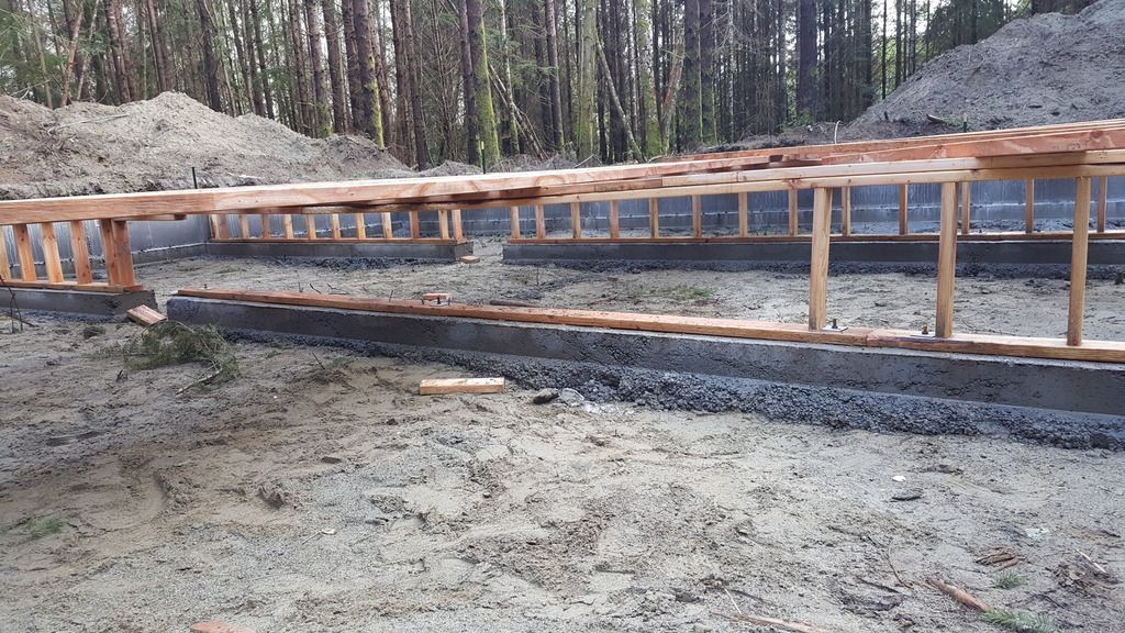

Monday afternoon framer shows up. Opens the lumber stack and moves about 10 boards and then goes and smokes cigarettes in his truck for an hour. I finish my drain shit and ask framer when he will be done. He says he will have it all banged out by Tuesday.
Tuesday the 14th, show up to the site around 515, music playing, tools everywhere, and no framer in sight. Hung out there until close to 545 and he wasn't coming back. Hardly any works was done. Only about 80% of the mud sill was complete. On top of that it looked as if he hadn't set the boards up right and a few of them didn't have the correct amount of bolts holding the mud sill down. Though okay, maybe he will show up Wednesday and finish.

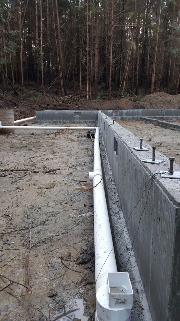

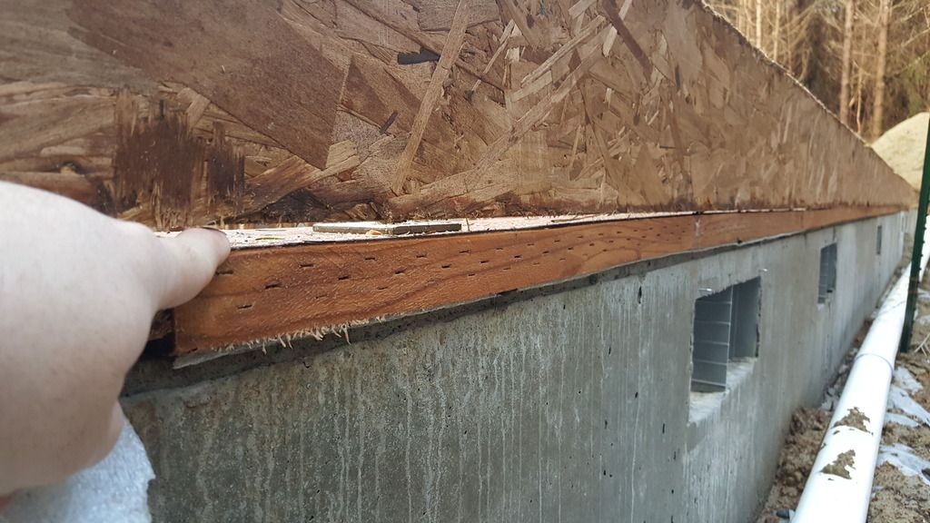

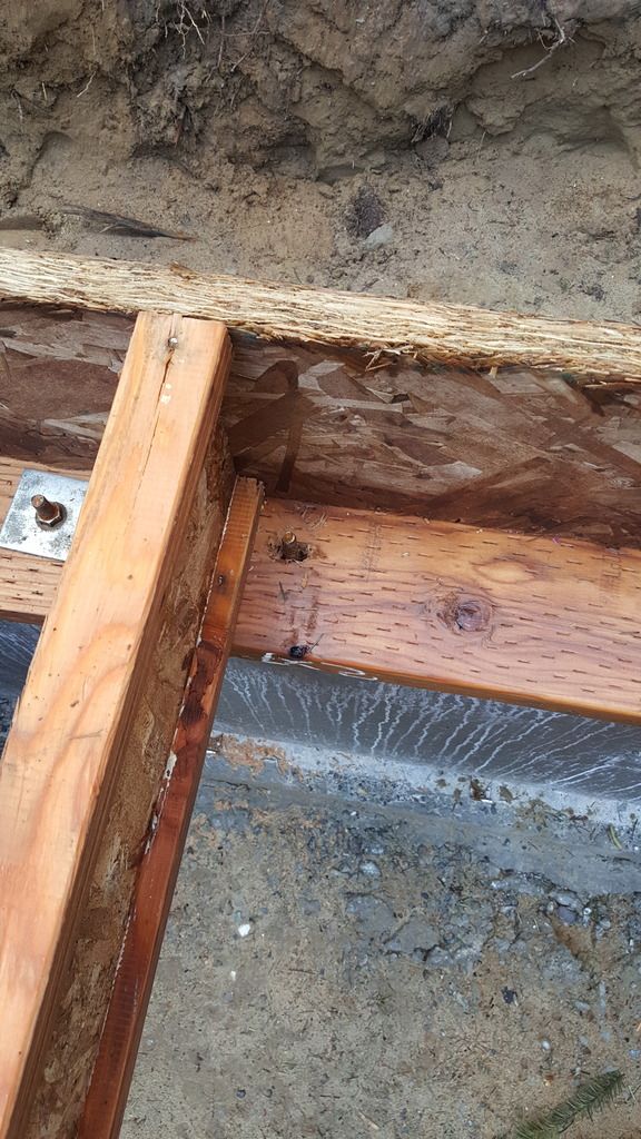

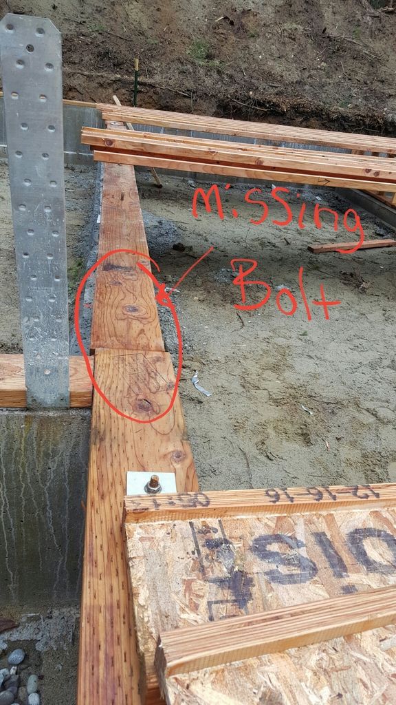

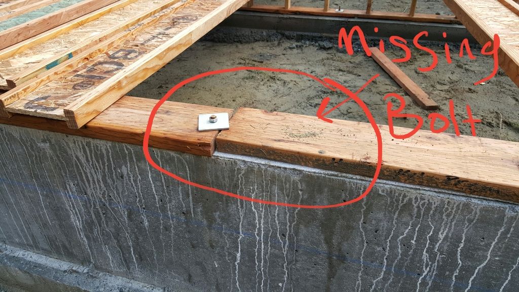

Thursday the 16th, I pull onto my road and pass the framer leaving as I'm pulling in. He has his trailer with him so I'm assuming he's all done and taking good his job trailer with him. I get to the site and see this shit.....
Crushed my drainage pipe
Missing studs on my pony/cripple wall
Missing bolts
So now I'm fucking pissed!! Call the foreman paul (who I have felt is a fucking retard this whole time) left him a voice mail. Called the local office and left a message there too. I'm steaming pissed and I'm getting ready to leave when I get a phone call from Paul's cell. Turns out its not Paul on the other end. Paul walked in dropped his keys off and quit. So now they have a temporary foreman from another project to fill in while the new foreman is getting trained. Dirt guy shows up to check to see progress b4 he brings in all his equipment. Calls off back filling until next week when no lumber is in the way.
Friday the 17th, I speak with new foreman. He tells me that the framers will be done with the framing by Saturday. I asked him who I send the bill for the broken pipe to. Because I'm charging the fuck out of these guys for sheer neglected. I mean who stacks 6 fucking floor joice's on pipe that suspended in the air. He says to hand it to the framer and email him a copy. He then tells me the dirt guys will have all of next week to get everything done. Because the framers will be done and all the lumber will be out of the way.
I call dirt guy and let him know he has all next week to dirt work. He says ok, and to call him Monday and let him know for sure if the lumber is moved. I go out to the site on friday. Framer is there with his flunky employee. He tells me he will have everything framed and all lumber moved by sat afternoon.

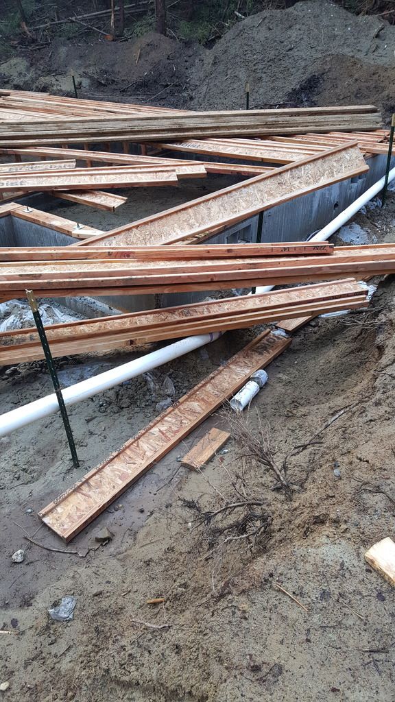

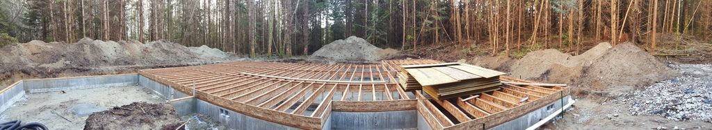

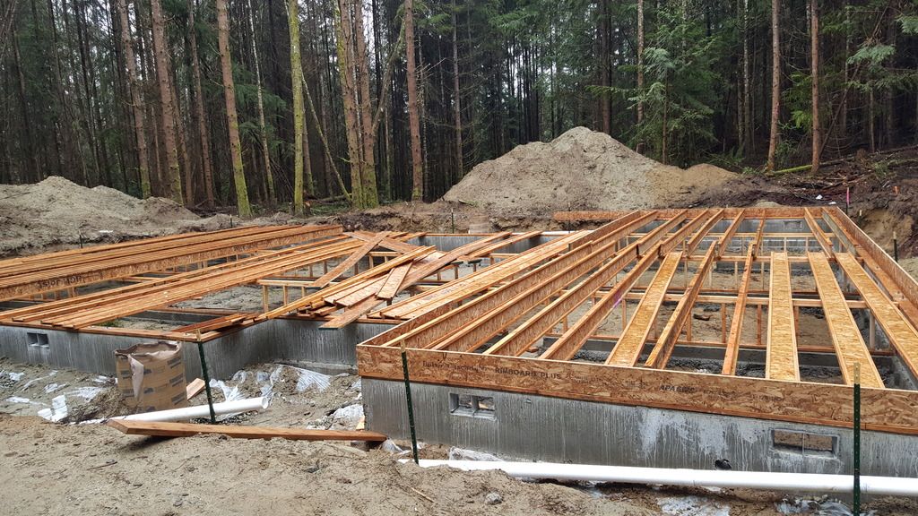

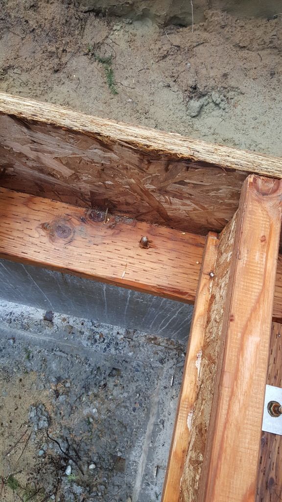

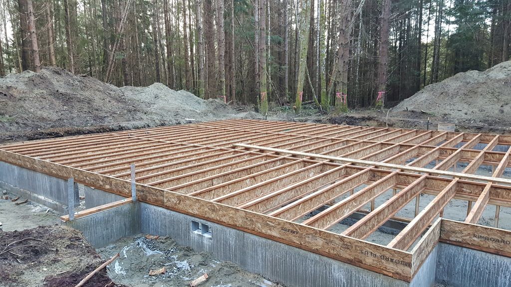

Sat the 18th, I show up and I'm in a full fucking rage. Nothing is done since Friday when I was there. I'm so pissed I'm ready to call my lender and tell them to put a stop to everything. Just as I'm getting ready to leave I get a email from our new foreman asking me how things are going. Told him I'm done with the emails and he needs to fucking call me. 5 min later I get a phone call from dale, our temp foreman. I explained to him that I'm done with it all. He sucks up and tells me he will take care of everything and whip them all into shape. He apologized and told me how this isn't the normal for there company. So, on monday the 20th, I'm going out in the afternoon. If shit ain't down. I'm going to padlock my property and they can all get fucked. I'll hire someone else.
Here is how it looked when I left.
There is maybe 6-8 floor joice's that are actually nailed. But not completely, just one one end.

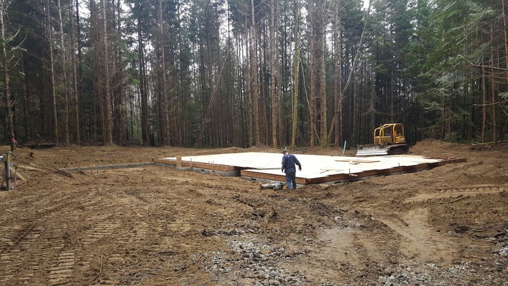

Well the fucking lightning bolt from God came down and smashed the framer in the head!! He fixed everything except he missed putting the nuts on 3 bolts that hold the mud sill down. He fucked up on like 3 floor joices and set them low and the rim sill on one corner is kinda fucked up.
New temp foreman said he would address those items with the framer and make sure he fixes them even though the county inspector signed off on the framing already.
Onto the pics

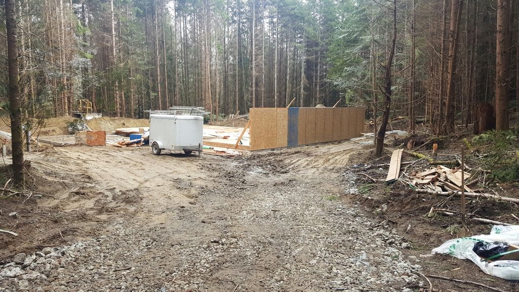

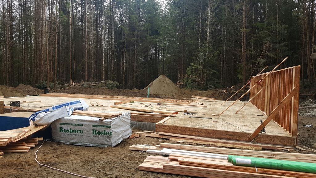

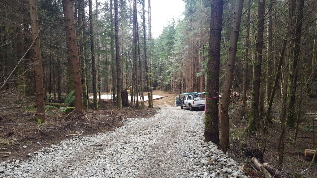

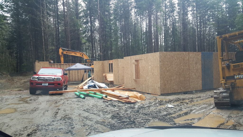

So I stopped by on Saturday 2/25/17 to see where we were at. Pretty fucking cool to see most of the dirt moved around. They were back filling the foundation and it looked like the framer laid down most of the plywood sheeting on friday/saturday morning. He kinda fucked the dirt guys by not cutting the plywood off and just ran it long past the rim joist. So because of that, they couldn't compact all the dirt down tight right next to the foundation. Also saw that our inspection sheet was back and that the inspector had written down some notes on the back saying that the framer needed to fix the missing bolts and take pictures and send them to the county b4 completing the sheeting. Anyways, onto the pics and videos..

Stopped out on Tuesday the 28th. Framer had top and bottom plates for exterior walls framed setup. All floor sheeting for the most part was done. Guy still moves slow as balls.
Went out today 3-2-17, dirt guys are finishing up the septic, infiltration pit, and grading and tree removal.
Dirt guys said framer wasn't there on Wednesday at all, and then only worked about 3 hours on thursday and bounced. I showed up a little after 2 and in 2 fucking days the framer managed to frame 1 exterior wall. And it wasn't even the big wall. Dude is such a dough bag.
Anyways, crawled under the house to check 1 wall that didn't have all the bolts on the mud sill down. Still missing bolts in that mud sill, so I guess he will be under the house running a rotor hammer. Just don't understand why he thinks I'm not going to check this shit? Anyways, onto the pics.

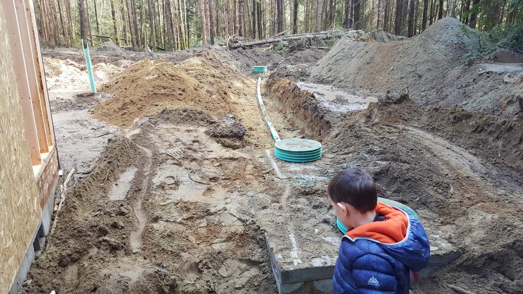

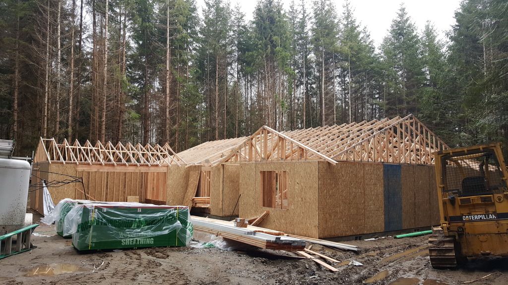

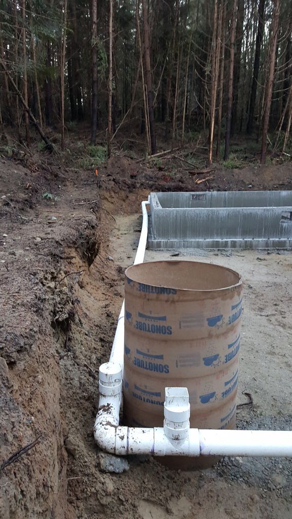

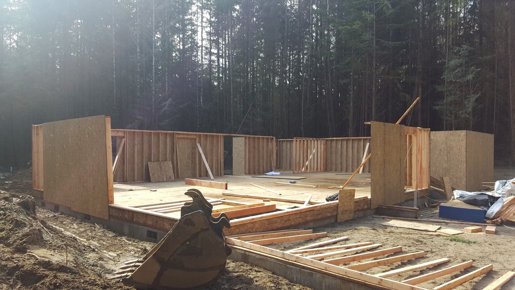

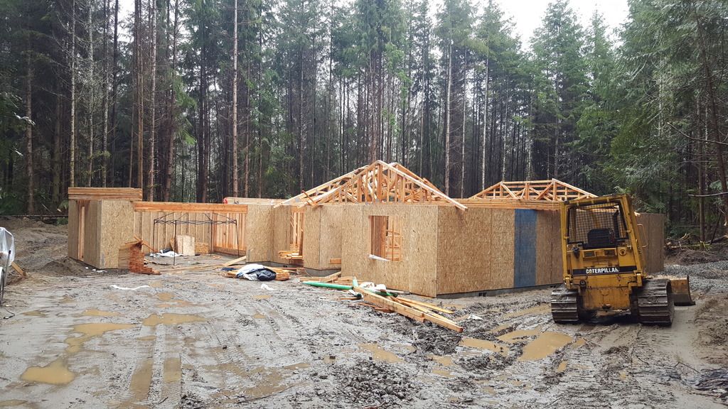

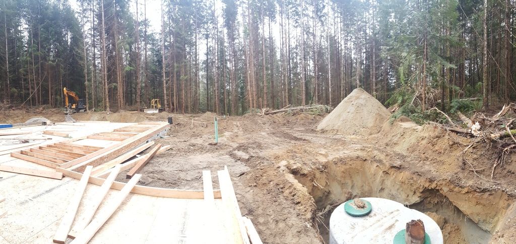

Well, got a call on friday the 3rd from our septic guy. Told me they installed a 1000gal tank and not the larger 1500gal tank I wanted. Said he could refund me the $500 differance in cost or pull it and install the 1500 tank on monday. We plan on adding a shop with a 1 bedroom apartment eventually and I don't want to have to do this shit 2 times, that's why I wanted the larger tank to begin with. So they pulled it out and had to wait for the new one to come in.
Came in on monday, installed and hooked everything up. Inspection was Tuesday March 7th for it and the infiltration pit. We passed everything and they are planning on backfill everything and smoothing it all out today.
We get our roofing trusses delivered tomorrow and those should hopefully be done and stood up by next weekend. And then he can sheet them. Once the roofing sheeting is done the framer is out and I can go in and screw everything down. I got 2 buckets of 2.5" screws last week and plan on knocking all that shit out after the framer is done.
New larger septic 3/6/17
Framing as of Monday morning 3/6/17
And as of Tuesday afternoon 3/7/17

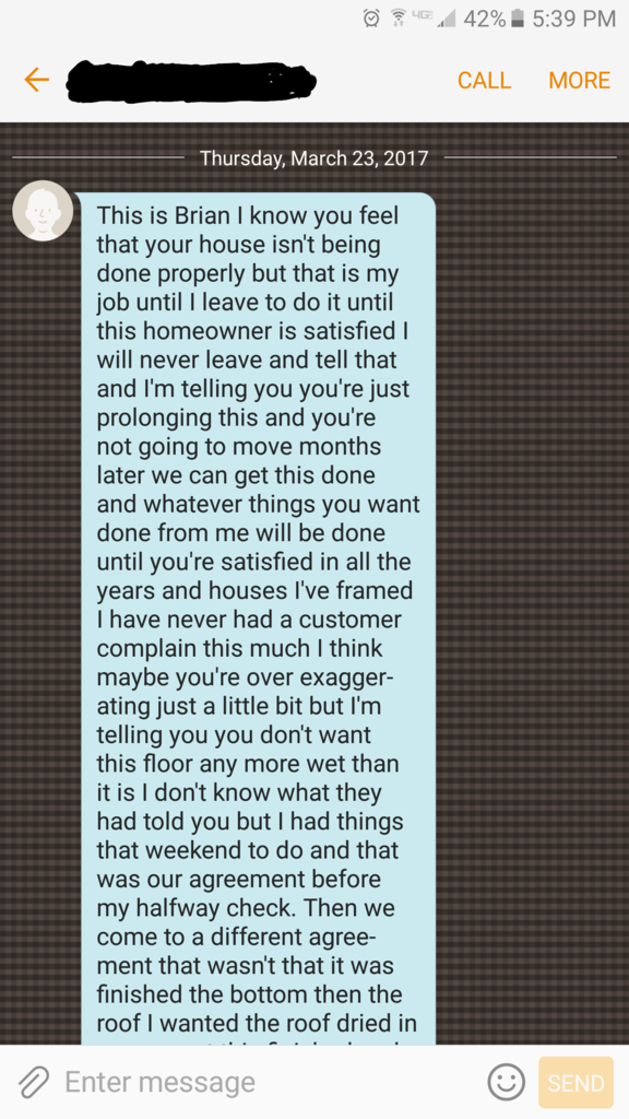

So I went out to the house yesterday Thursday 3/23. I get there and Brian the fuckup AKA snowflakes trailer is still there. I call the general manager of the company and ask him wtf is up. He didn't know it was still there. He said he would call the snowflake 1 more time and if it wasn't removed within 1 hour he was going to have it towed. 2 hours later I get a call from snowflake asking why I didn't like his work....lol needless to say he was pretty much begging for me to let him back on the job because now that he has been fired he's not going to get payed. So now he's trying to play kiss ass. I tell him his work is shitty and he's a fuckup and that when he decided to get combative with Shannon, in my eyes he's way over due to get fired. He then got all defensive and and tried to tell me that the floor in my house is gonna be fucked because it's getting rained on and he only has 2 more day of work b4 it's dried in and it's going good to take months to get a crew out there to finish it off and Yada Yada yada. I tell him again it's over and I'm done with it. I hang up and get a giant text from this guy. I'm not looking thinking to myself I'm gonna loose my shit if dude tryst to fuck with me.
Anyways here's the screens shots of his dumb ass uneducated messages.

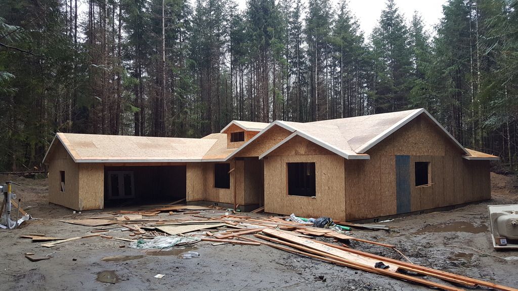

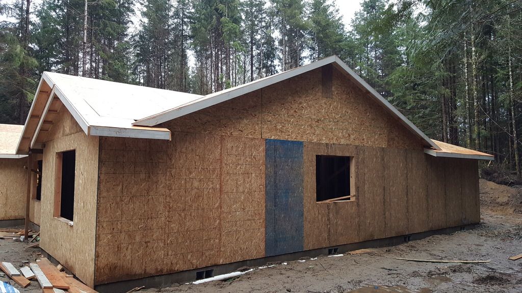

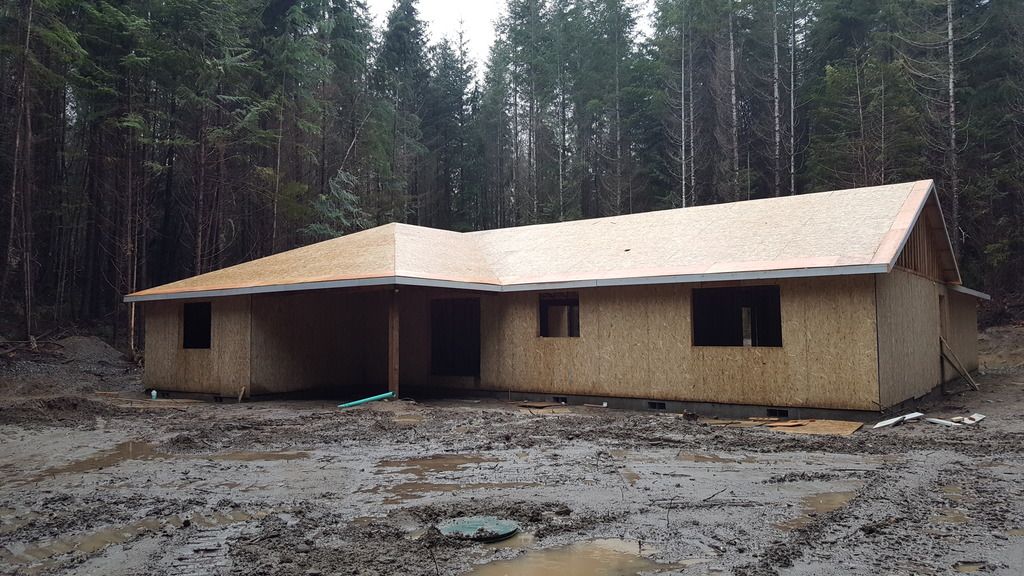

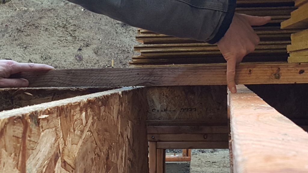

New framers showed up on thursday morning march 30th. Took a look around and got to see what a shit show it really was and had to go set some trusses on another job. There was 3 of them on friday the 31st. They did more work in 8 hours then the other snowflake framer did in 8 days.
1. Thwy pulled some if the external sheeting iff and plumbed the walls and made them square.
2. Thw braced all the walls off.
3. They then resheeted the external walls.
4. They mived all the interior walls to there proper location and finished building the clisets that were not yet built.
5. They tore most all the sheets off the roof and moved the trusses.
6. They then braced the trusses properly and respected them.
And all that happened on friday. They then set the rest of the trusses over the next few days and finished most the other stuff off. They should be done with everything today besides fixing the pony wall studs (adding more in the correct places), and adding 1 more mud sill bolts that was missed. Here is a picture of its current state.
Front of house
Side of house
Rear of house with 16x12 covered area that I'm going to build a deck on.

The roofers are going to love you compared to most new construction.

yeah it does look like a simple one, compared to most.
speaking or roofers... place im renting (duplex) needed a roof. landlord contracted that shit out. 3 dudes showed up, busted out stripping the WHOLE THING, laying new plywood (or fixing some, i seen sheets gone), papered it. in ONE DAY. was like, shit. next day they they hammered out all the shingles....DONE. 2 days. duplex 2 miles away on the way home was going on a week or so lol.... you should hit those guys up  :mexi: :mexi: :mexi:
my place has one central peak, with total of two small ones (done over each unit). so damn simple.
