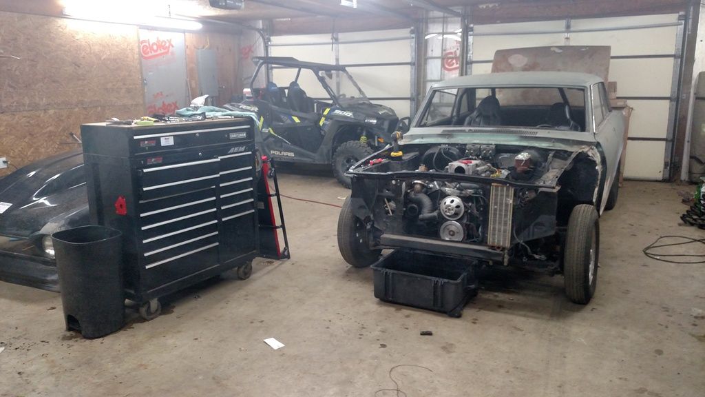

Whats up fuckers. Been awhile. Got a new project and figured i'd make a thread to keep me motivated.
Some of you probably remember this car. I helped a buddy build a couple years back. Forged 358, scratch build manifold, TH400 with 3500 stall/trans brake, etc
Well......he wasn't doing anything with it so I got a pretty good deal on it. It sat outside covered for 4 years now so i'm gonna tear it all back down and build it the way I want.

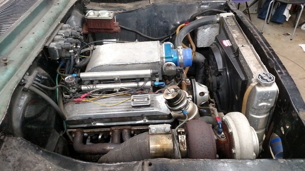

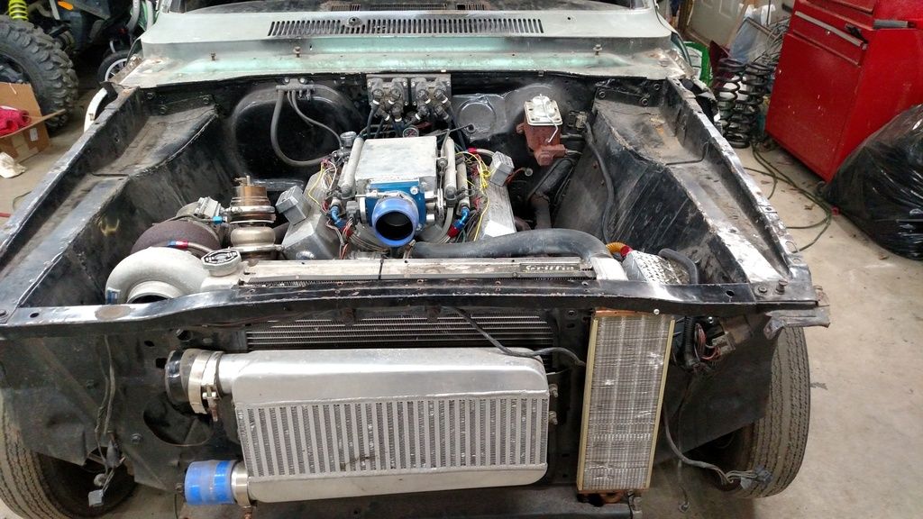

Immediately brought it home and started tuning. When I left off, it was pretty much just running so I wanted to make sure the engine was still good.
I got it running better but something still wasn't right with it. Sometimes it would rev clean, other times it would pop and snarl at me and it was just rough in general. I was pretty confident the engine was in good shape so I said fuck it, lets tear it down.

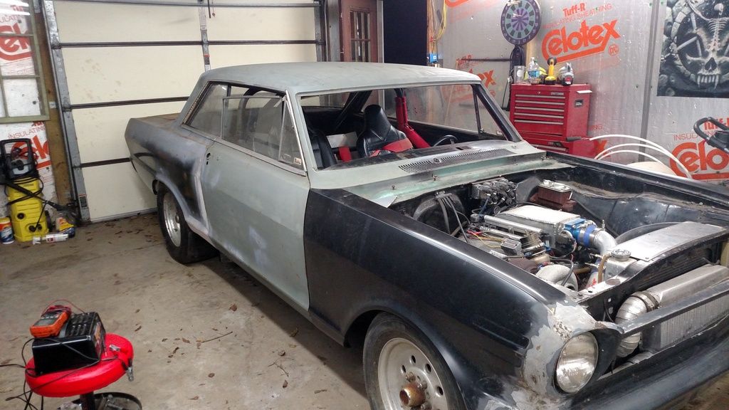

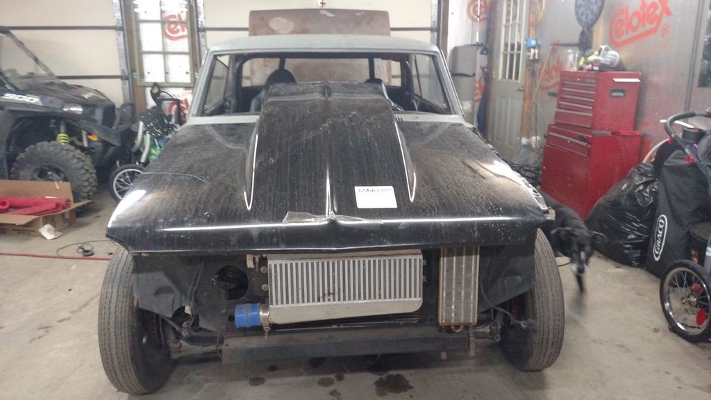

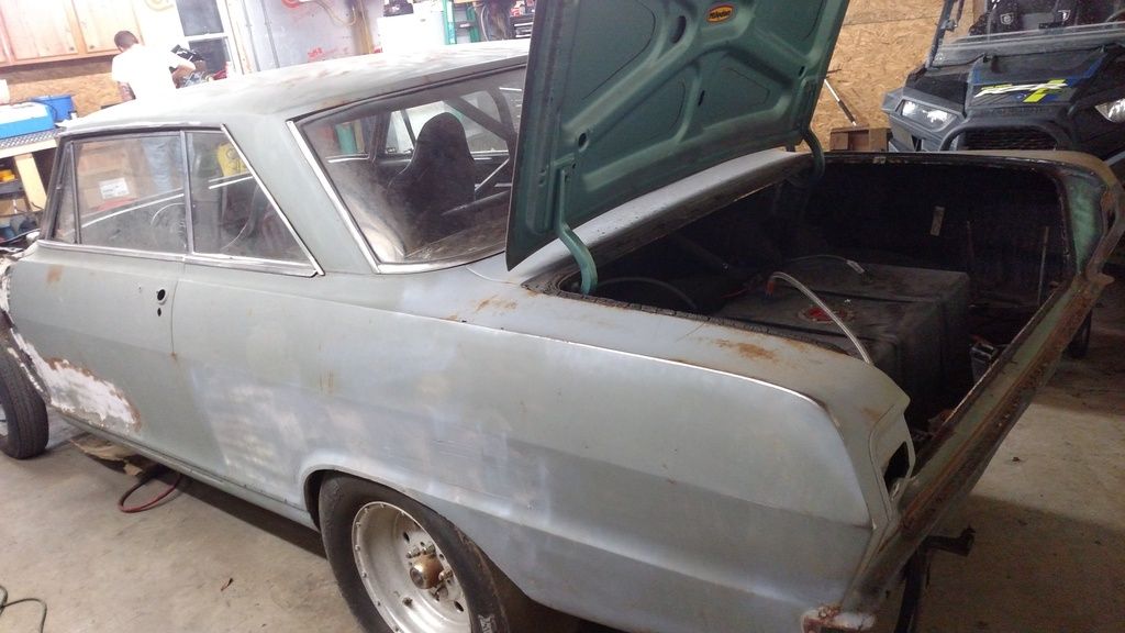

Pulled the front end off. My buddy used steel fenders and a fiberglass nose. I wasn't sure about it at first but I think I'm gonna finish it. Make it a two piece pin on front end.
Dirty and corroded. Definitely didn't look like this the last time I worked on it.
Got the charge pipe off and it was black inside. Smelled like exhaust fumes. Thought.......well that's weird.

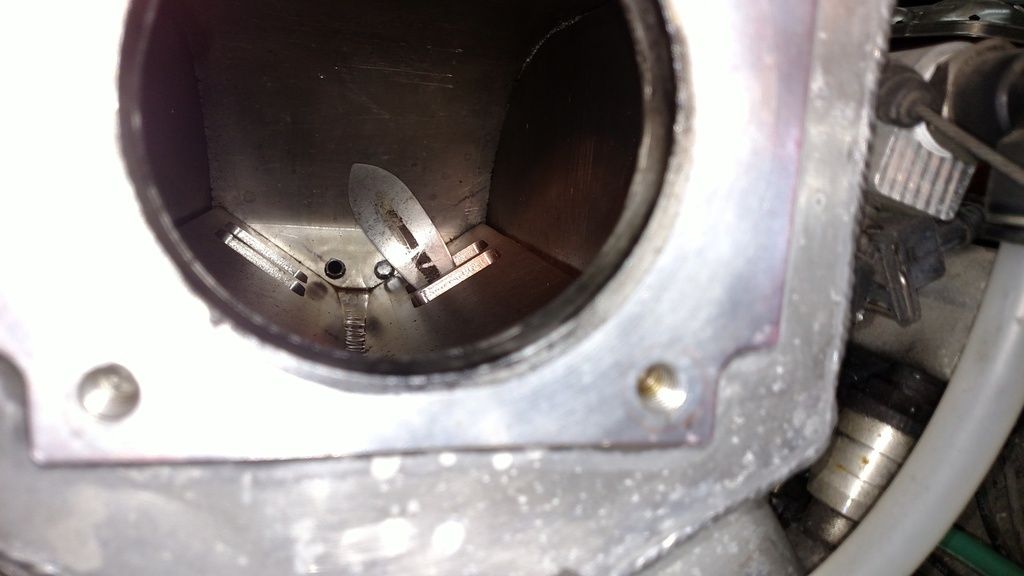

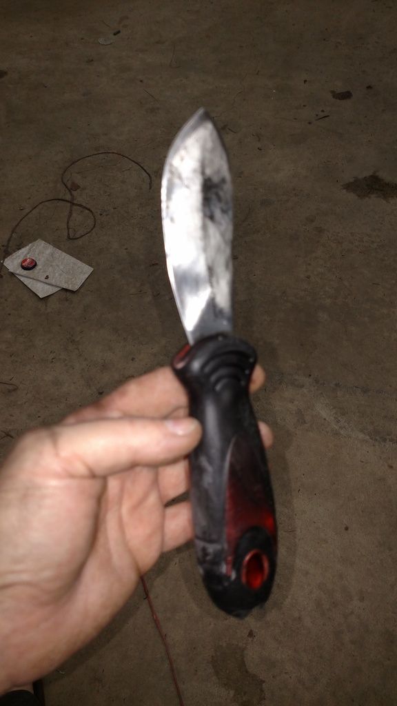

Popped open the throttle body and found this little fella staring at me............
Fucking Blue Point gasket knife down in #7 intake runner. Fucker was jammed in there too. Probably been in there since its first fire. Who knows how it came to be there.
So.....i'm sure that explains why I couldn't get it running right.

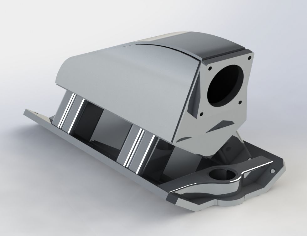

When I did have it running. I noticed that when I revved it pretty good, the top panel of the plenum would flex in and out. Too big of a span for 1/16" material I guess.
So, I'm gonna redo the plenum.
Drew this up tonight.

« Reply #4 on: December 02, 2016, 01:23:01 AM »
thats cool. like a cross between a fabricated manifold and a 4150 elbow to TB setup.
current manifold have 16 injectors?

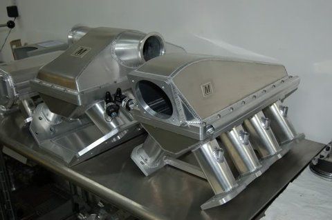

« Reply #5 on: December 02, 2016, 11:35:21 AM »
Ya, similar to the top plenum on this manifold here.

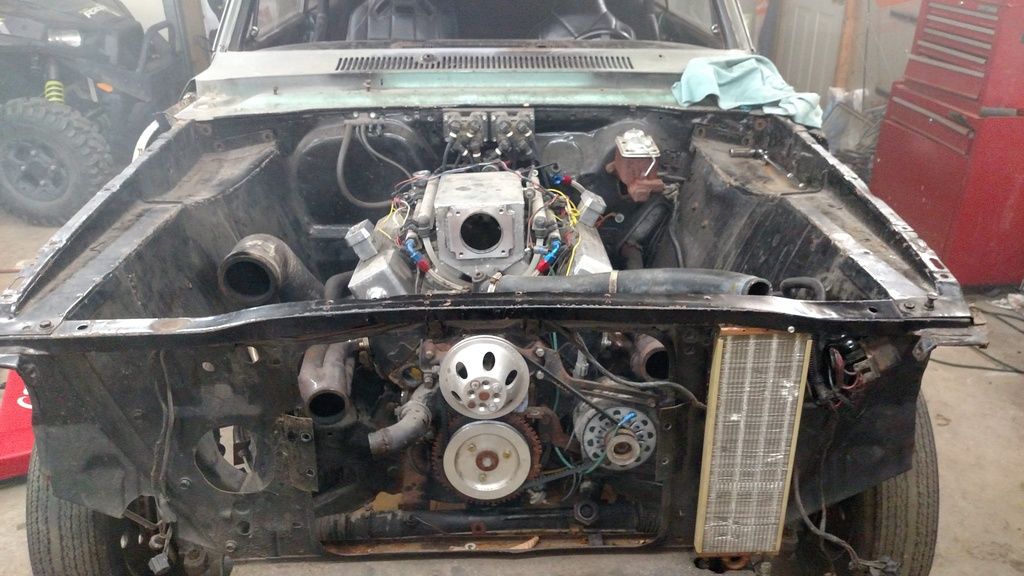

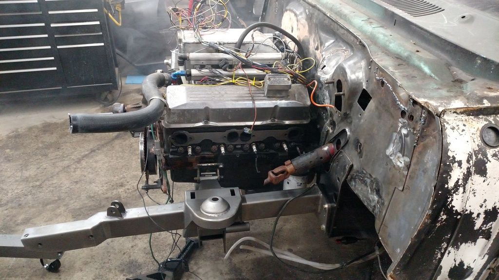

Decided to just pull the front subframe, engine and tranny in one shot. It's ready to come out. Hoist was supposed to be delivered today but FedEx can't drive in the snow.
Re: 65 Nova Build
« Reply #21 on: December 29, 2016, 03:39:12 PM »
Any update?
carkrazed
  • Posts: 3422
Re: 65 Nova Build
« Reply #22 on: January 03, 2017, 08:38:01 PM »
Any update?

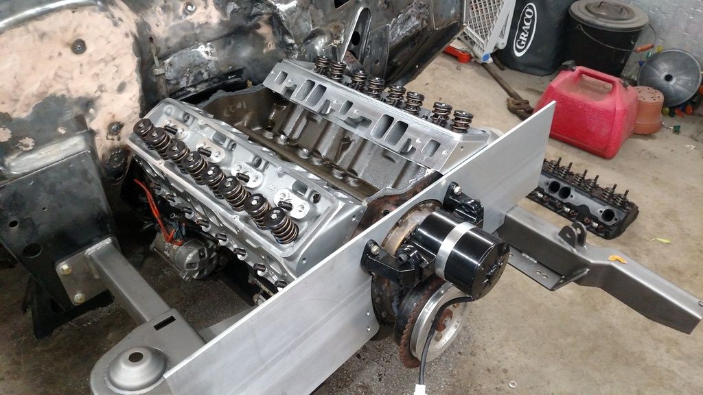

Got the engine/tranny out and the front end off. Been working some crazy hours trying to get a project wrapped up. Its pretty much done so I'm gonna take thursday and friday off. Have myself a car weekend.

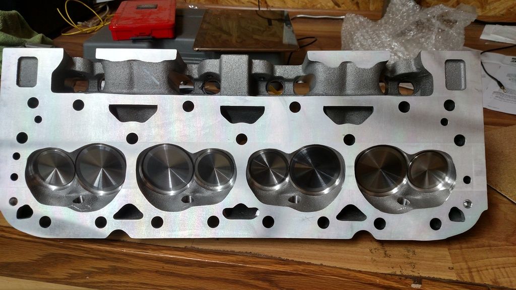

Had to order a set of heads today.
https://www.summitracing.com/parts/drt-127422
Been doing some engine research since chevy v8's have never been my thing. Turns out, the cam that the previous owner bought for this engine shouldn't even be run on the 70's era iron heads that are on it. Everyone says the max is .500" of lift and this cam has .563"
http://www.compcams.com/Company/CC/cam-specs/Details.aspx?csid=235&sb=2
Seen some positive reviews on the DART SHP heads and my dad was able to get em through one of his suppliers for $475 a piece. Should wake this engine up.

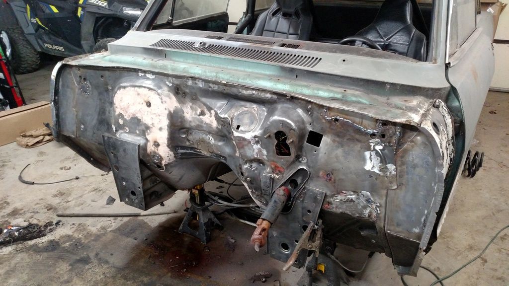

Spent all day getting the firewall cleaned up. Patching holes, etc. It's pretty close so hopefully I'll be starting on the front clip tomorrow.

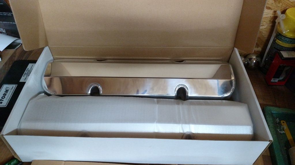

Got some more parts in.

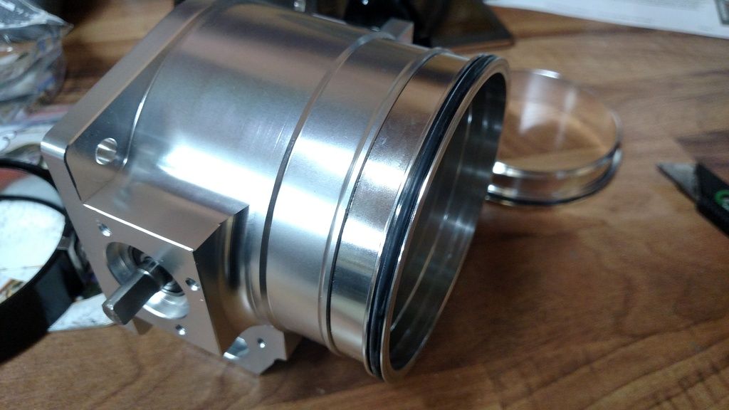

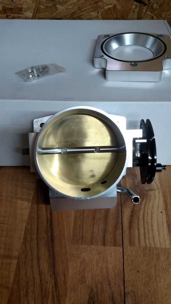

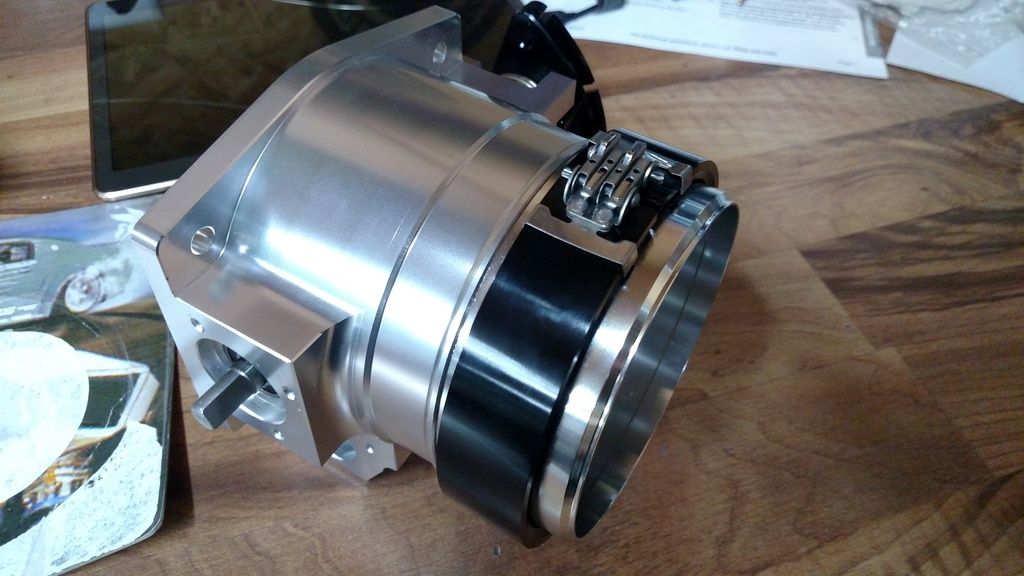

102mm lsx ebay throttle body. It's actually a really nice piece.
New valve covers

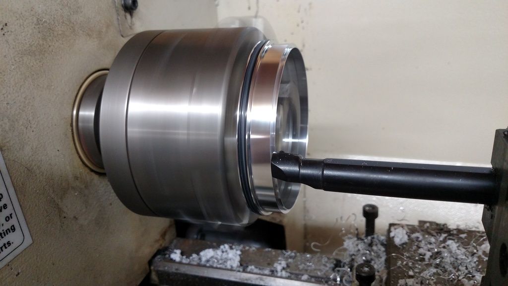

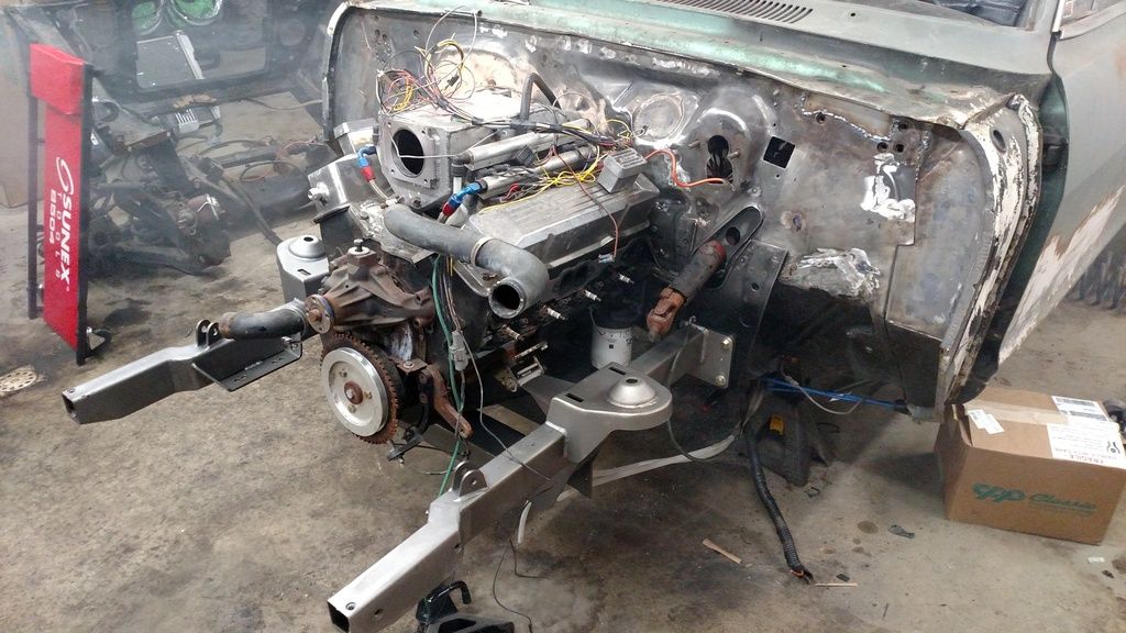

Fitted clamp to new throttle body. Ready to weld

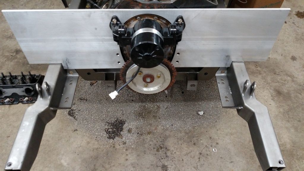

Got the new frame rails put on and engine back in. Spent the day fabbing up a new transmission mount because the pinion angle was way off.
Almost ready to start on the fun stuff...... :noel:

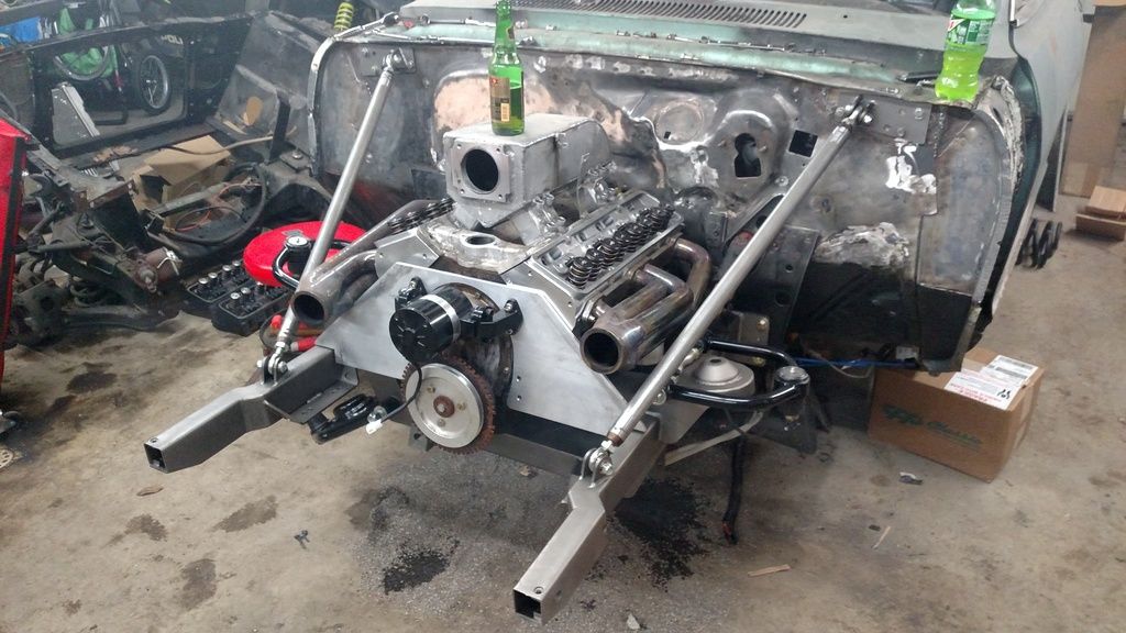

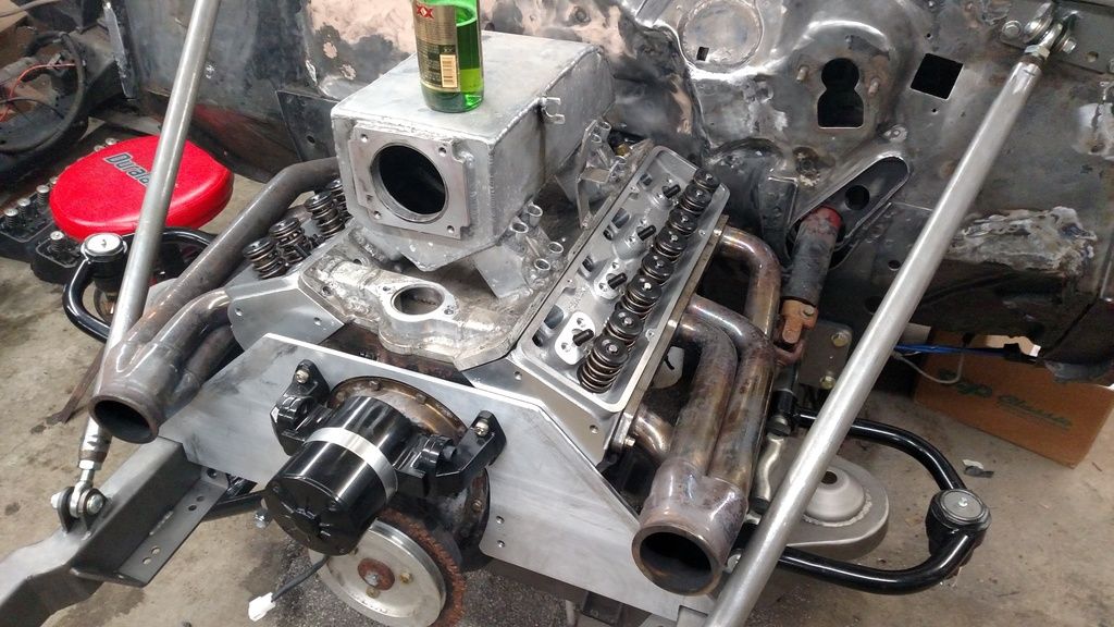

Getting everyhting mocked up. Figured out my crossover pipes aren't going to fit with the new subframe so i'm gonna have to redo those.
Got the new DART heads in. Gonna need port matched but overall, not a bad deal for $475 a piece.
