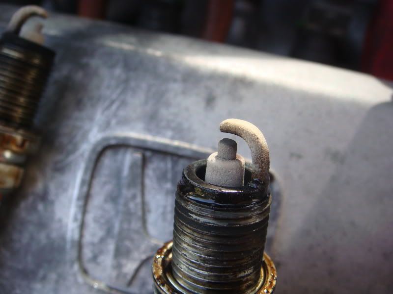

Halfway home (of at 120km drive)  the temptation to resist boost was too great.... seemed to be running fine and all so one WOT pull in 4th gear and I had time to think it felt lazy and look down at the tack.  POP POP at 5500-6000rpm  pulled over and Subaru death rattle ensued.  Felt much like the first time it broke two ring lands.

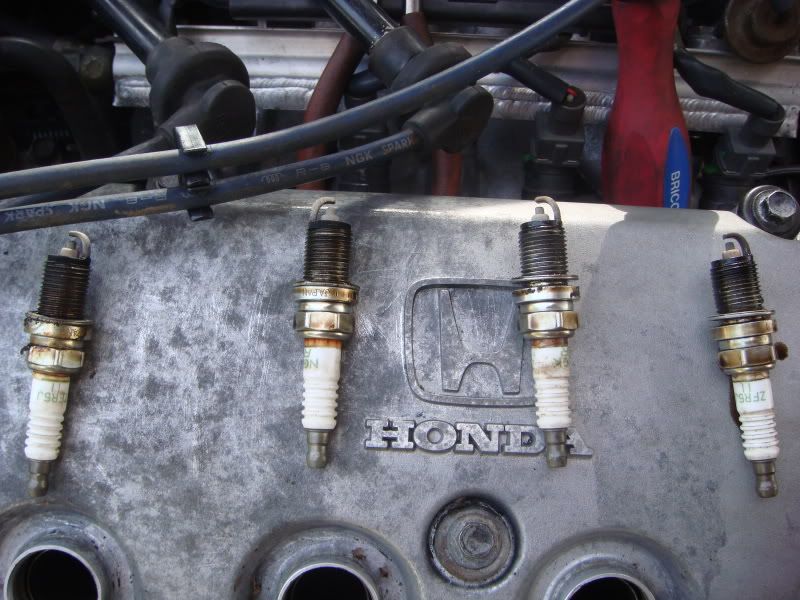

Timing MAY... have been the fuck up here.  I honestly don't recall.  I'm thinking I set the timing at 13* on the digital gun but lined up with the stock 16* timing mark  :'(  I also just wanted to get home so was using USED spark plugs (the same ones it had in it from the first failure :-\).
Tear down ensued....
Overall

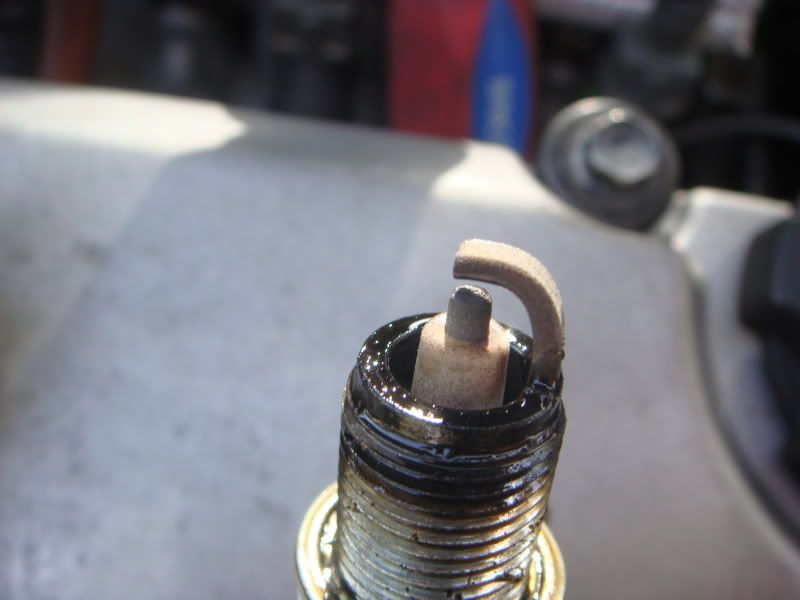

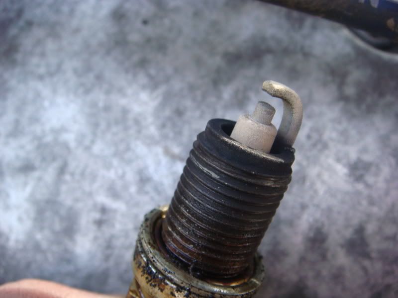

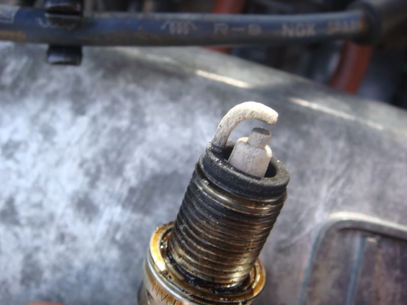

plugs from right to left (1-4), No. 1 plug looked oily and two others seemed to have this concrete looking plaque on them.

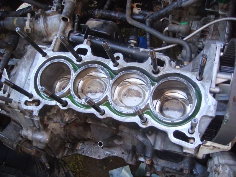

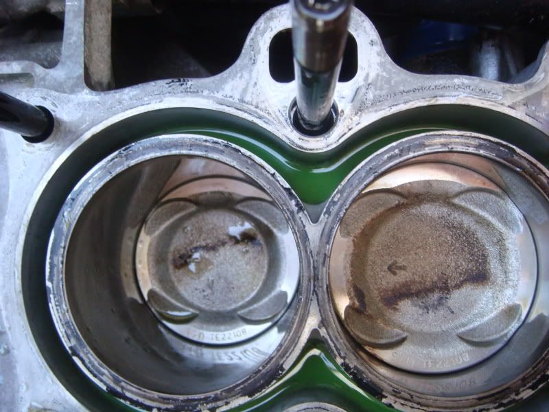

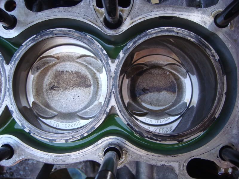

Sleeves appears ok, no signs of burn or leaks on the HG, no milky coolant, no milky oil, both fluids were still full up.  Pistons appear fine from the top, no melted corners, or holes in the tops of pistons... and can feel ring tension in each hole, head looks as installed.

omg the strap on those plugs  :-X :-X :-X :-X :-X :-X :-X

I would pull piston 2 and 3 as the spark plug looks the worse on those.
Re: What went pop?
« Reply #6 on: May 13, 2009, 08:43:24 PM »
plugs in 5 heat range.  you should at least be using ngk 7's

pistons are all out as of last night, no visible damage [pics when i get home], which is good for obvious reasons, but just plain dumb of me for re-using old plugs  :(
next steps i guess are to leak test the head just to make sure it didn't do something stupid like burn an ex valve,... then reassemble with the right heat range plugs...preferably new ones :P

Damn, the walls still have a mirror shine. Those plugs are flaming gay.

ball hone goodness ;) the rings were beginning to seat pretty well.

Pistons 1 and 4 look as if they may have had contact with valves, but it could be camera angle/lighting.
Get yourself some NGK 4554's when you put it back together. Then get it tuned.

Those are ugly plugs.  Peppered FTL.  Do they look a bit oily to anyone else?

Yea the plugs are disgusting, pity i didn't do a comp test before, i will try to do one before i spark it up this time.  My thinking was pure sadness and ''maybe... maybe'' its just minor and i can save the bore because i shut it off quickly.  No valve contact, its just the light. If anything is causing compression issues it'll be a valve seat now.
thanks for the ngk number, what kinda heat and gap are we talking about with those?  I have some stock replacement but with the 7 heat range.  will grab some 4554's too for curiosity's sake.

4554 are an 8 heat range non resistor plug.  They work pretty good for a lot of setups.  You can gap them stock if you like depending on boost level and lower the gap if you have some breakup under boost.  I usually start around .035 myself to be on the safe side.  They may be too cold if you arent running much boost.
Those wires look kinda old too.

Alright here's what I think it is because ive seen it before. the wet plug is fouled and it burn't through the plug wire somewhere and is sparking to the plug tube.
I had I guy ive tuned for call me at a gas station saying his car was blown up. I rolled over to check it out and found what I just explained. Look the plugwires over for burns in the sides.

After all that, it did turn out to be the spark plugs.  That is the only thing i changed after all the inspections. The plug wires aren't great, but i did look and none are burned.  Head leak tested out fine, and it went back on.  I ended up grabbing a clean set of autolite 6 heat range plugs from the hindu auto store since that's all that was available on a sunday afternoon.  it fired right up no problem, and with a few tweeks to the TB, no more hunting idle either.  Set the valves and drove it home.   :noel:
