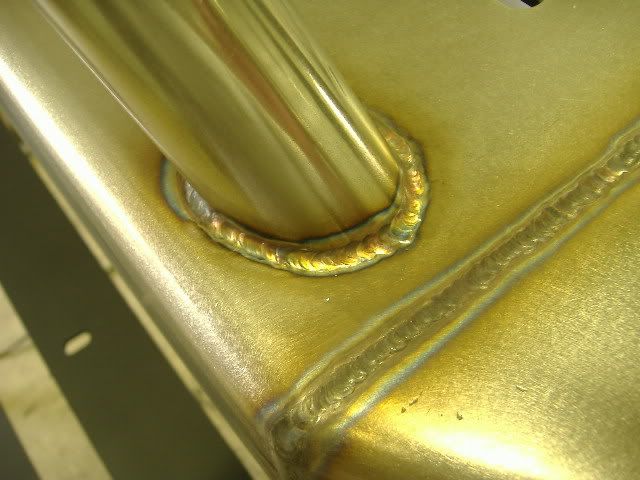

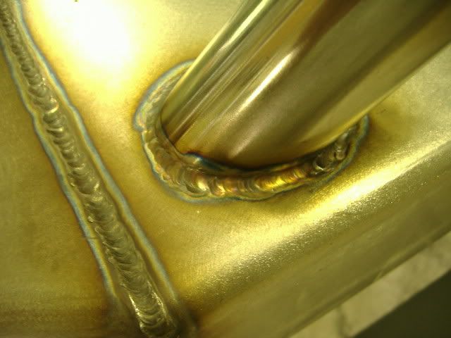

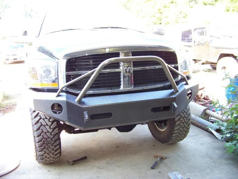

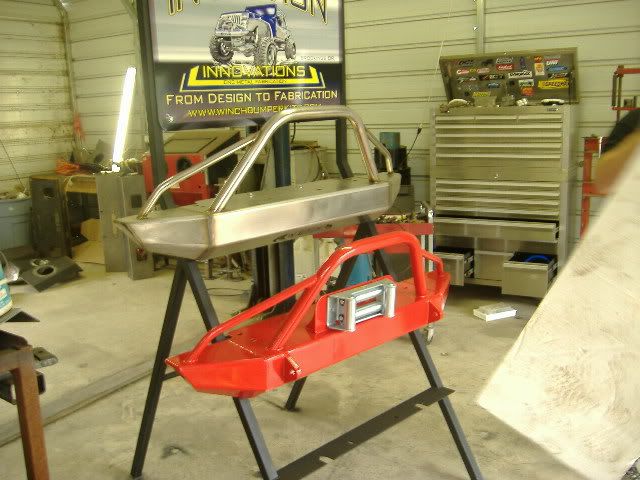

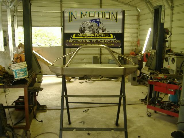

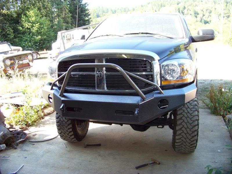

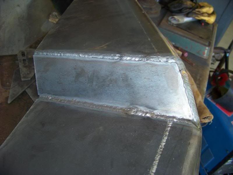

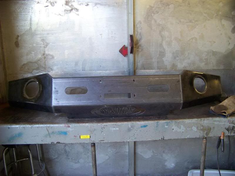

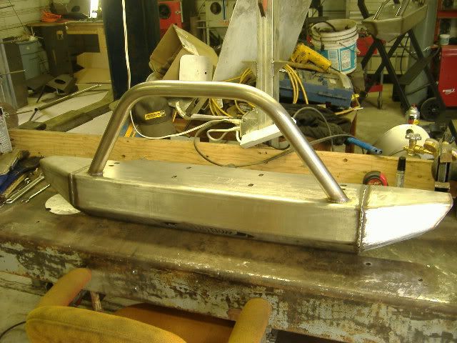

As I've mentioned before I have been out of work for the past 10 months. Not cool. Anyway, we just moved back over to the coast for cheap renting. Somehow my brother-in-law knew of a guy who owns a shop that needed some help and I showed up at just the right time. So as hilarious as it seems to me, I'm a fabricator for a living right now!
I'm working for a fledgling shop that builds off-road style bumpers for trucks and jeeps. It's been really cool so far, hopefully I'll be able to branch out a little and get to work on some new stuff. Designing the bumpers has been the fun part.

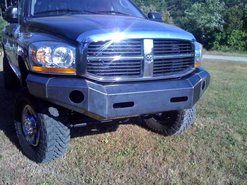

Here's a few pictures of my work:
Duramax bumper:
2006 Dodge bumper, this one was pretty cool. The bumper is mild steel and the bars are stainless. We powdercoated the bottom and left the bars bare to be polished later:
powdercoated:

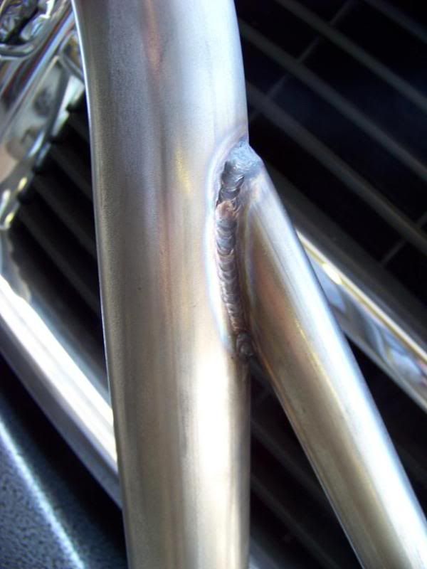

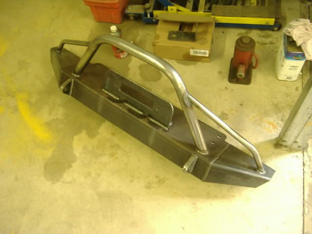

Here's a stainless jeep bumper I just finished up:
Another stainless bumper I'm working on:
and a YJ Mild steel bumper:
We powdercoated a couple bumpers bright colors so they'll stand out at a fair:

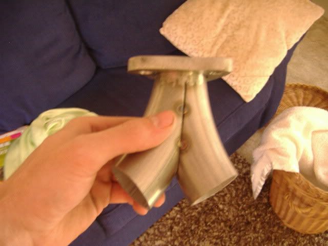

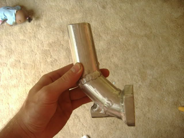

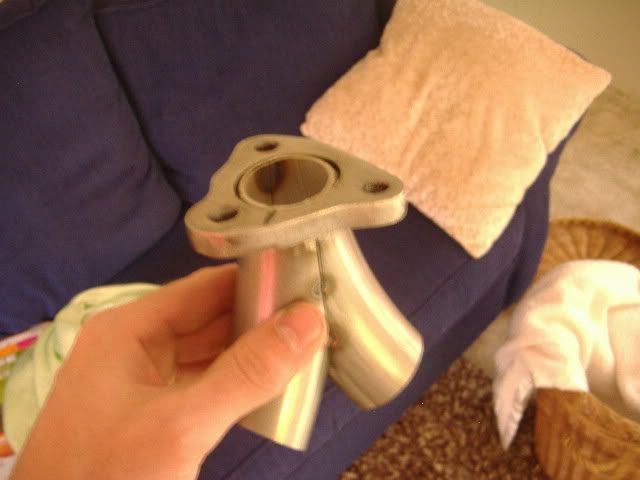

Anyway, that's what's been keeping me from working on the bike. I did get a few little things started though. I was able to get started on the collector for the turbo manifold:

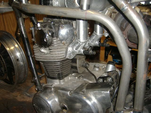

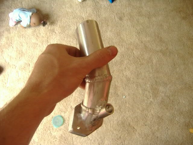

Also I got the injector bungs in the mail, drilled the runners for them and welded one side in place. Not so happy about my aluminum welding right now, I need more practice:

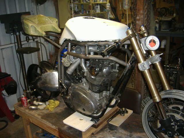

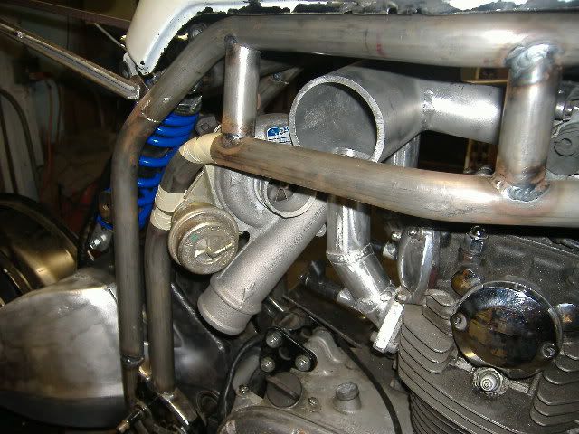

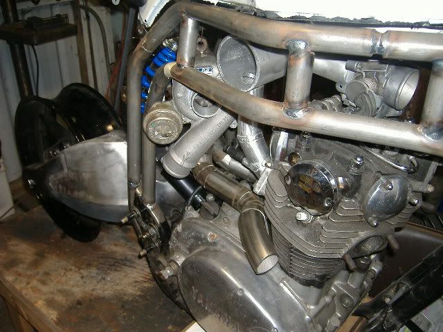

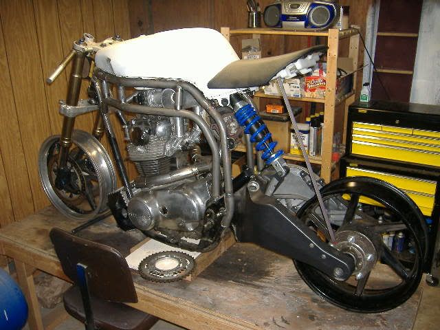

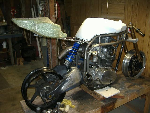

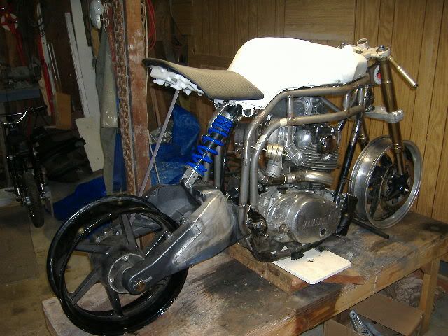

A few new pictures from tonight. Got the other injector bung welded into place, still not great welding, wish I has a chance to do some scrap welding on aluminum to get my skills up to par. Anyway just a few shots of the bike together with the turbo mocked into its final position:
Everything is a pretty tight fit!
Check out my sweet exhaust :)
I just think this picture is cool, when was the last time you saw injectors on an XS650?

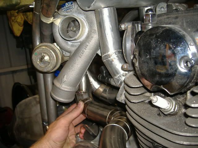

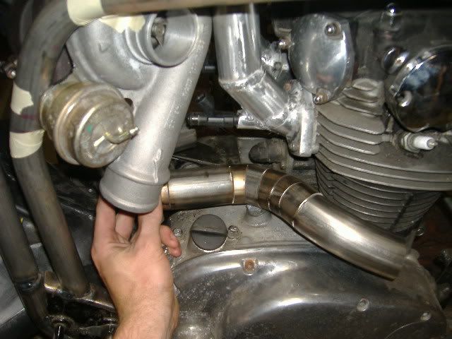

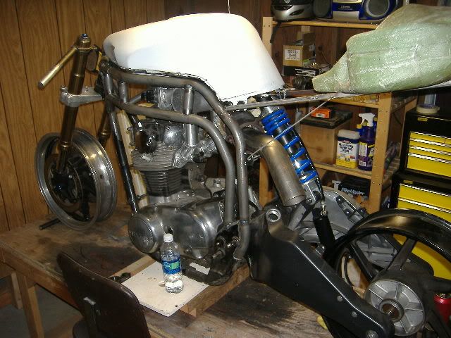

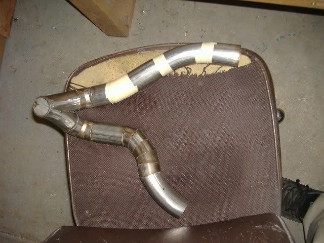

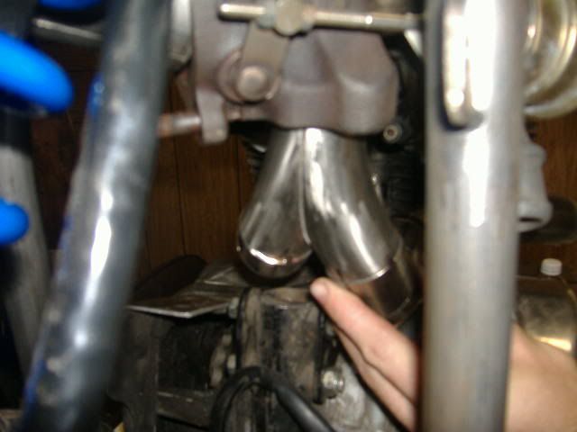

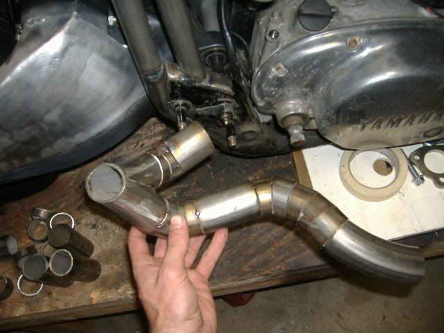

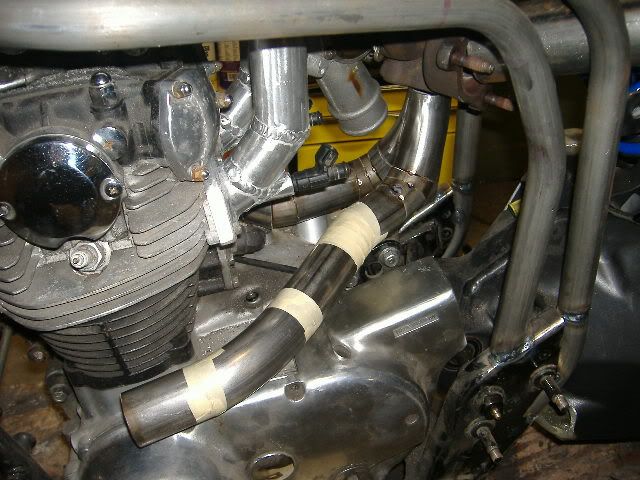

Here's a couple quick pics of the turbo manifold I'm making:
I determined awhile ago that I would be able to check the oil on this bike, so you'll notice the pipe snakes nicely around the oil dipstick tube :)
Masking tape is an excellent tool for mocking up tubing
That's about where I'm at now, that side that still has masking tape in the picture has been tacked into place. Due to how the head ports are placed on these engines it's impossible to build the manifold as one peice, so likely one or both sides will have a flanged section that comes apart for installation or removal.
Thanks again for looking in....
Sky
looks great so far.
have you thought about a slip fit section for the manifold?
i know pictures fail at showing depth and can hind things, but how close do those injectors sit to the turbo?
96turboracer
  • Posts: 913
looks great so far.
I thought about using a slip fit, but I don't have any experience with using one and wasn't sure how good they were. Anyone with any use want to chime in?
The pictures are pretty accurate, there's just enough room behind the compressor housing for the fuel rail I'm making. It's all a very tight fit.
biggest thing is having is be a tight fit, and just weld on some tabs and use a bolt or a beehive spring to hold tension on it.
they have all the supplies on burns stainless's website.

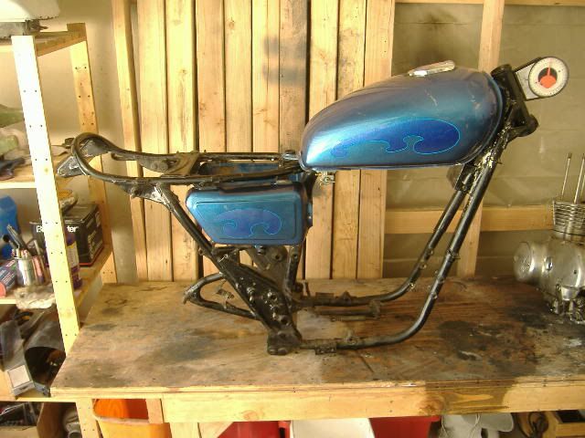

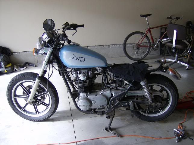

I thought it would be cool to put up some pictures of both my bikes since they're both based off of the same platform:
The chopper when I got it:
The sportbike when I got it:
The chopper now:
The sportbike now:
you'd never guess the sportbike is two years older :)

Sorry guys, my welder being at work is conspiring to keep me from working on the bike at home. However I have been trying to build the fuel rail for it. I had the rail made, the injector bosses were ready to weld in place. and basically I screwed the welding royally and I threw it away.
So I'm going to rebuild one out of steel instead of aluminum. But that's where I'm at right now.

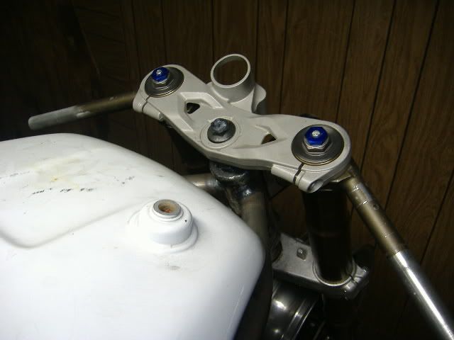

Got a few parts in, got my Kawi upper triple:

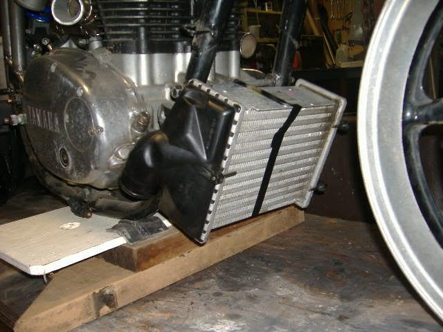

Here's my new intercooler. It's a perfect size! It originally came as a side mount intercooler on an Audi S4:
This probably isn't the final mounting position, but I'm trying out a bunch of different spots. It will be mounted to the downtubes in some fashion though.

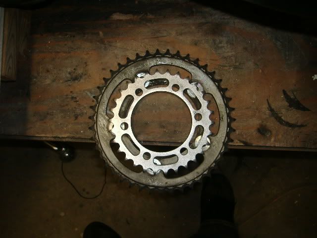

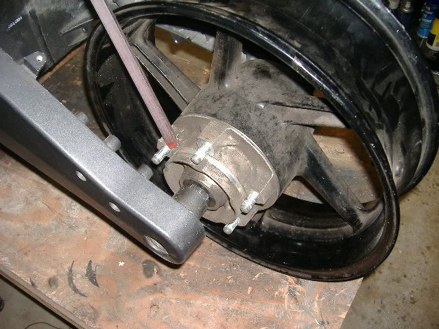

Got my cush drive in:
This is what sucks, because of the gearing in these bikes I need to use a 30 tooth sprocket, that's pretty small. So there's going to be lots of milling on this cush drive to make it compatible with the new sprocket. I'll also have to cut an adapter plate:

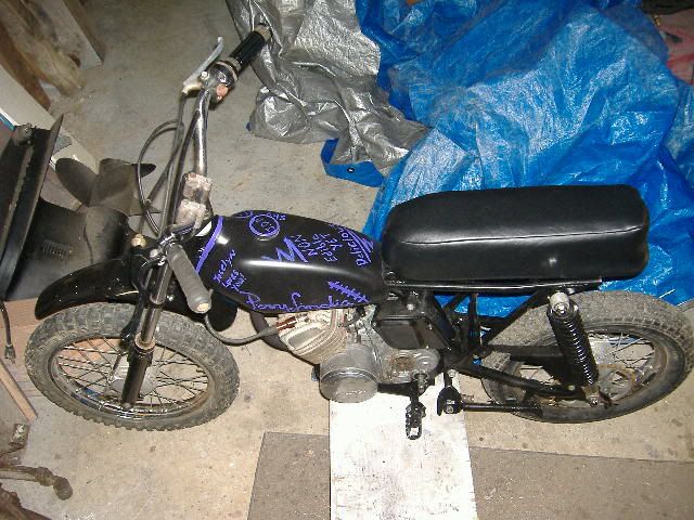

I've been trying to teach my wife to ride, but she gets really intimidated by bikes. So I tried to find the least intimidating bike EVER :)
I've spent the last month refurbishing it, it's almost ready to go, just a little bit more work.
It's going to be a surprise for her, don't ruin it! :)
