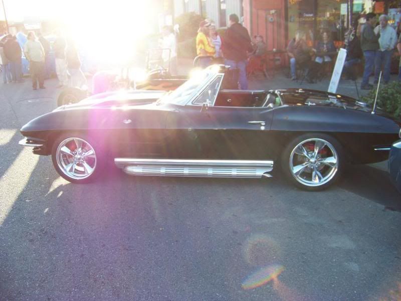

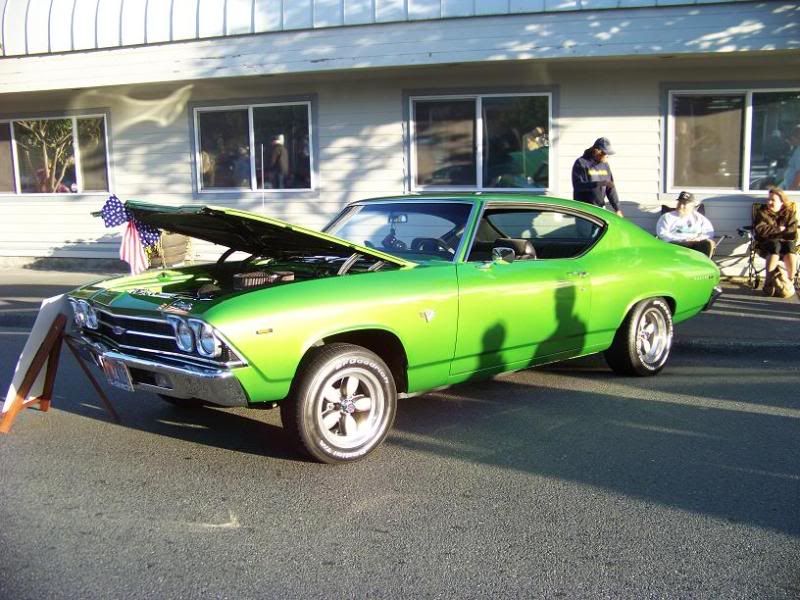

But first, went to a local car show this last weekend with my other bike. Wasn't able to be in the show because it's cars only, but here are a few of my favorites.
Nice oval window bug

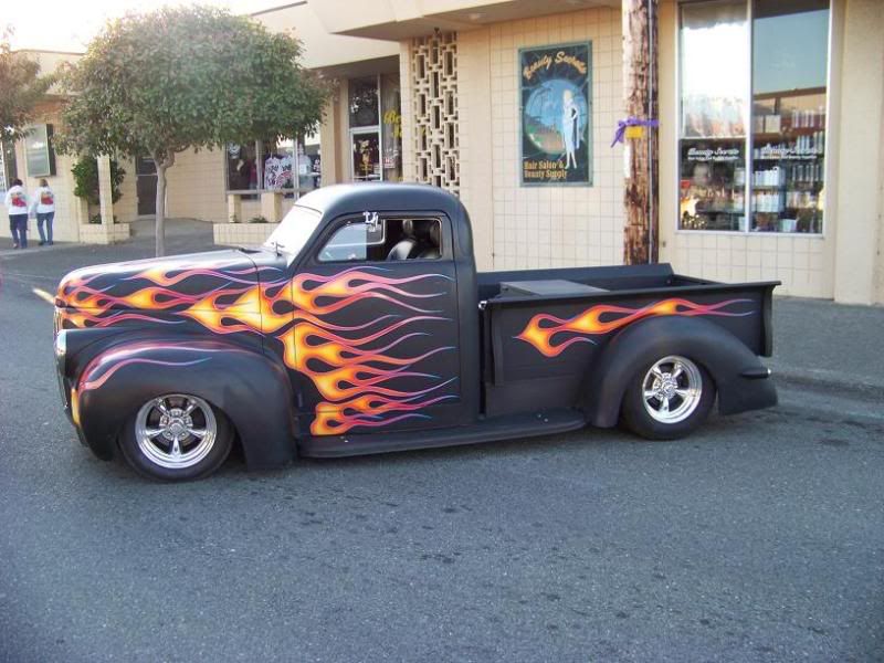

Neat chopped truck
Crazy chopped car
Really nice Chevelle
This Nova was crazy, bass boat style metal flake on this car. Way too overpowering during the day, but it looked amazing at night, tons of power as well.
This Nova was really clean. After this bike a Nova this style is going to be my next project.
And in my opinion here's the craziest car there

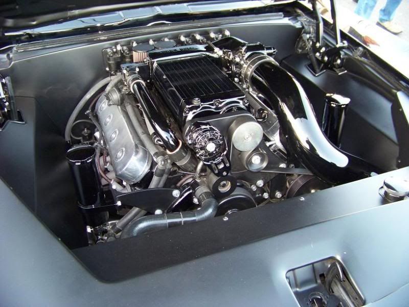

1967 Camaro, LS7 Kenne Bell supercharged. has a TKO 6-speed in it, dyno tested, puts out 817HP and 922LB torque, absolutely ridiculous. And the engine bay is clean enough to eat from, easily. Also the rear rims have about 8" of dish. I can't even think about all the money in this car. Super nice guy owned it.

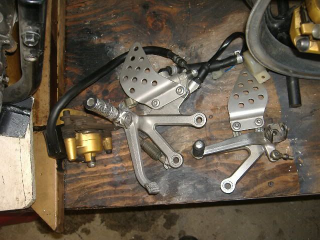

Here's a few shots of the stuff I got from my brother after his bike accident

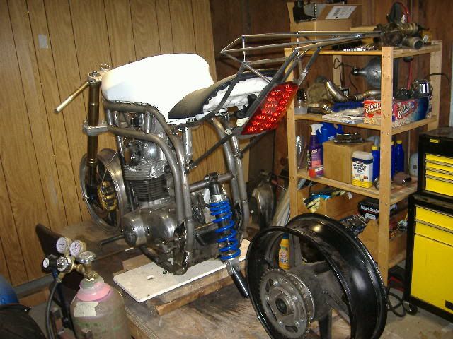

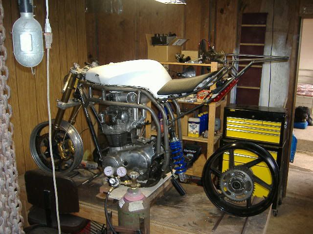

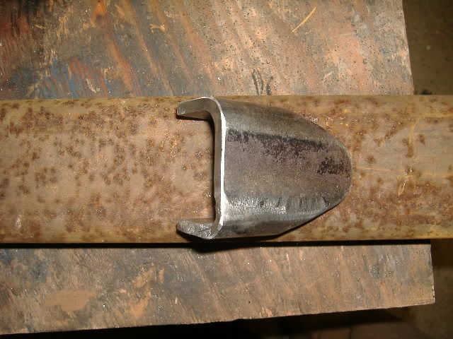

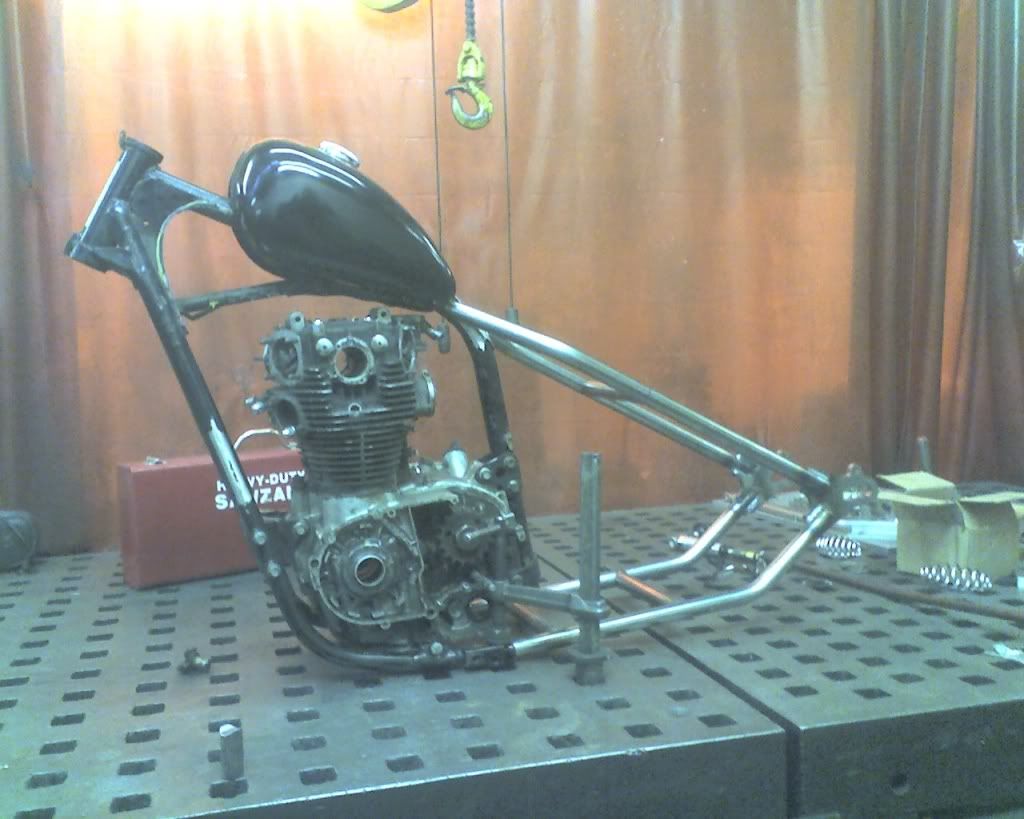

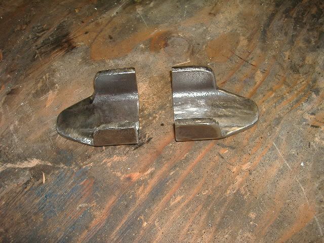

I've decided to scratch the swingarm I had, it just wasn't working out, I was going to have to put hours and hours into modifying it, and it still wouldn't be right, so I did the right thing and bailed on it. Now I'm building one from scratch. Here's the start of it, the axle adjustment plates. You'd be surprised how much work went into these things. I started off with square tubing that was too large, so I had to cut it down and weld it back together, then shape it. I've still got a bunch more work to go on them.

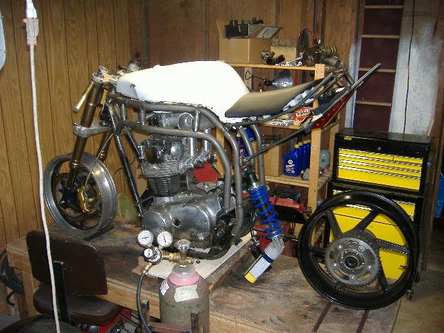

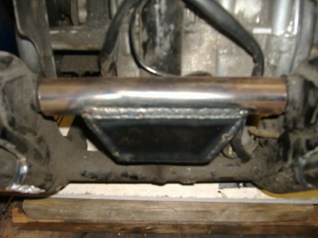

Here's the start of the swingarm pivot point
I started building my subframe/tail section. Please reserve judgement on this until it's done, remember that the actual tail section will resemble the KTM RC8 tail.
and a quick pic of the RC8 tail to refresh your memory
You can see from these pictures that I also relocated the shock mounting point. The new swinarm will allow the shock to be mounted low like that which will give me the clearance I need for the turbo and exhaust. Should be a much better solution, albiet not as nice looking.

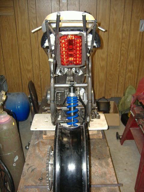

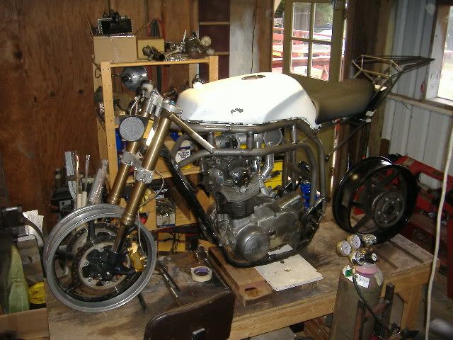

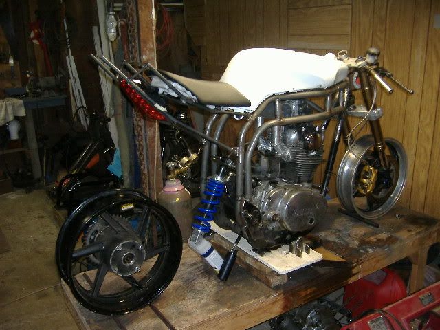

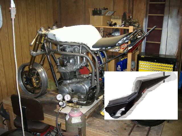

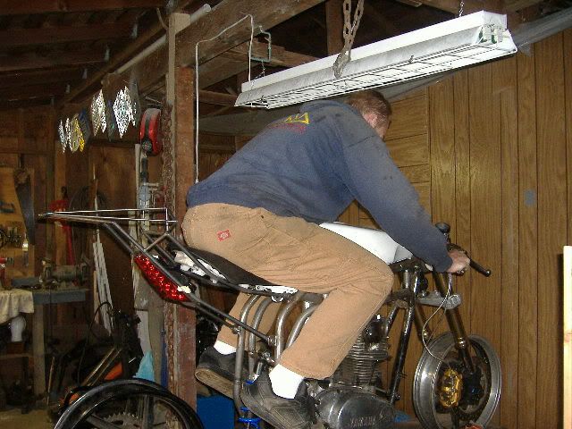

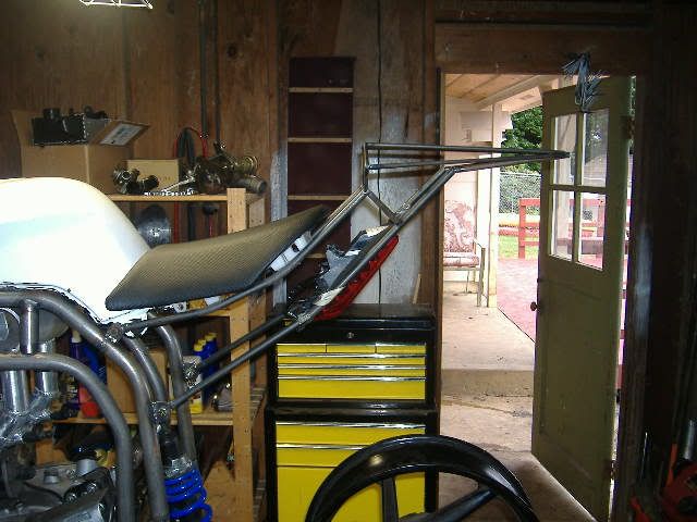

Got the tail section fully mocked up. It needs to be finish welded and smoothed, Then I'll skin it with sheetmetal, should look pretty cool.
As you can see I pulled inspiration from not only the RC8 but also from Rossi's current tail section. It's a little hard to see all the framing in the pics, but the tail doesn't come to a direct point, more like a duckbill that's about 3" wide.
Let me know whatcha think....
I feel this is the best shot to show the end result
thanks for looking
Sky

looks like youre wearin airwalks
WTF?
Looks tits, keep up the good work
the rear tail section looks sweet, and the riding position looks pretty good.  :yes:

haha you don't ride it seatless do you?  I hope for your ass that you don't
toyolla86
  • Posts: 289
i think the seat is there. its just hard to see.
one piece of metal sheet as the seat.

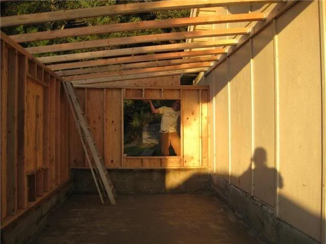

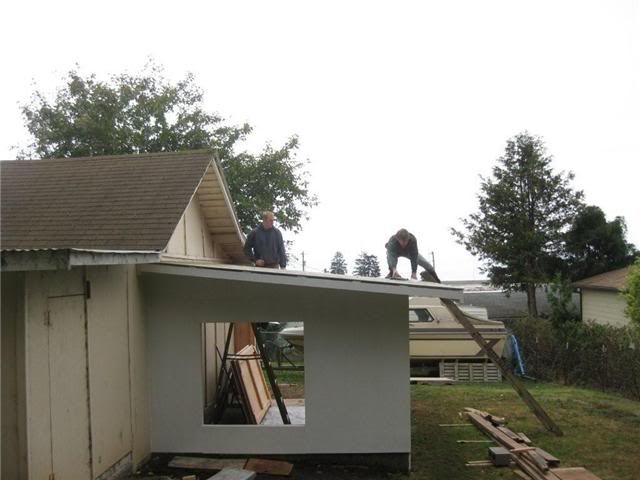

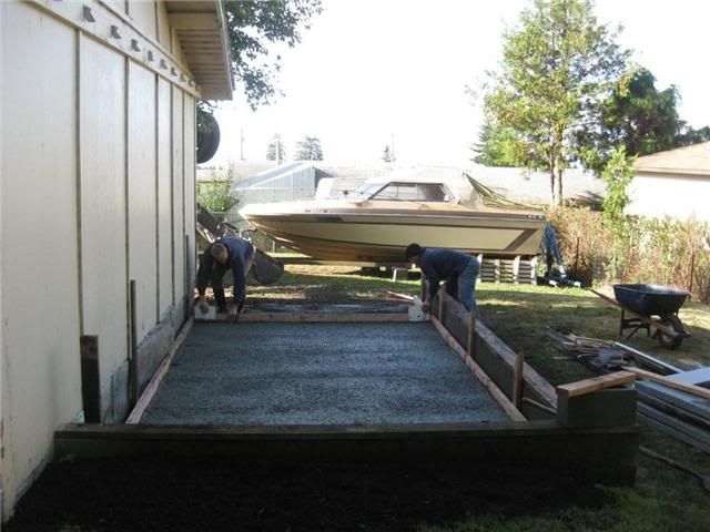

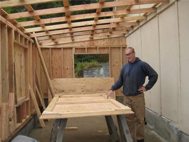

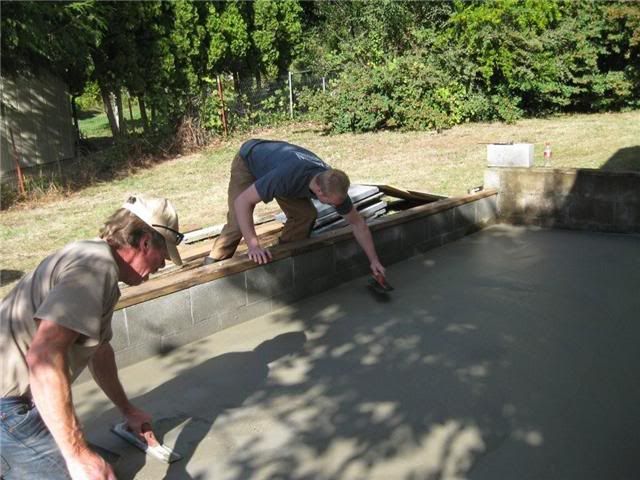

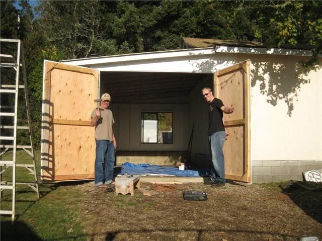

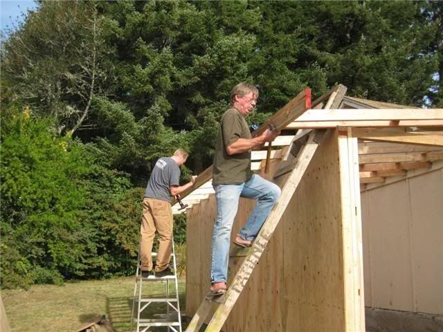

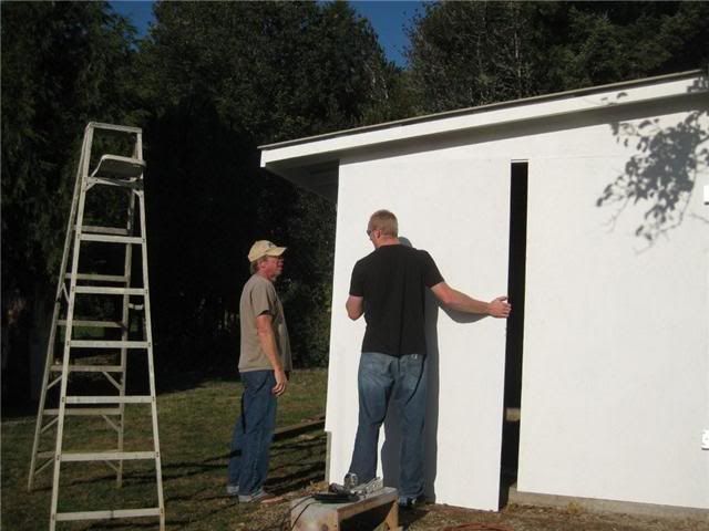

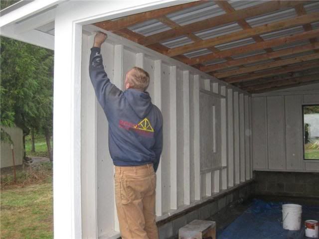

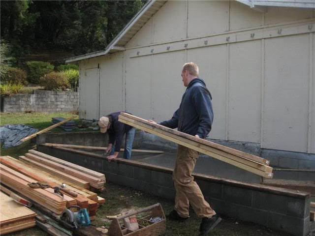

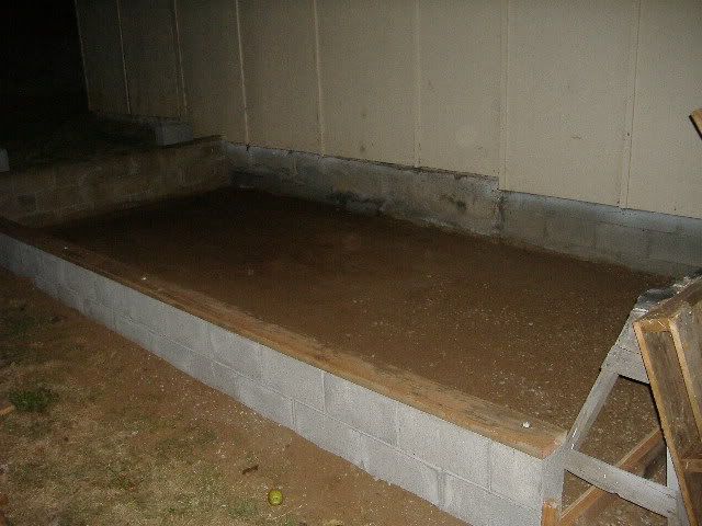

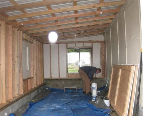

Not much on the bike build, but this last week has been really busy. I've been helping my father build an addition to his shop so we can have a metal working area. I'm super excited about this because it was really cramped in the shop currently as I'm sure you could tell from the pictures.
The other reason I was happy to be involved is that I know NOTHING about construction, I just don't do it. So here was a good project for my Dad to help me learn some stuff.
Enjoy the pictures:
It was a great thing to work on, got a lot done. The only things I have to do now is make some hinges for the doors and get those mounted. Then I can cut the door into the main shop and I'll be able to move all my stuff in.
A few notes about the shop- The wall on the left side has an opening for another window, we didn't have a window yet, so it's just covered with plywood for now.
The outside will eventually be painted the same color as the rest of the house, that's just a primer.
Why white/cream colored on the inside? Two reasons, one it will reflect light really well and look brighter inside, and two we had about 5 partially used  gallons of paint in the garage and when we mixed them all together this is the color we got :)
Thanks for looking and I'll post some more bike related stuff soon.
Sky

any idea how much it cost to do that? i am trying to buy a house right now and i am considering buying something with a small garage and adding on if i can afford to. its really hard to find something with a garage i am happy with that also has a house my wife is happy with.
how much concrete did you use?  did you use rebar or dowel it to the existing pad?
solid work. it always gives me a half chub to see people doing shit on their own rather than pay someone crazy $$ to do it for them.
96turboracer
  • Posts: 913
I think about 2.5 yards? somewhere around there. We put rebar in the flooring, but didn't attatch it to the other concrete pad.
Finished up the doors today:
yea buddy, time to start moving in! :)

What, no electricity built in. Are you going to insulate for winter. Just cuz you don't pussy
out on your maticulas fab jobs on your bikes, Don't start there
robus
  • Posts: 316
+1
run the wiring before you put insulation and cover with some sheetrock or plywood—so much neater and safer than having your wiring exposed  :?:
Great little fab area though ;)
He has it to the point where it is ready for wiring, etc.
The way I see it, priority 1 was getting it weather tight, prior to proceeding to the next step, wiring.
I don't really see why people are jumping in about it unless they don't really have any experience with construction.
Looks like he is exactly where he needs to be for right now. I'd rather wire it out of the weather.
