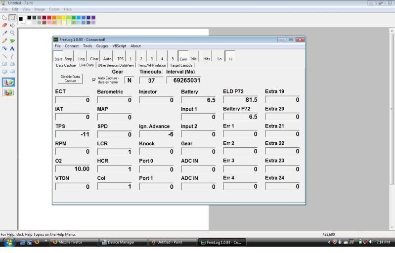

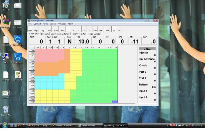

I have the latest crome and freelog versions but very little is registering.  I have the 4post to usb on the ecu and my com ports are set to com4 with good connections. Only running the narrow band O2 for now till i get a LM1 to ecu cable, but shouldn't i see rpm, iat....etc even just idling???

in freelog go to setting and under data command, set it to crome 1.4
Don't forget to enable Quickdatalogger +RTP plug in with Crome
I'll try this,
i thought at least once i had both programs open and RTP enabled but will try again and report back.
