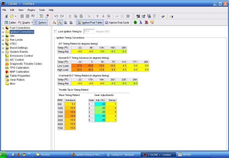

jagojon, is that map with the default timing shit in crome left alone?
Yes, the default timing shift hasn't been modified. I haven't changed anything on this setup page.
Is that crome gold? Mine looks nothing like that.

yeah thats gold. Sometimes I can get gold working good sometimes it doesn't
