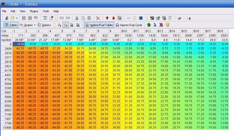

Here is my timing map, jago can you post you're up please? I'd like somthing to compare mine to. If anyone thinks this is too much or too little please chime in.
This is a z6/vitara setup stock rod length so yea low comp. Like I said before it surges like crazy at WOT after 5500rpm and at 15psi or more.

from personal experience you have WAY TOO LITTLE TIMING
im running like 27 at 15-16 psi no knock (at least in my det can) at about 29ish (i think) i started to hear something so to be on the safe side i dropped it.
also 16 psi is probably maxing my turbo. small 16g
ran a 12.4 @112 mph with a 1.8-1.9 60ft in a 2300 lbs car
i also did a 4:30 hour trip non stop up and down mountains in 3:30 hours. bagging on the car and listing for det once in a while. next day checked the plugs and they looked mint.
im sure some one will say that's way to much ECT ECT but it seams to take it and run perfect.
also a buddy's car was doing the same. taking about 25 degrees at the 14-15 psi range

Yes it seems like a lot, but:
Was it on 94 pump?
What was the base timing (distributor) set at?
Was the base ignition table modified?

yes chevron 94
distributor at 16
base ign (im guessing thats the advance feature in crome that adds timing by it self? if so it was set to 0)
Yes the feature in crome, that adds timing based on rpm. Was it set to 0 across the board, or was it just left on its default slope?
but now im starting to think maybe the i should set it to stock retard the timing and it might improve my out of boost driving

Well that is why everyone else has like 15 degrees and you have like 27  :P . As if they have the default slope by the time they get to 7000rpm they have ~12 degrees extra base, or about 27 degrees total.

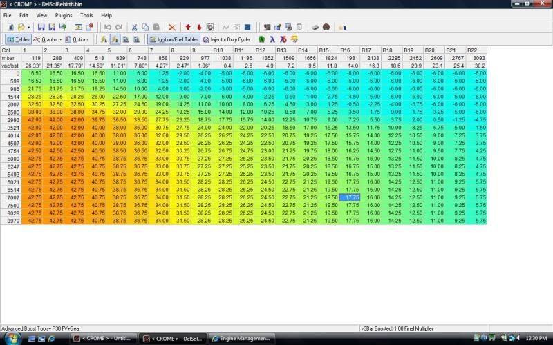

Here's my current high timing map... I'm sure I can advance it more.

Re: Ignition timing on Vitara setups
« Reply #28 on: July 12, 2009, 03:25:39 AM »
jagojon, is that map with the default timing shit in crome left alone?
when you say antilag in crome free, are you talking about modifying and using the low side vtec off the launch?
« Reply #29 on: July 12, 2009, 11:24:49 AM »
Yes, the default timing shift hasn't been modified. I haven't changed anything on this setup page.
