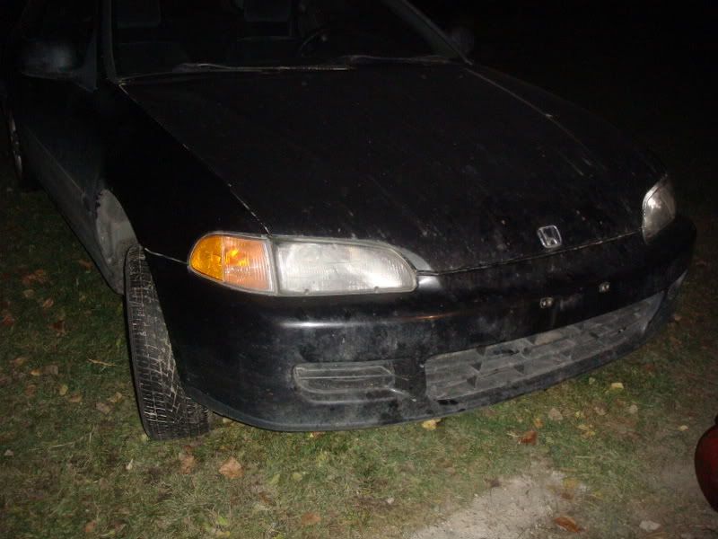

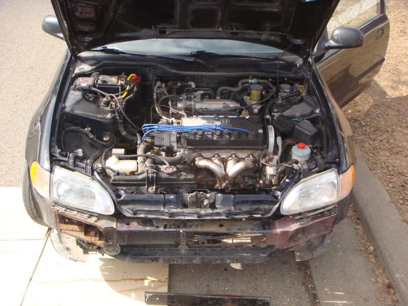

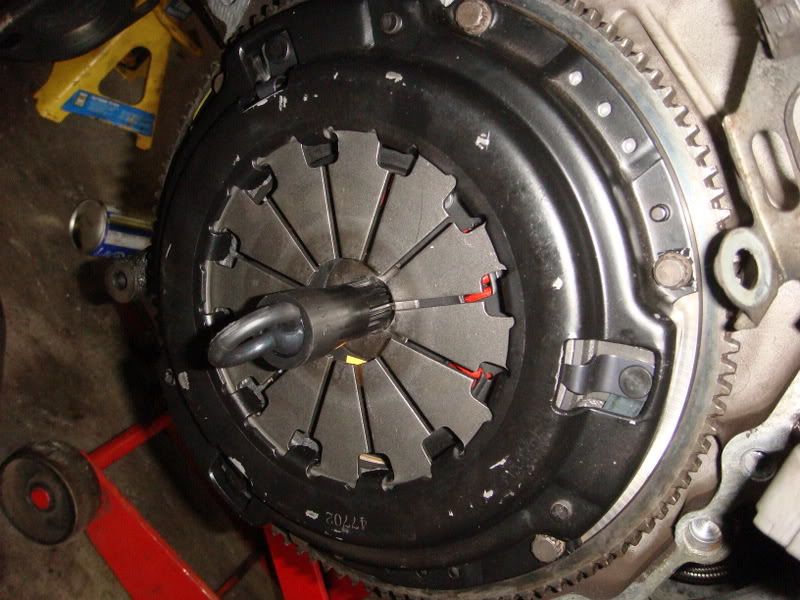

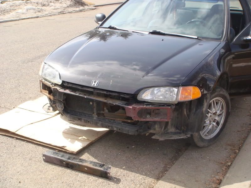

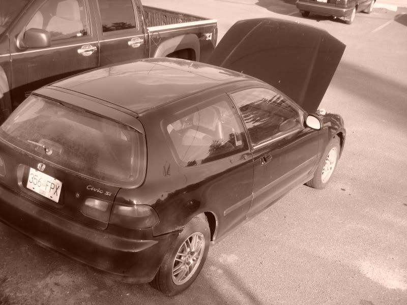

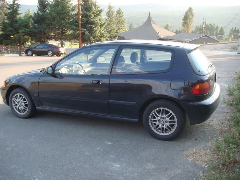

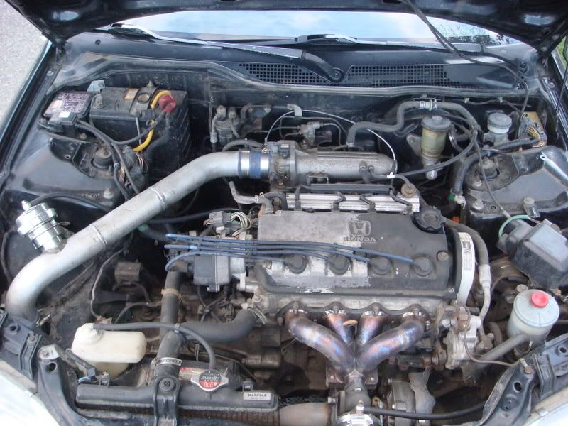

My white car got rear ended and i bought another one (a black SI) so it got the turbo instead.
I hurt the motor in the black car this weekend on my road trip to see some buddies in PG, so back to driving Snow White (recently released from the body shop).
Pics below Enjoy and comment.
Evill mani
Clutch install
this thing was clearly no match for my 9# D

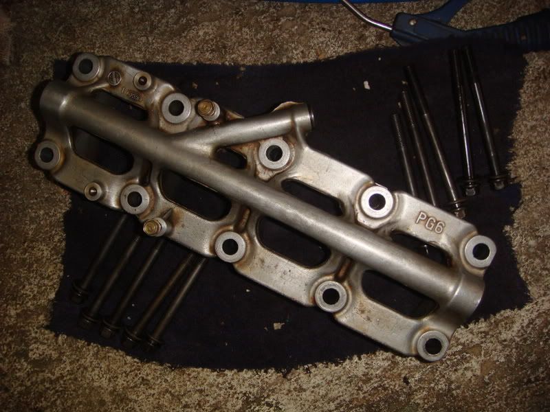

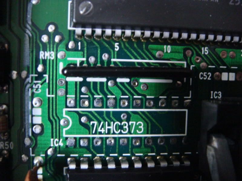

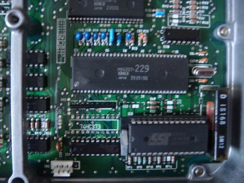

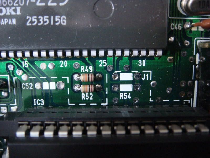

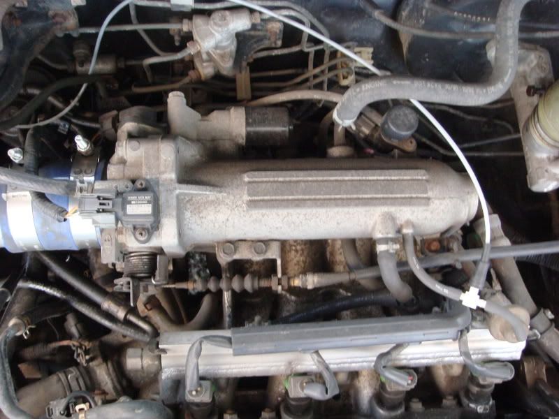

some pics of the ECU that was missing parts as it turned out

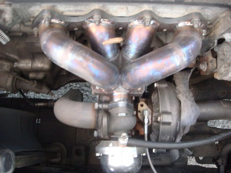

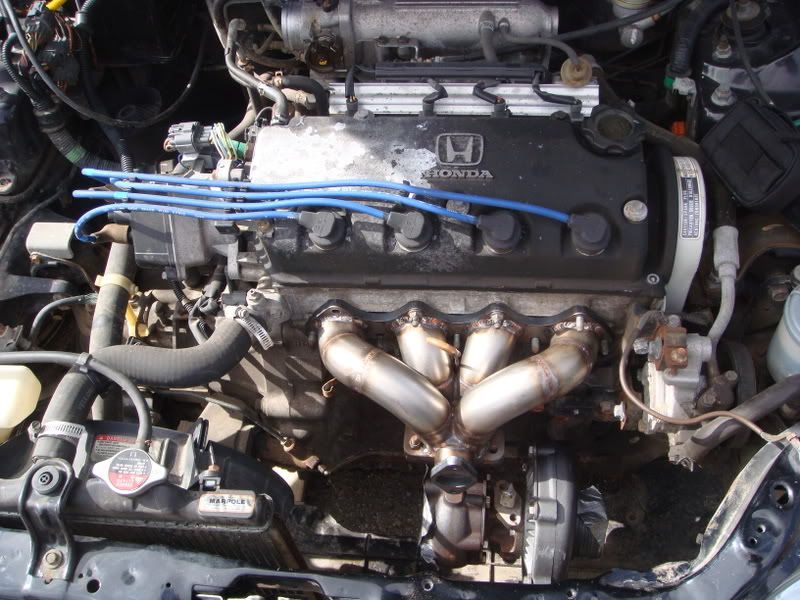

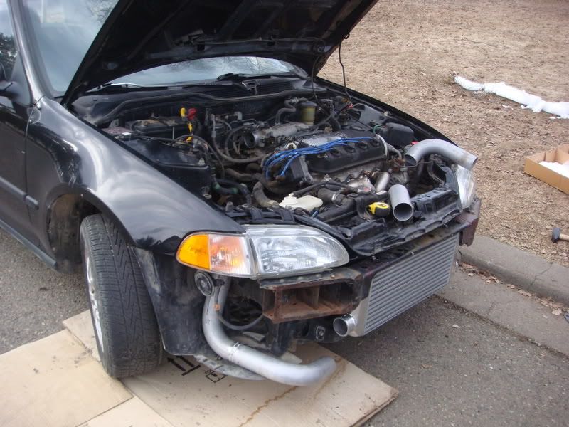

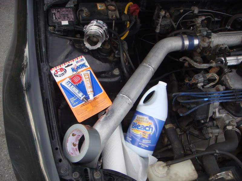

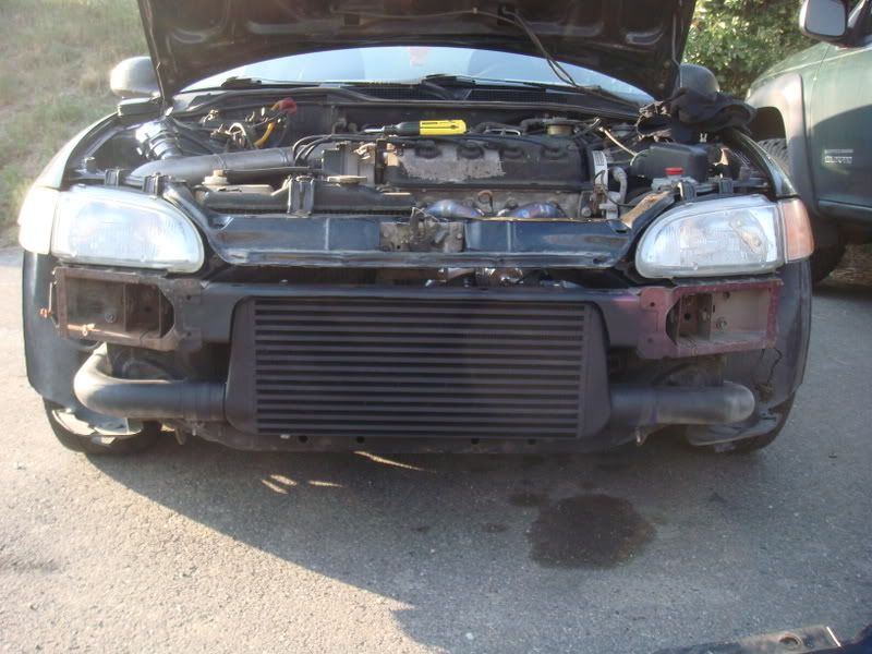

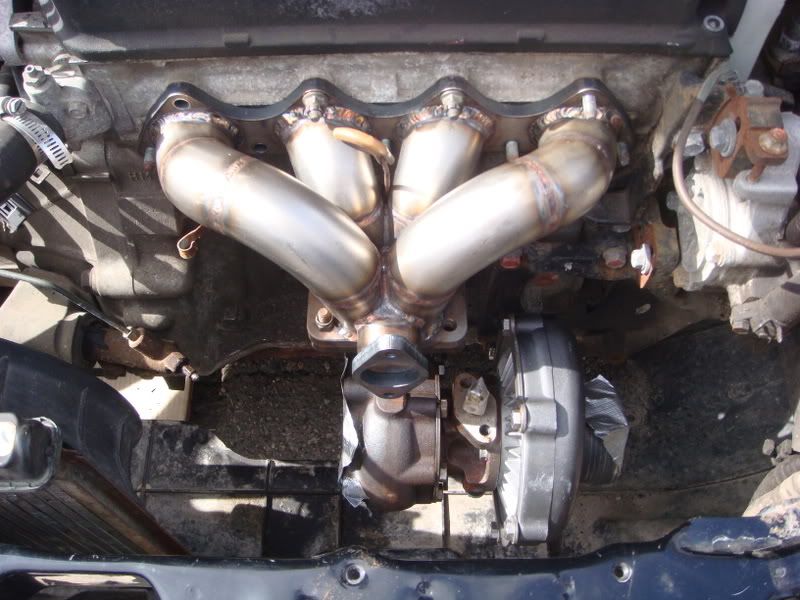

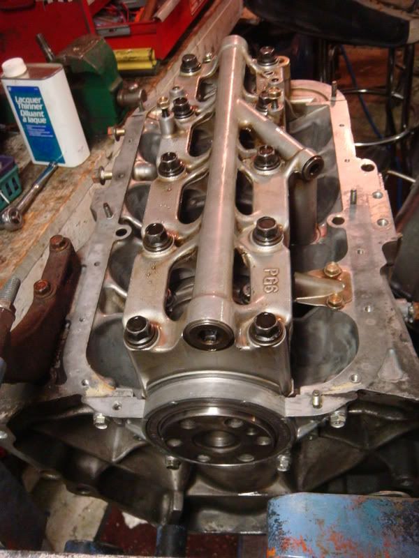

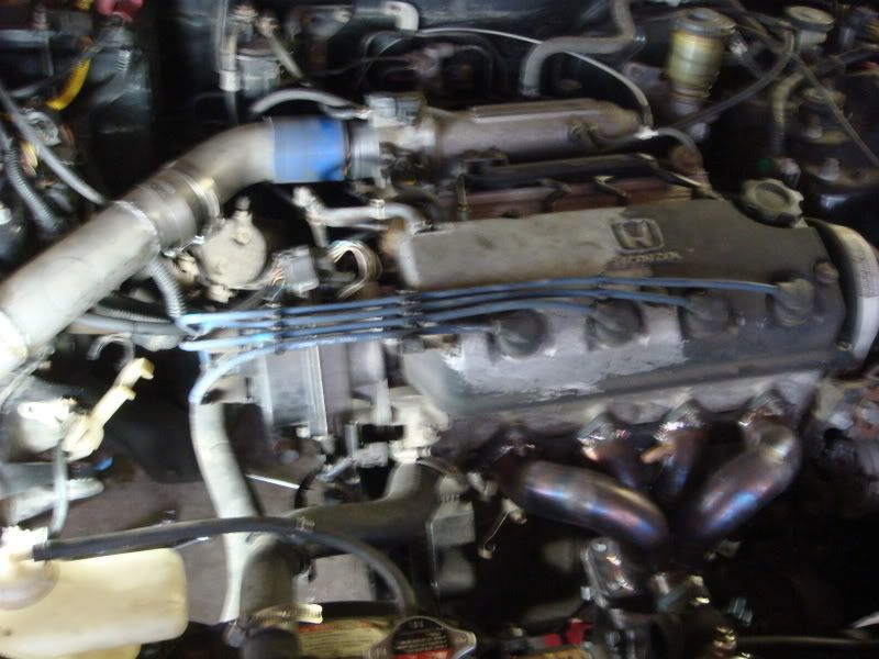

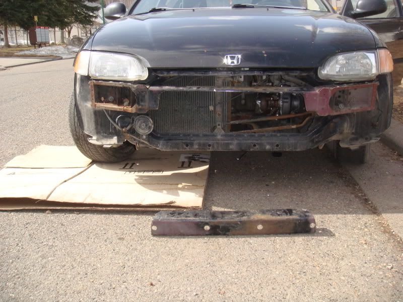

charge pipes mock up, can you believe i conviced a nog to help me build this in his driveway on his wedding day... O0

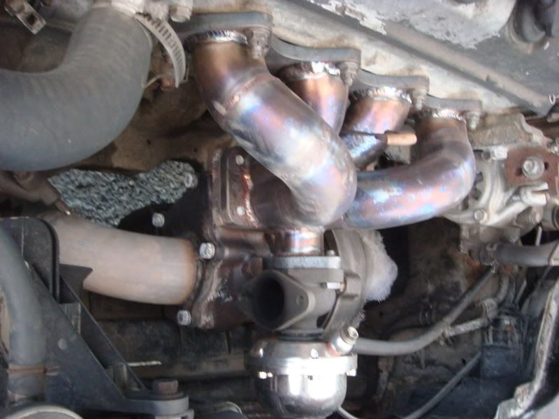

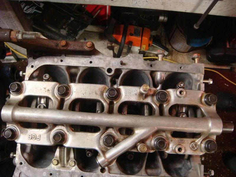

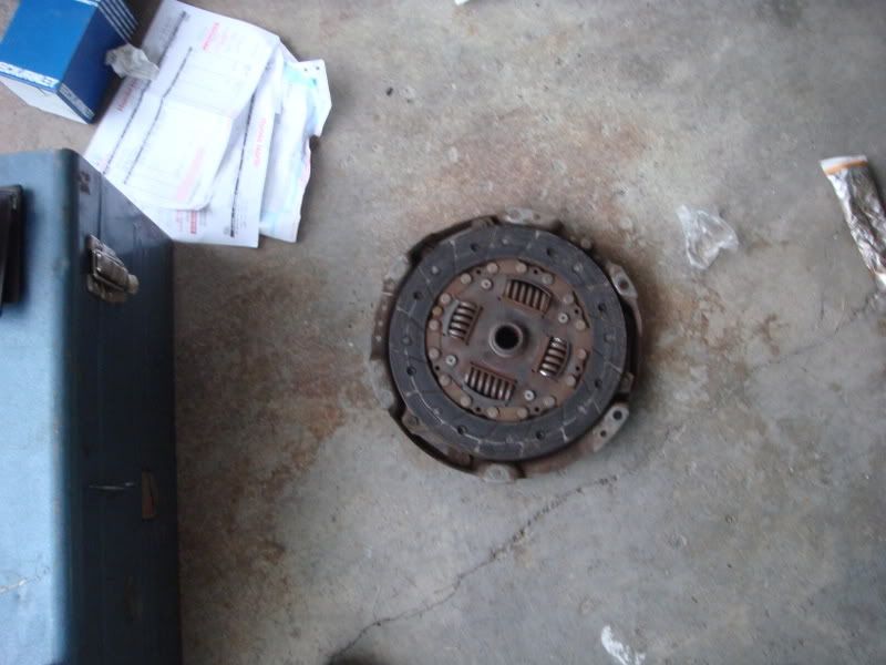

my pride and joy, welded and drilled rail, yup boys this was the point of no return
install complete, getting it to run, not so much at this point

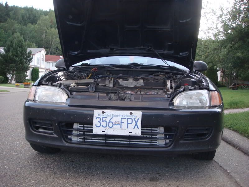

front view

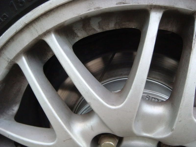

new shoes ;D
rear disks yo!

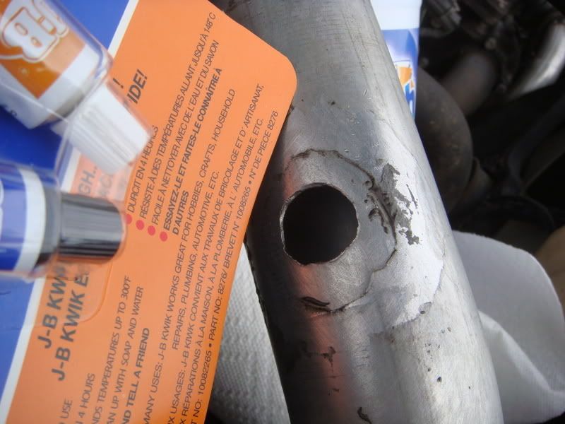

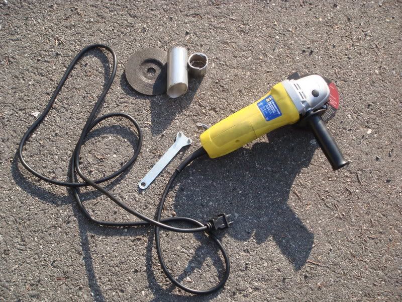

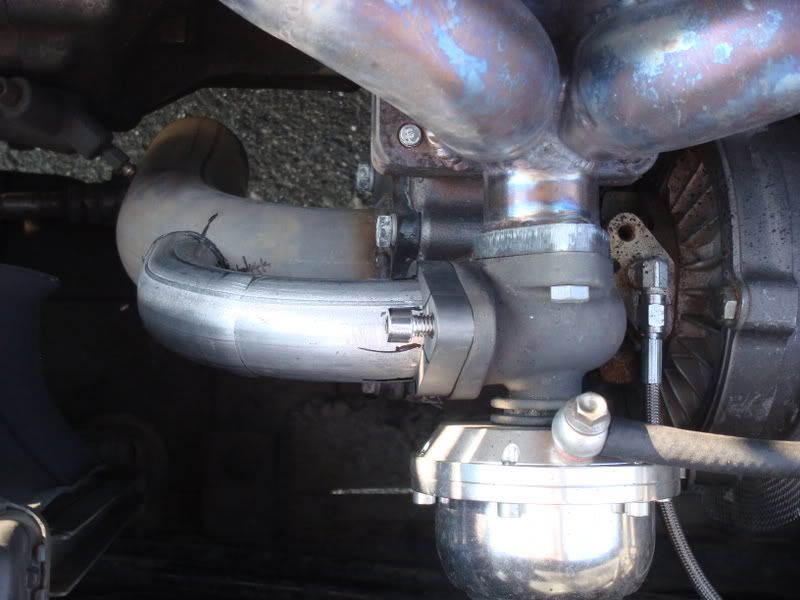

tools for making a pipe for the previously open wastegate dump
after reading about this being a bad idea, i turned it and it dumps right beside the open down pipe :y

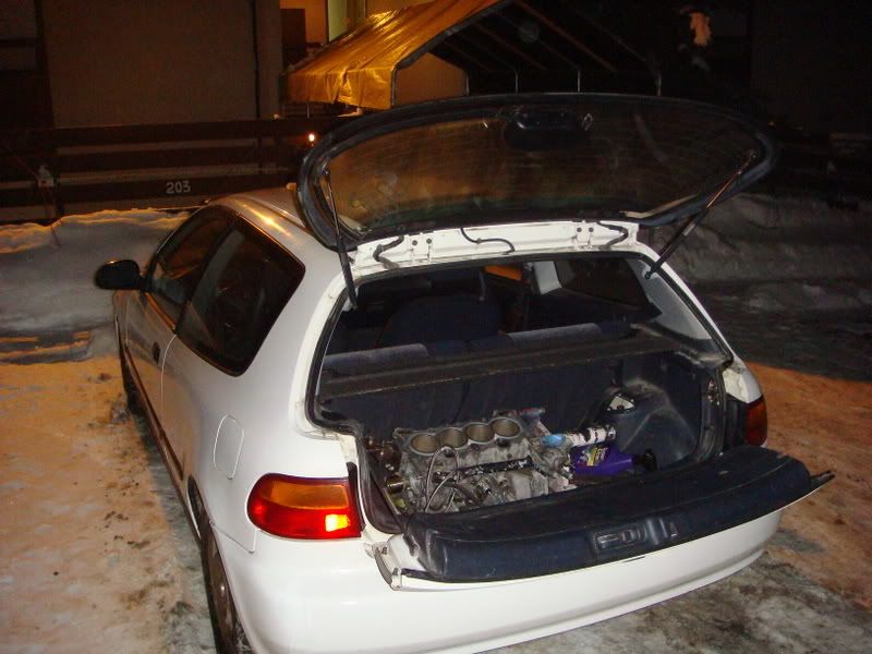

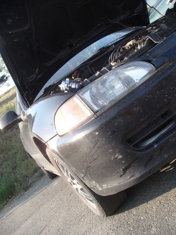

On the way home from work one day (same day i was to prove the D's worth, she spit the BOV in protest
back up and racing in 2 hours

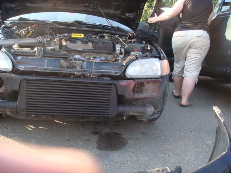

After almost 4 months and 10,000 km of beating on it, something finally let go on my way up this weekend.....
Seems to still be fireing on all holes, just some are weaker than others. Oh and the typical big time puff puff out the valve cover hose. Betting cracked pison/ringland! Opinions?
Kinda hard to tell in the vid, but the second one where it sounds like a lopy cam... well its' not the cam.

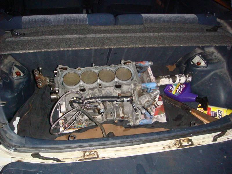

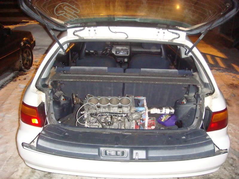

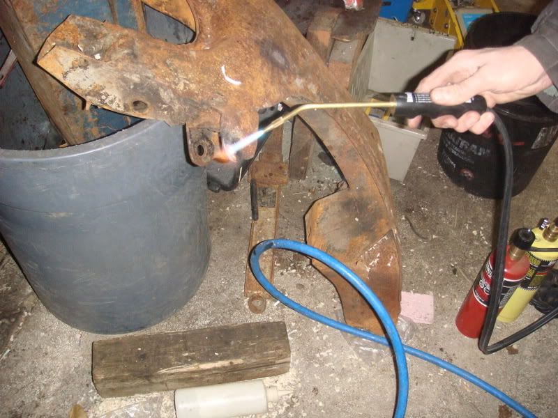

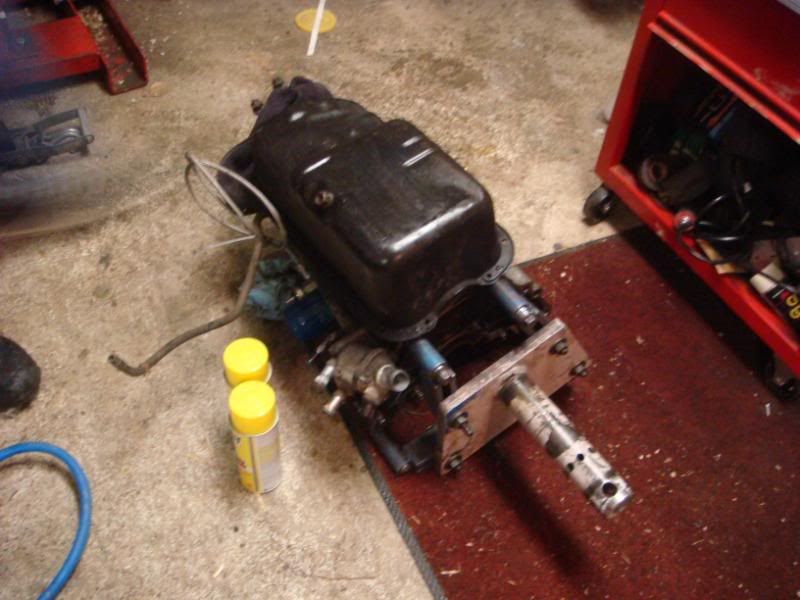

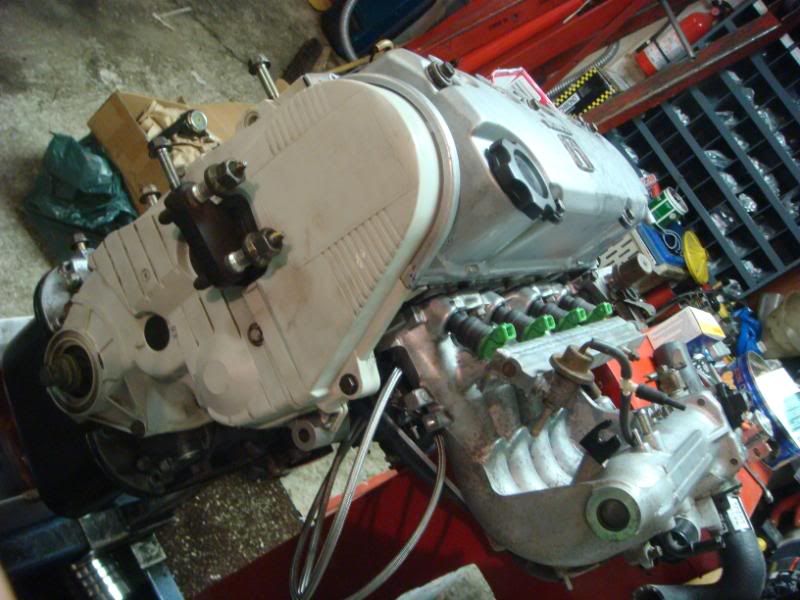

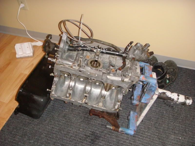

vitara's and fjt's have arrived
motor is ready to pull,

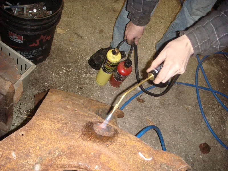

and we played with an interesting homemade oxy-acetylene setup tonight

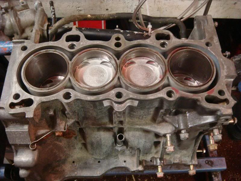

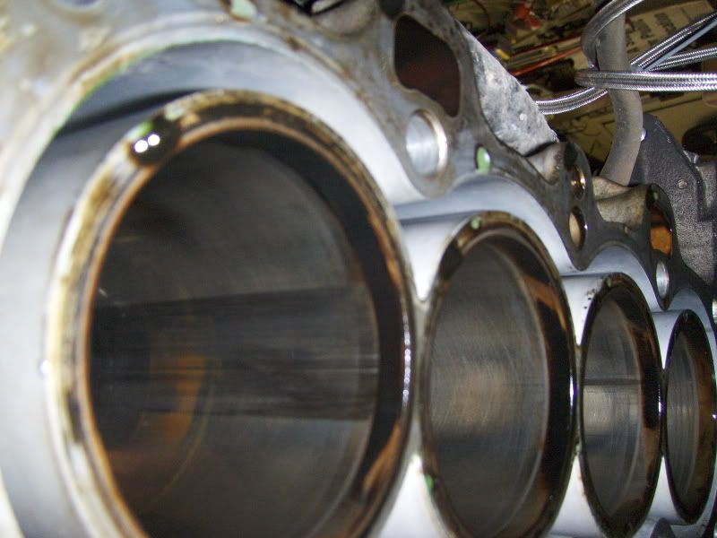

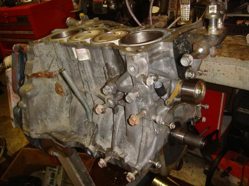

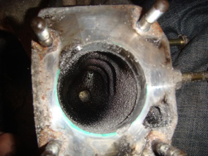

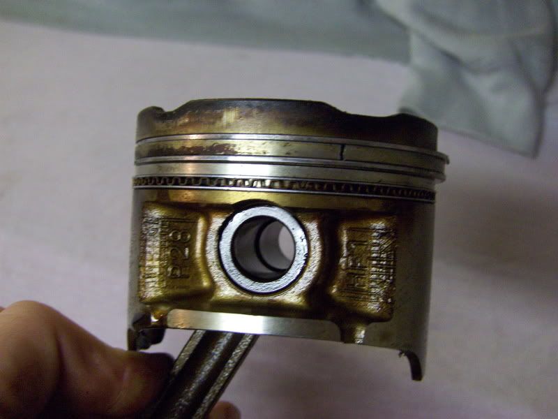

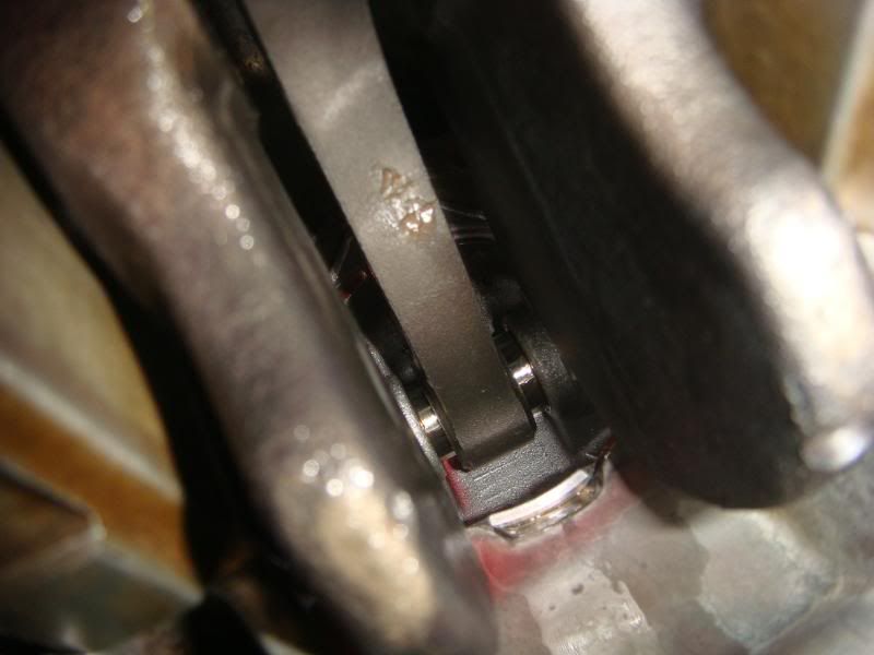

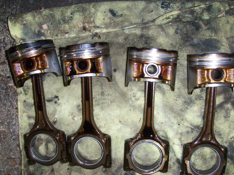

ZC time to photo whore, cause words are boring.

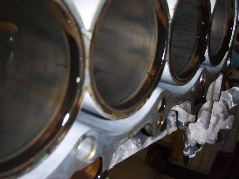

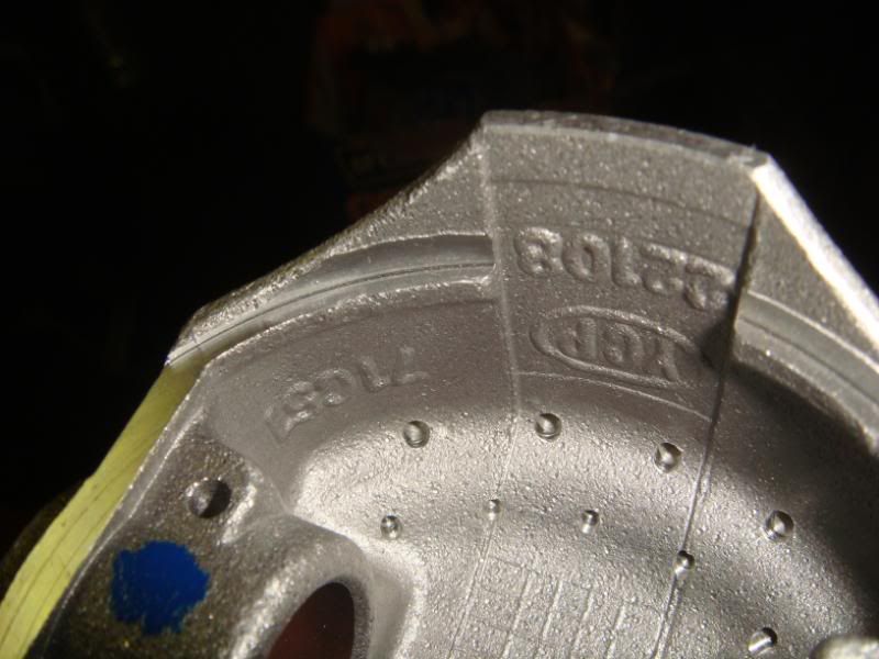

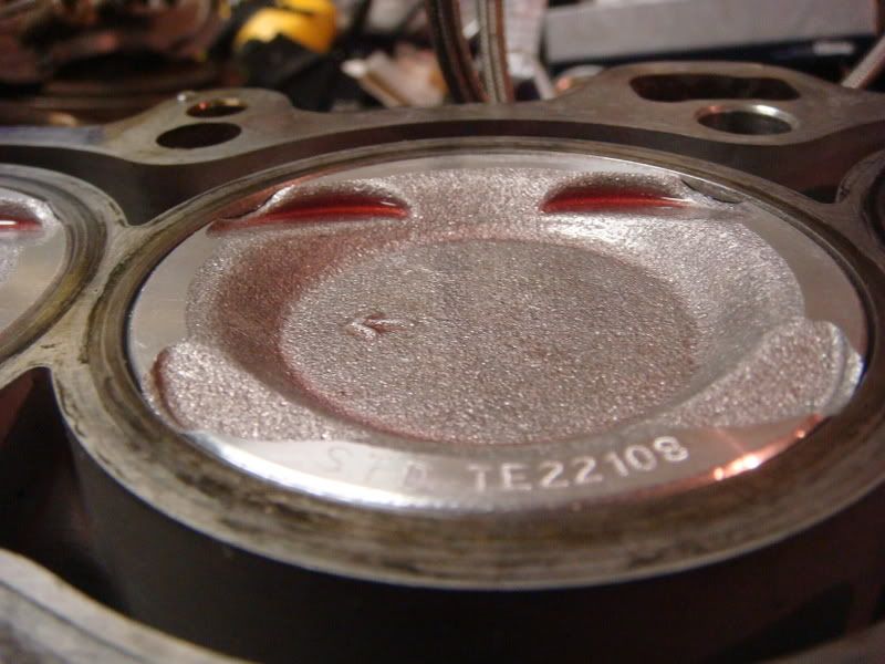

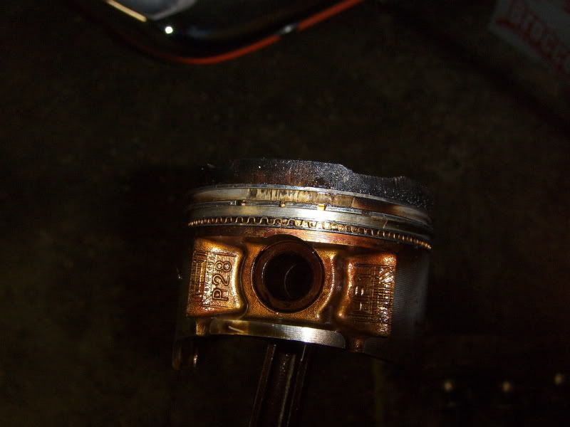

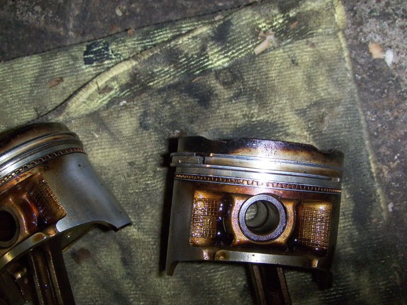

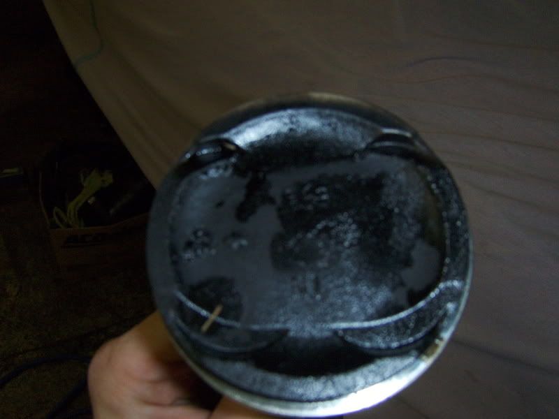

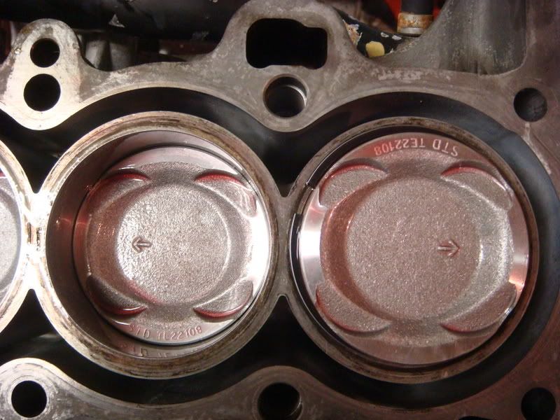

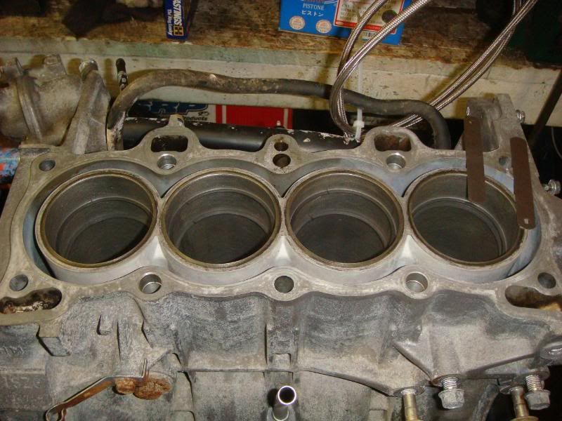

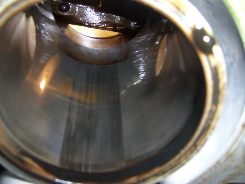

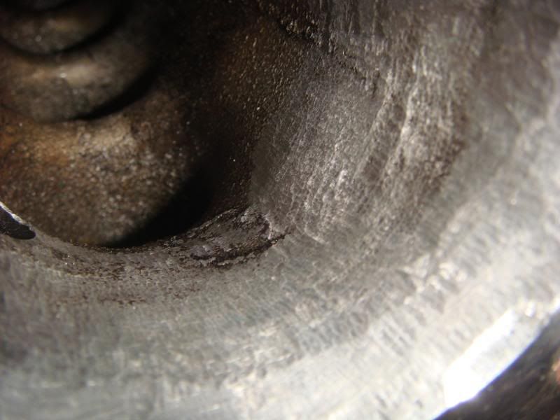

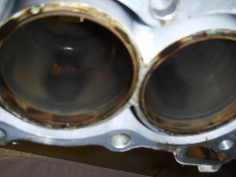

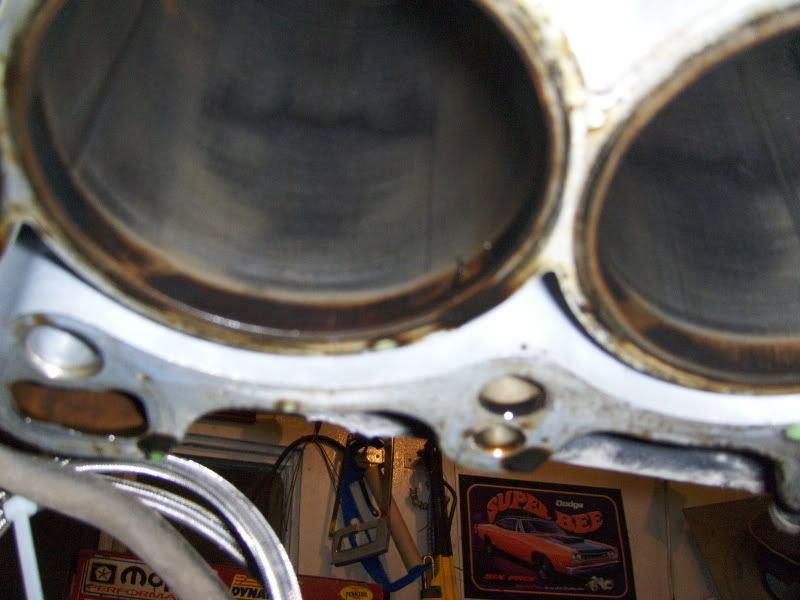

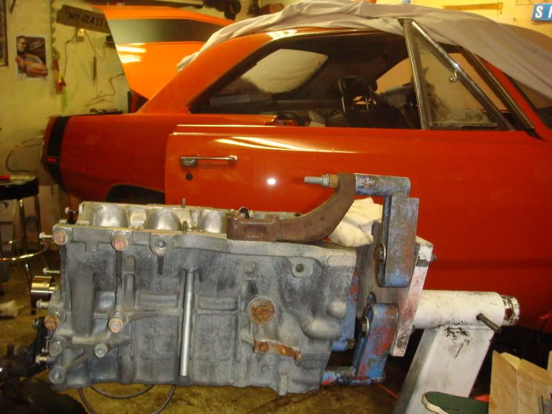

3 out of 4 ringland-broke pistons.
Actually broke the ring in 4 places haha
Sooty enough

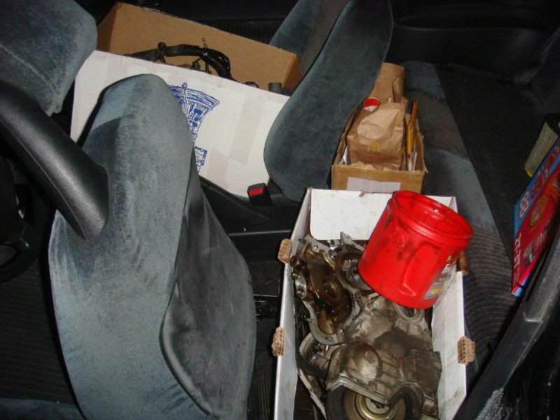

Box of shit and stuff
Pre-dissassembly
The crank looks decent too

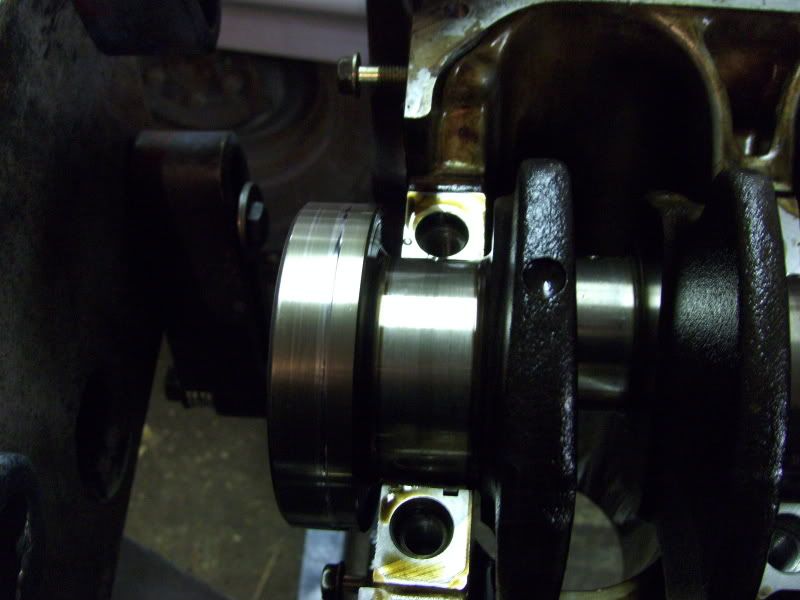

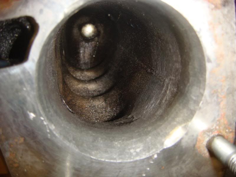

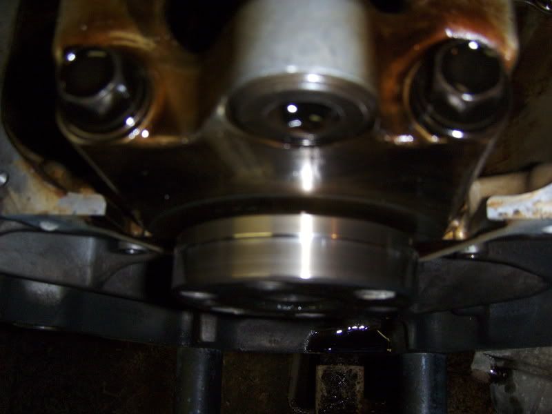

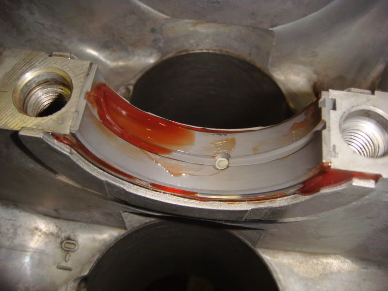

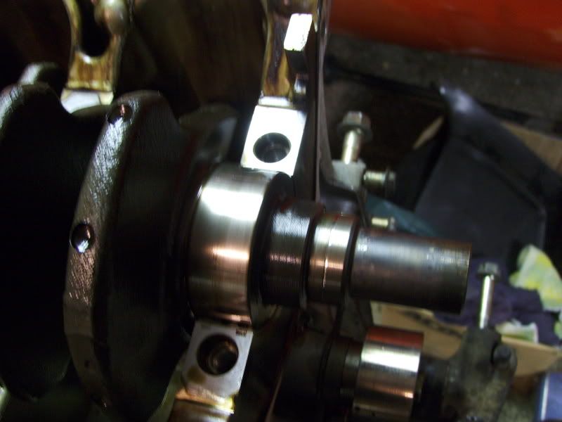

Except it did have these marks where the seal goes (appears on the snout and flywheel side?!?!
The worst hole, doesn't look tooo hurt...
a couple of the thrust sides
Crank
No crank

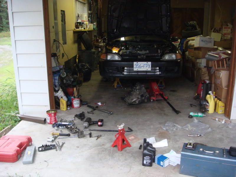

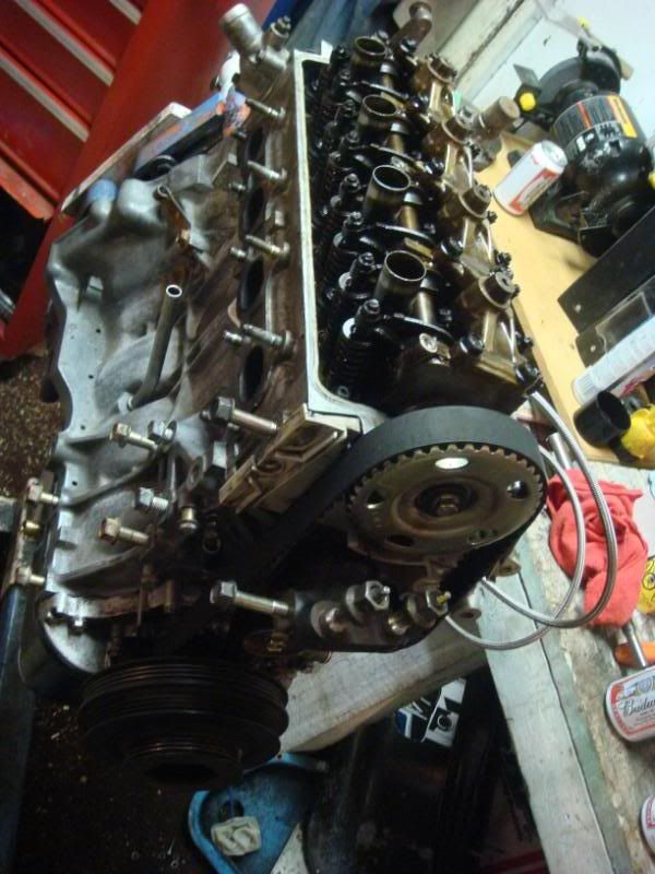

Finally got a chance to do some work and have my camera with me

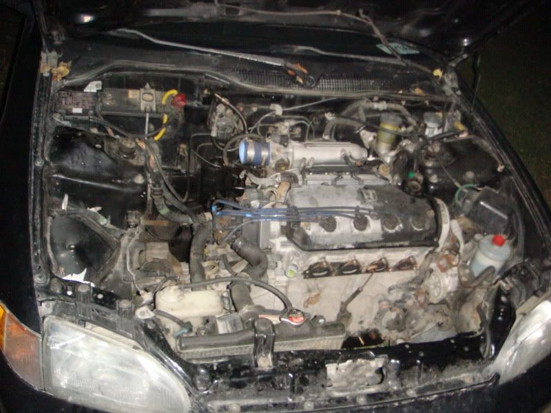

This is what she looked like when i got to the shop :S

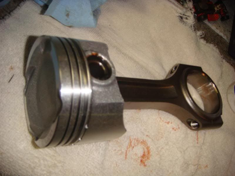

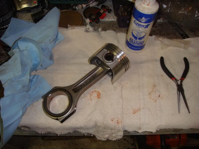

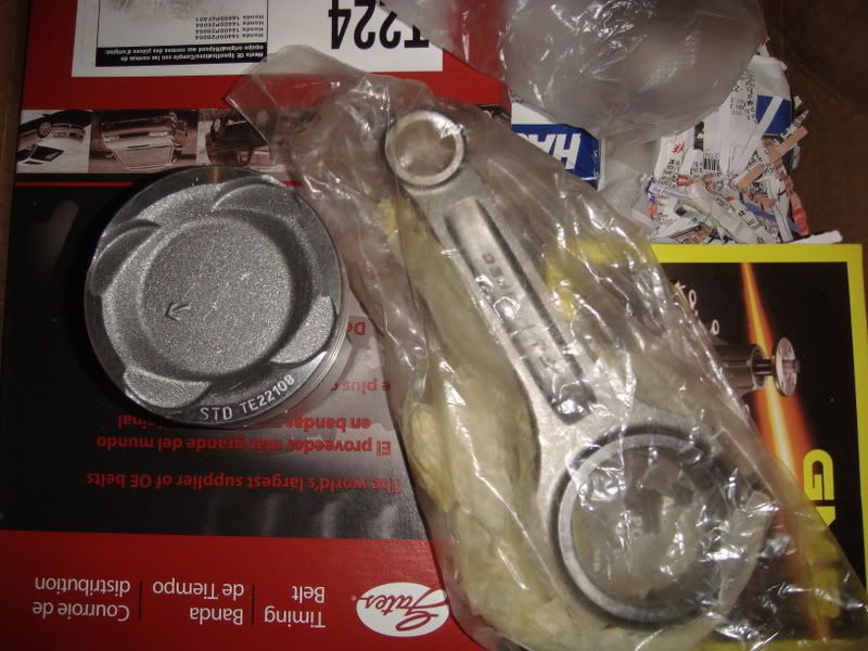

Pistons onto rods
ft/lbs reference for later
Ready to for loading into snow white

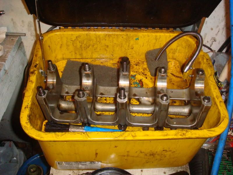

trip to the carwash "hot tank" with two cans of oven cleaner (forgot my cam at home for this trip...seems to be happening lots lately.. :P)
clean and drying

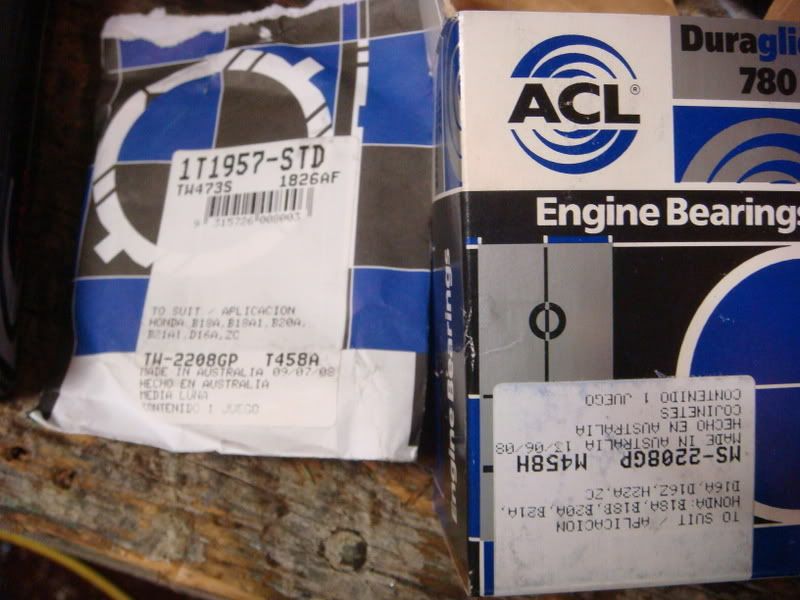

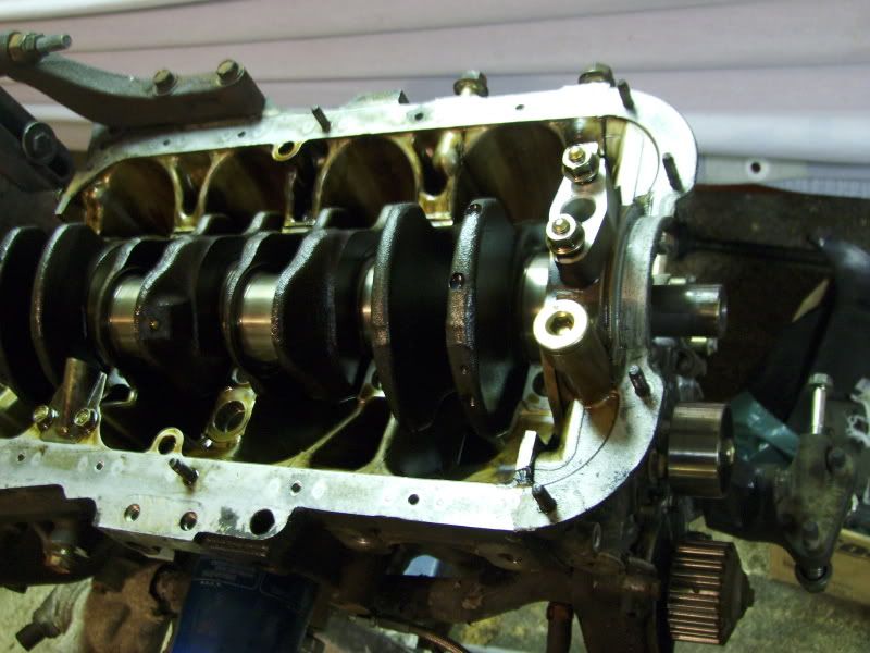

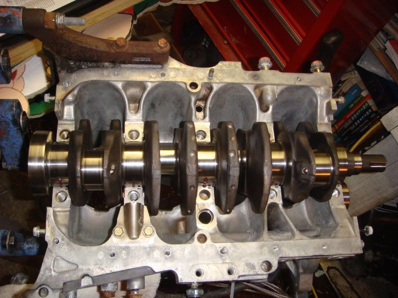

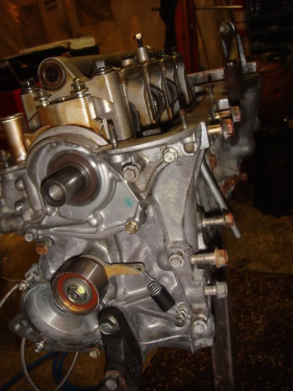

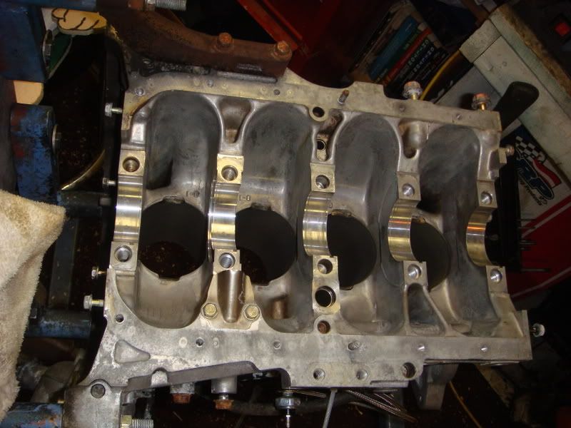

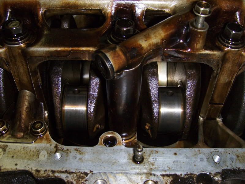

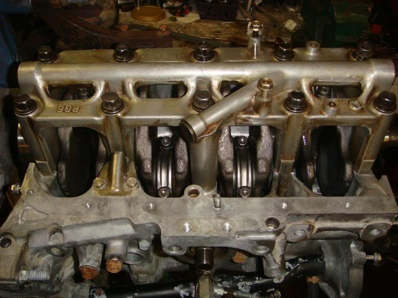

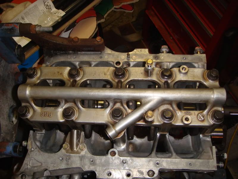

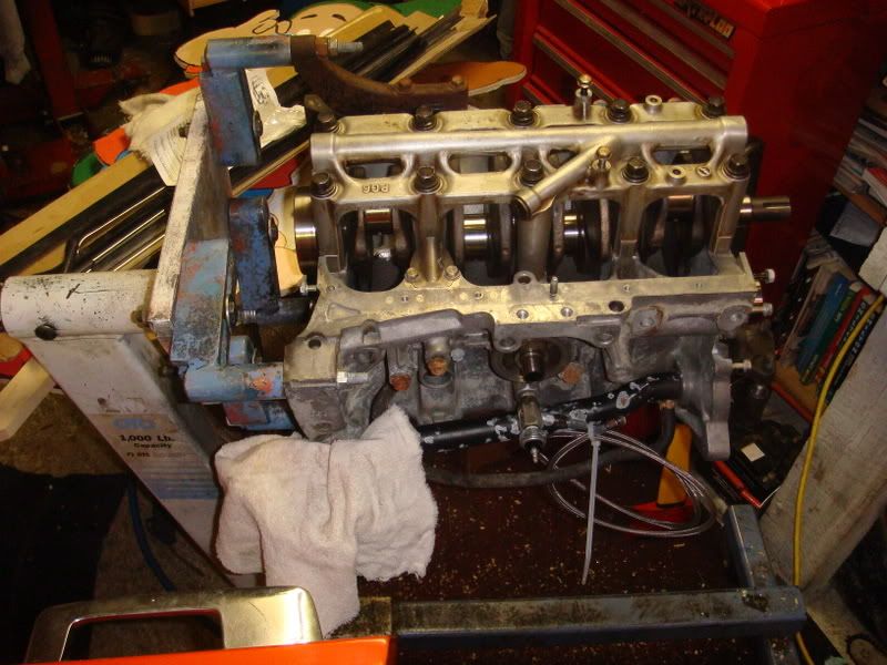

Got the crank dropped in last week
Say hi to dopey the crank inspector

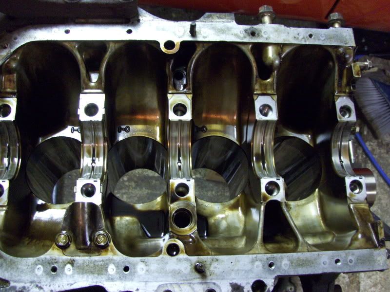

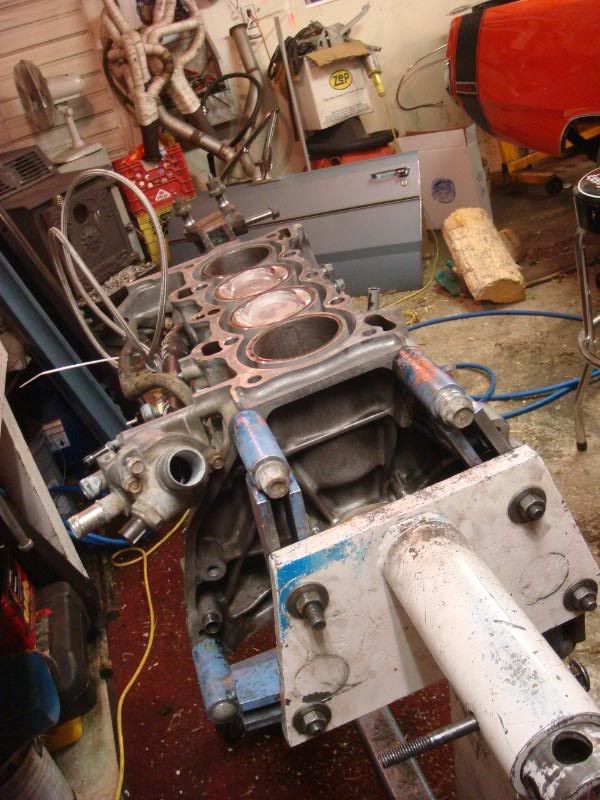

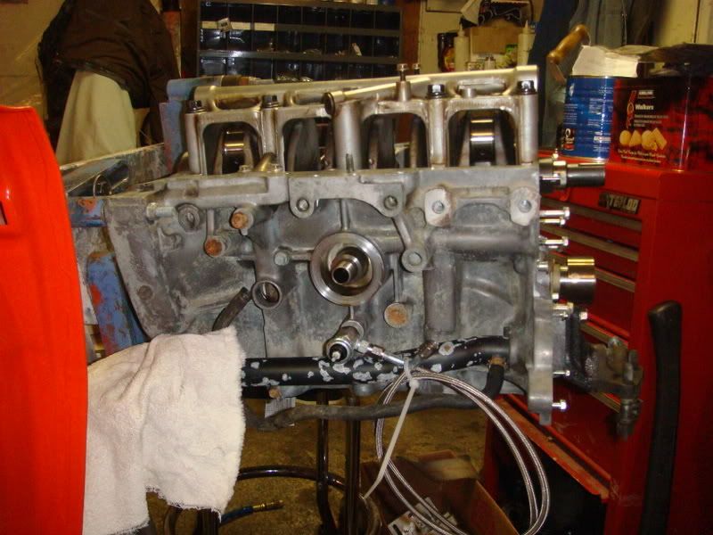

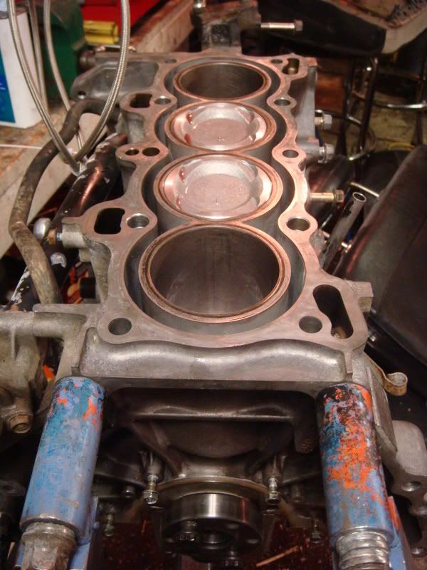

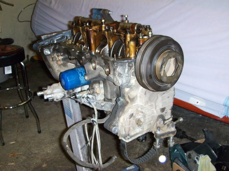

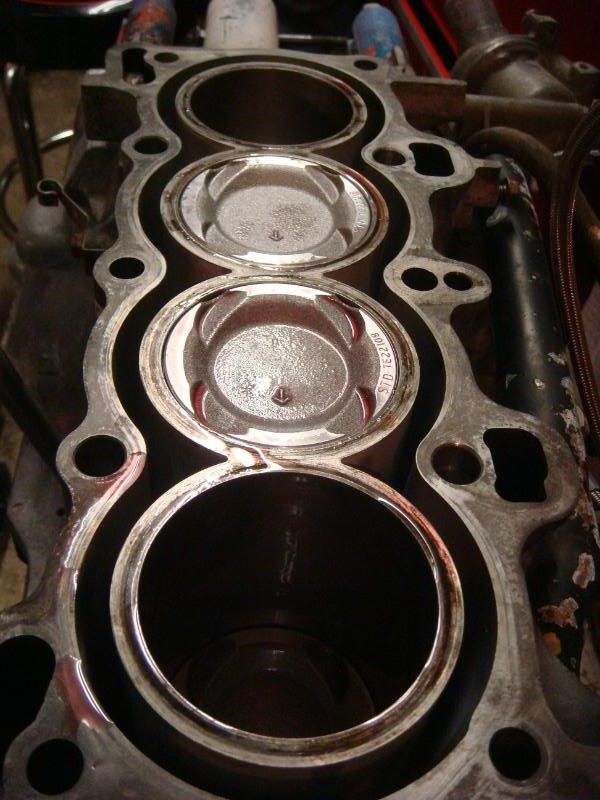

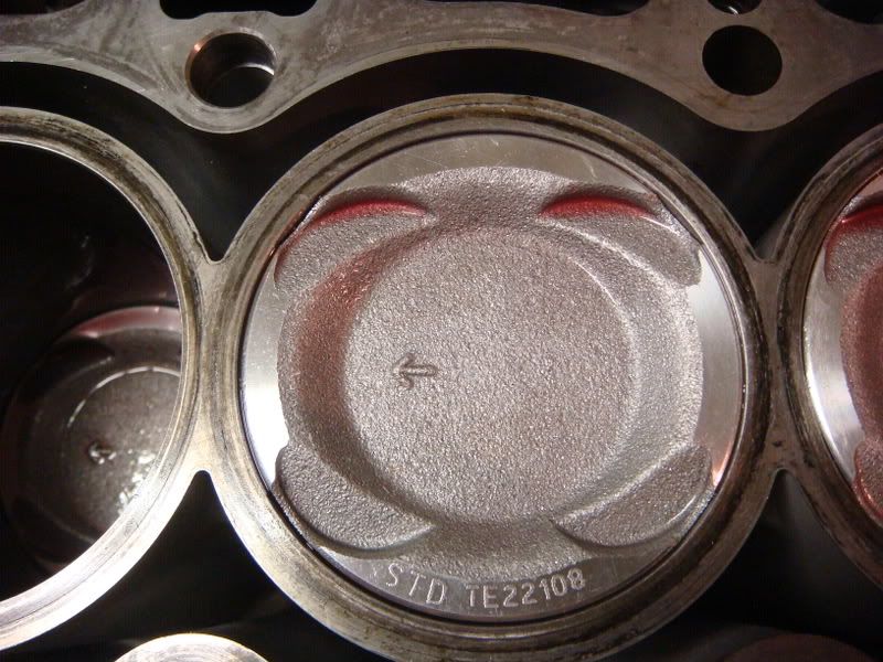

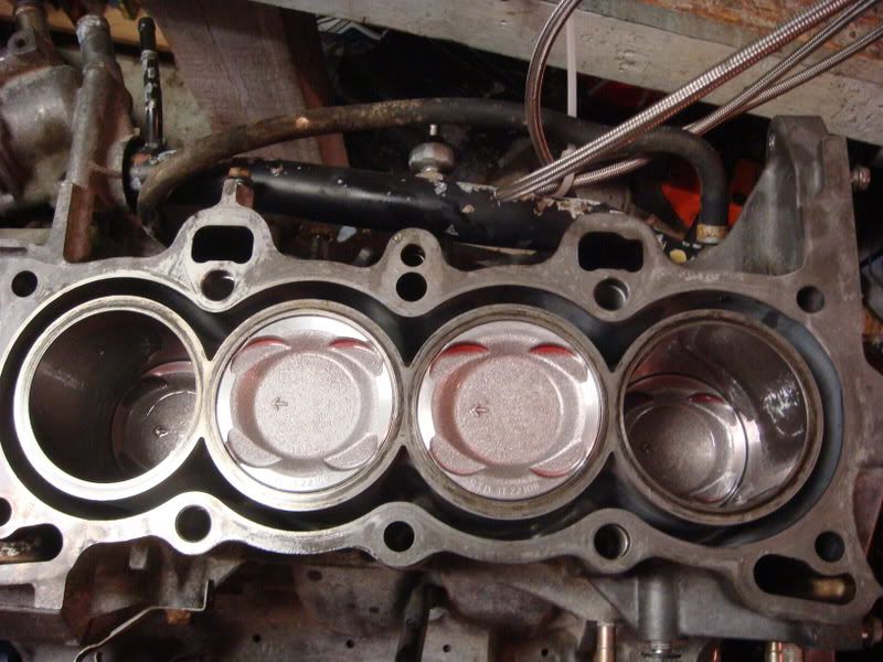

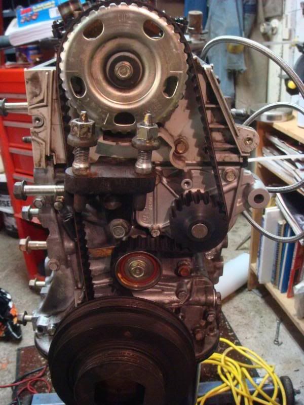

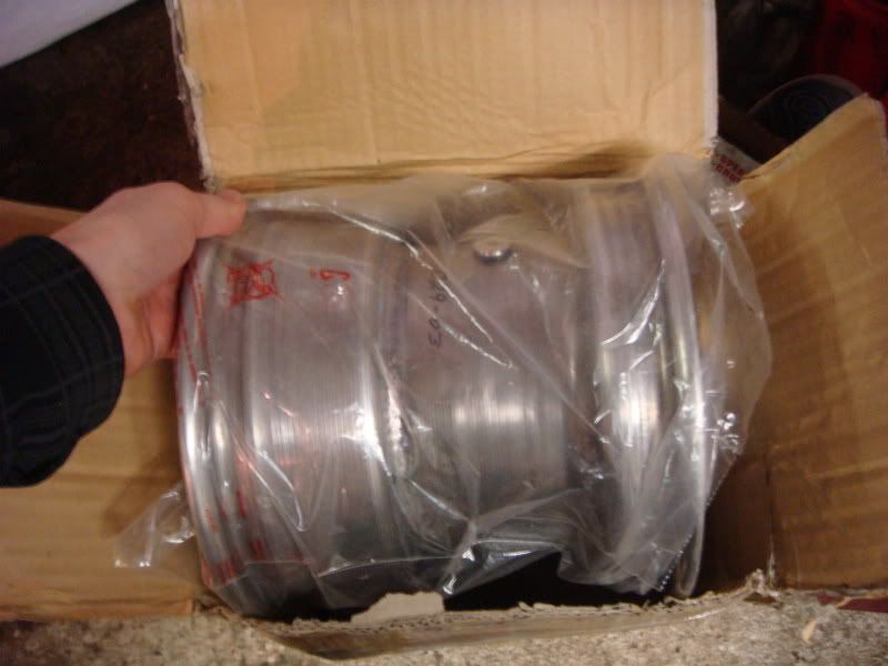

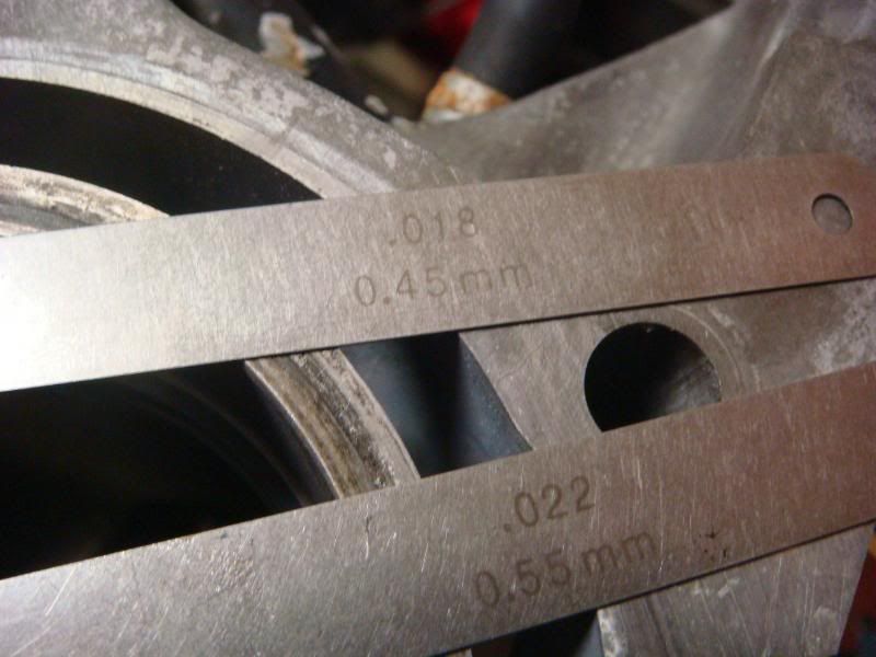

Pistons got rings and dropped into the bores and all the rotating assembly is now tightened up as of last night
Checking Ring gap... came out to .018" top and .022" second out of the box seemed more than big enough. (.0065/in and .0075/in resp.)
The infinite spellabilites of the asian market....haha coating gives you increased strenghth's :D I think it also suggests for max perf. that the pistons be kept to low RPMs :S
Shop's AC and heating systems.

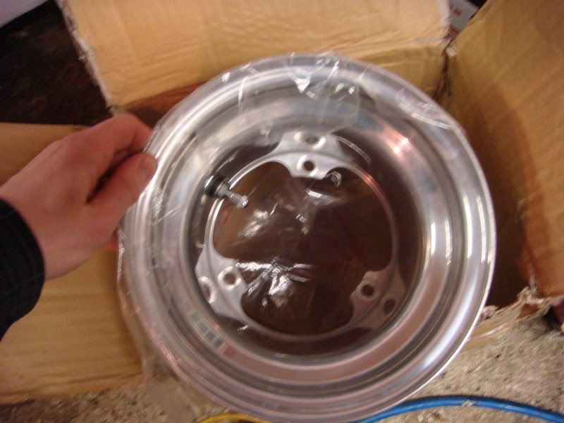

To access to your race car in BC you need one of these (note this is a 25yo Eaton's VIKING model top not shit damn near throws the snow over the house)
The parts safely stowed away.

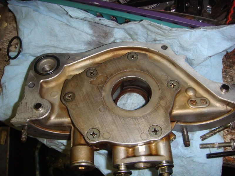

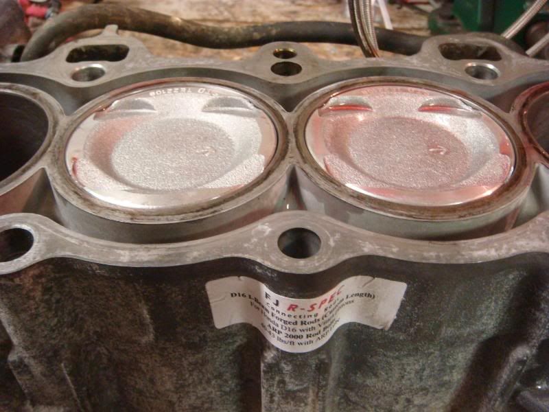

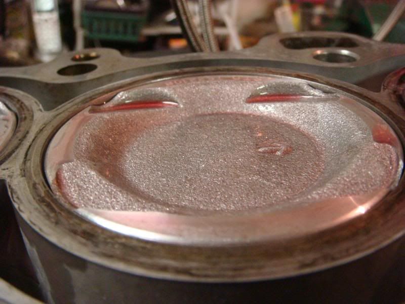

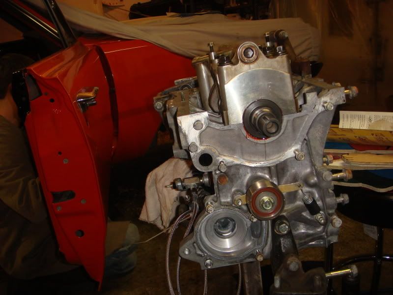

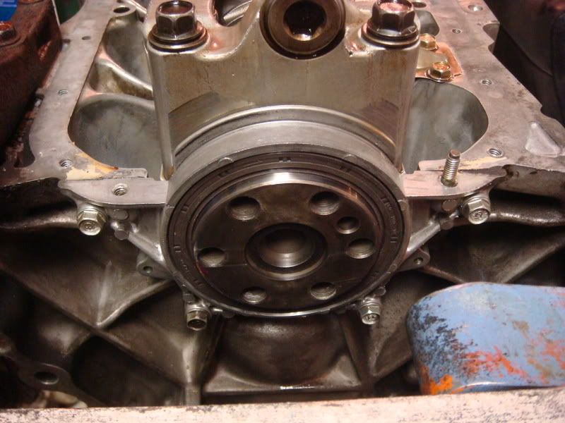

Ok not too much accomplished here last night, but here it is anyways. Got the pistons facing the right way now (thanks guys for catching that) and the oil pump and rear main saddle mounted.
The beach is 'that' way haha
All in and torqued.
Can't seem to get over how well these rods bring the damn near 0 deck height back.
Oil pump cleaned lubed and lock-tighted, ready to go

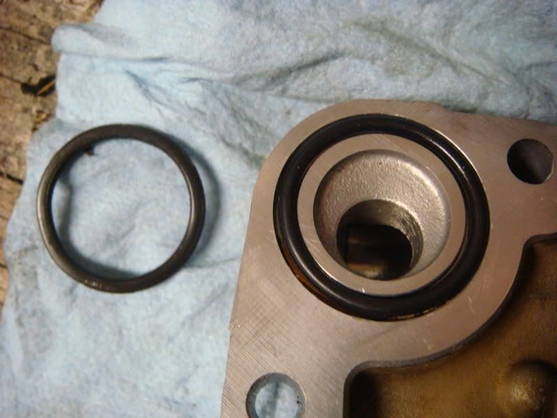

New O-ring courtosy of the FJT superkit.
Buttoned up
New rms and saddle installed.
Look Jr Digger wheels...aren't they cute.
Looks like a Russian hat up atop there!
Some perspective

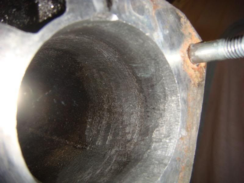

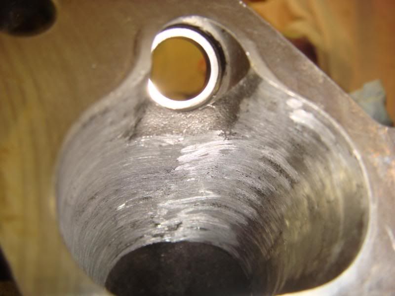

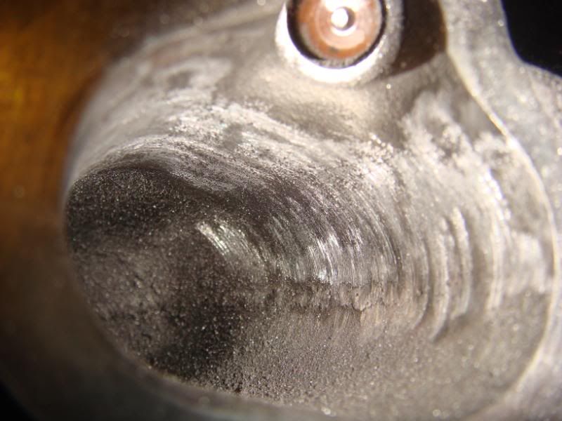

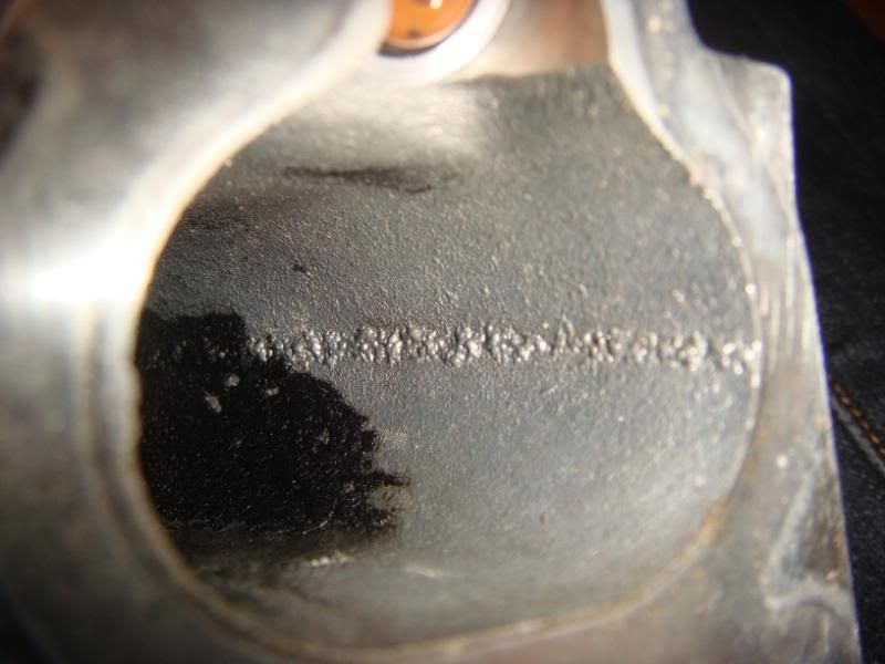

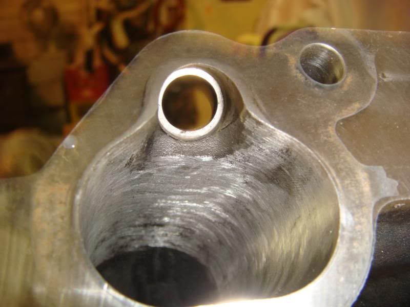

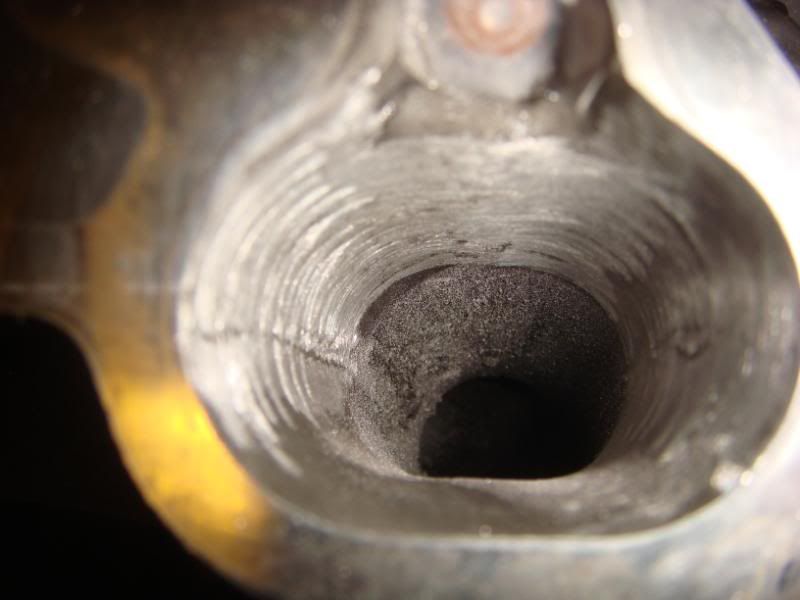

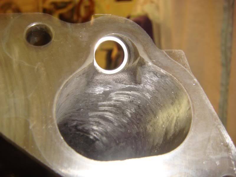

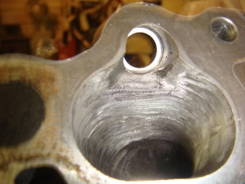

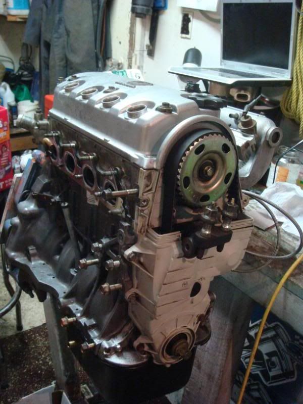

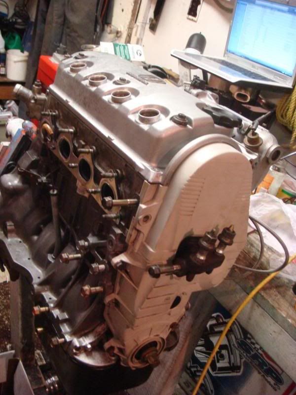

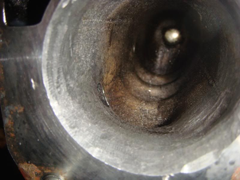

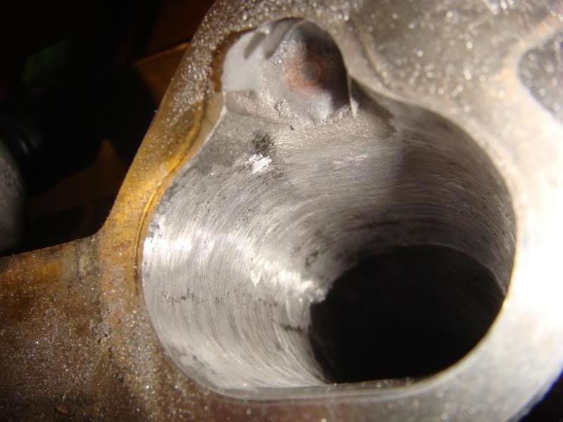

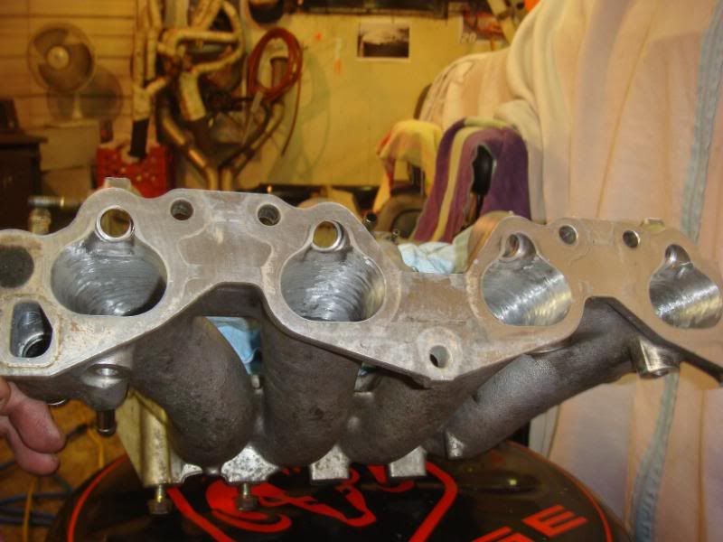

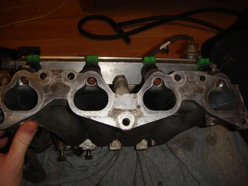

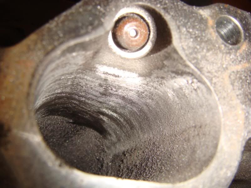

ah k been a while and its been going slow but its finally coming together, cleanup-ported the intake and sized it for a gsr TB, also go the right studs in and the head on an torqued.  bastards at our parts store wont sell  aircraft paint stripper over the counter anymore and won't give it to me under either.. fuckers.  so it looks like it might have to go back together with its sketchass half peeled valve cover.  anyways... on to some pics
virgin mani
the ports generally looked like this before i started with the sand roles
started working em in a bit
and more or less what they looked like finished (from right to left)

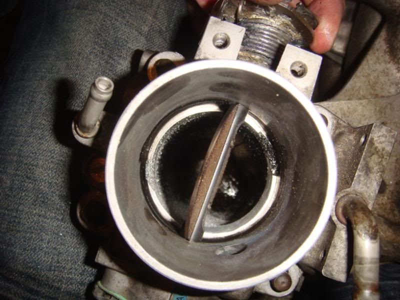

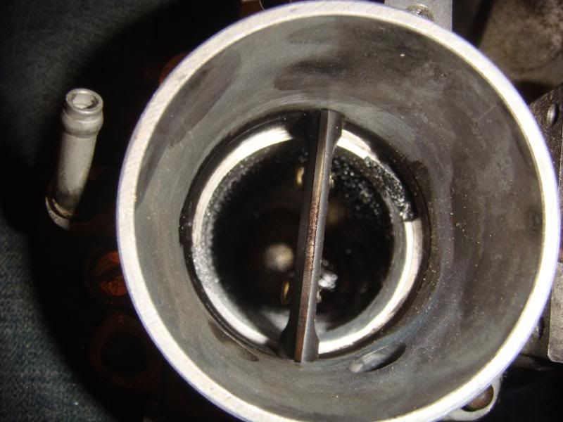

TB missmatch
and some grinding courtosy of free dremel...wich lasted all of about 4 minutes before i toated it.
On to airtools... if i had time i'd go back and spend a bit more time with a sand roll but untill it comes off again its just the way the carbide left it.

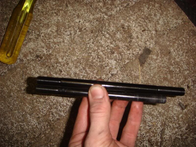

Differnce in stud length for a Y8 and a Z6(long ones)

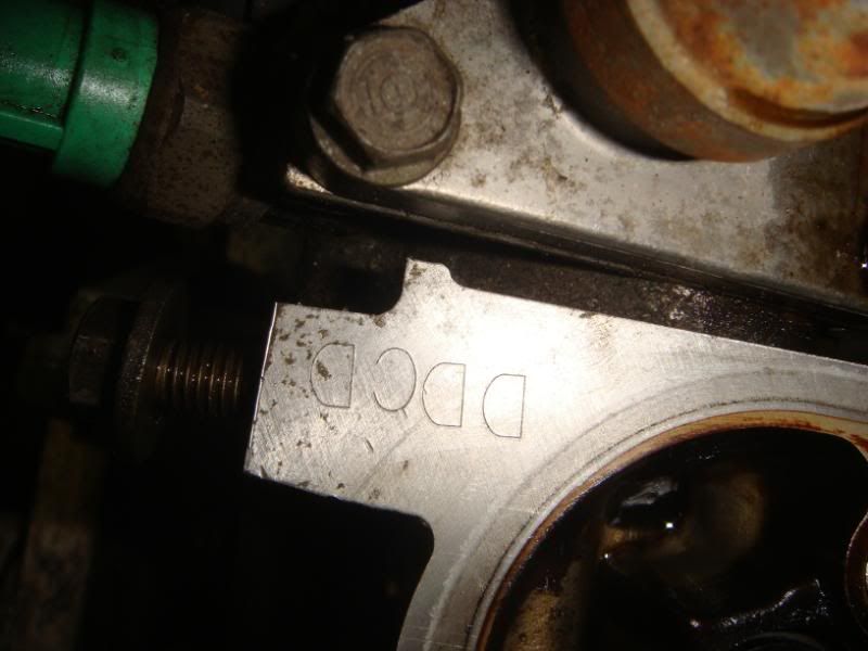

Head on...anyone know what these numbers mean? just curious

Is the DDCD bearing codes? Build looks great, you gona bring it down for some dyno days?
Re: Canadian D *updates 4/15/09*
« Reply #21 on: April 15, 2009, 08:50:12 PM »
Thanks for some ideas I'm building d16z6 w/ y8 head w/ vitaras w/ z6 mani and w/ h23 tb for now.
What intake mani are you using? (it looks like z6)
What is the bore size on that GSR TB is it bigger than 62mm?  ;D
« Reply #22 on: April 16, 2009, 12:17:10 AM »
It is a z6, and it is a 62mm TB

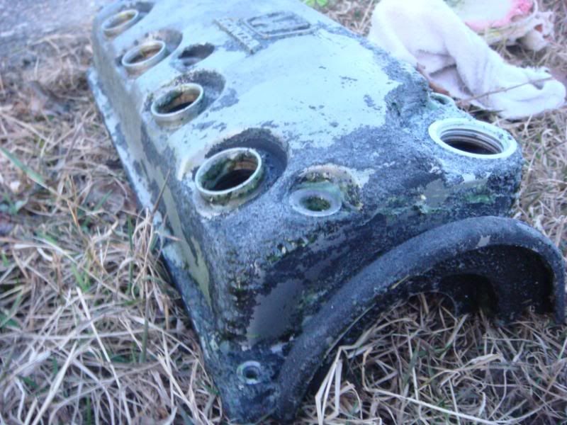

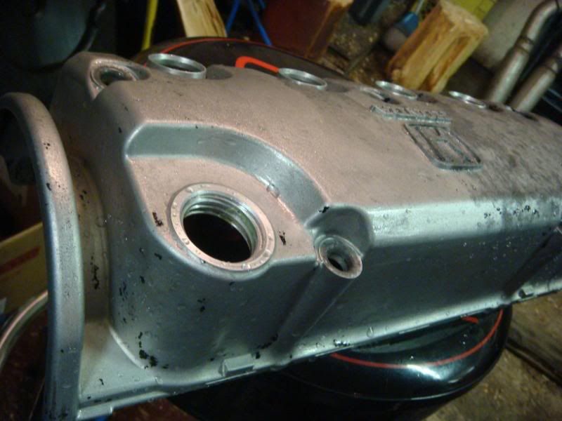

correct everything you see is z6 with the exception of the GSR TB.   **also on a sad note my cummins was stolen last night  :'(
found some stripper...and some chemical to clean off my valvecover too haha....

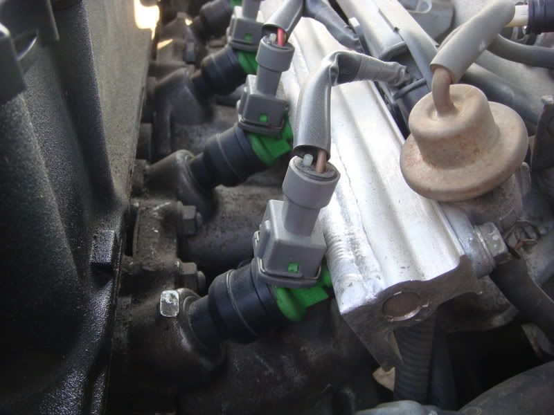

Looks good! Time to find another fuel rail, and order up the new injectors, and a 4 bar map sensor.

as far as those letters, i'm pretty sure the crank code is on the flywheel end of the block and there is 5 letters, one for each of the mains.  can you zoom out a little on that picture or tell us what surface that is?  looks like on the head under the vtec solenoid.  might be the cam bearings but idk.
loving the bare aluminum vc
