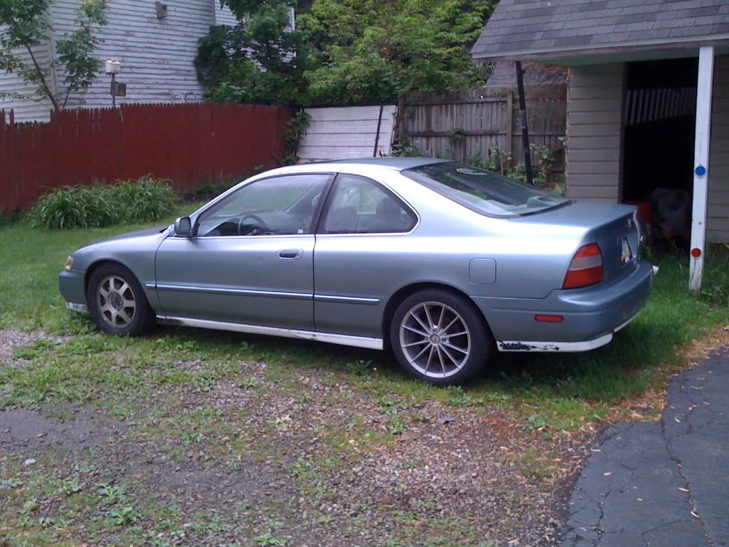

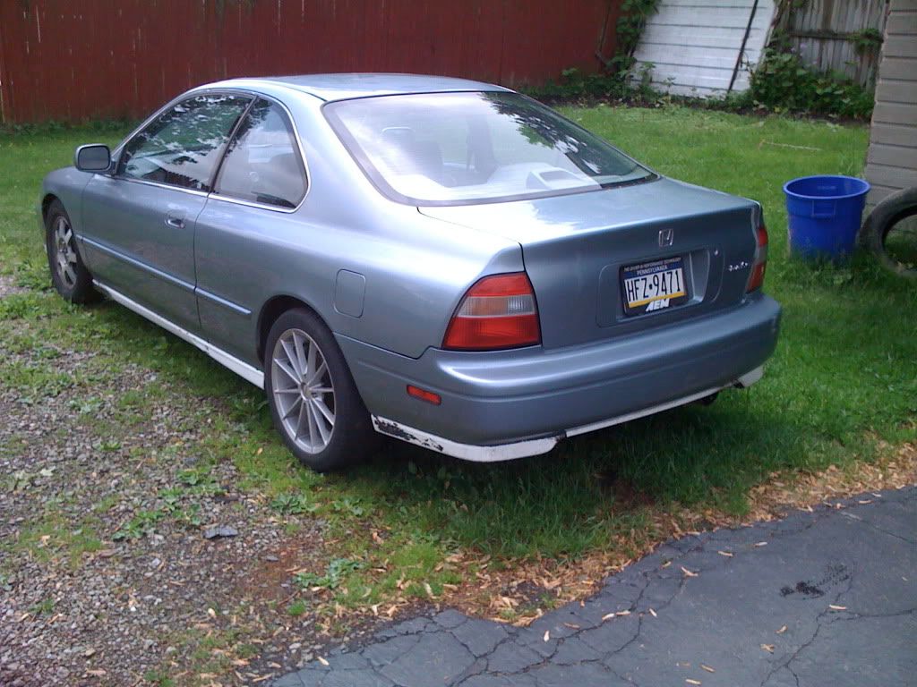

the car is a 95 Accord EX coupe. bought the car with no motor or trans for $200.

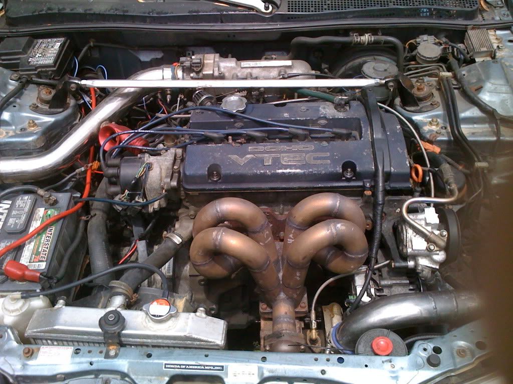

the motor:
stock F22A bottom end
F20B sir-t top end
JDM H22 rods
Wiseco 4g63 stroker pistons
King bearings
ARP head studs
Homebuilt ramhorn
Dying Holset HX35
Ching Chong 38mm wastegate
Home made "whitey bend" 3" downpipe
Ching Chong rfl blow off
Evo 560 injectors Delphi 780cc injectors Precision 880cc injectors
Ebay intercooler
XTD stage 3 clutch LSD dragger clutch
M2B4 LSD trans
3 bar map
Chipped P28 on crome, tuned by me Sewell tuned on EcTune
Ebay alum radiator
GC coilovers
Konig 17" rims with 215/45/17 (front tires in pics are drag tires)
accord wagon front rotors and calipers
the car is (well was before it spun a bearing) was running 12lb boost, i was waiting to turn boost up until i had head studs, 3 bar, and bigger injectors. it ran high 13s at around 109 IIRC. the car would not come off the line, it either hopped horribly, or came off the line like a limp dick.

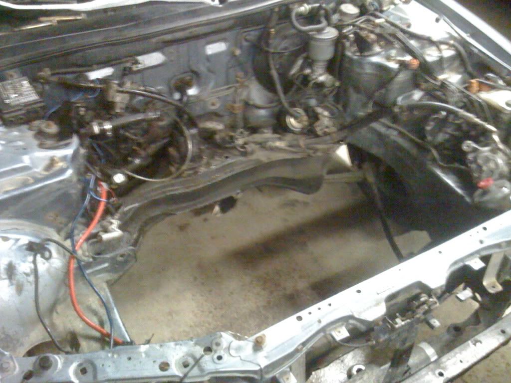

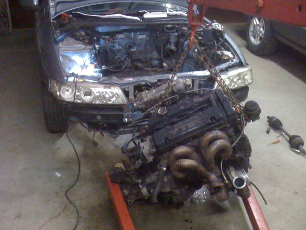

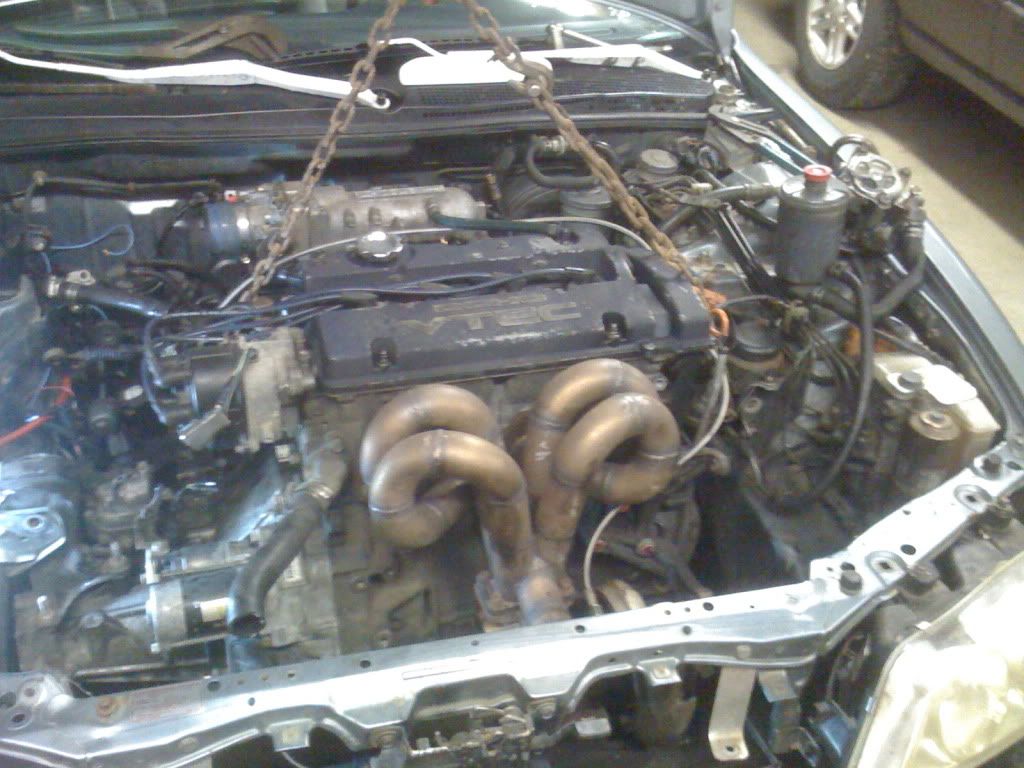

here is the motor about to be pulled out.
here it is on the ground, took like 2 hours and about 6 beers!  ;D
the engine bay is a mess, im going to clean the fuck out of it, tie some shit out of the way, and maybe do some sort of mild wire tuck. i dont want to put a ton of time into it, i want to get it back together in time to get it tuned.

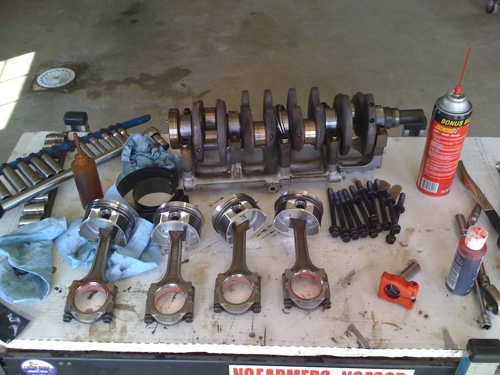

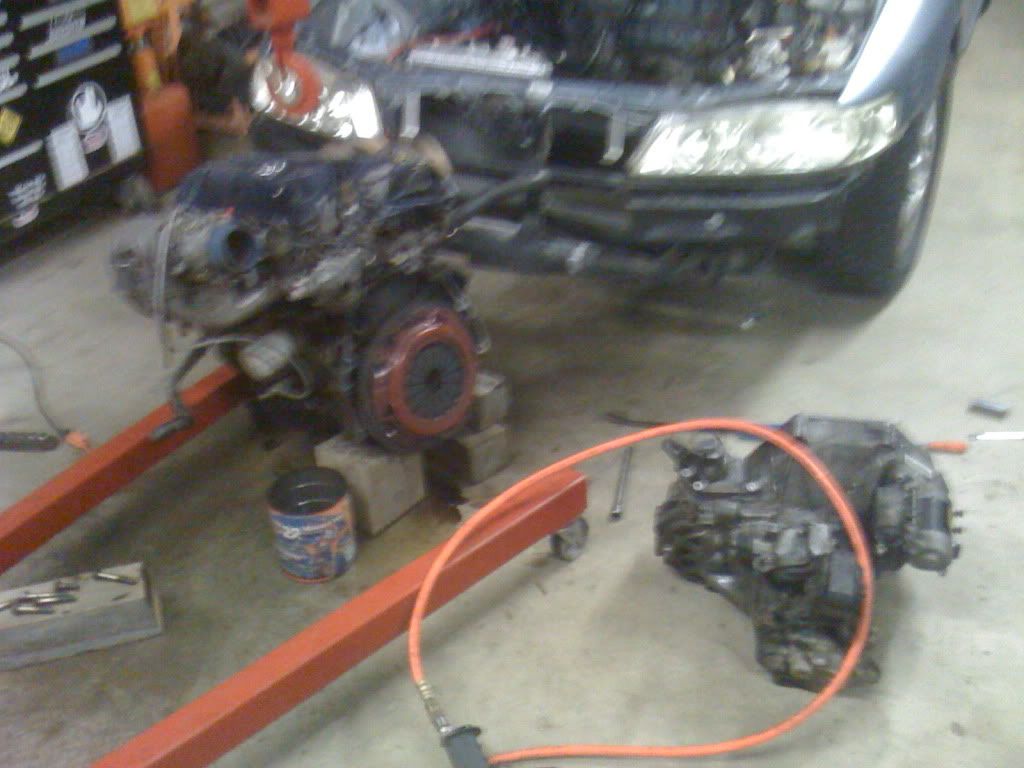

The M2B4 JDM h22 LSD tranny removed
the piece of shit jackie chan XTD stage 3 clutch, 1100 miles on it. no signs of excessive heat, and i really didnt abuse it a fuckload...

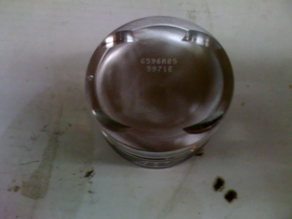

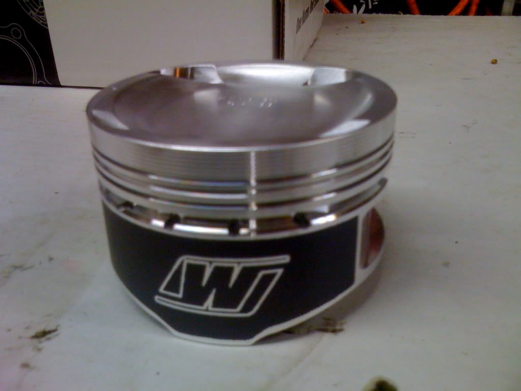

Wiesco evo 8 stroker pistons!

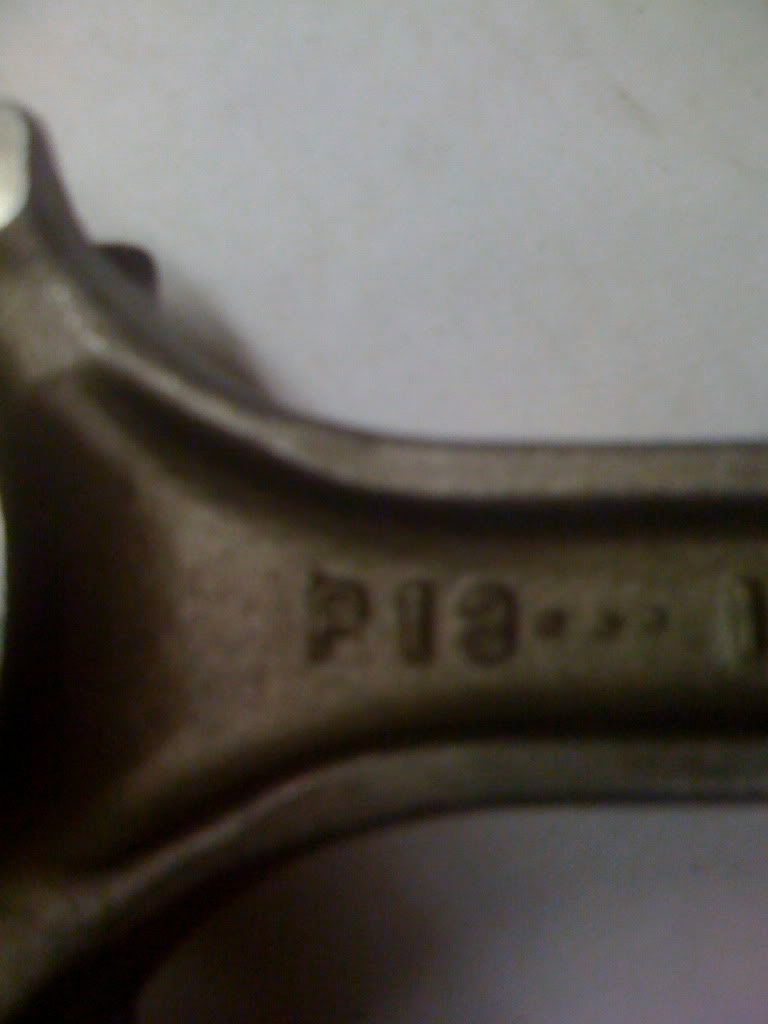

P13 H22 rods
my $20 junkyard score. i also got a new timing cover and balancer cause mine had a huge chip in it.

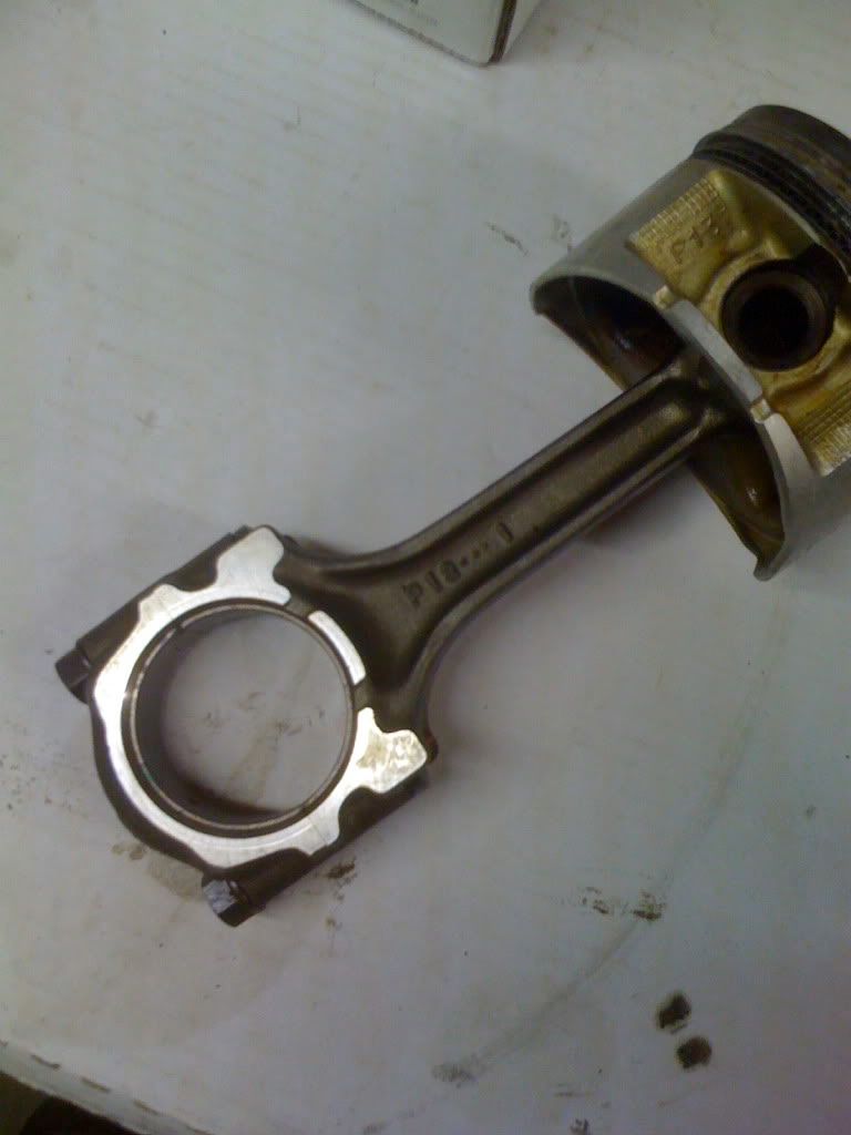

the rods are at the machine shop getting reconditioned, and i got to thinking, the stock P13 rods are pressed pin and the pistons are floating pin, i guess i got two options, either get the new pistons pressed onto the rods or have them bore and rebush the rods.
what is the better solution here? the machine shop said they can do both, the price of boring and bushing is quite a bit more, is it really worth the extra cost?

i got good cheap stock H22s and they are more than enough for what i am going to do. i plan to port the oil pump, and also shim it like 1/16. im also going to blend the bowls and just clean up the ports in the head. also the intake is going to get a slight porting.
i talked to the machine shop, they suggested i just have the pins pressed, they have a rod heater and they are only charging like $3/rod. they are also checking the rods for roundness and going to true them if necessary. i picked a shitty weekend, cause the machine shop is going to be off till monday, so i wont have the piston/rod assy till tues or wed. that will give me plenty of time to get the crank in, all porting done, rings gapped, and all that good shit.

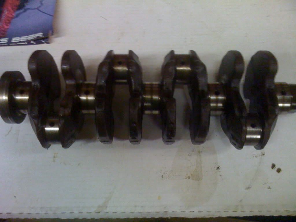

Got the motor apart tonight, and the block is fucked. The middle main journal is way fucked in the top bearing half of the block.
Tomorrow it's bright and early to the yard, hope the block I robbed the crank from is still there. They only wanted another $20 for the entire motor, I should have taken it when I had the chance.

What's the specs on those pistons? I'm assuming the compression height is shorter since you'll be using the longer H22 rods.

the pistons with the H22 rods end up .100 in the hole. i dont remember the exact compression ht, but ashb82 did an excellent write up on the link i provided above. all the credit goes to him.

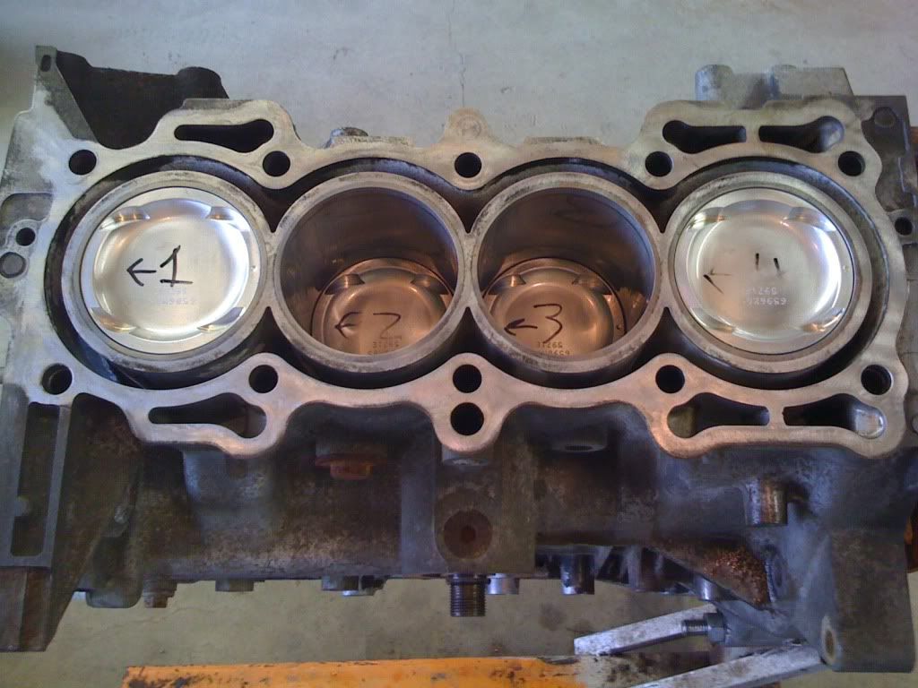

now that that is taken care of another progress update. i got the block at the local jy, the rest of the F22B2 for another $20. it looks excellent. i pulled it apart, it had decent cyl. walls. i ran a hone through it and the cyls are beautiful.

the last time i was home i did get some progress made, i got the bottom end all together. it rotates now! and everything spec'd out awesome and it went together quite smoothly.
i should be home within the next week, i want to get it all together and partially broke in, then its time to up the boost and see what it can do.
here are a few pics of the bottom going together.
ok, well more updates as the build progresses. hope to have it up and running by mid next week.
