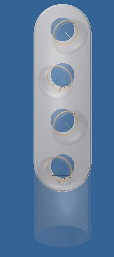

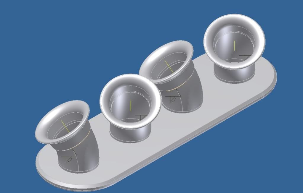

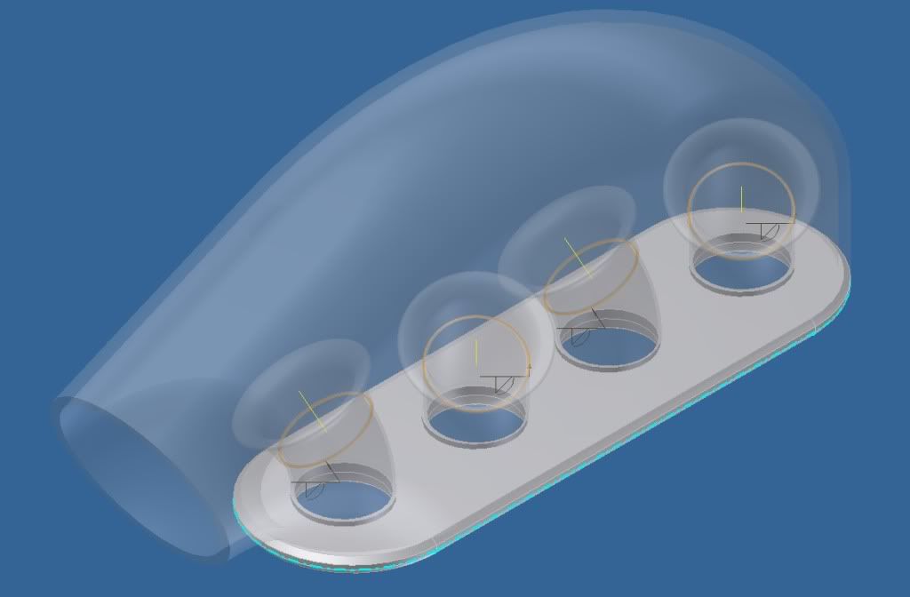

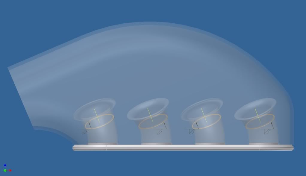

Ok I think I am finally done with plenum and stack design
I am raising the stacks in the plenum so to reduce the overall distance from the tip of the plenum to the head so to fit it in smaller cars better.
Will be standard flanged for 90mm throttle body but can be switched for 105mm throttle body also ;)
Let me know what you laddies think :P

wtf is with the wierd runner exit into the plenum?

on topic:  james, are you going to do a cfd test on your plenum design?  if so, who are you getting to do it?

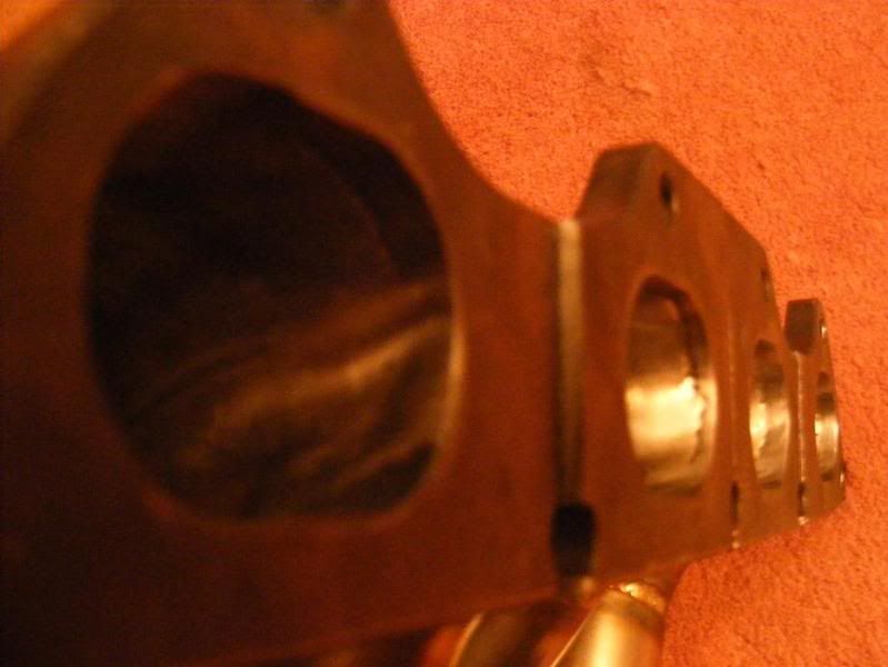

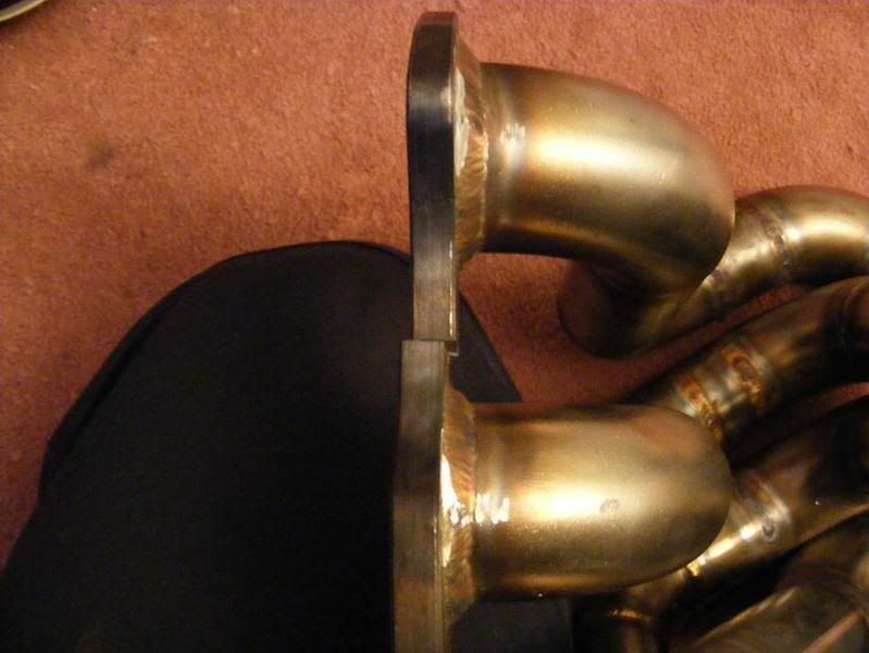

Quality BMC work.
Im still having a hard time with the fact you actually sold this piece of shit to someone.
Its a shame you never contacted me or anything about this, had you done so I am sure we could have worked something out.
BTW tubular manifolds bend and conform very easily and will seal off on the head just fine, and after several heat cycles the pipes will normalize to that postion and remain the the shape from there on out..

Quality BMC work.
spoken like a true scammer.
take some fucking pride in your work, don't send out products that look like complete ass.
i've never seen a weir manifold go out like that.

Also an intake manifold is meant to match a cylinder head so on a stock head or your typical ported head a manifold like this will
A. Lose throttle response
B.Torque
c.Shift power curve in the wrong direction

i know i may have invited you here but i wasnt aware that you were the one that ships out manifolds with flanges that arent true
why would you even ship something out like that?
Quality BMC work.

Anyway, that IM design is junk.  That's innovative placement of the velocity stacks to keep flow from disrupting the adjacent stacks, but each one is shrouded by the side of the IM it is angled toward.

James, take your bullshit back to H-T. You were contacted many times on that manifold and basically told the guy tough shit and to get fucked. I had to cut that pile of shit apart and put a new flange on it. Plus I had to finish welding the collector you neglected to weld.
If you think you are going to start drumming business here you are wrong. Aaron and Corey do most of mani slinging here and they actually take pride in their work. DIAF.
