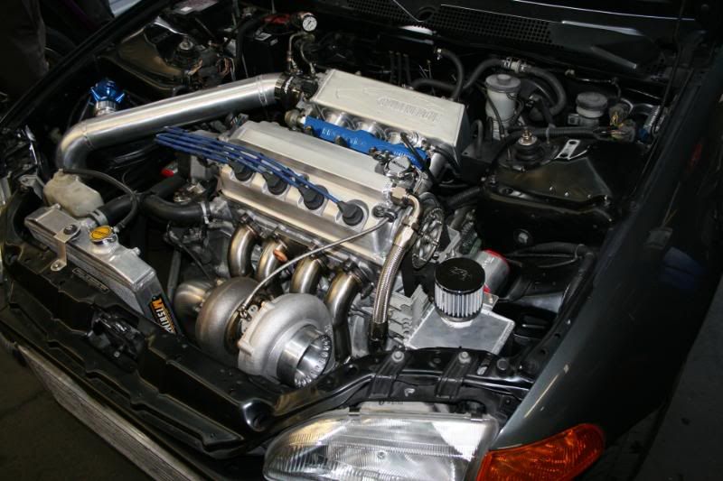

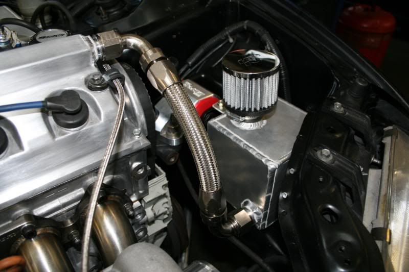

FYI, since we have you on tap, do you have any pics of your valve cover fab?  I really like it, looks like it was super simple to baffle without constricting flow.
Re: New vitara record!!!!
« Reply #56 on: July 21, 2009, 08:39:15 PM »
x2
JFK78
  • Posts: 17
« Reply #57 on: July 22, 2009, 03:17:48 AM »
I think all he did was welded a piece of square tubing onto the cover then drilled several holes through the cover into the tubing. But since what I think don't worth shit, I hope he tells us what he did.
I didn't take any pics during fab, but it really is super simple, and we didn't have to baffle anything.
It was a piece of square channel that fit a -12an fitting, we cut the bottom open and cut/folded/welded the far side down for the angle. Then we drilled holes from the top above the areas where the factory baffling is in place in order to utilize what is already there. Slightly enlarged a few of the existing holes on the underside, nothing major. Welded her up, then ground/sanded for that "made that way" raw metal look that I love so much.
After all the dyno pulls and track runs, there is still absolutley nothing in the catch can. This setup works flawlessly, and is gorgeous to boost! I take a few minutes to stare at the engine bay everyday, it's my favorite piece of art that I own!

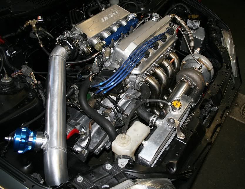

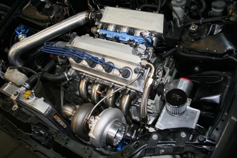

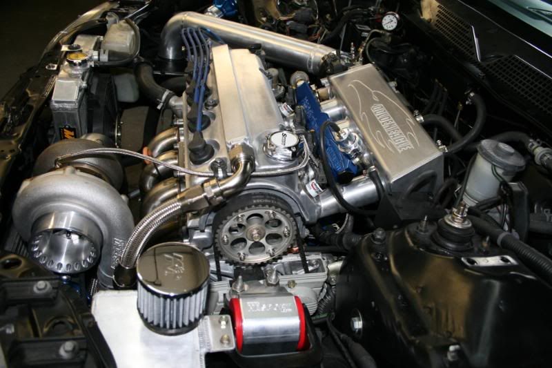

Figured I'd post the older pics here as well, it's slightly cleaner now but nothing major.
